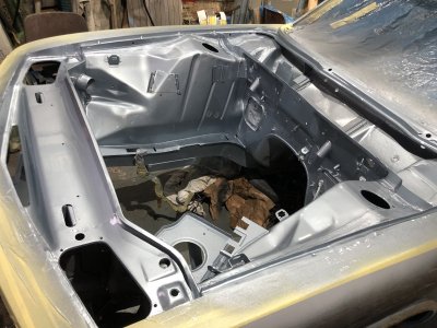

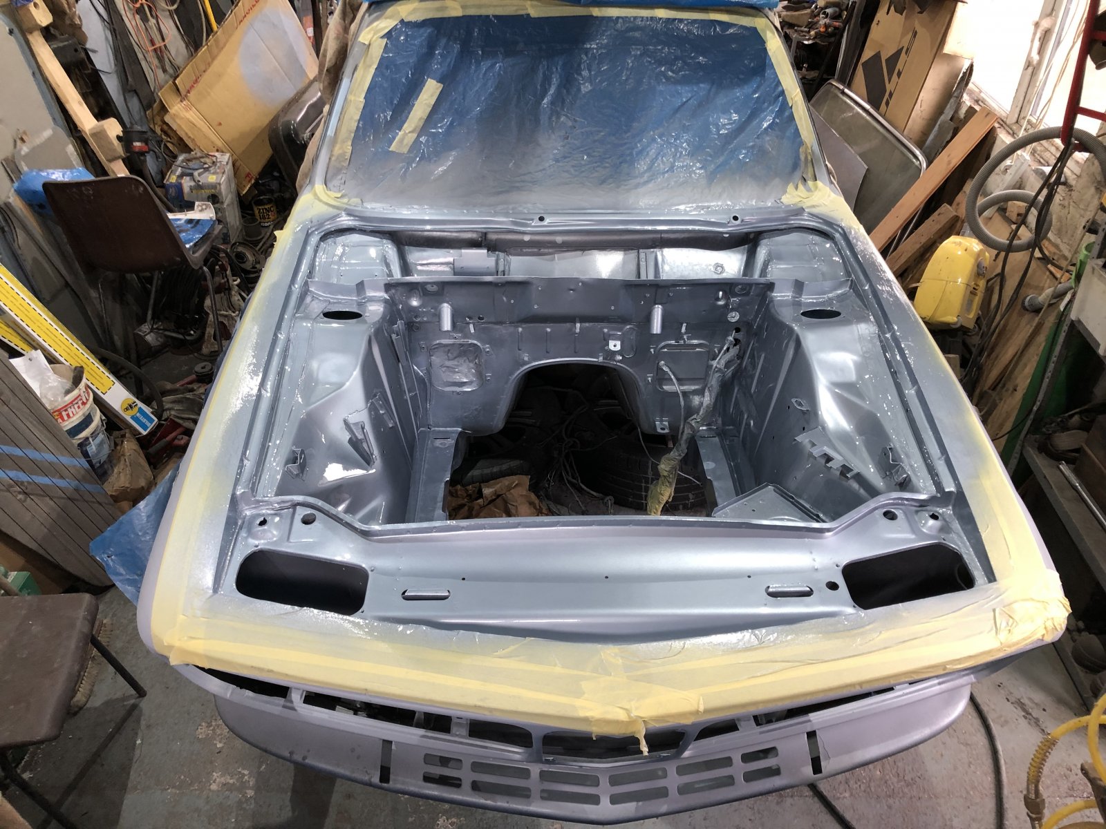

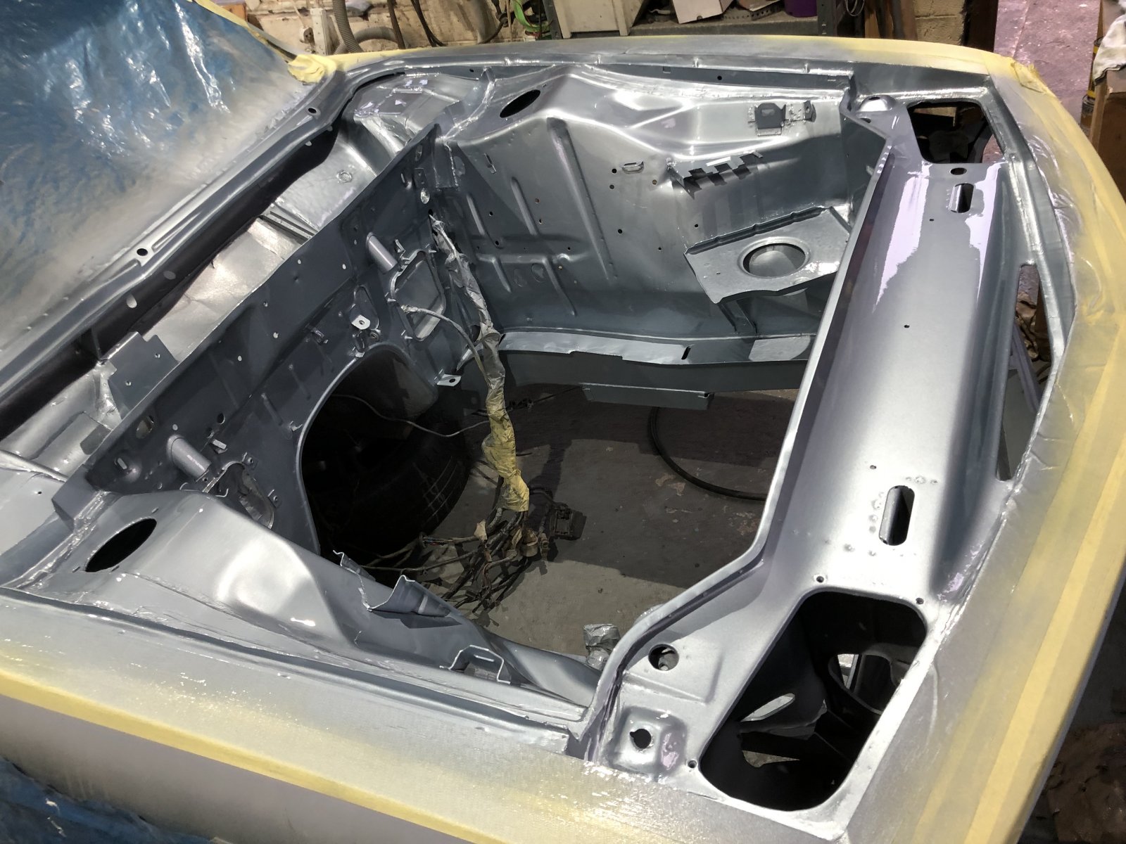

Hi guys
I painted my engine bay last month.
I bought fjord blue 037 from a reputable paint supplier.
But I am fairly sure the paint he mixed is NOT the correct colour.
He mixed it from what was on his computer for fjord blue.
He had said to me did I have the car outside and he would use his “paint camera “ to scan it to get an accurate match.
I didn’t have the car with me or any panel from it either.
So I think I will have to try again with him
This time I am planning on bringing in the sunroof from the car ,the original factory paint is still on the underside of it .
Hopefully he can use his camera to get me a better match .
The last batch looks too silvery and doesn’t have enough blue in it .
Has anyone else ever had this problem with fjord blue ??
Or are there more than 1 fjord blues out there and he mixed it to the wrong one ?
I have tried to convince myself now for about a month that I am just not seeing it properly but I had a friend call by yesterday and I shared my thoughts / doubts. And he agreed it’s not the original colour in his opinion either.
It’s a pain now to have to re do the work but , I’d prefer to just take it on the chin now and fix it rather than looking at it for years knowing that it’s wrong.

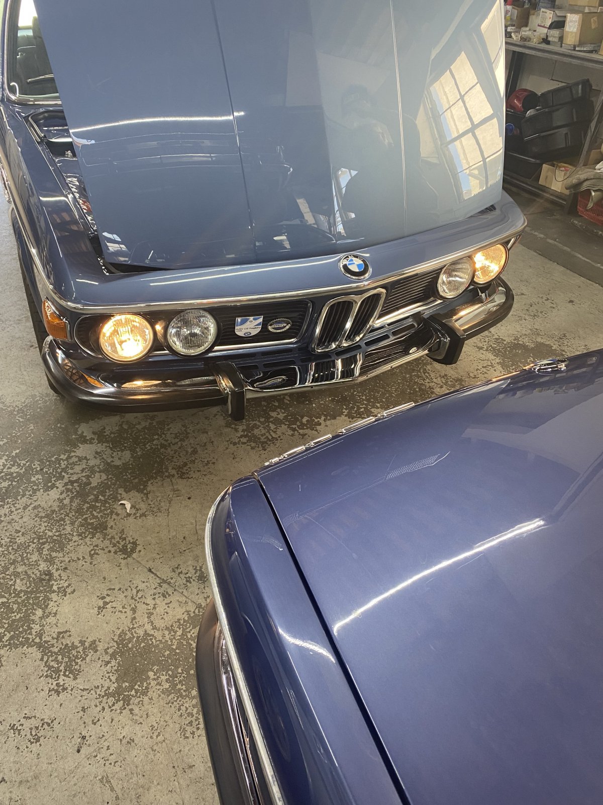

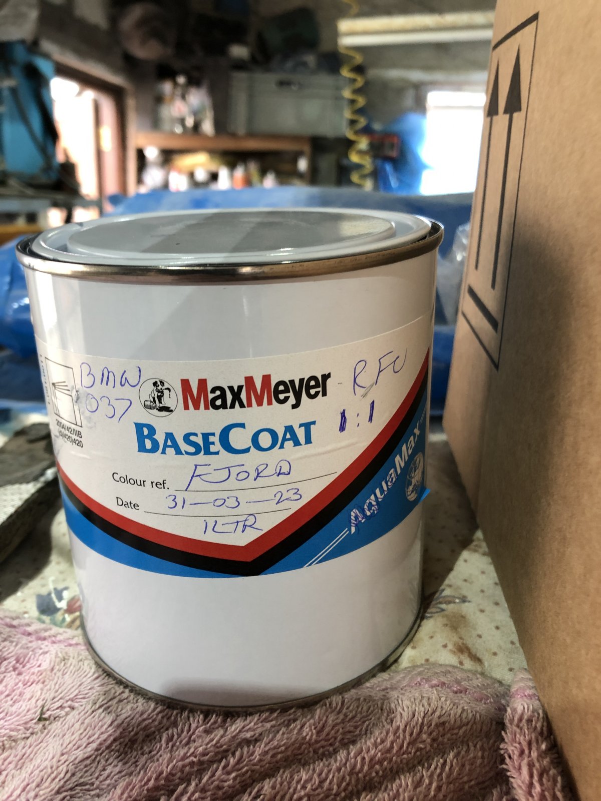

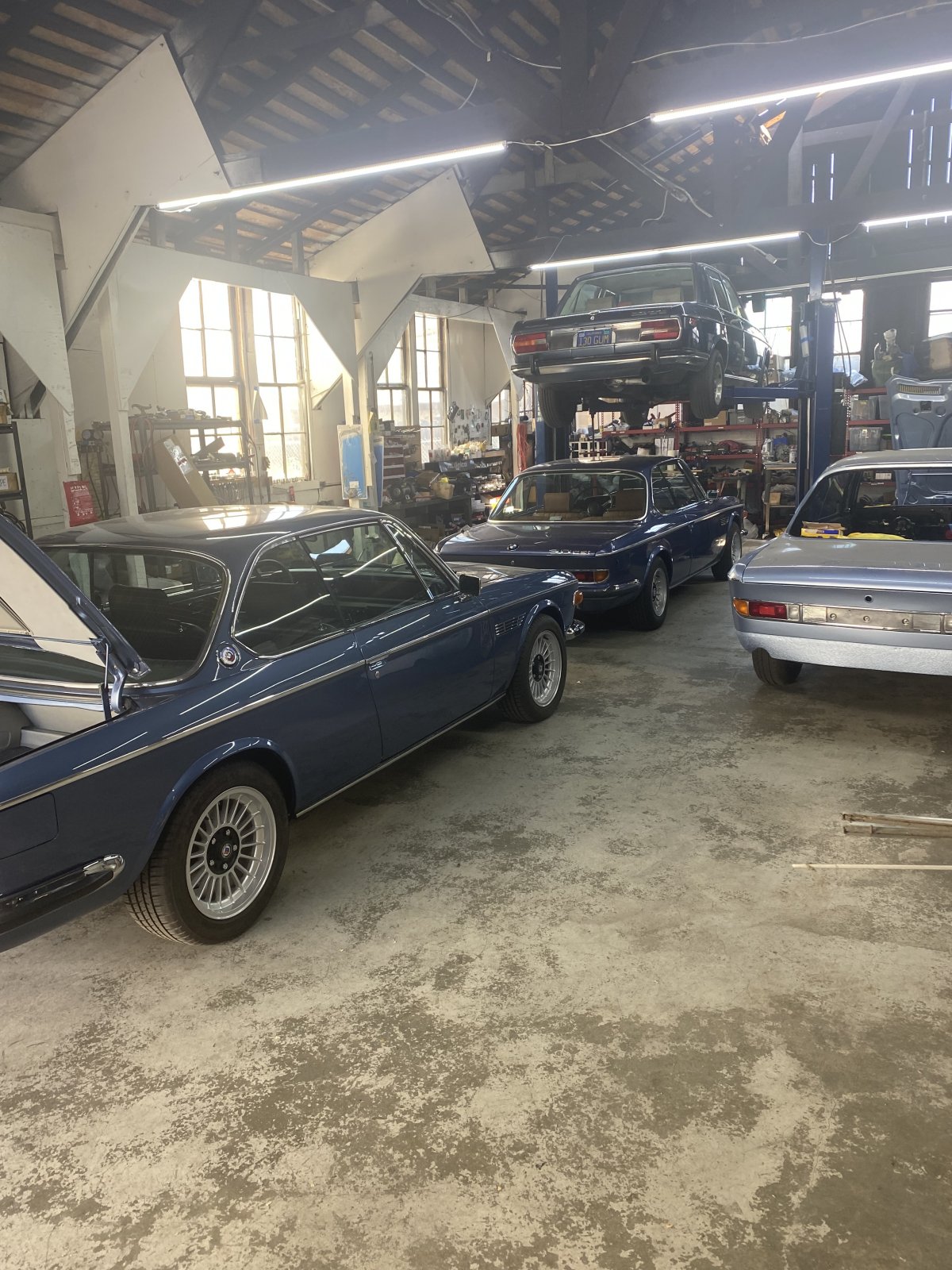

I'm lost- you show a coupe engine bay painted Polaris. A can of paint titled Fjord. A pic of a stick ?with wet paint that looks Fjord.
Which is which?
I have 3 fresh Fjord paint jobs in the shop now- do you need pics?
Is that room your painters paint booth? No wonder the paint was incorrect. Anyone with eyesight could see the paint wasnt fjord when they opened the can the first time. They need not have gone any further. Close the lid and tell you its incorrect.
First, a paint supplier won't know what Fjord looks like. I agree that it looks too silver, and without a metal piece off the car as a sample your best option is the scanner. They should be able to tint the existing paint to correct it. It's good you've stopped after the engine compartment, not that much work to fix.
Barry--I had a similar situation getting the correct Turkis paint on my car. The restoration shop used PPG metallic paints. The formula For PPG Turkis looked too silver in color and took several coats to paint a 2 ft X 2ft metal sample. Forum members Paul and Jon told me to use Glasurit metallic and the color and texture of the metallic was very different and vibrant in color when seen on the metal sample in the sunlight. I suggest you get a quart of the Fjord in Glasurit and paint a metal sample with the correct primer and clear coat. Then you will be able to see if it matches your sunroof. Now is the time to go the extra steps to get a finish that you will be satisfied.
This is interesting. I had 037 mixed right in front of me for my fjord 2002 that I restored a few years ago. It looked correct when they showed it me but when I went to the body shop after it was painted, I couldn't believe it. The color was more silver and had more lilac in it than what was on the car before and I could definety see a big difference when I got it home next to me coupe. Initially, I was pretty stressed about it. The paint job was nice and I wasn't about to get it repainted, so I finished putting the car back together. It got all kinds of compliments and won two awards at the first show I took it to. It also broke a record on BaT for a non tii square tail light.
Which is which?

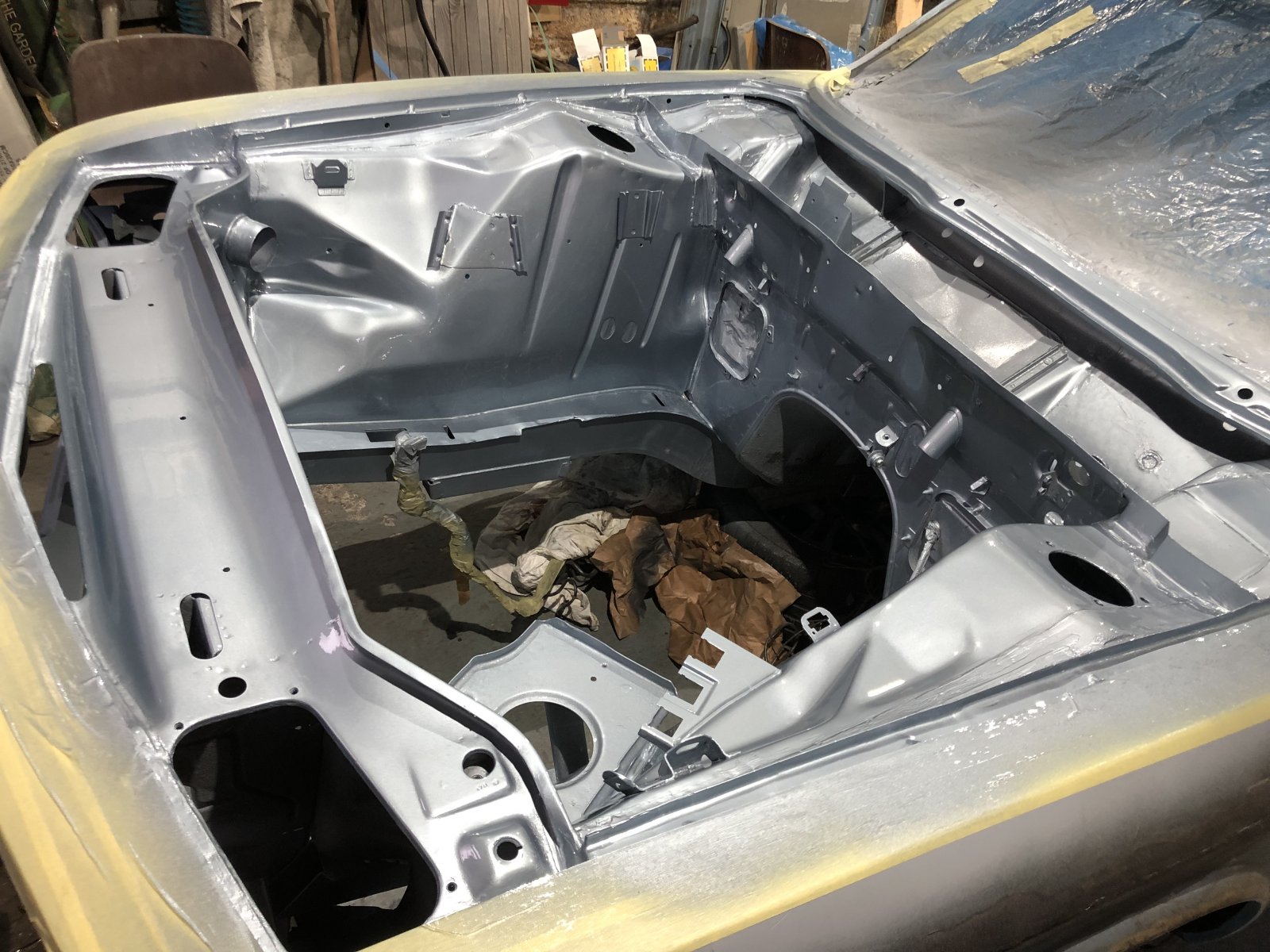

Hi Don
The stick and the engine bay are from the same can of paint.
The only difference is that the engine bay also has clear coat on it.
I might be crazy but I think it turned more “silvery” after I applied the clear coats.

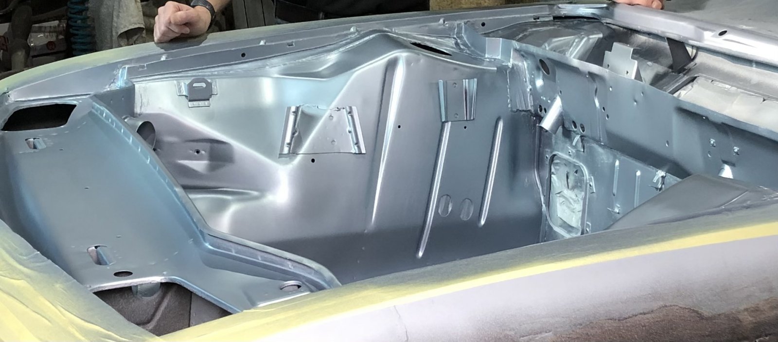

Thanks for the offer to supply photos, I think I don’t need them, I’m hoping that once I bring them my sunroof panel they will be able to match that.
Here is a photo taken before I applied the clear coat.

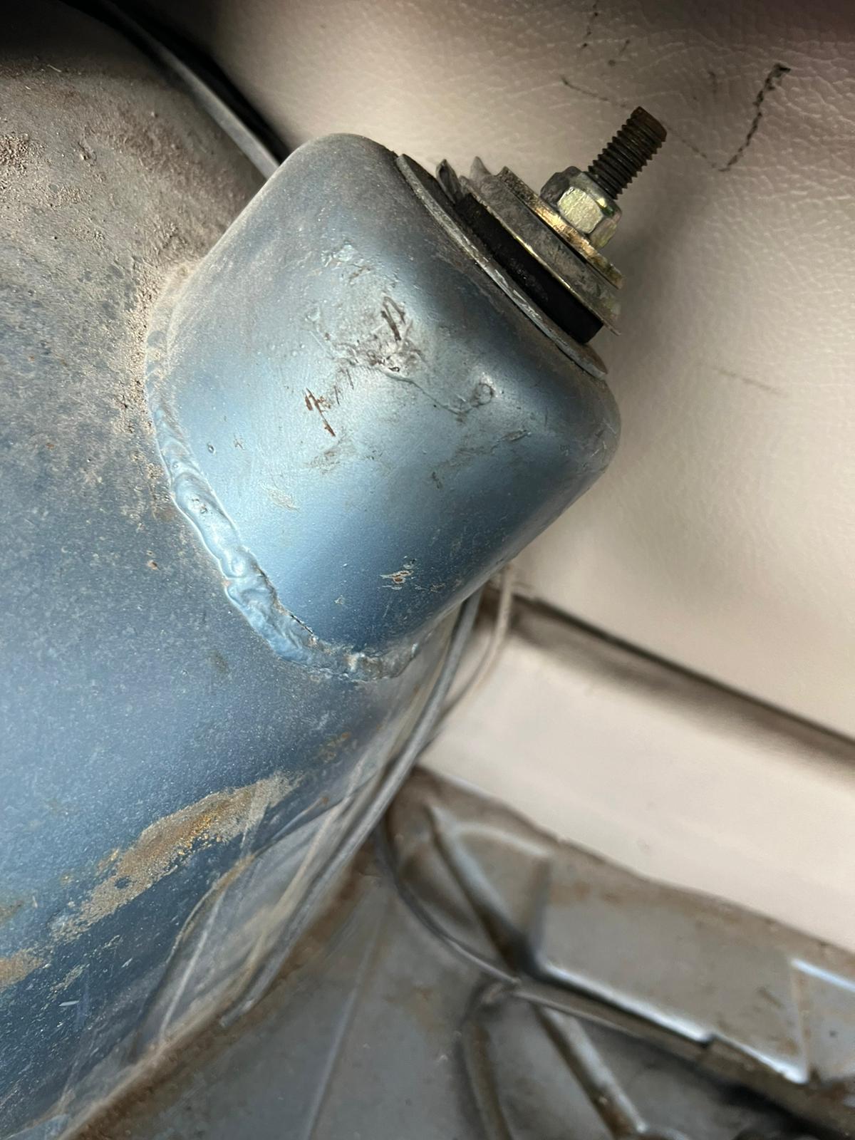

Paint has evolved and to some de-evolved over the past 15 years. All the formulas have changed with the changeover to waterborne paint and most are not correct to the original color/formula which is a reason why you see 6 shades of fjord when you go too a bmw meet.
The only way to match paint at this point is by color matching which means that you have to pick your favorite of the six shades you’ve seen and go with it. Colors have also faded over 50 years. Many think that they have a match from an original inner panel but that too has a degree of fade which makes it impossible to match to the original color.
You should always ask your painter to do a spray out before approving the final color.

Oh no- not color matching.
My pics show “pansy blue” for our cars and “silver blue for OP.
We have samples for David S. car that Pelly and Cain worked on and likely samples for our last 4 Fjord paint jobs all in Glasurit.
Maybe we can send one out?
