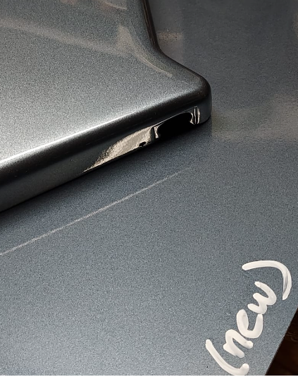

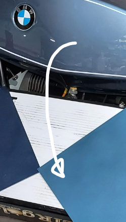

glasurit paint
waterborne gave a wrong colour using the old formula

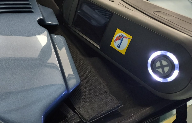

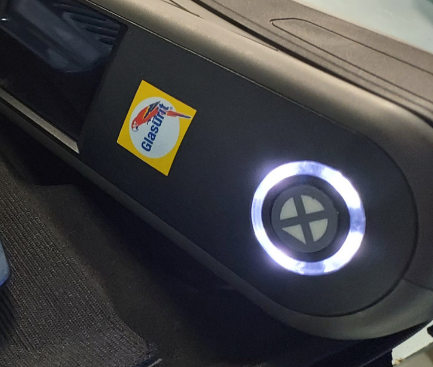

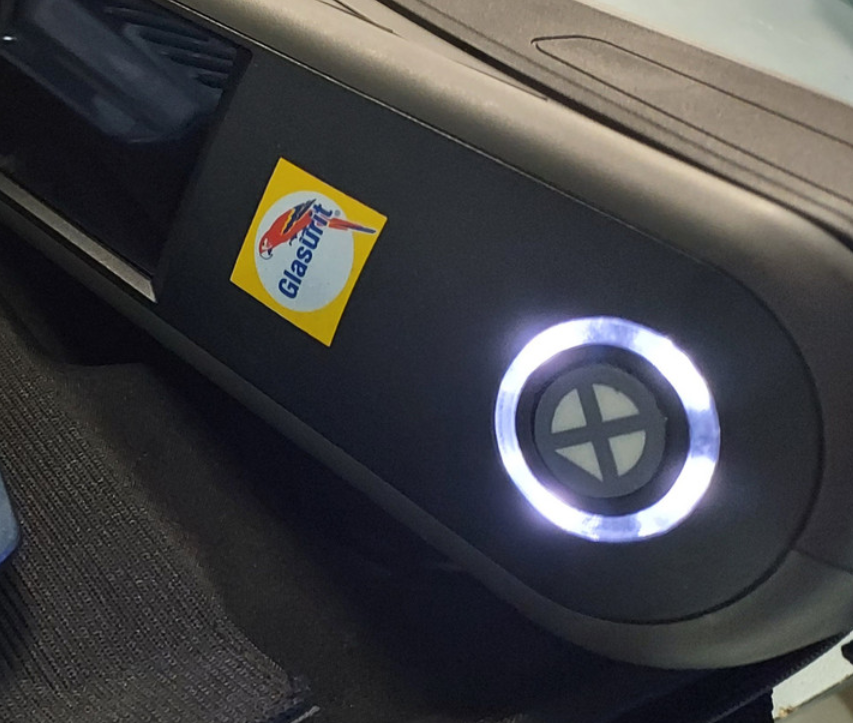

scanning he colour and reproducing it gave excellent result, anyway one more turn was needed to fix it to man’s eye

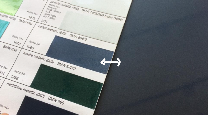

top, real 042 colour, well done in solvent original glasurit formula
below, waterbased same formula done by glasurit factory, result NOK
capture colour

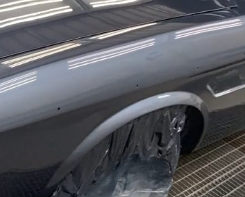

home testing in spray, waterbased, not bad when compared to solvent based piece (left top)
check book against water based formula

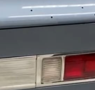

yes same colour in all the pics, light is a bitch !
