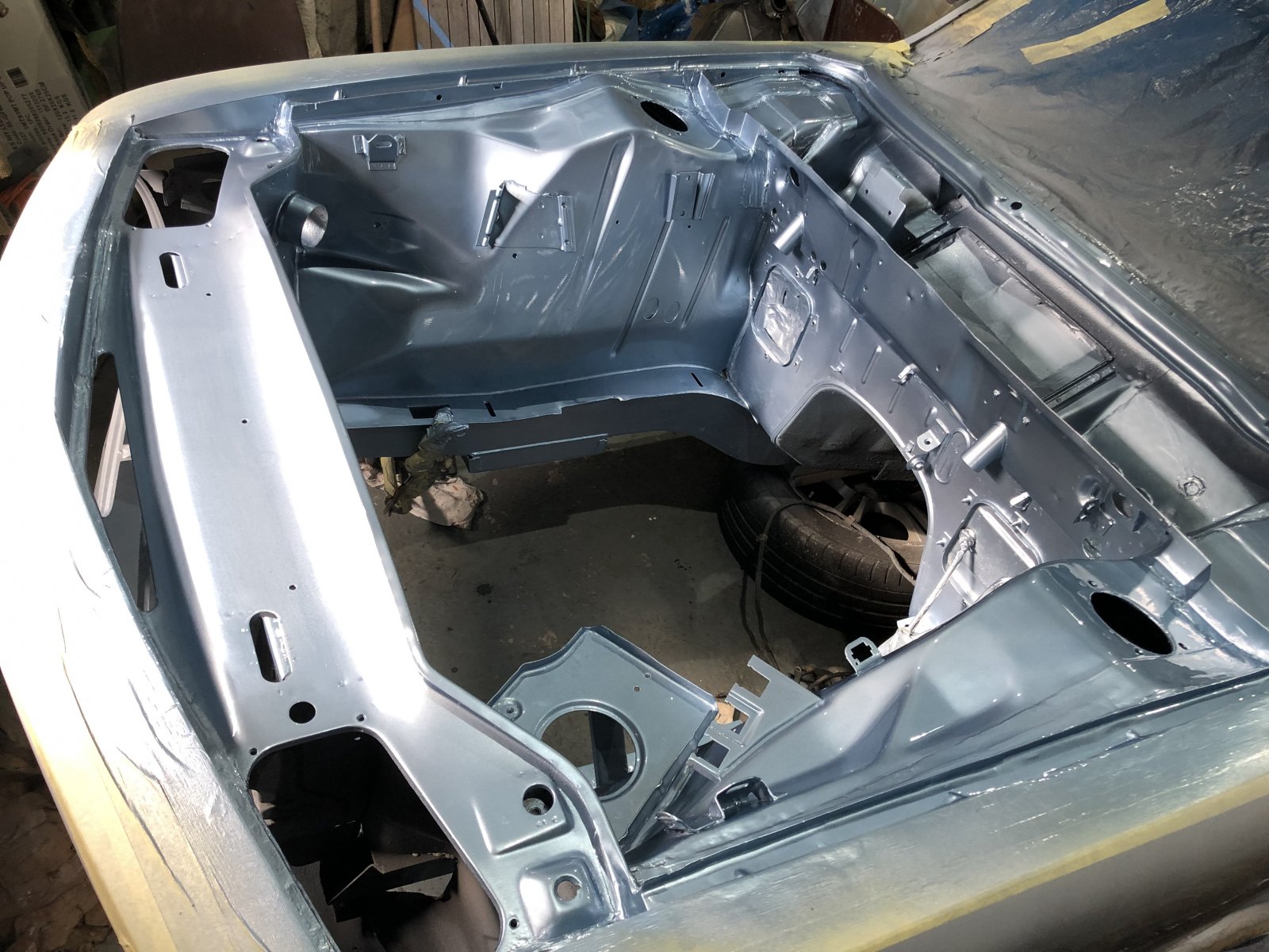

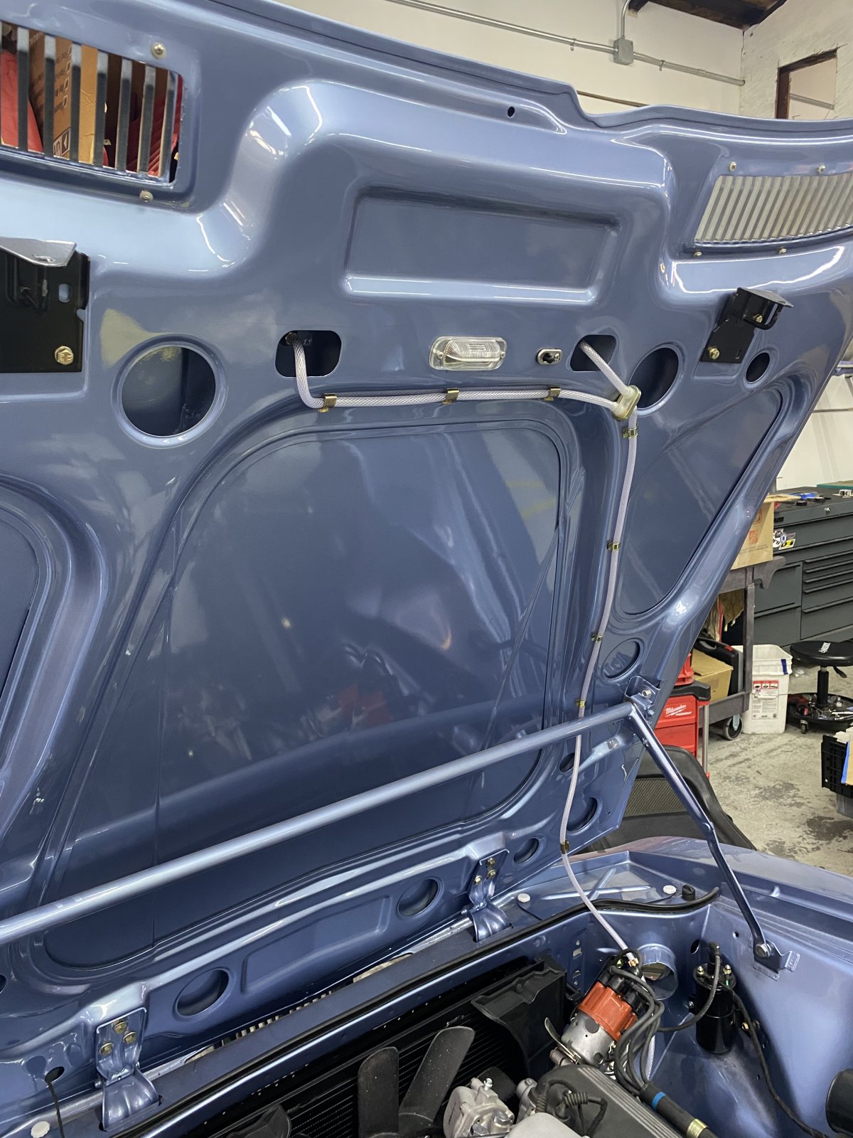

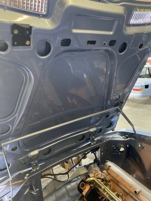

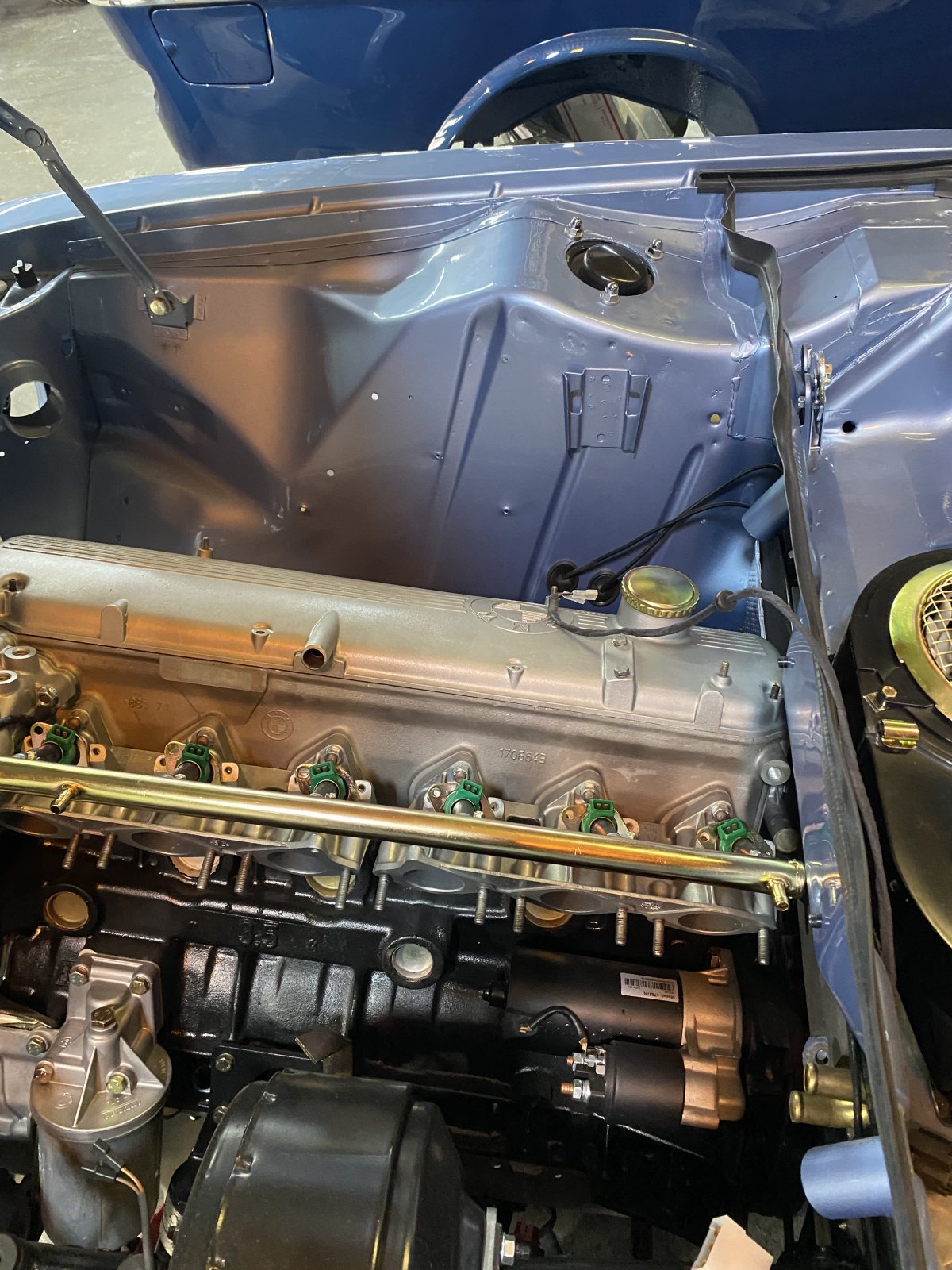

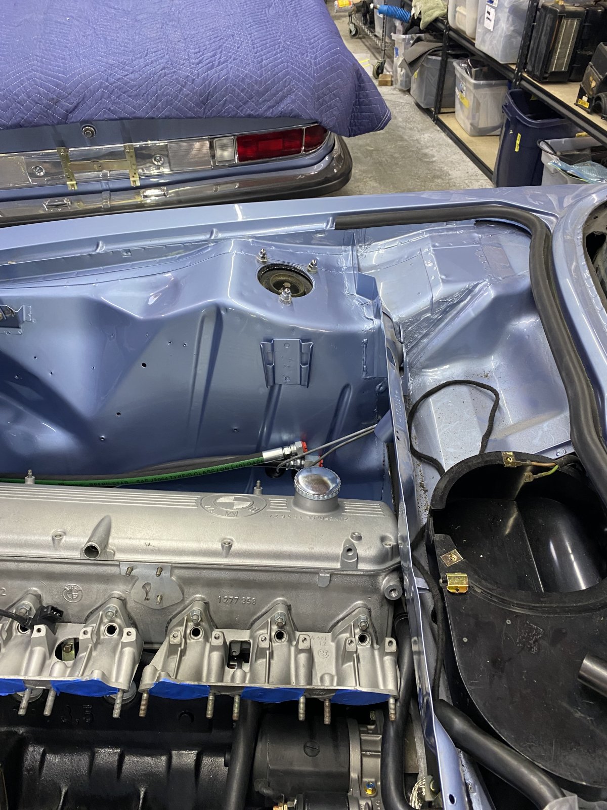

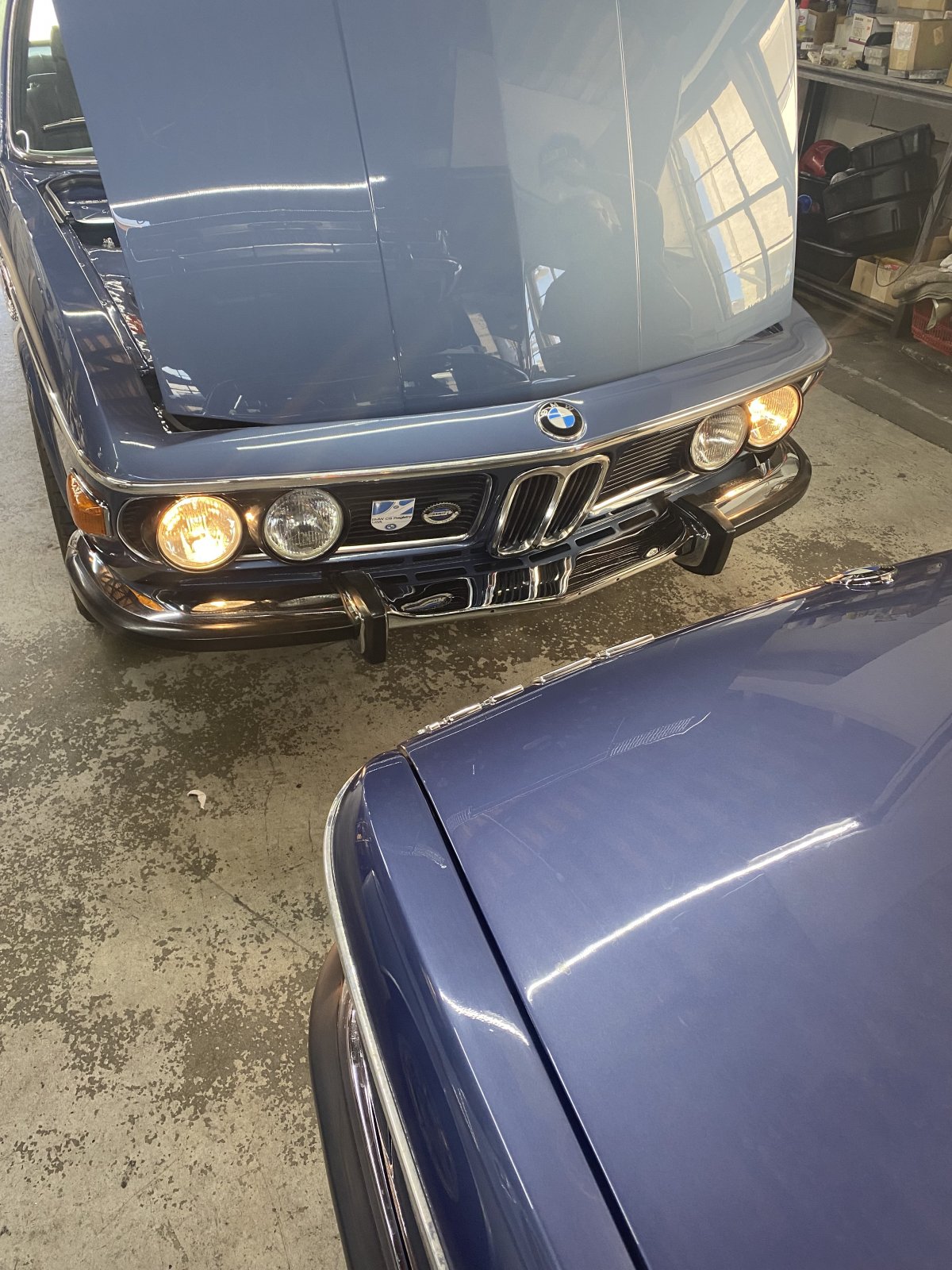

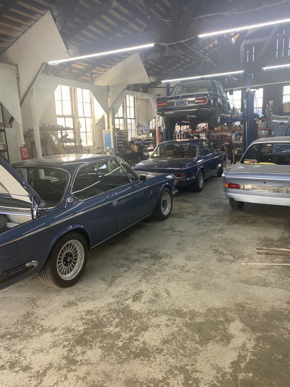

Here are 3 new Fjord paint jobs.
Look at the wild color differences on the same body panel…

The colour difference is really evident alright, I suppose the angle of the panel to the light source is probably causing it.
Beautiful work by the way !!!
Well good for you on pushing yourself and doing things yourself. I hear you on the eyesight and led lighting. You can do a good scuff and repaint. It's not the end of the world. Good luck on the color match!

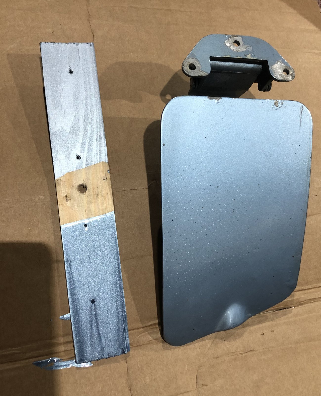

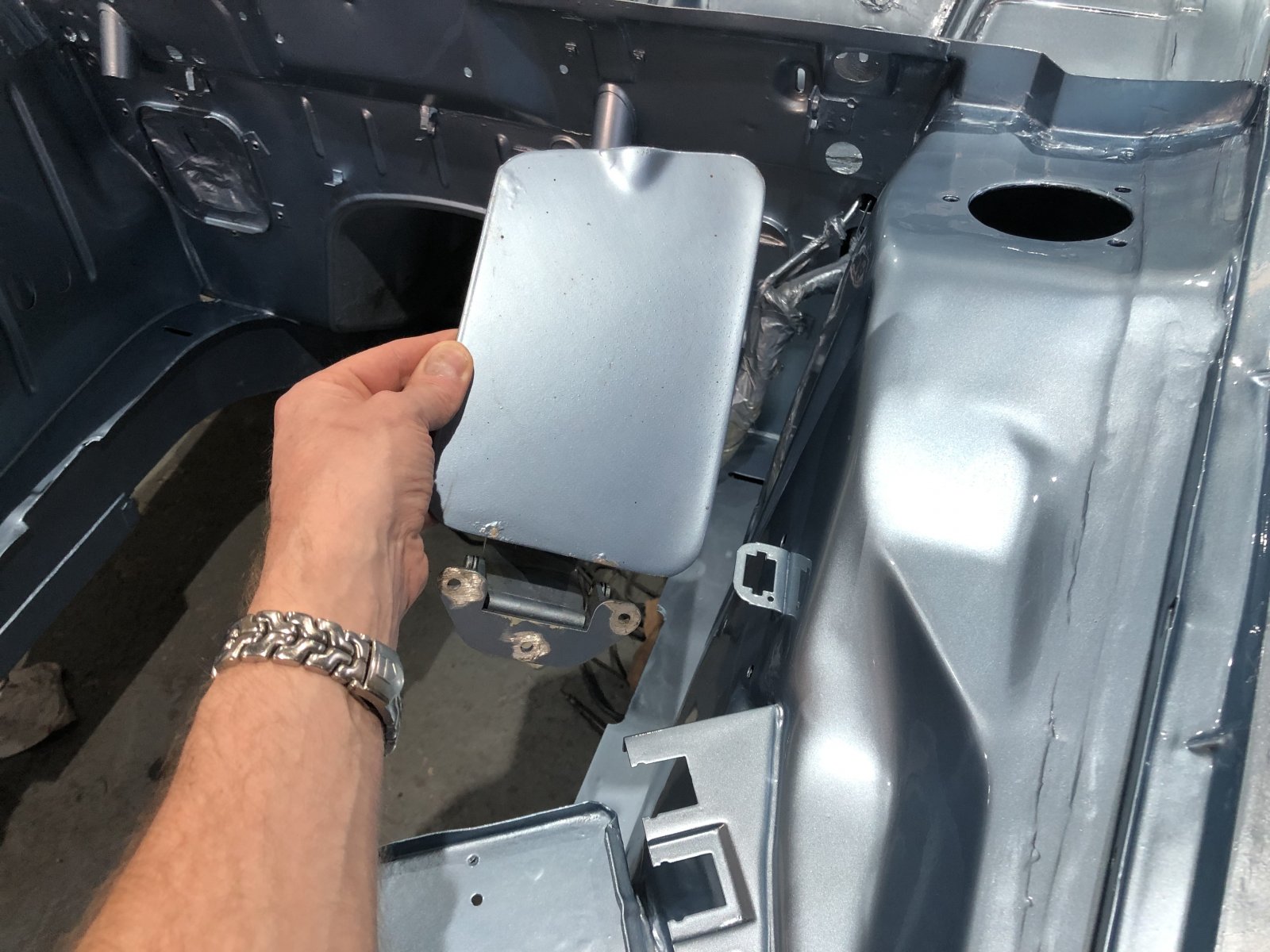

Okay

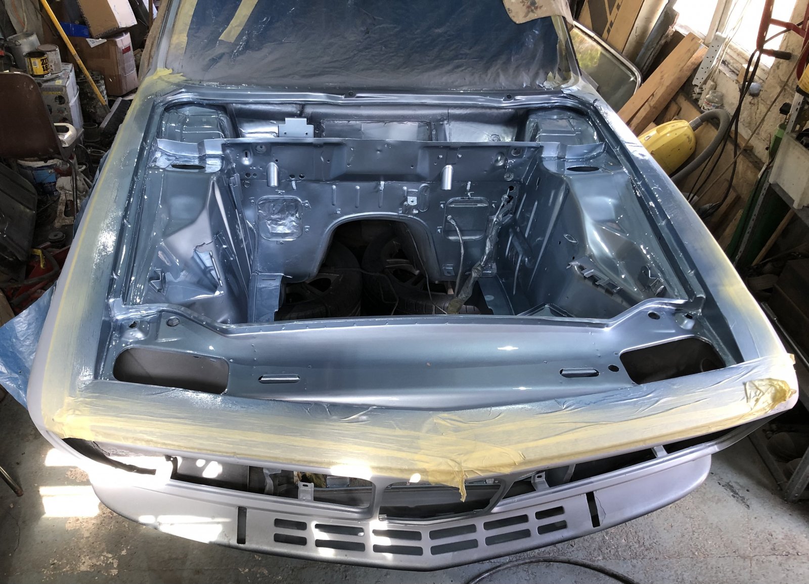

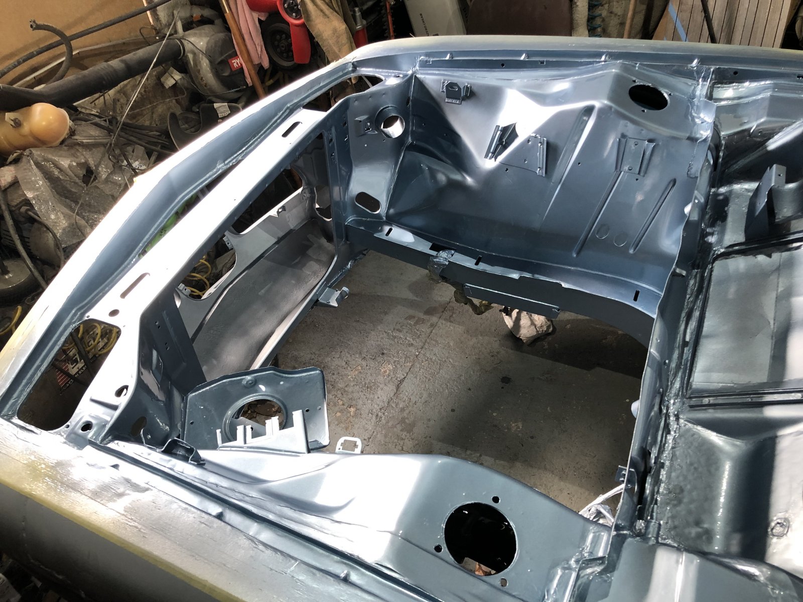

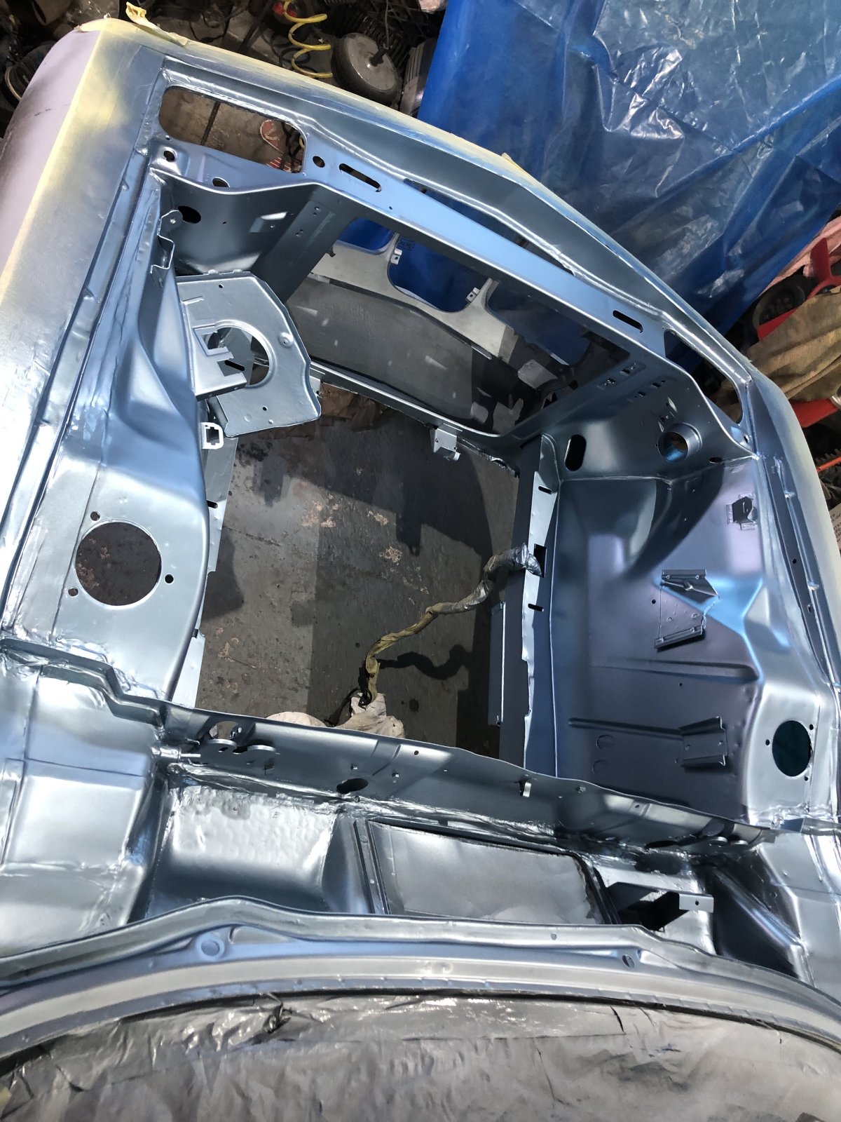

So I got more paint today on my way home from work and I re - prepped the engine bay this evening.
My plan is to lay down a few coats of colour tomorrow
And then hopefully get the clear coat on before the weekend.

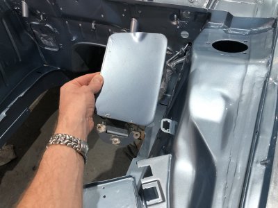

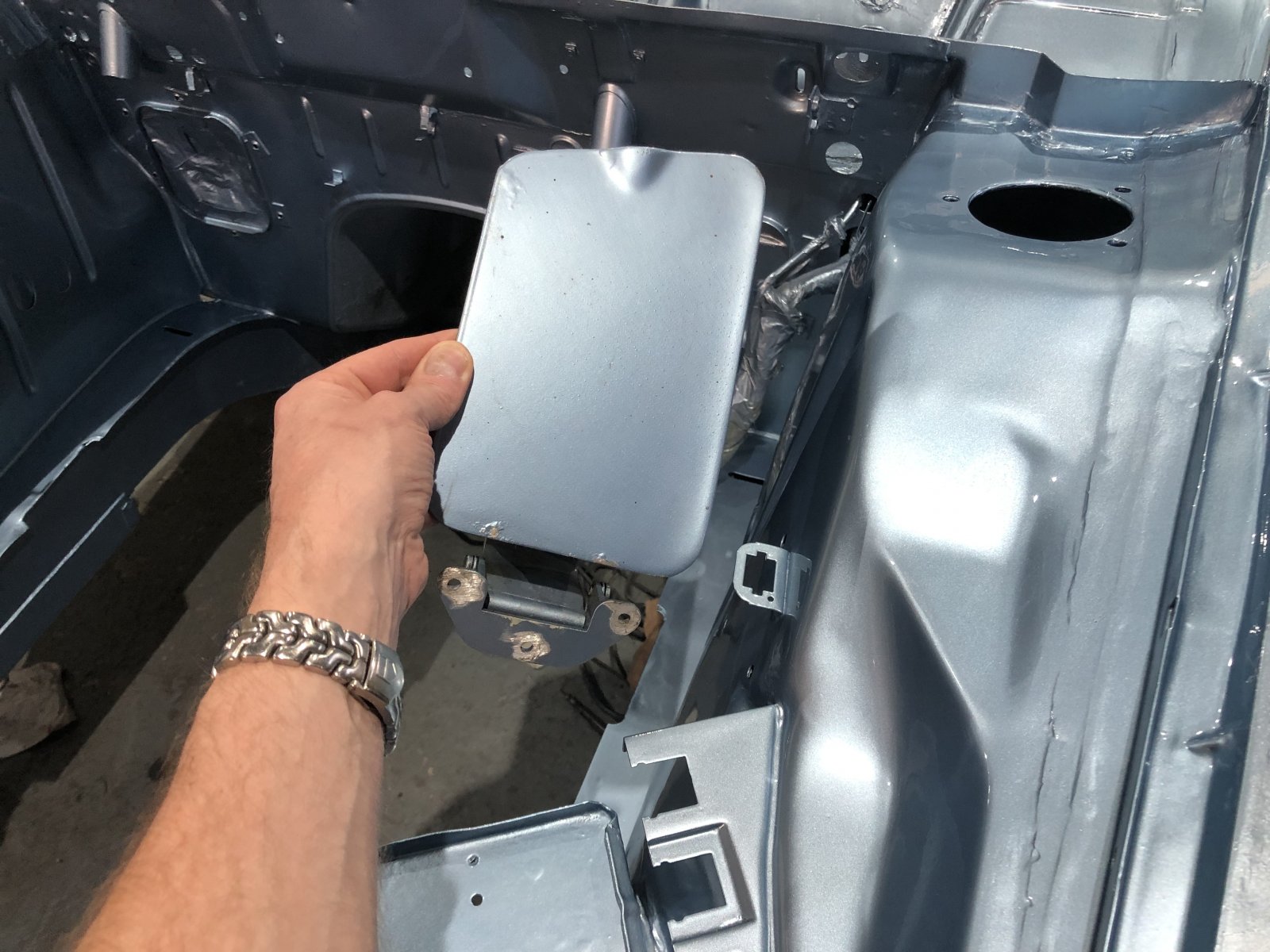

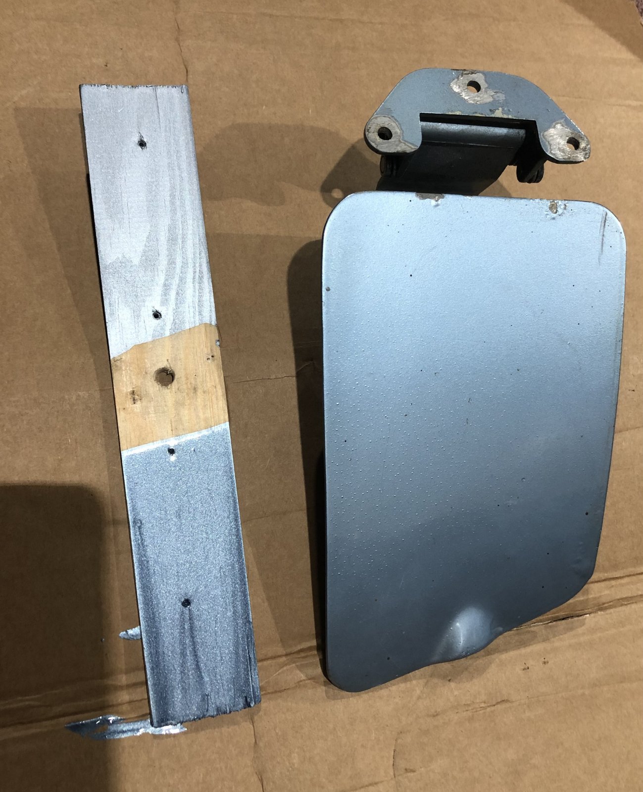

I have attached a photo showing the old “incorrect “ fjord blue and the newly bought fjord blue , it’s obviously only on a stick at the moment but it’s definitely a better match to my fuel filler door than before.
Fingers crossed that it looks better this time.!!!

I had an issue with Polaris for my engine bay that came down to metallic size. I also recently had some Porsche Minervablau base coat mixed up and in one line (Matrix), it looked very similar to what you got the first time. The final was much better color wise but metallic size was off compared to the original but it wasn’t critical on that project.
I’d be much happier with what you got this time.

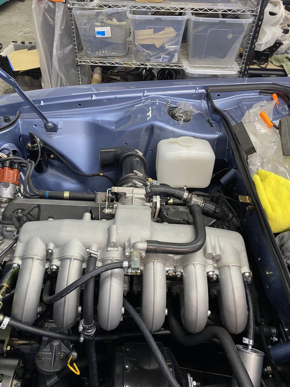

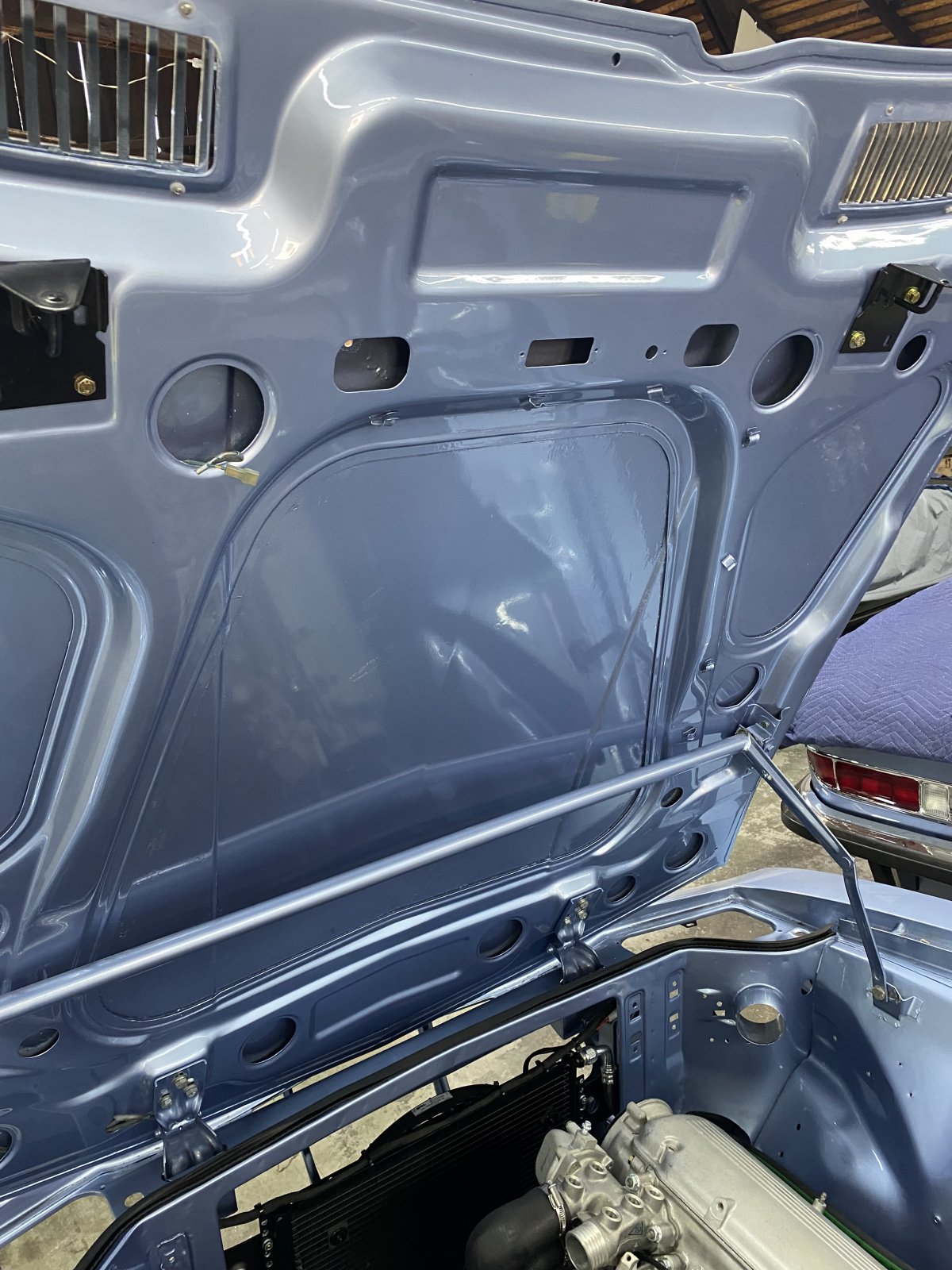

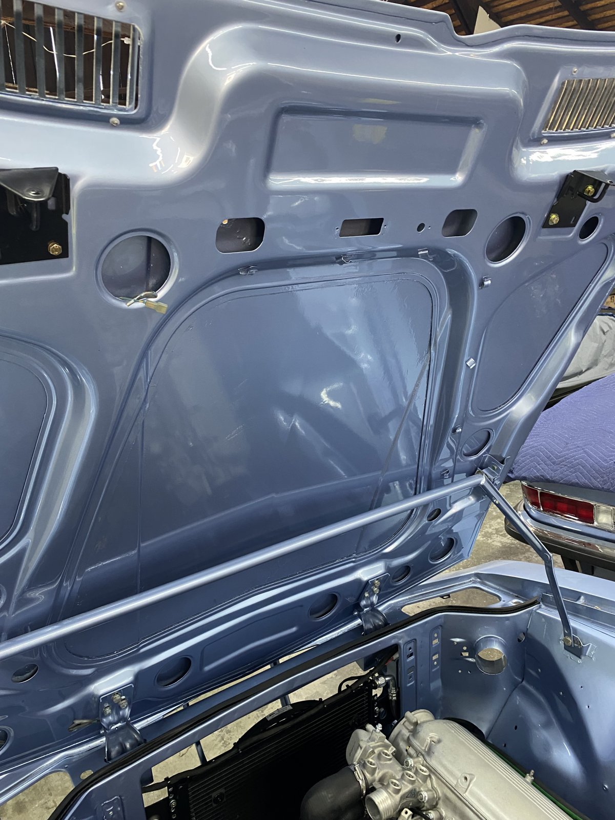

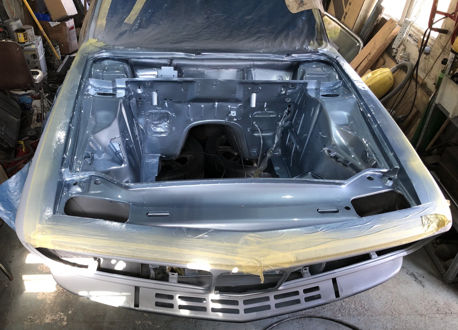

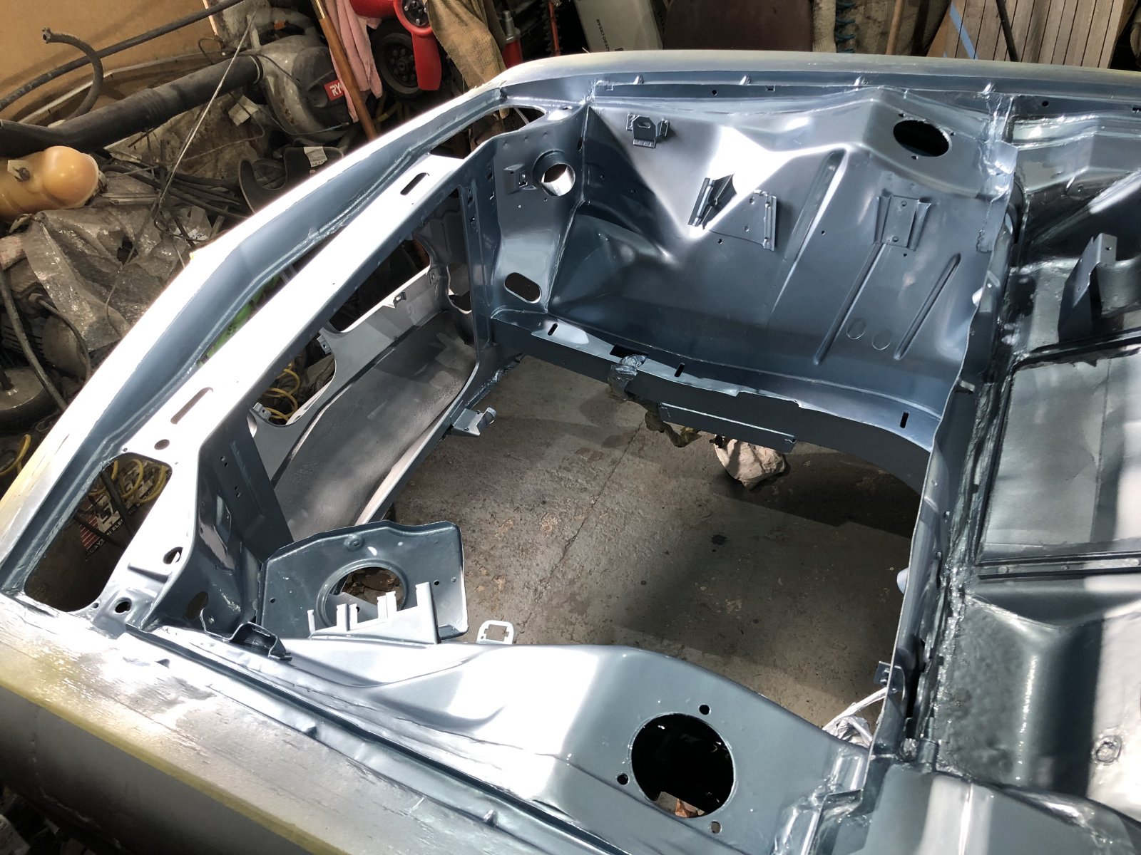

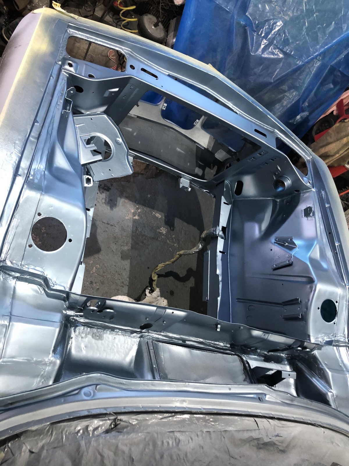

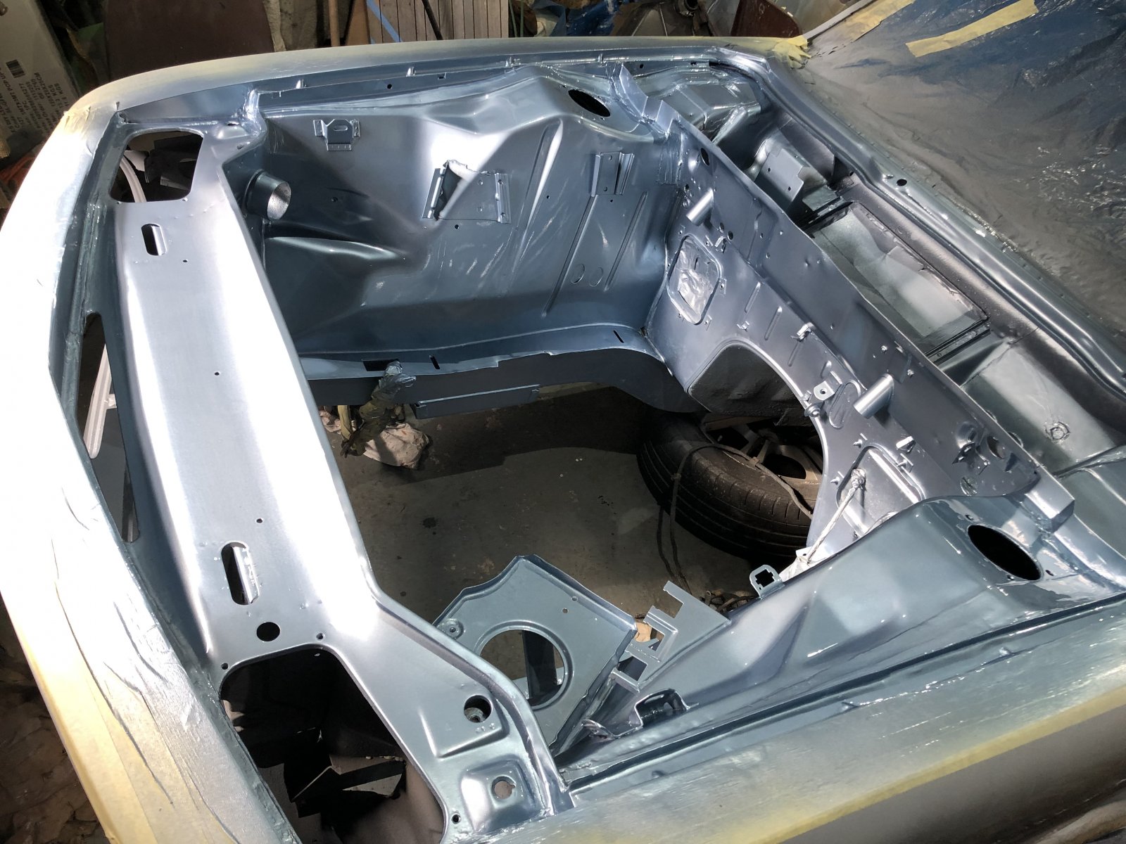

Hi guys
I am back on track , thankfully once I actually admitted to myself that it was the wrong colour, fixing it was easy enough.
I am delighted now that it is correct, I would never have been happy with it as it was .
Anyway thanks again for all the advice help and support
It really helps a lot !!!

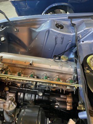

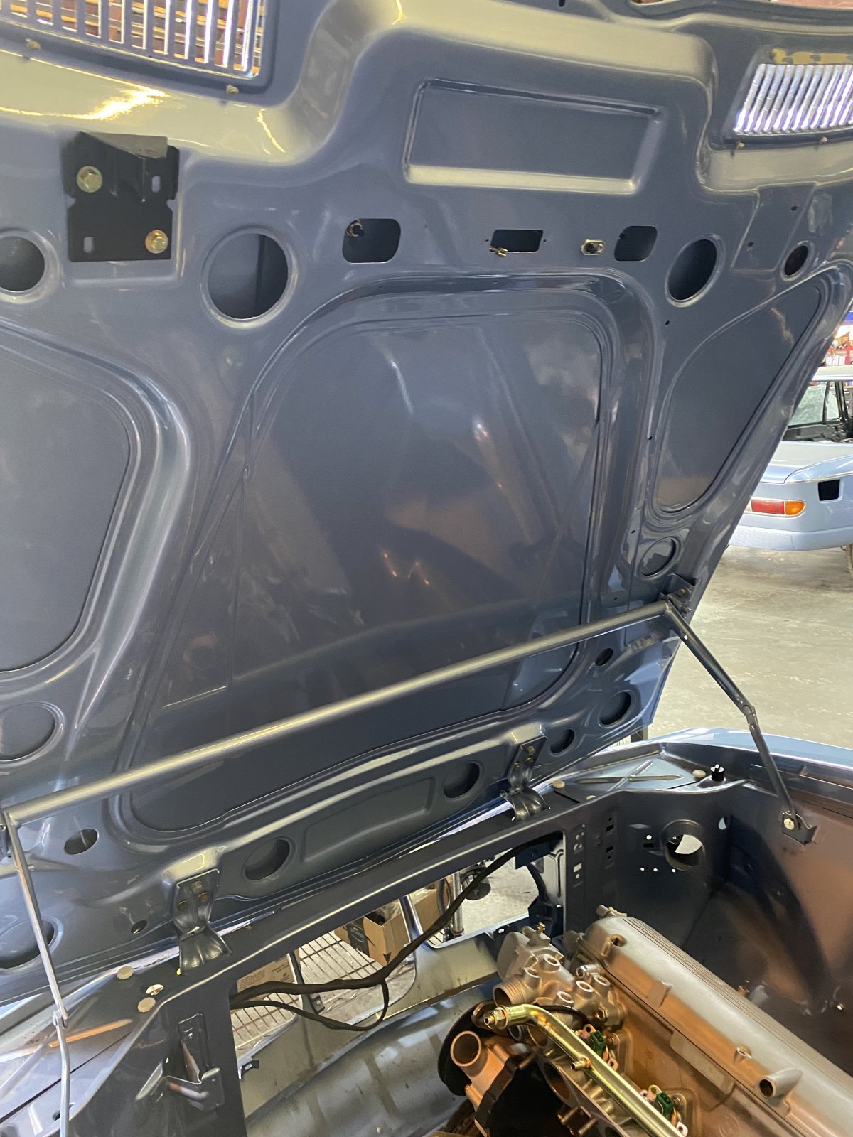

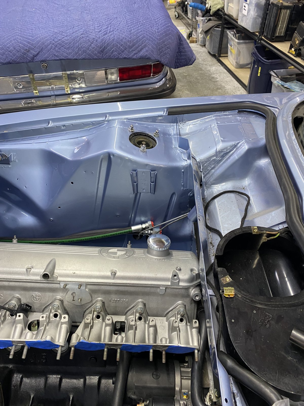

There are 2 coats of the new colour on it and 3 coats of clear , it’s actually a bit hard to get a proper photo of it ,it’s too glossy to capture it properly. but it does look nice when you are standing here beside it .

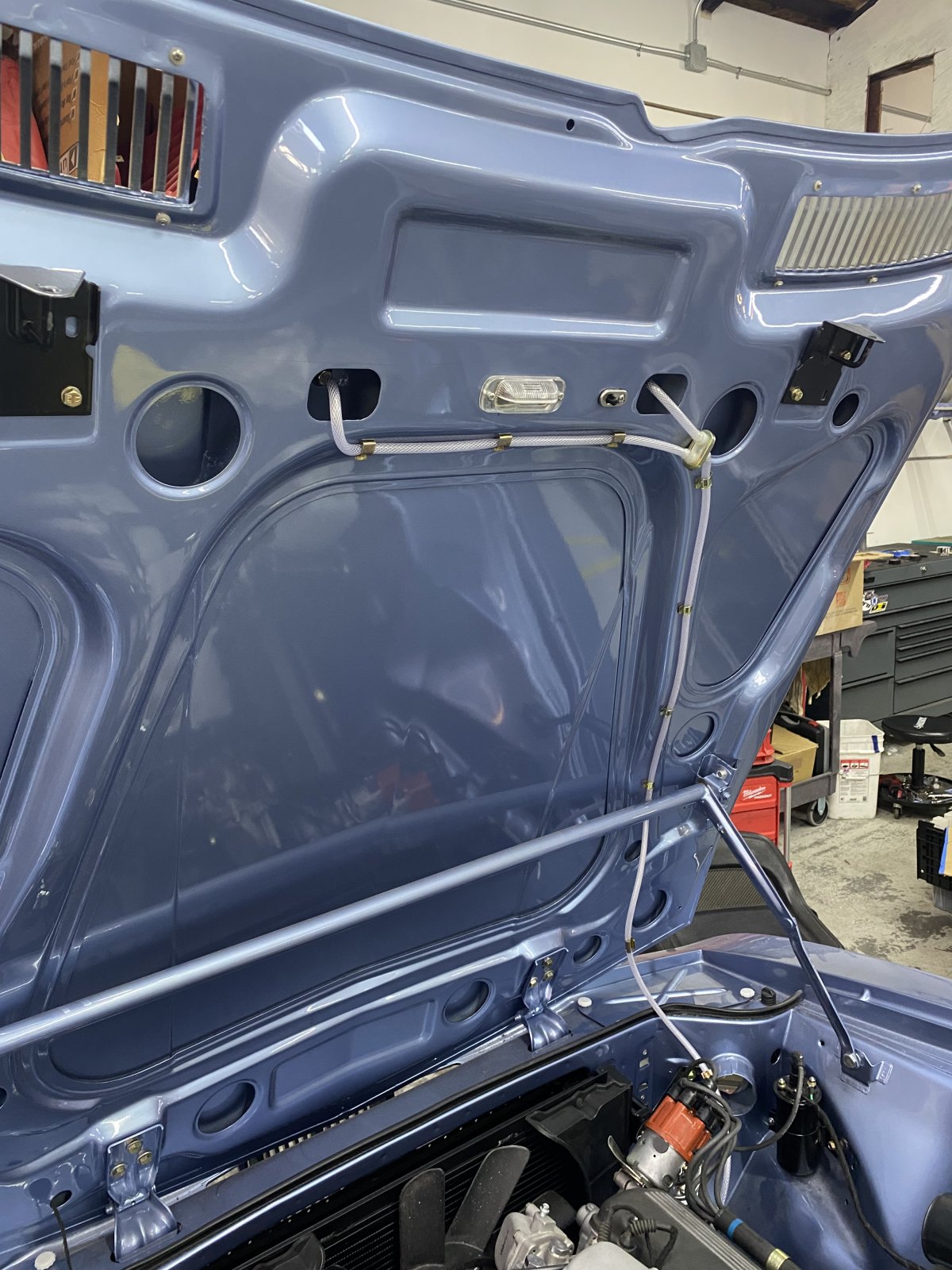

This is what she looked like back in February
So I’m happy now .
I am looking forward to bolting some stuff back in now :)
