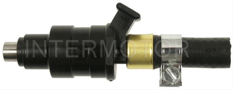

Just to (hopefully) wrap this post up. I missed Don's post above at the time (thanks again Don ) but subsequently heard back from Standard Motor Parts who provided flow rate spec etc which was virtually identical to Bosch OEM . Their injector ( made in USA ) is FJ118 and I bought a set via Rock Auto for about 1/3rd of cost of Bosch. Have done a few hundred KM's so far and all good.

Q:What car This FJ118 is suitable?
My car is 1972 BMW 3.0CSL. It is using BOSCH 0280150003.
Do you have a table for me to check whether FJ118 is suitable for my car?
Asked by SHU PUI on January 25, 2018
A:
Thank you for your question. The Standard Motor Products FJ118 fuel injector will not fit your application. Unfortunately, at this time we do not offer a fuel injector for your 1972 BMW 3.0CSi.

Seller says it won't fit csi, but it fits a csl ?????

Same thing, from my understanding... @sfdon can confirm.
