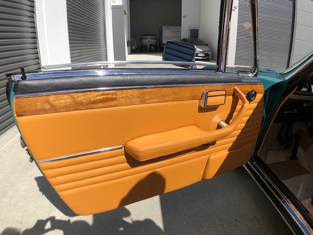

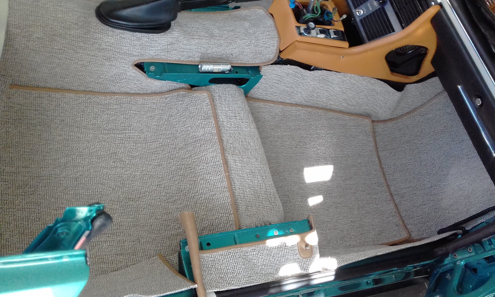

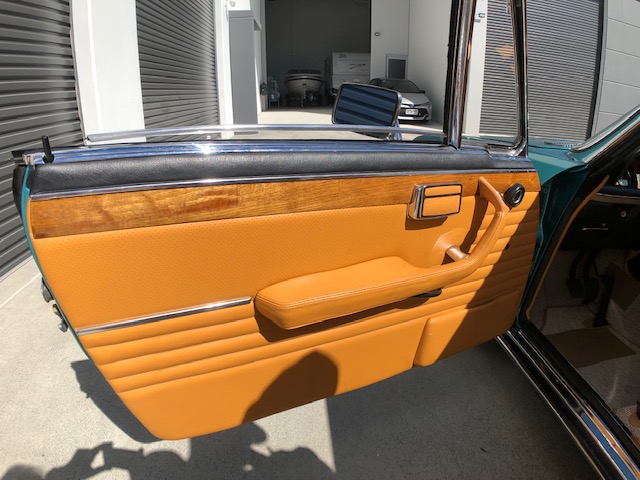

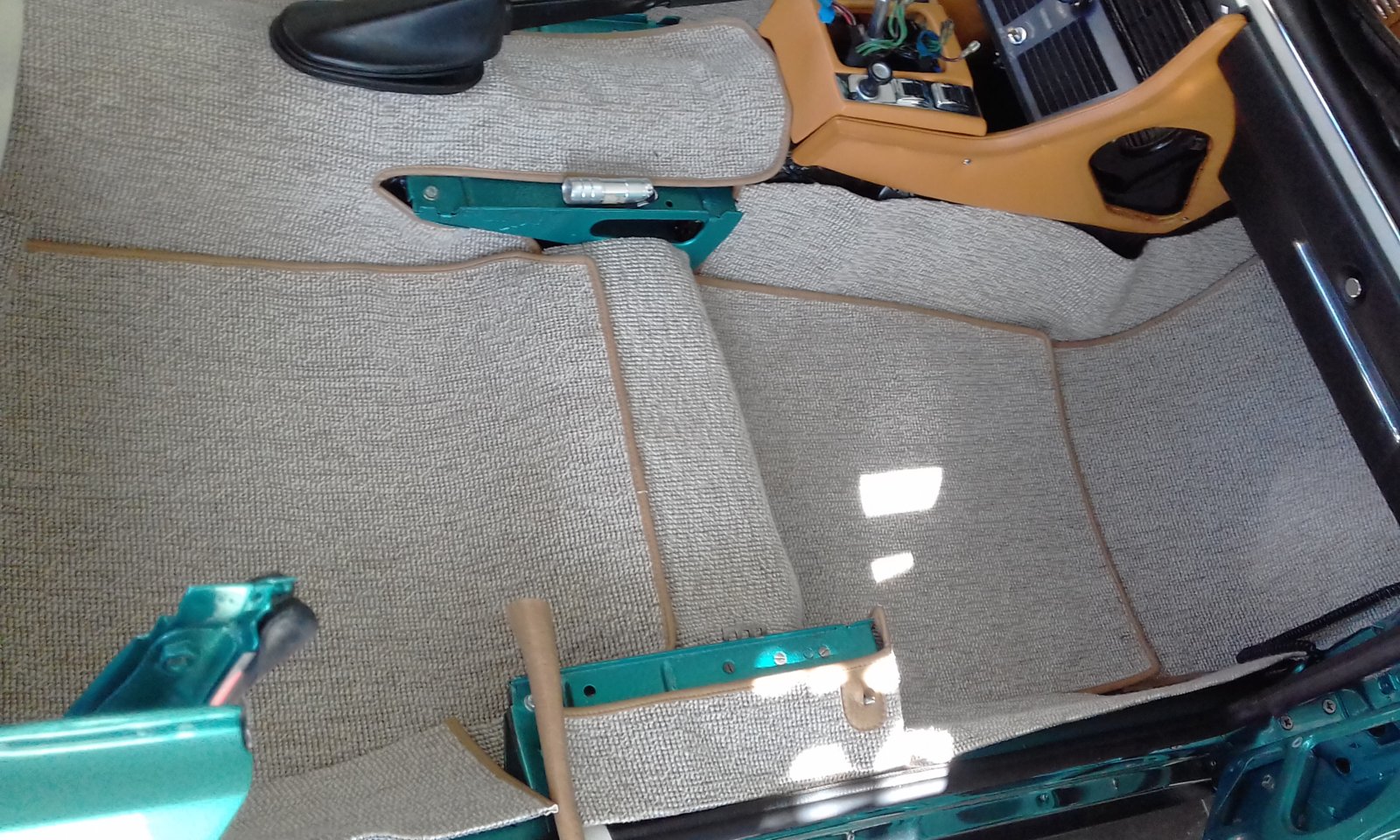

Well I went a little different than standard........for carpet I used German Square weave from KHM colour Bouncle Oatmeal....simply because I have the same in my Pagoda roof Benz. Leather I went top shelf German Napa. I thought the original E9 colours were a little stale.......just my thoughts.
Regarding soundproofing I had the whole area floor inside and out Rhino Painted including trunk and inside of roof then dynamated the whole lot except trunk. I doubled up on the firewall with dynamat..........I hear absolutely no road noise at all in the car and no engine heat whatsoever.:)
View attachment 96779View attachment 96781
Hi do you have a colour ref for the leather it looks amazing

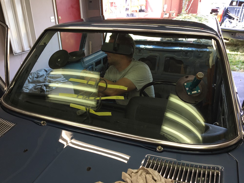

  • Planning to pull the windshield, it is pitted and I know what a difference a fresh windshield makes.
    • I have seen videos of people polishing the glass, but has anyone tried it? If so, results?
I have polished wiper marks, haze and light scratches out of windshields with Eastwood's kit. I got good results. It takes A LOT of time, however. You can't go fast or you can generate too much heat and crack the glass. If you can catch the scratch or pit with your finger nail, you are probably not going to polish it out.
Eastwood does make a heavy duty polishing kit also. I have not tried this one.
I don't know how available and how expensive a new windshield is for an E9, but my glass guy got one for my E3 for $200 delivered. I wouldn't consider trying to polish one at this price.

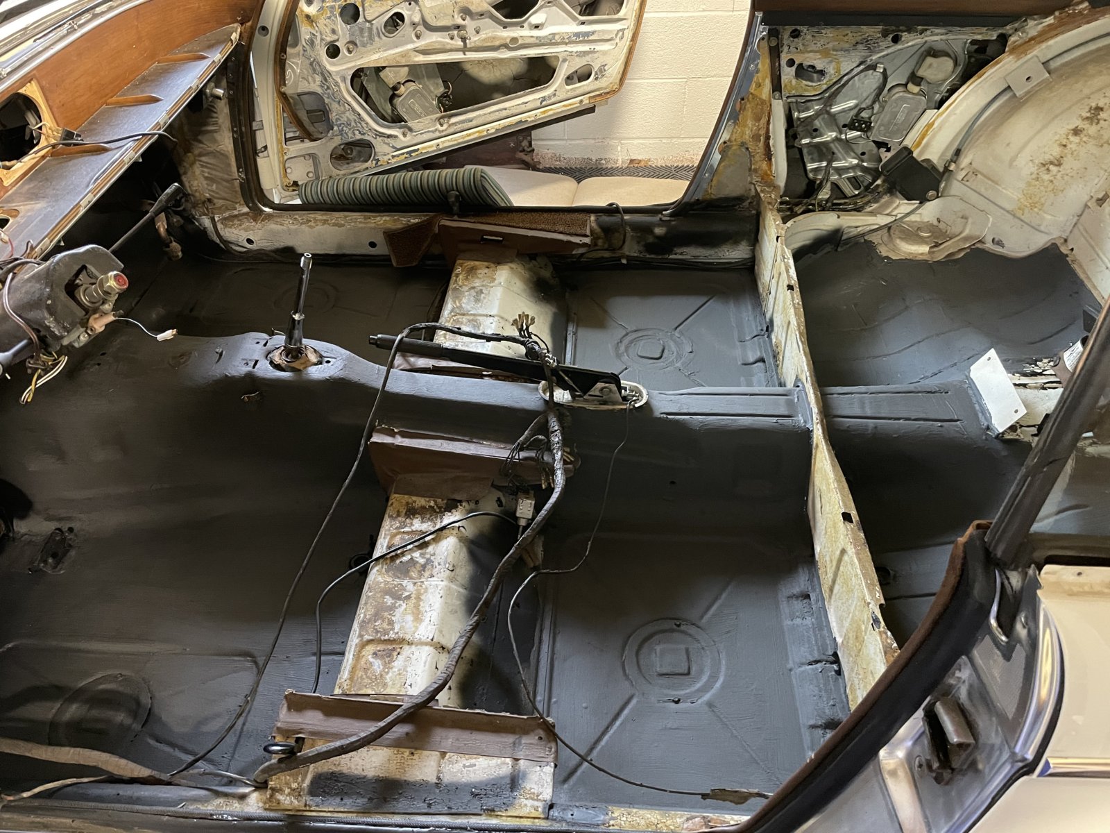

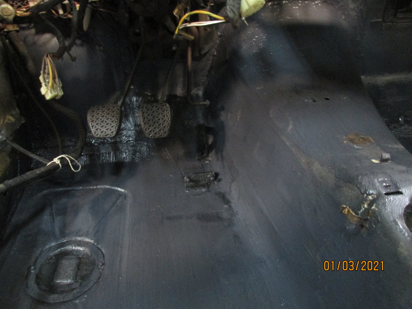

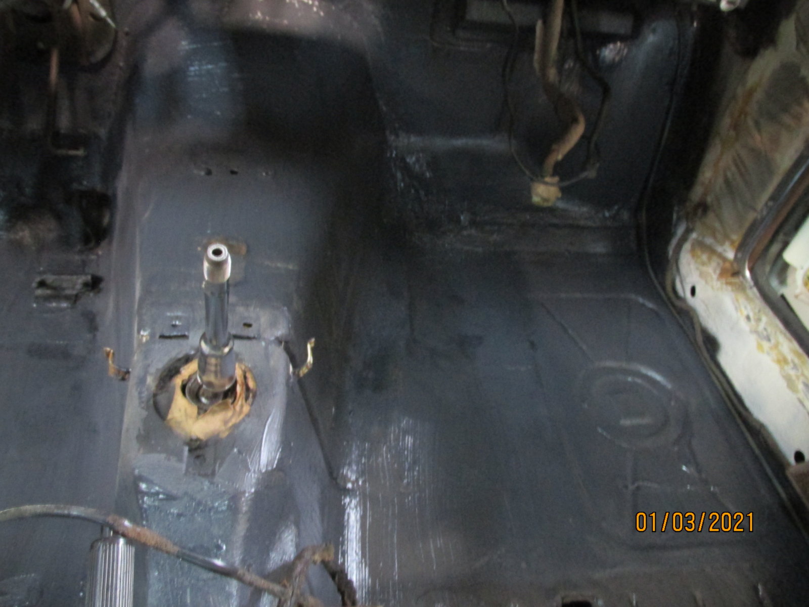

I have been planning for the interior refresh, with new wood, upholstery and carpet this winter, and did kick the project off in late November.
All of the parts above have been removed, and I am pleased to report that there were no serious rust issues in the floor or firewall. The coupe’s original owner (I have all the maintenance records going back to 1973) spent about $22k back in 1991 having the rust remediated and the work has held up well.
I removed (chiseled) all the original asphalt and tar sound deadening material, ground surface where any light rust existed and coated with rust encapsulator (Eastwood) and now have applied the first and second coats of Second Skin Firewall ceramic coating on the firewall floors and tunnel.
Following the advice on forum I removed the boxes for the evaporator and the heater core so I could do some work on both. I am looking for a source to re-core the heater (if needed) and the radiator (I can see where it has been weeping in the past). Also planning to send my dash out to be recovered.
As you can see from the pictures, the windshield is out, and I was pleased to find there was no rust in the body under the windshield. There was a very small spot of surface rust in each corner that I will wire bush and use the rust encapsulator as it is really only surface in nature.

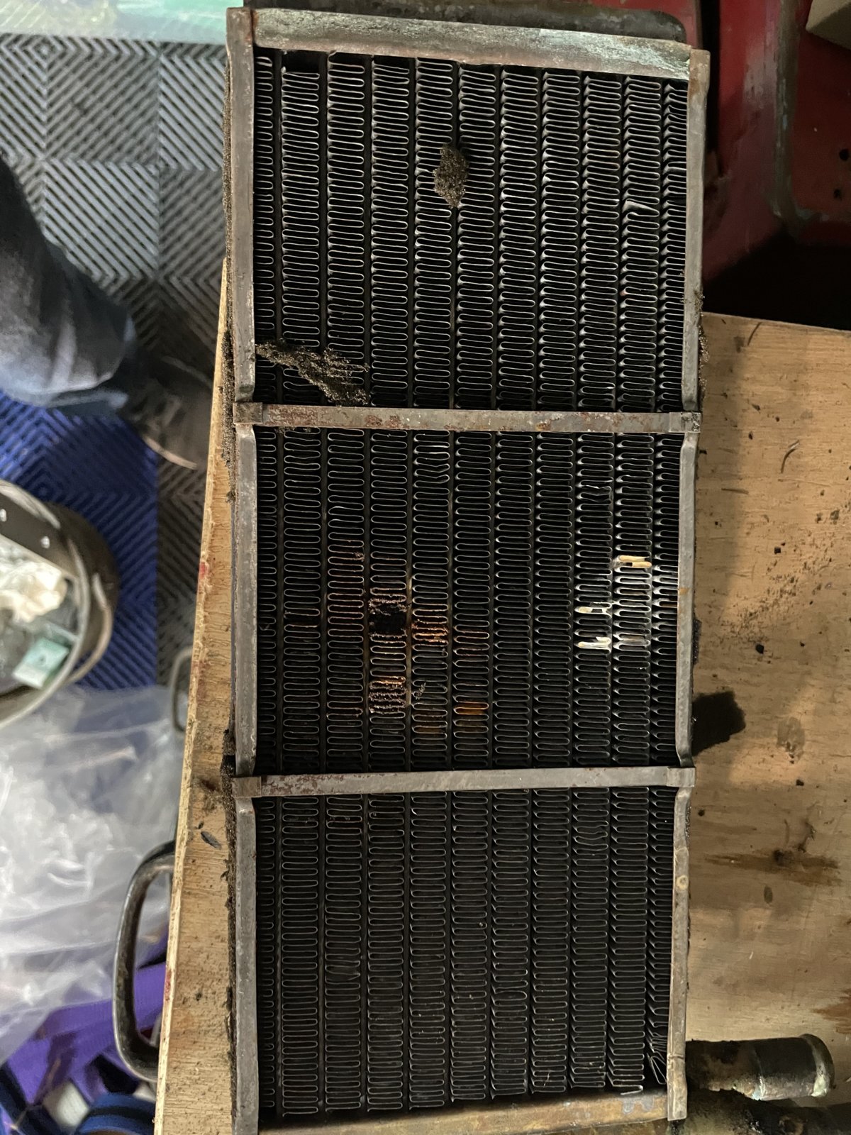

Agree, already have the expansion valve and was planning W&N for the glass and gasket. I cracked open the heater core box tonight and found this...
Are replacement blower motors available?
