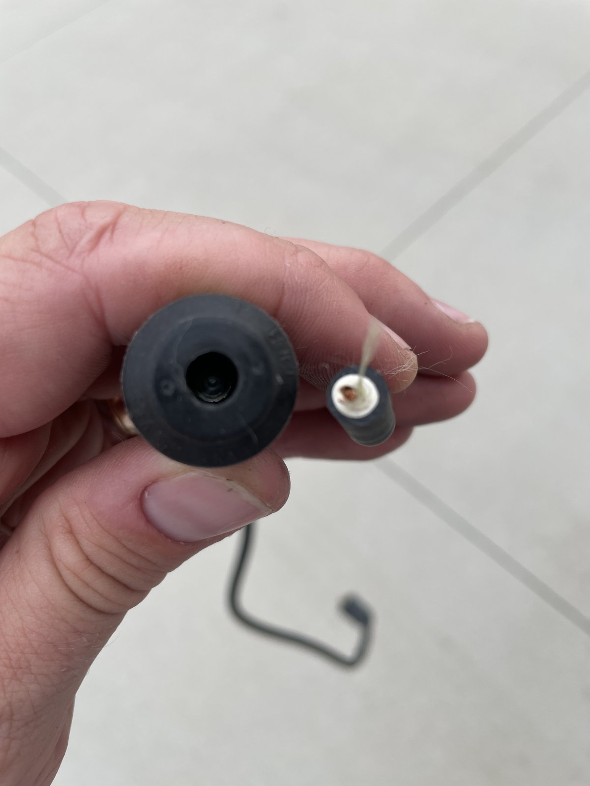

I decided to recheck the coil, and when I pulled the coil-distributor wire it came apart. Could it be this simple? My previous luck in life says no, but maybe it's time for a fresh start lol!

The new ignition wire from coil to distributor did not solve the problem. Still cranking but won't fire up.

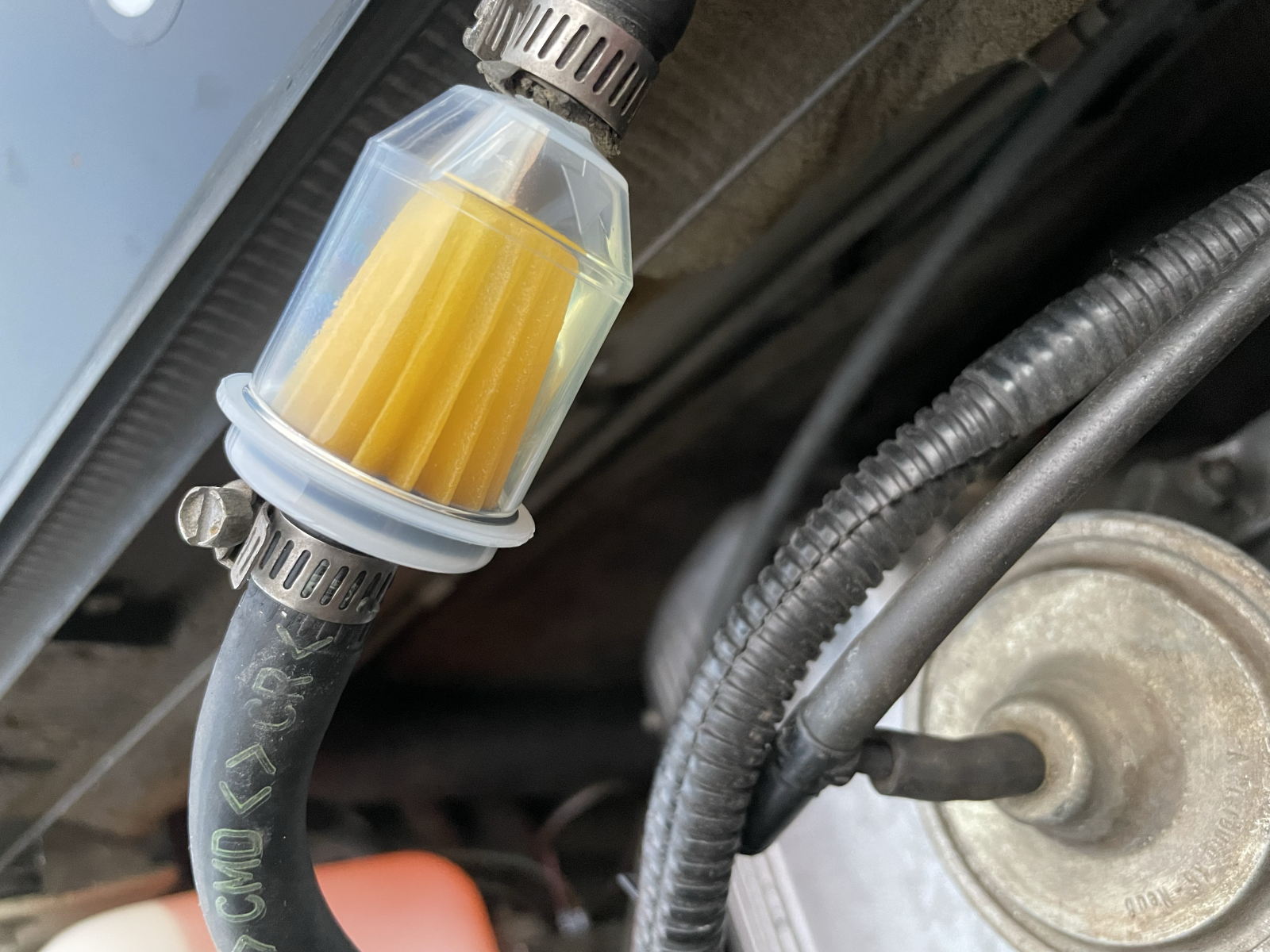

Just for fun, I installed a clear fuel filter near the firewall where I could see it. After a few cranks, I only got a few drops of fuel at the filter.

So you have spark from the coil? When my Chamonix wouldn’t fire after I replaced everything but points which looked good, it started after I replaced the points. The fuel filter will never have more than a tiny amount of fuel in it.

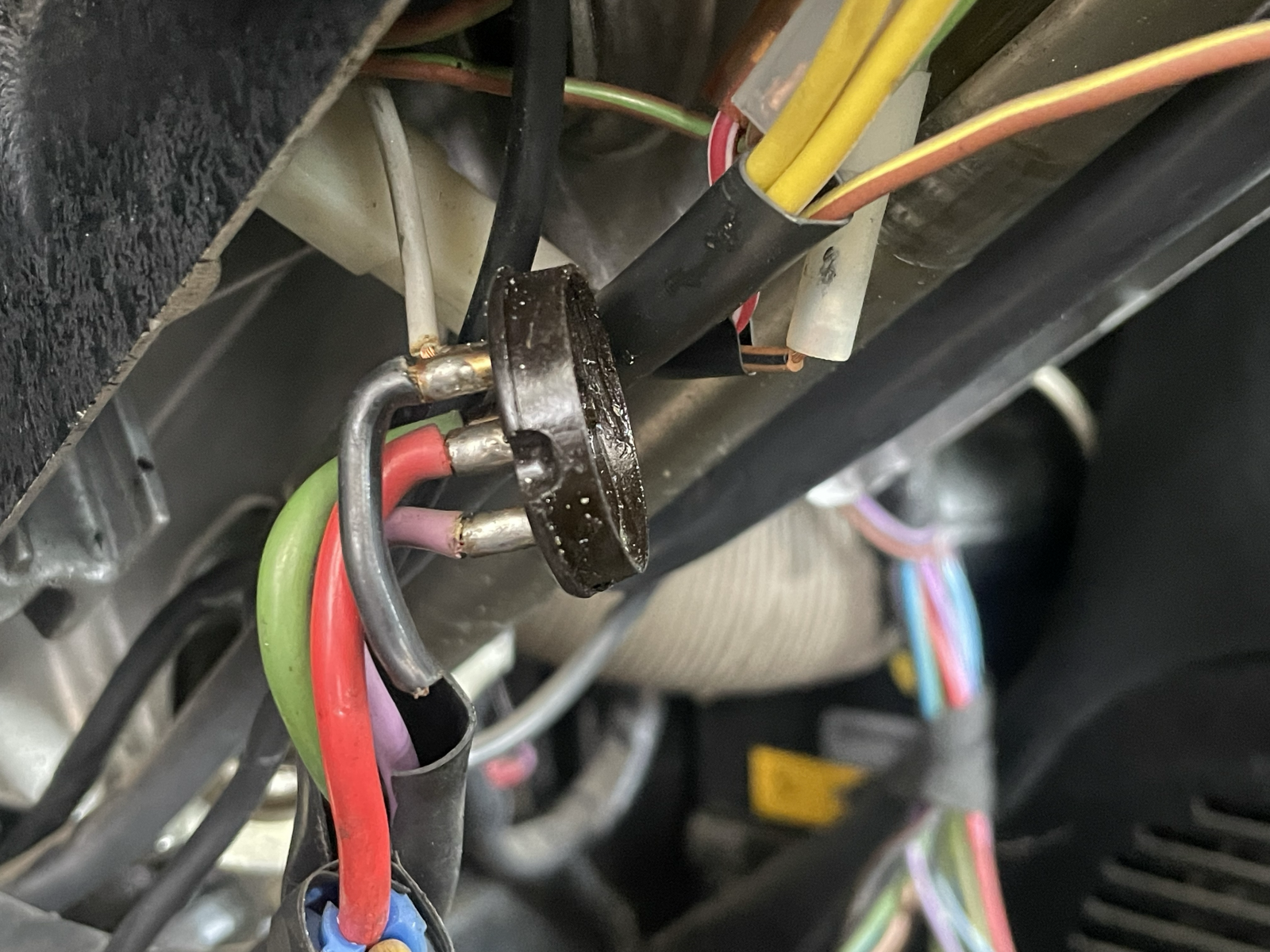

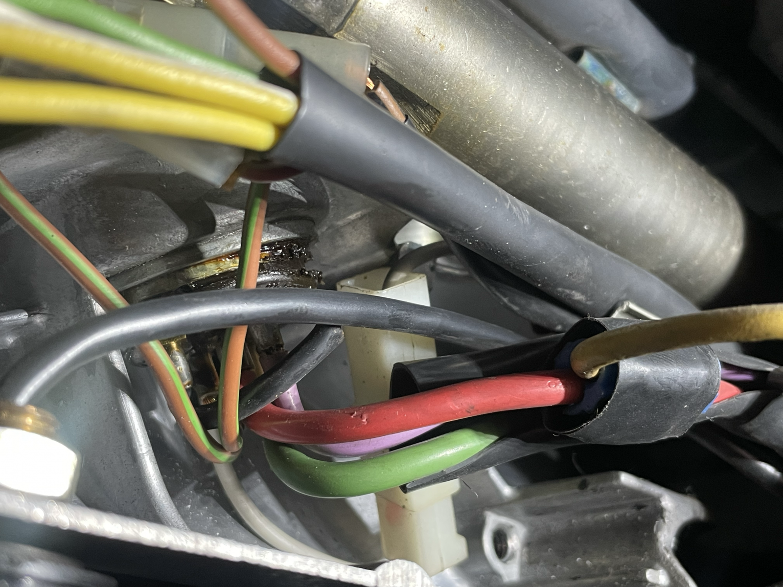

I dropped the underside of the steering column to check the ignition switch. Looks like mine is coming apart.
My ignition switch was in two pieces and likely held together by the harness and the bottom cover of the steering column. Dash lights were going crazy as I fiddled with it so I pulled the battery. A small copper piece also fell from the switch as I investigated- I'm hoping this bad switch can explain the intermittent running issues as well as the strange results of the recommended testing.

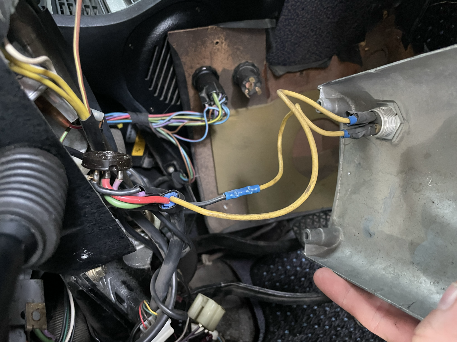

To make things more fun, a previous owner wired in a start button off the ignition switch. See attached.

Going back to post #22 and the broken wire from the coil to distributor- the new replacement wire was also junk. The new wire was from a Karlyn/Bremi kit. Once a second new wire was installed, the car fired right up.

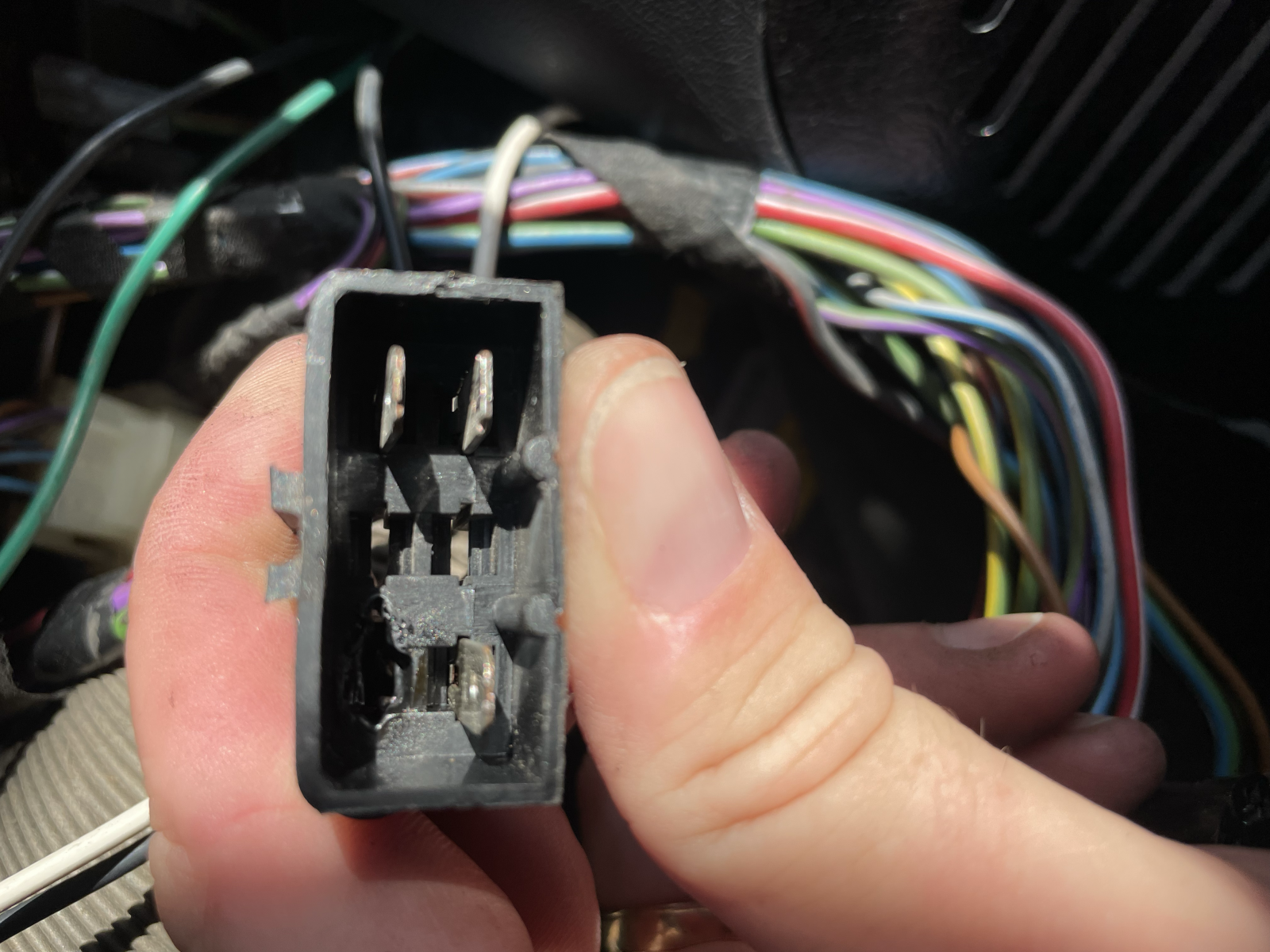

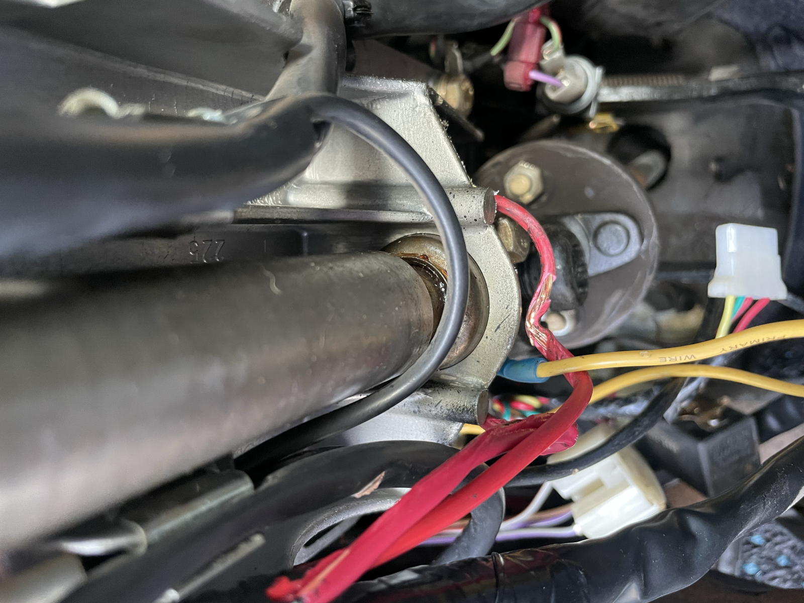

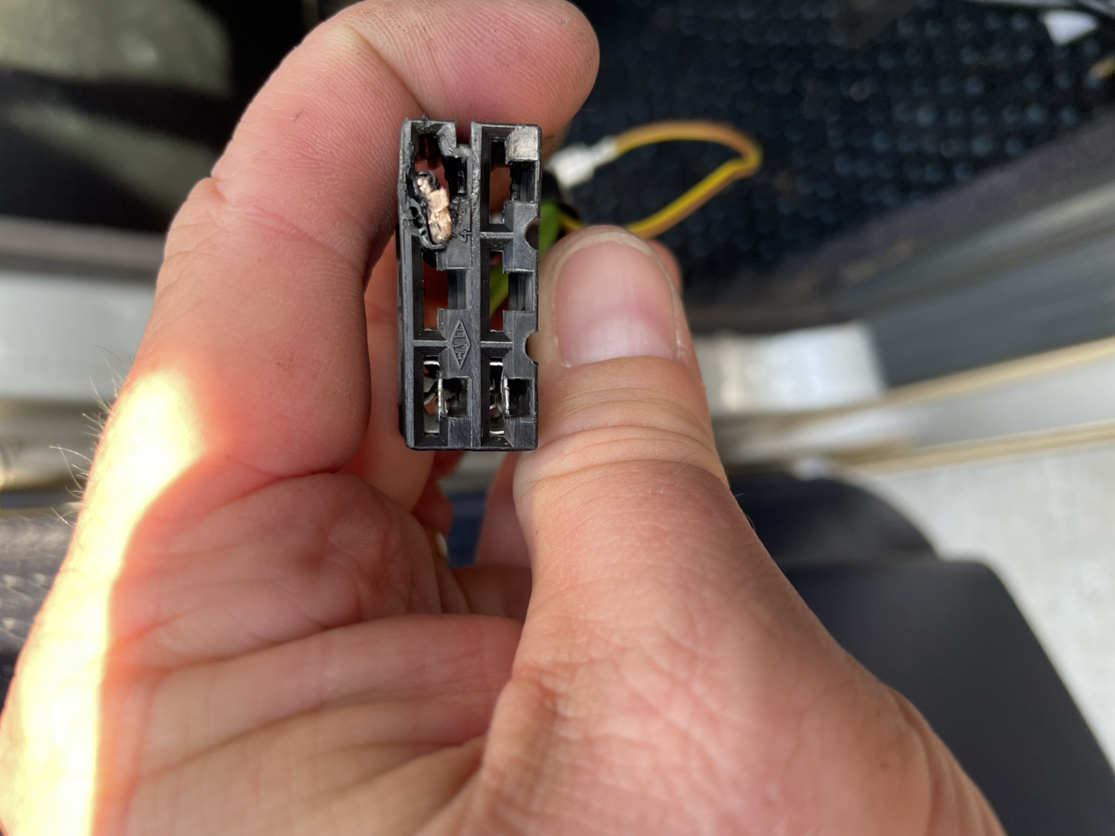

Unfortunately, the triumph was short-lived. I took my son out for some celebratory ice cream after his soccer game tonight. Just as we were approaching the driveway at home, the car (and all interior lights) died and I had smoke coming out of the steering column. Obviously a short. I disconnected the battery and will leave it outside tonight and will investigate in the morning.
Unfortunately, I found the new ignition switch harness wrapped around the steering shaft. The friction went through the insulation, shorted it out, and melted the harness plugs together.
I did notice some odd resistance in steering on the way home last night, but didn't hear any noise from the suspension or power steering. This explains it.
