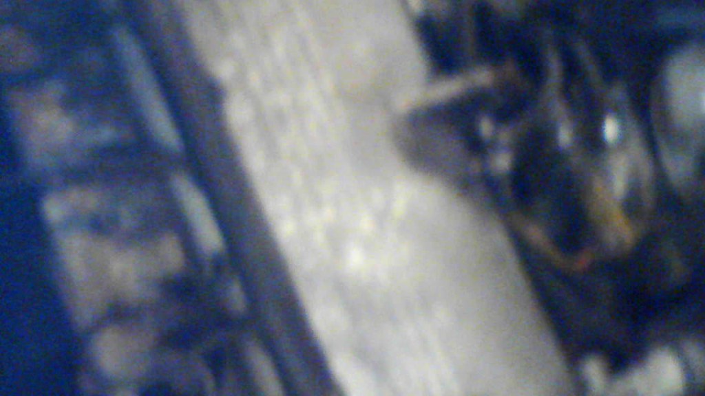

I just wanted to add another relatively easy thing to do if you have a laptop or android phone. This is a good option for curious folks like me that don't want to get their hands too dirty.
For $20, you can buy a USB inspection camera and drop it down the #1 spark plug hole. I've also run mine through my rockers and in the area near the A-Pillar windshield frame.
https://www.amazon.com/DBPOWER-Wate.../B01MT7OLIQ/ref=sr_1_2?ie=UTF8&qid=1490736580
With a camera, you can see the piston top, which is pretty distinctive for each motor.
Here is one of my 2800CS. Lots of fumbling with the insertion but it was my first time. ;)
