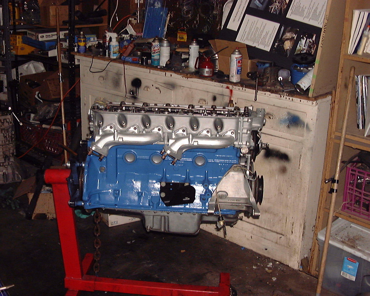

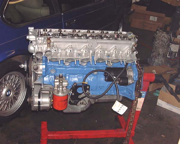

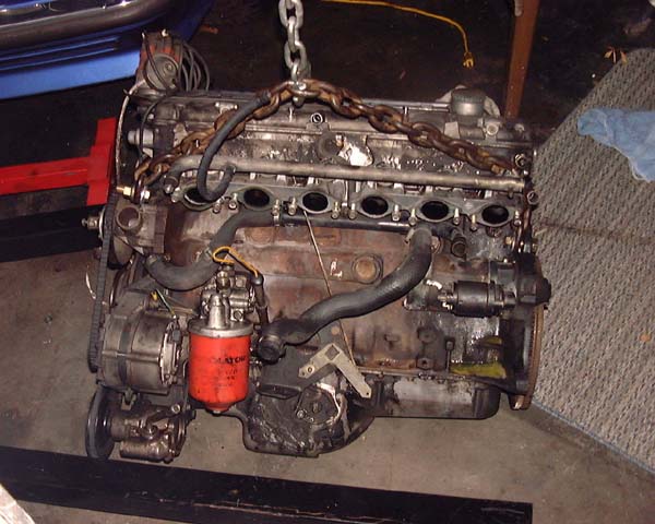

Here is an M90 from a 1980 Euro 635.
In the "dirty" pic you can see the painted "L". This has the "long" water jacket with 3.5 cast into it. And per one of the early posts, the "A" type plenum supports. It is an L-Jet system.
I had the head off this engine, and can verify that it is actually an M90 based on the bore.

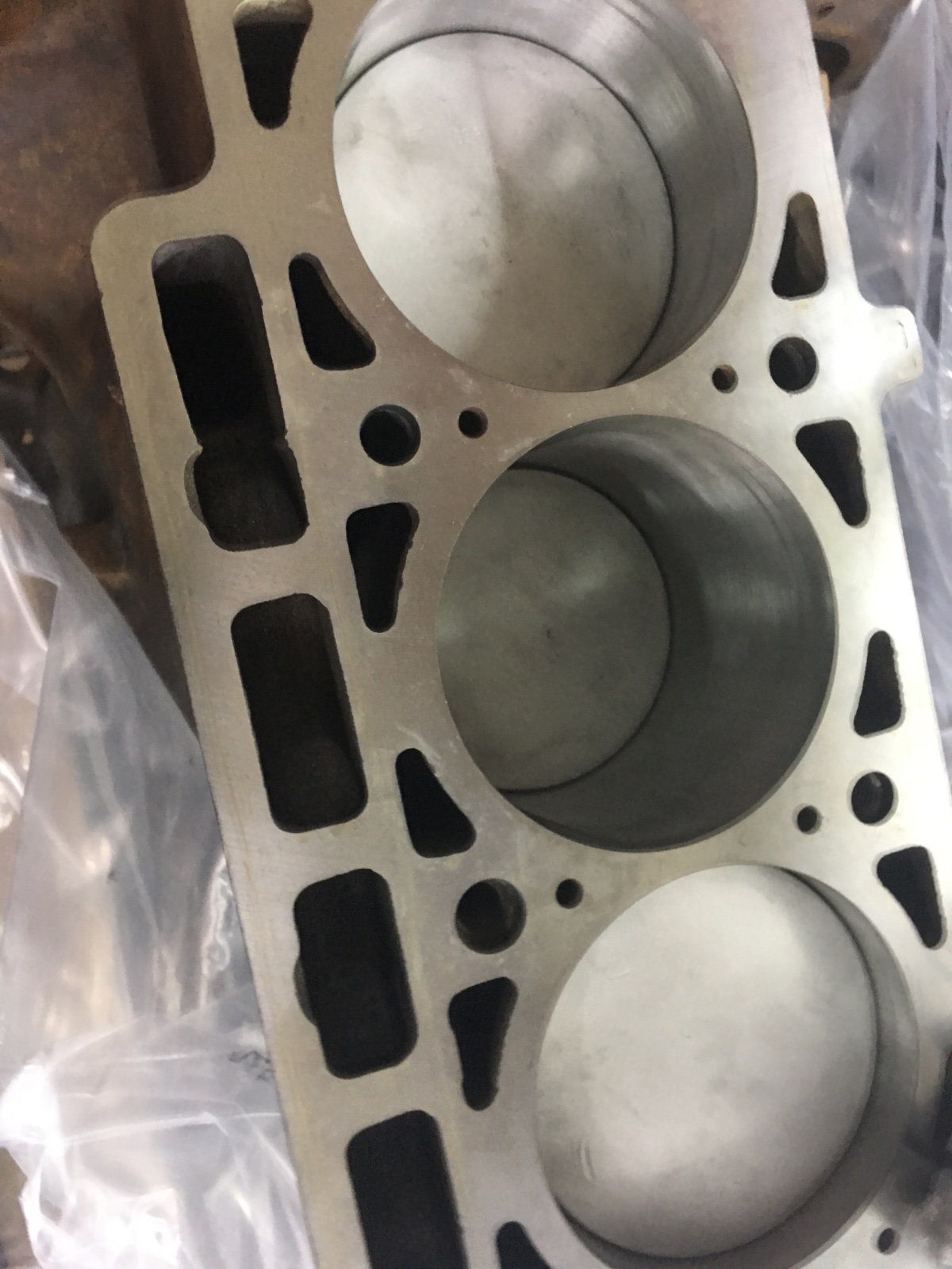

The M90 has a much larger bore than the M30. This means that the cylinders are spaced very close together, IIRC about 6 mm apart. This close spacing makes it impossible to get coolant between the cylinders. I suspect that the long external water jacket was part of an alternate cooling strategy. But that then begs the question if how the later "short" water jacket M90s were cooled..

“The M90 has a much larger bore than the M30. This means that the cylinders are spaced very close together, IIRC about 6 mm apart. This close spacing makes it impossible to get coolant between the cylinders.”
Actually, the M90 is the only block that has TWO coolant passages between each cylinder for cooling.
I meant actually between the cylinders. Not sure if the M30's do that either
