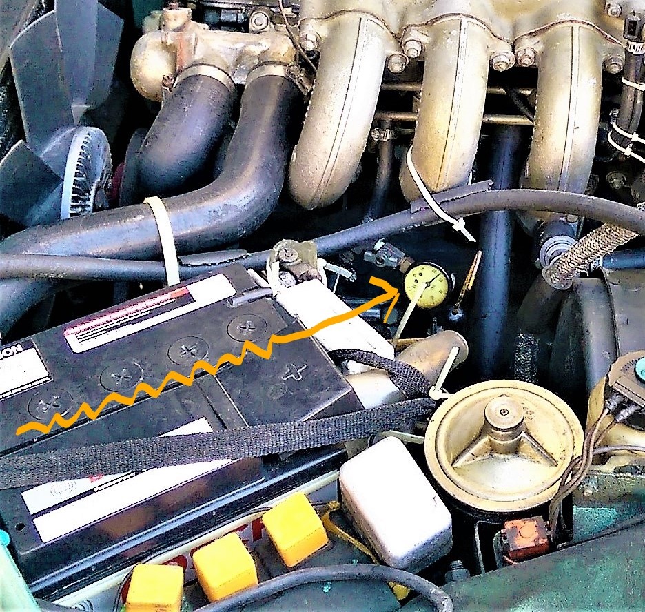

If your model is “injected,” as seemingly indicated, it is doubtful the vehicle is experiencing vapor lock, especially since most of the fuel system is pressurized. However, aft of the fuel pump (between tank and pump/tank reservoir) it is possible a poor hose connection or compromised hose might permit air to enter the system, in turn, causing momentary cavitation at the pump. One means of eliminating this remote possibility is a simple pressure gauge spliced between the fuel filter (usually under the battery tray) and the feed hose to the injector manifold. If the pressure remains steady, air in the system might only cause a hiccup and not a complete shut down.
Old braided high pressure fuel hose does not last forever. It can possibly sweat, allowing pressurized fuel to escape without significant warning other than the occasional fuel smell, and occasional rough running - or worse.
The filter age is probably a non issue too, especially if the gauge indicates normal fuel pressure is being maintained. If in doubt, remove it and try blowing through the filter. If that indicates serious resistance, you have an answer. As a simple field repair, you can still flush it in reverse to unclog it.

Something similar >>
1625409159700-png.122337
