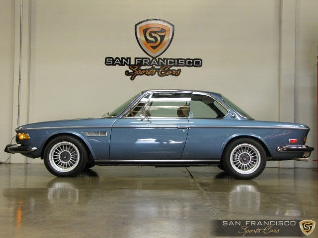

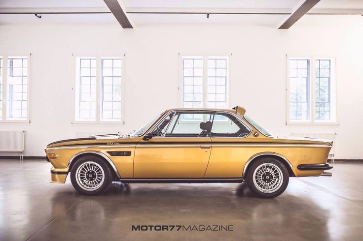

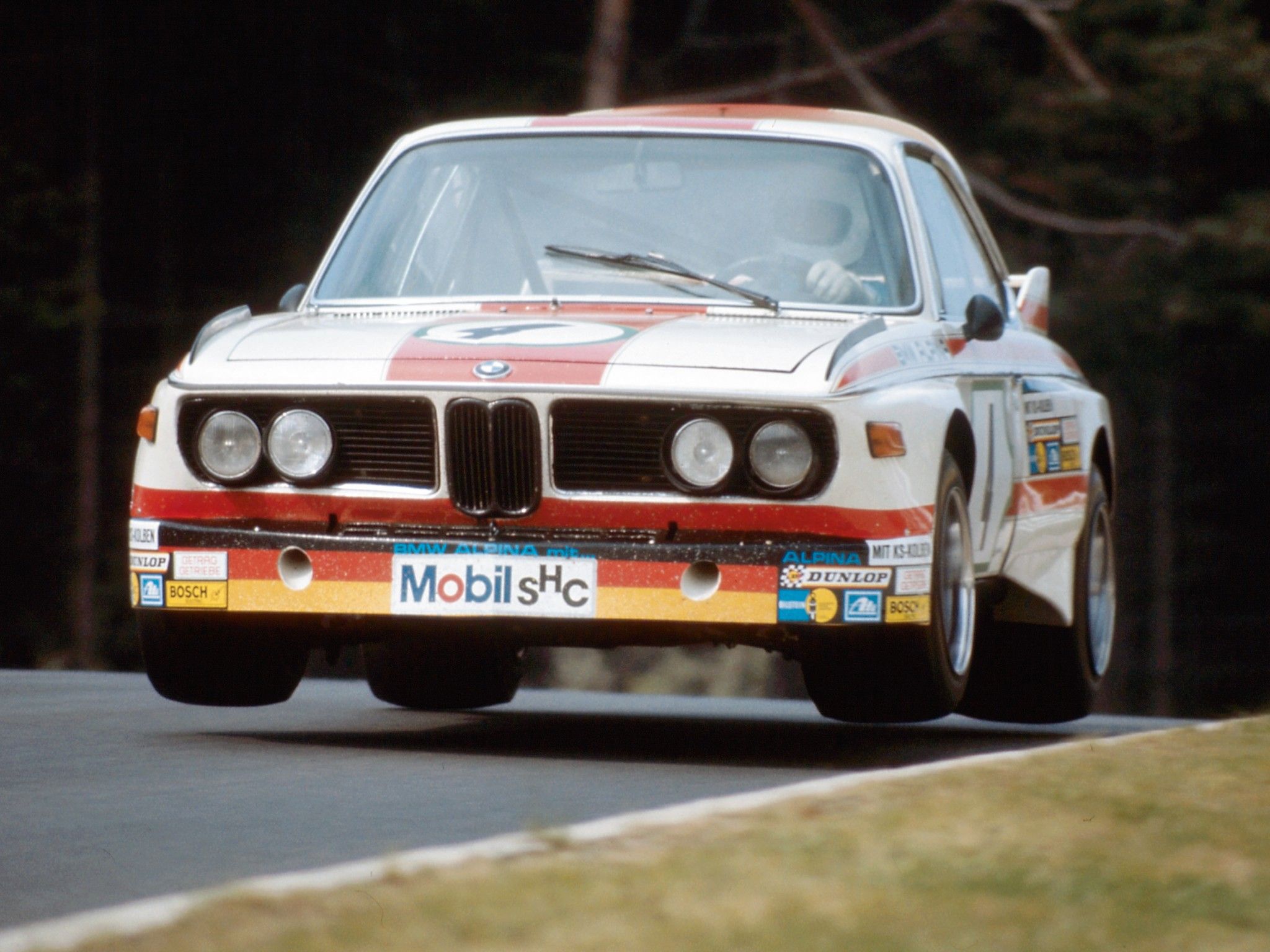

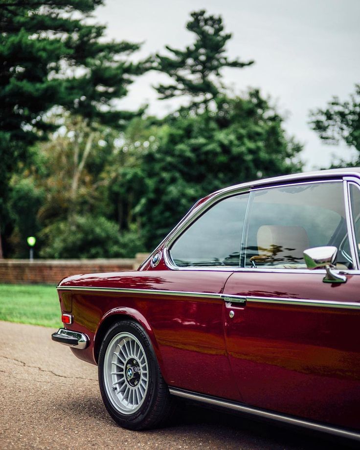

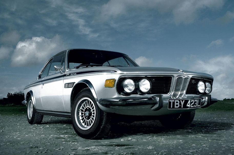

Random mix of shiny
A not-so-subtle attempt to outrun the heat and UV exposure?
*scientifically proven
