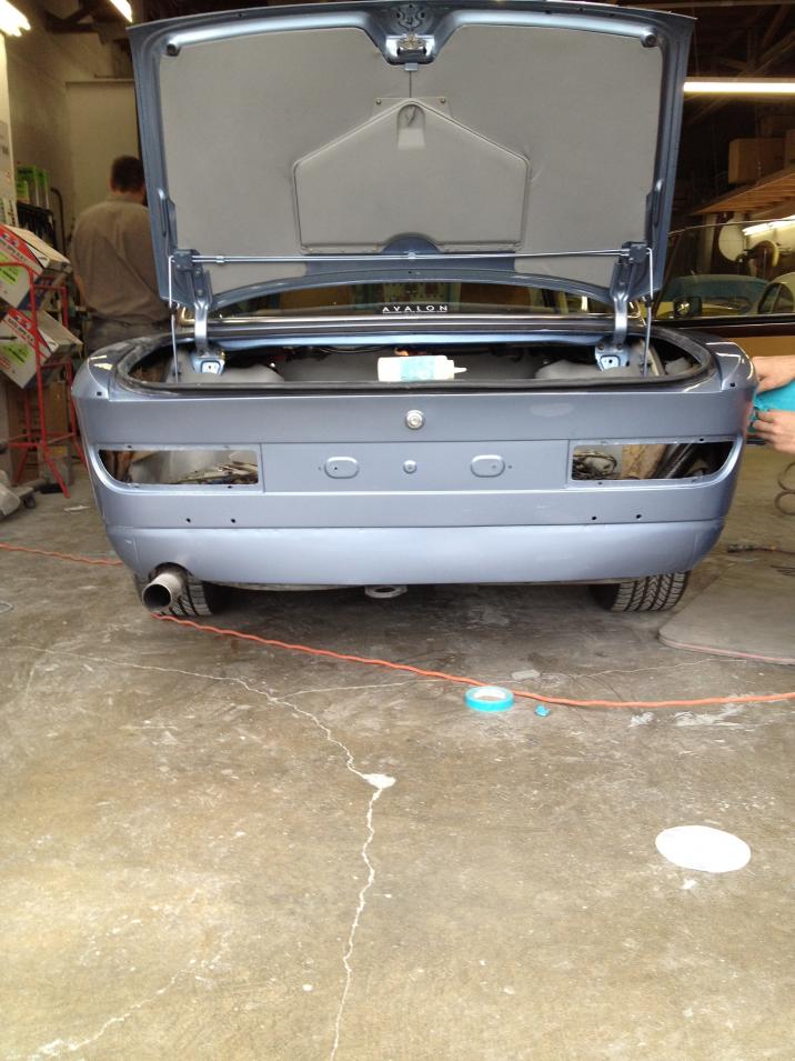

Thanks for the comments guys, I will be going up to the body shop with the bumpers to do some final measurements. The car will be primed at least one more time so I will have a chance to revisit the rear holes. Maybe you folks can tell me this in advance; I was thinking of fitting the steel/rubber "shelf" that goes between the body and the 74 bumpers on the car, I would have to cut it a bit, and then I thought I would make some plugs for the rear holes rather than weld them up, that way if the rear chrome bumper got destroyed I could at least fit the newer one on there temporarily. I'm not sure if there is enough room to mount the "shelf" with the older bumpers- Any thoughts or pictures you could share would be appreciated.
Cheers,
no room
as you can see from the pic, the euro bumper is almost touching the rear sheet metal, so def no room for a shelf.
re holes, if you dont weld them you HAVE to plug them, and make sure the plug is watertight, else rust has straight shot into your trunk and rear sub-frame. trust me, once you put your euro bumpers on you will never go back to the diving boards, even if your euro bumper gets crunched, so weld up those holes now while its cheap and easy.

+ 1 Alan. Body fill the holes now. This can always be un-done once big bumpers come back in style (I am not holding my breath) When I did my car we metal filled all the extraneous holes from the DOT stuff, there were many.
The car is looking great!
+2 on the filling. I initially hesitated on filling them in (like you i thought about plugging them) but then changed my mind . . . and i've never looked back. The big holes for the 74+ bumpers were clearly added hastily and those nasty welds are going be just slightly visible behind the chrome bumper.
I did thoroughly rust-proof/paint the inside of these holes because once they are welded up you have fully enclosed cavities with limited access.

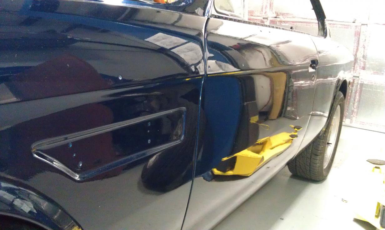

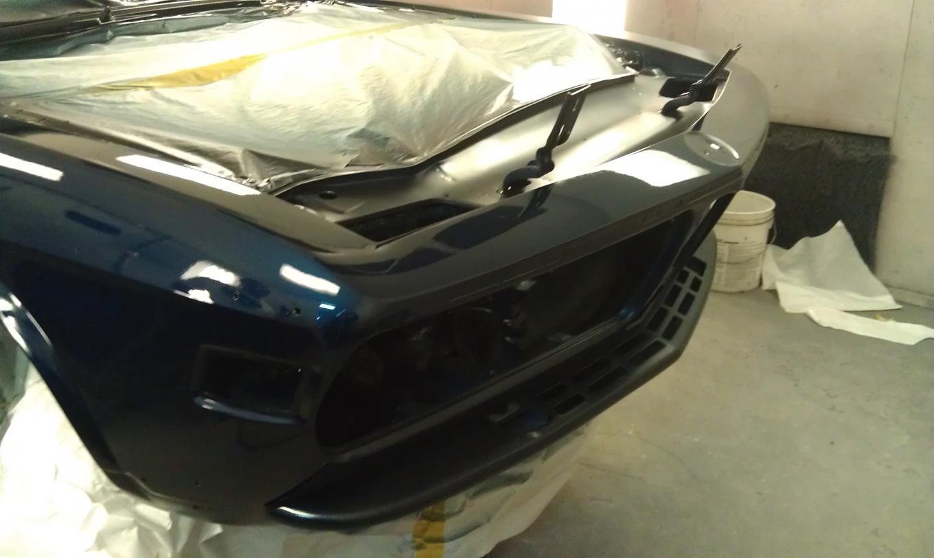

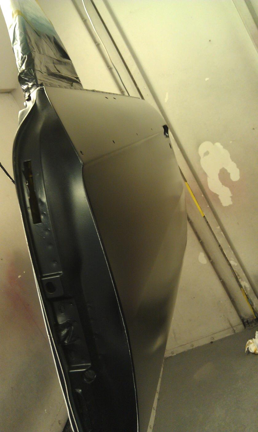

These are just the first coats, but I thought some might be interested in the process. the color looks almost black until the clear was sprayed.

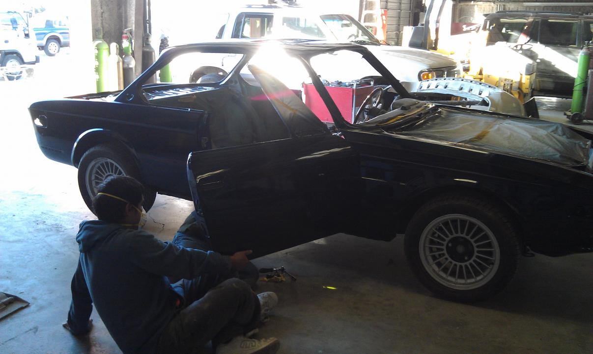

Out of the booth this morning! It's hard to get a good pic inside the shop with a cell phone :-(

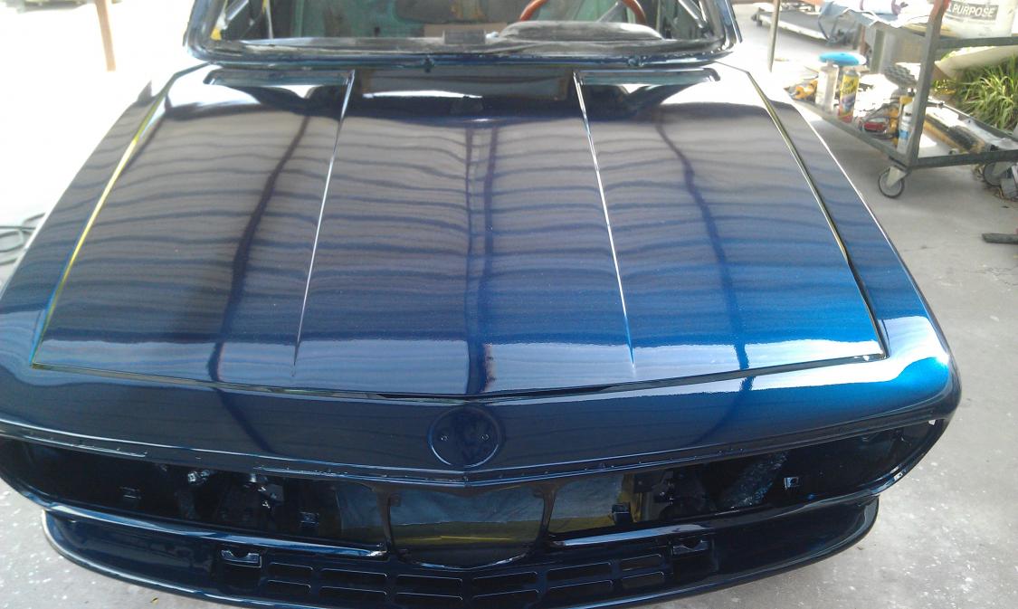

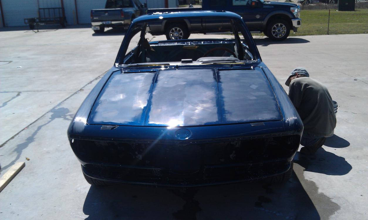

This is after the first coat of clear- it was being wet sanded when I went by today. They are supposed to re-clear it tomorrow, then dry over the weekend before.. what's next I don't know. And, yes, I made plugs for the rear holes but before I use them I am going to try a bumper mounting system I put together. Austin Texas is the "rear-end" capitol of Texas!

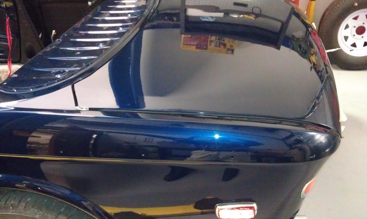

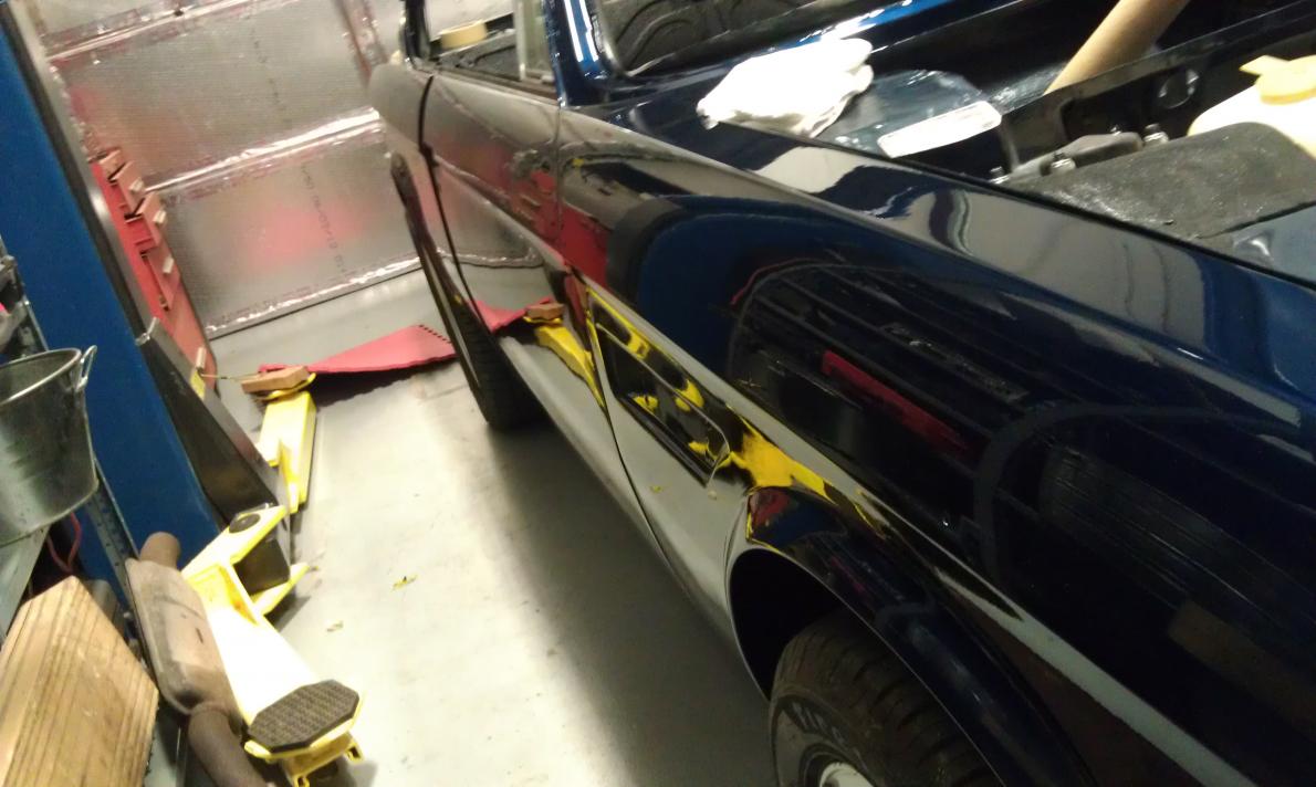

Hi Folks, thought I would post a few closer up shots of the paint, it's a little dusty but... just in the interest of keeping it going!
