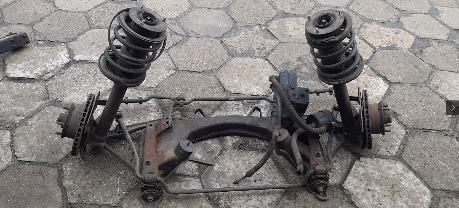

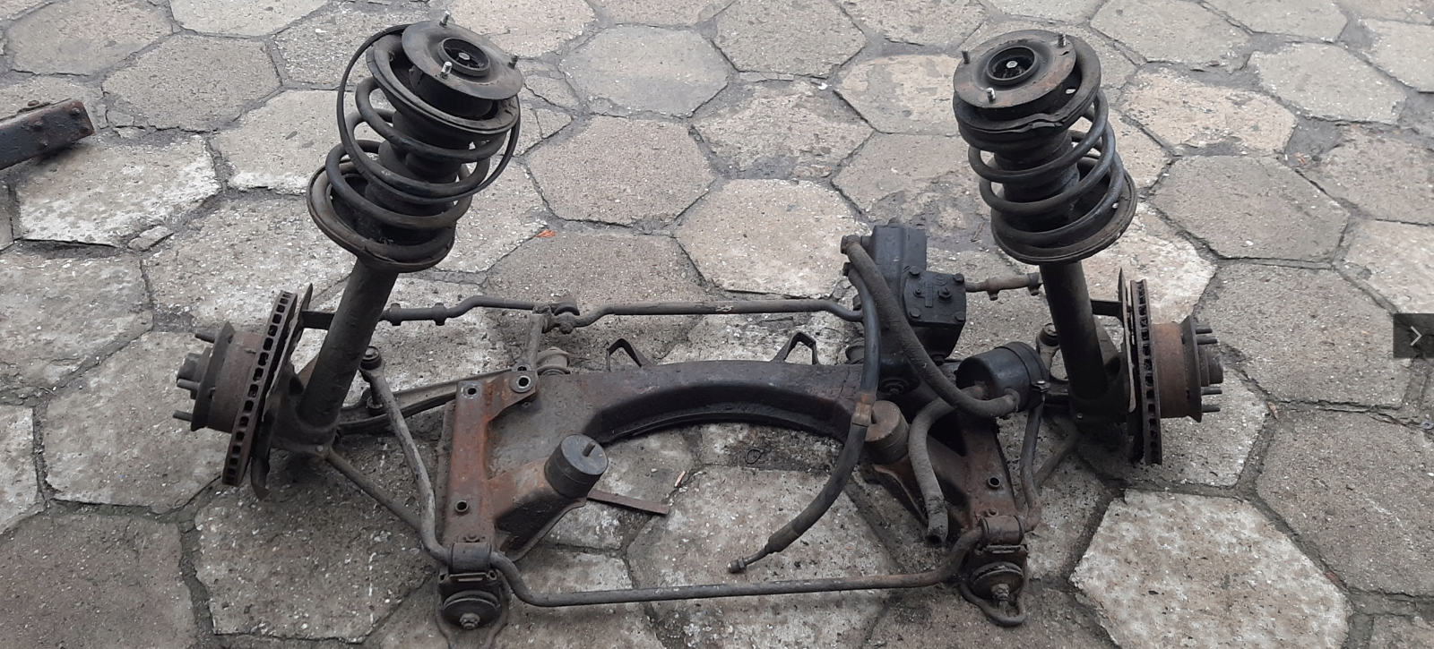

I have a friend who has a complete CSI suspension for sale.
Wow, thanks! Now if I could find another side too..
I somehow missed your earlier ebay link for full set with struts. That would be perfect if I wouldn't have already bought the rear shocks. Maybe I'll throw him an offer..
Thanks again.
