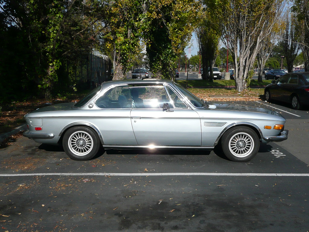

I have these on my Coupe (complements of Tony / Velocewest who I purchased the car from a while back).
Here is a pic of mine. I don't know the date of the spring installation or their manufacture....

Oh no. So none of you are looking like this?
http://i839.photobucket.com/albums/zz316/shawnalanhanson/DSC_0157.jpg
I found out from 'Shawn' that he installed the springs, Bilsteins, swaybars and camber plates. I was hoping to get a similar stance. Maybe there's different thicknesses in the rubber pads?
You should be able to get close to the ride height on my coupe.
I did use NEW rubber in the front below and above the spring.
I also used the thickest rubber block for the rears. I think it is the "3 dot" or ""one dot" whichever is THICKER.
Many coupe owners have used the same parts listed in my previous post and achieved similar results.
Thanks,
Shawn
I installed all of these except swaybars and my stance is not lower, although the handling is better. I was hoping for an inch lower. LaJolla says the springs aren't going to settle so???
