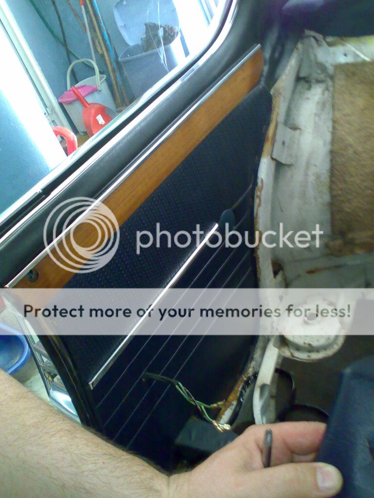

Lan-rear windows, motors, and trim panels - regrease and renewal

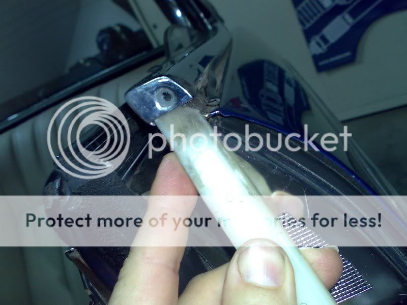

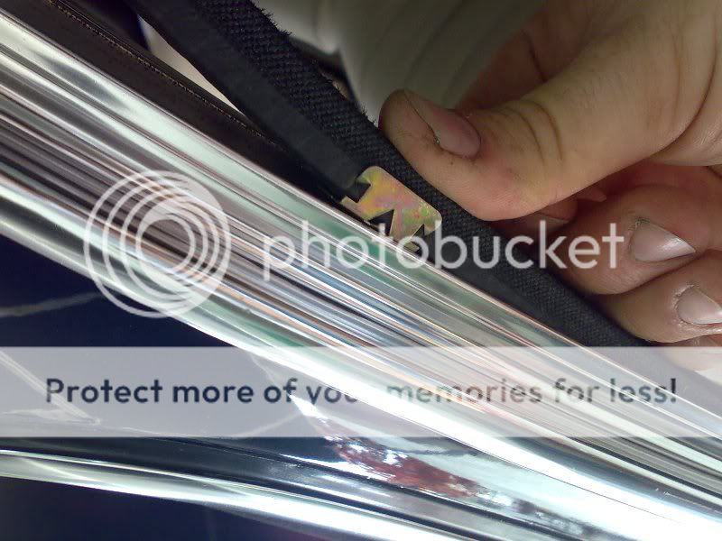

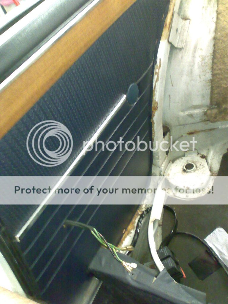

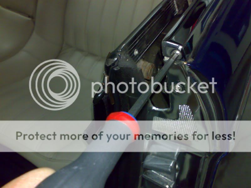

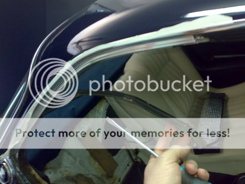

window upper carrier
to remove simpli use a flat screwdriver
new part is available in w&n, by meters

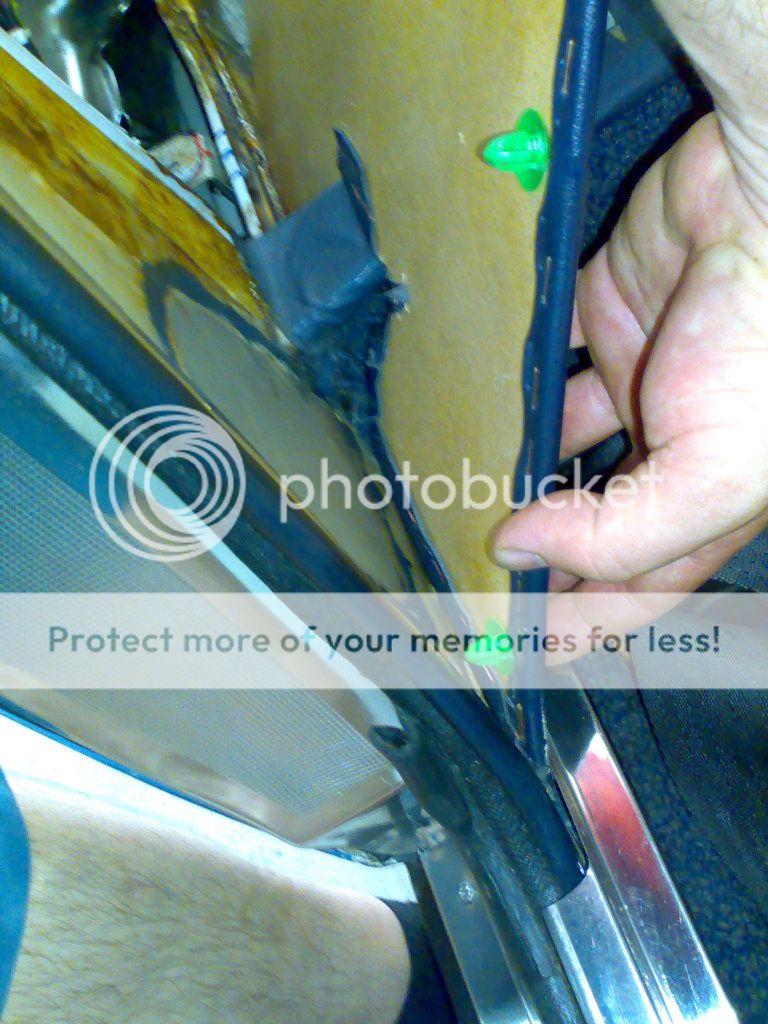

to install simply push the clamps

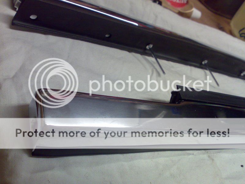

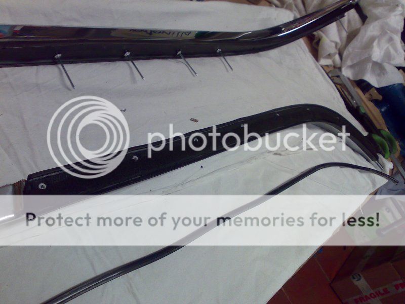

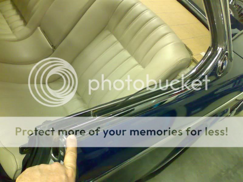

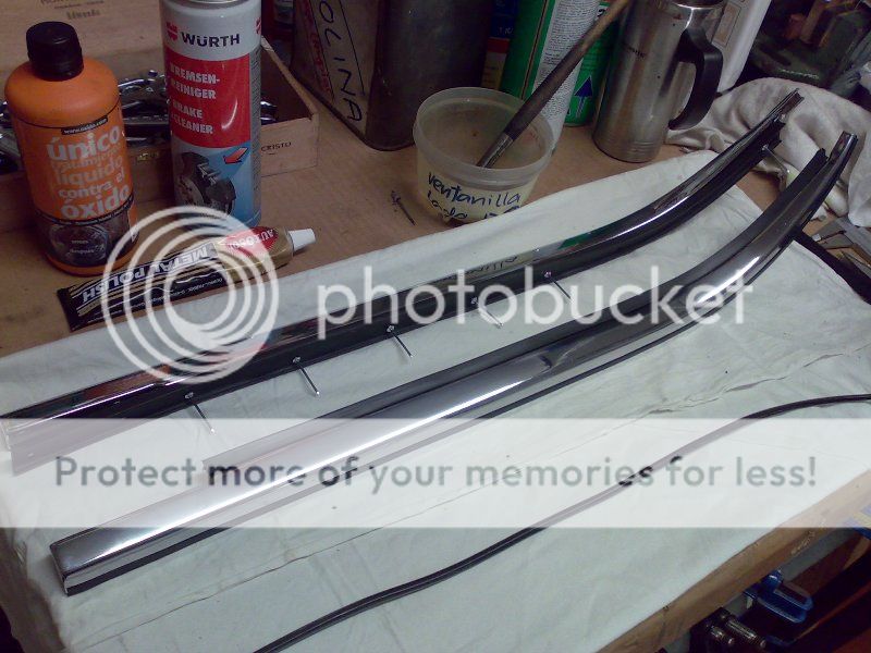

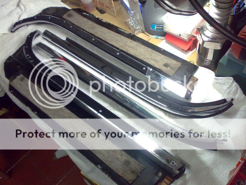

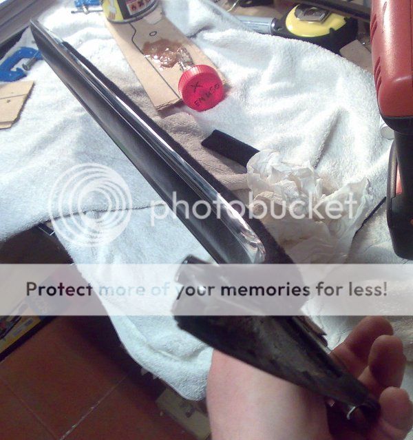

window weatherstrip, nice arrangement

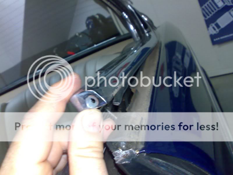

to improve the water tightness, remove the chrome part, by means of the front screw
then push upwards

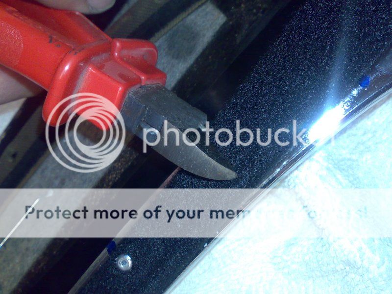

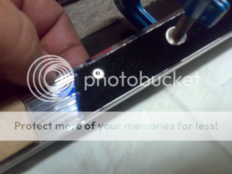

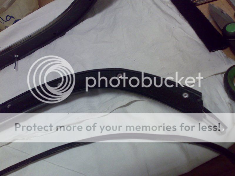

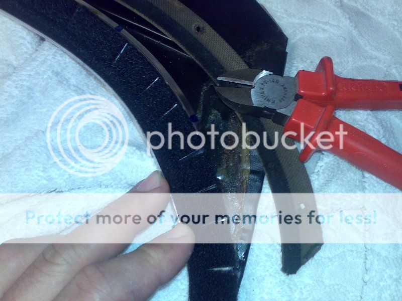

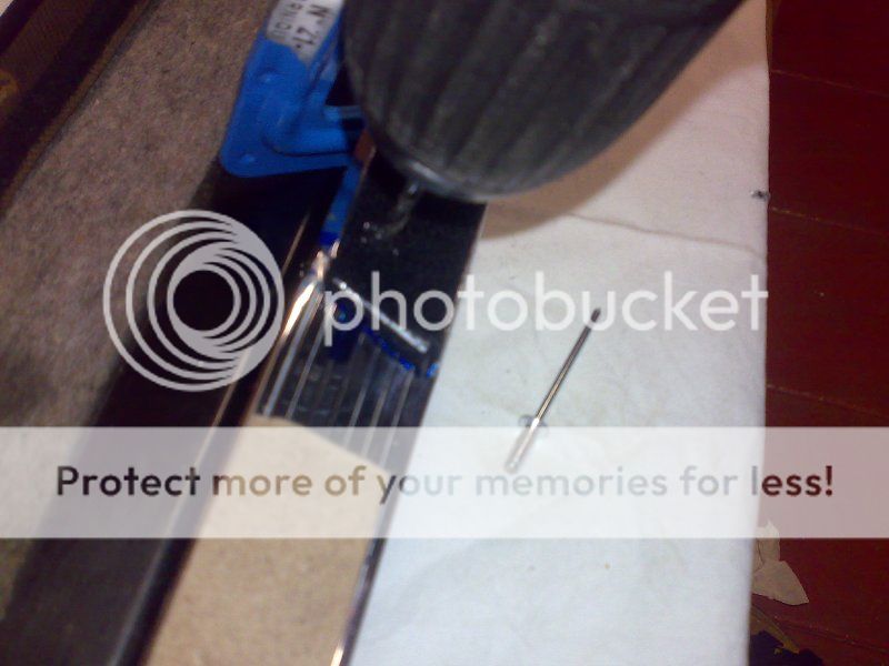

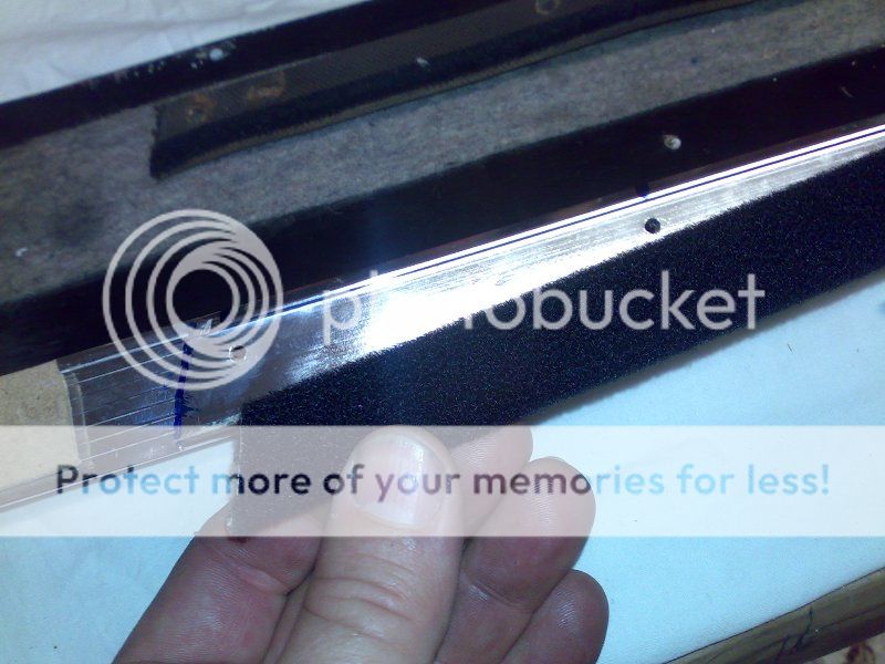

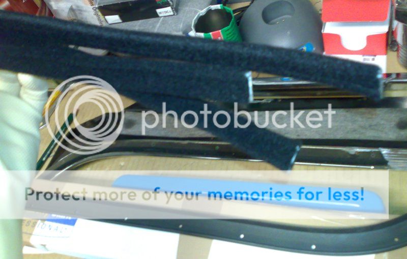

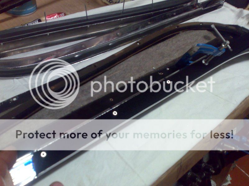

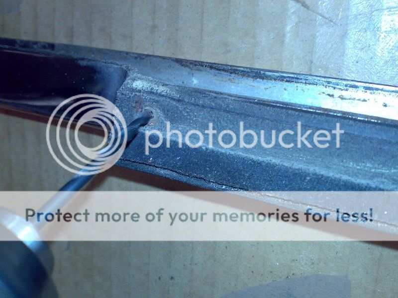

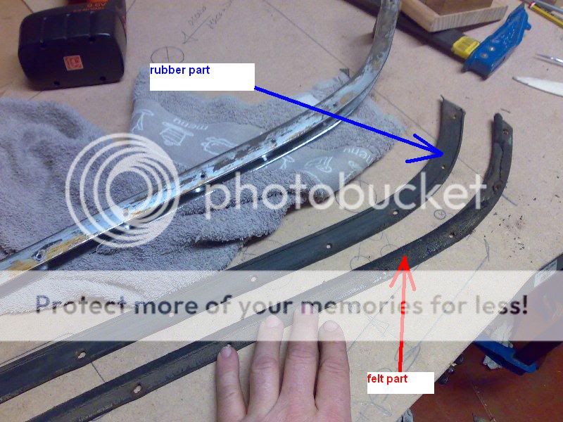

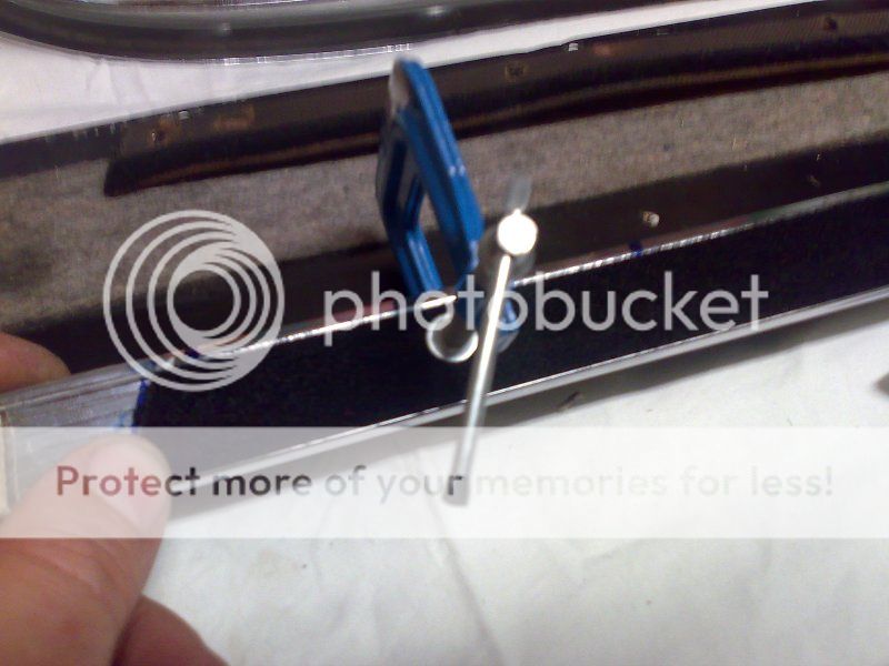

to remove the weatherstrip, you must drill the rivets

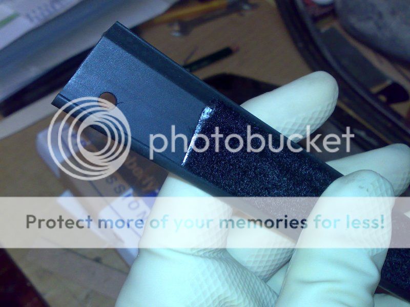

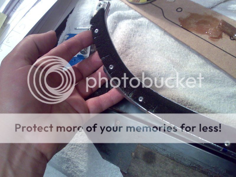

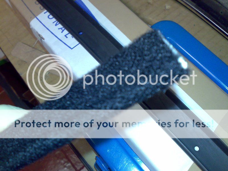

the rubber part is available at bmw or w&n, the felt part is NLA, so after some search I found an alternative
it is an aluminium plate covered in a apropriate textile
it fits very well into the rubber part

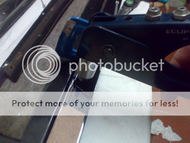

i will start from one corner
and go one by one drilling, plus riveting
then to cover the round part I must make small cuts to allow bending the part
looks good

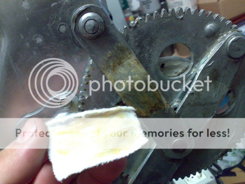

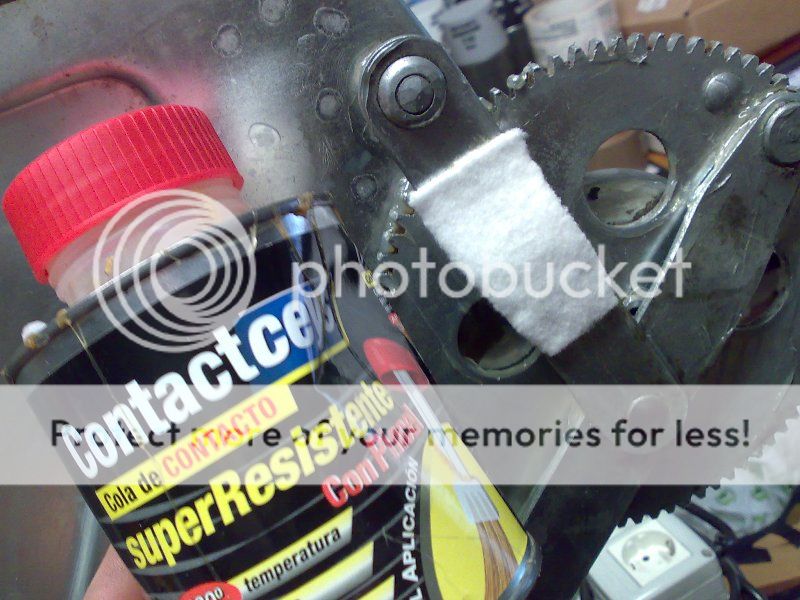

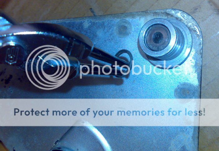

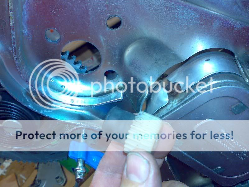

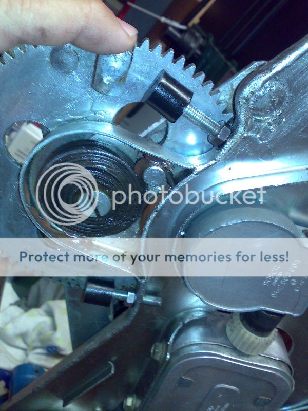

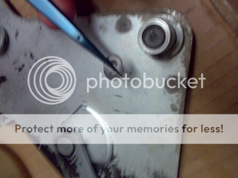

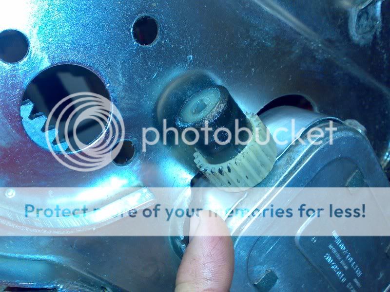

motor mechanics update

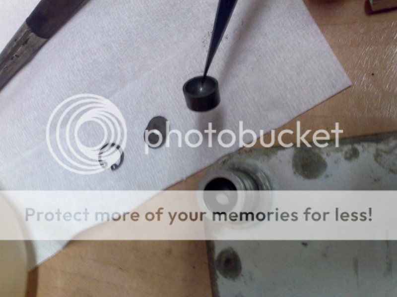

some details about the mechanism

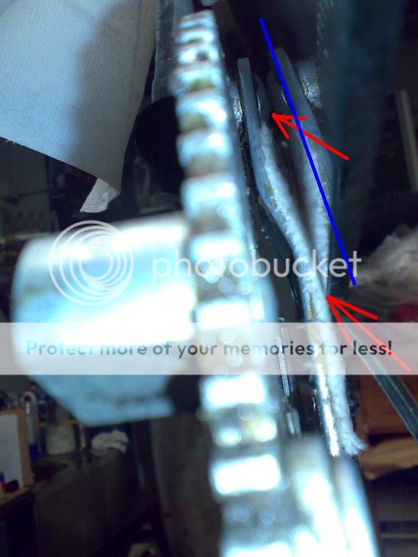

clean with gasoline and regrease

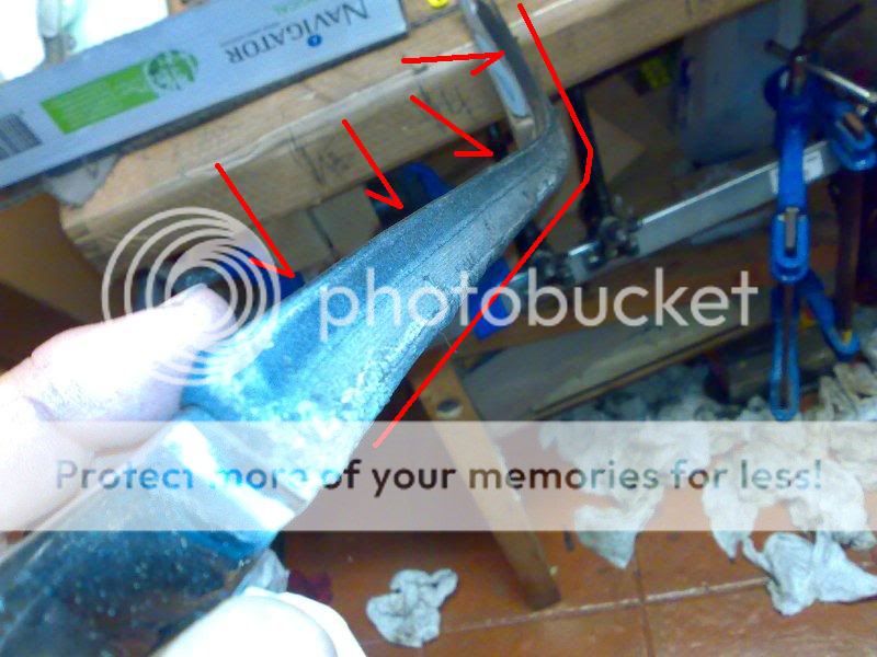

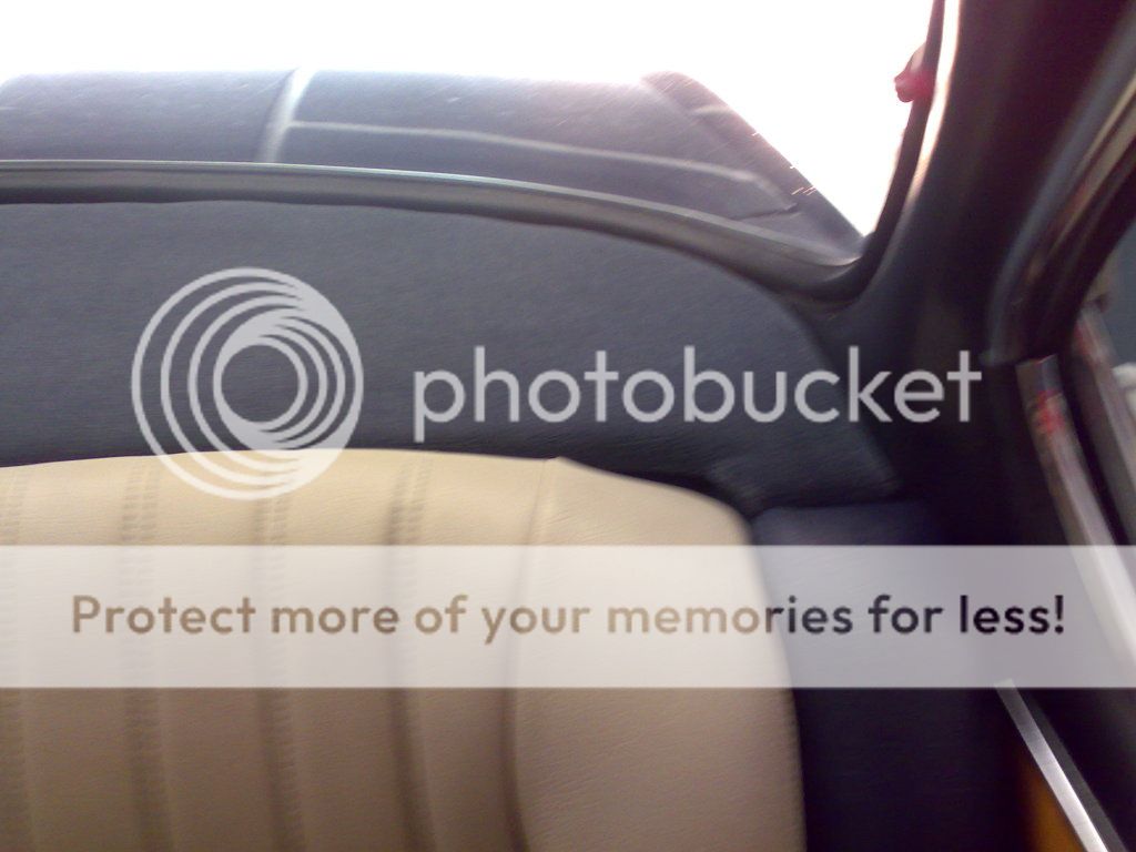

this is very important: this little textile band avoids contact between glass and the bar of the mechanism
here you can see how close the window passes
la raya azul representa el cristal, se puede ver como el contacto en la tela blanca evita el contacto señalado con la flecha roja

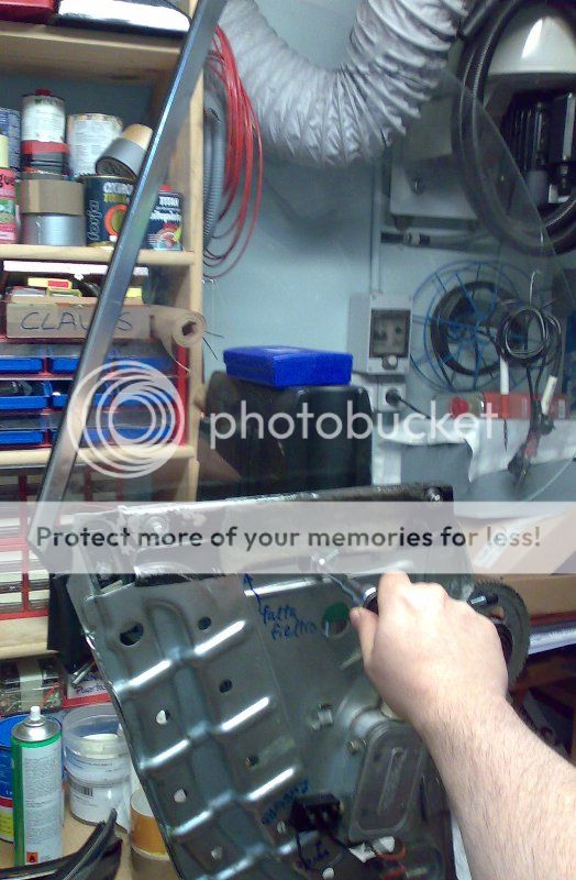

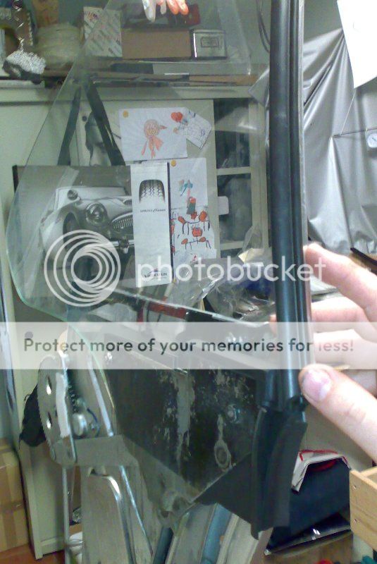

new stops and glass assembly
nuevos topes de fin de carrera:

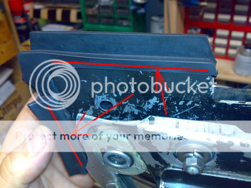

para montar el cristal primero montar la pieza de goma de esquina en el carro portacristal, el motivo es que hay que encajarla en las dos zonas indicadasen la foto:
se pone el cristal y se atan los tornillos a traves de los agujeros que se ven en la foto, hay que poner el carro arriba
vista exterior, comprobar que los tornillos no sobresalen

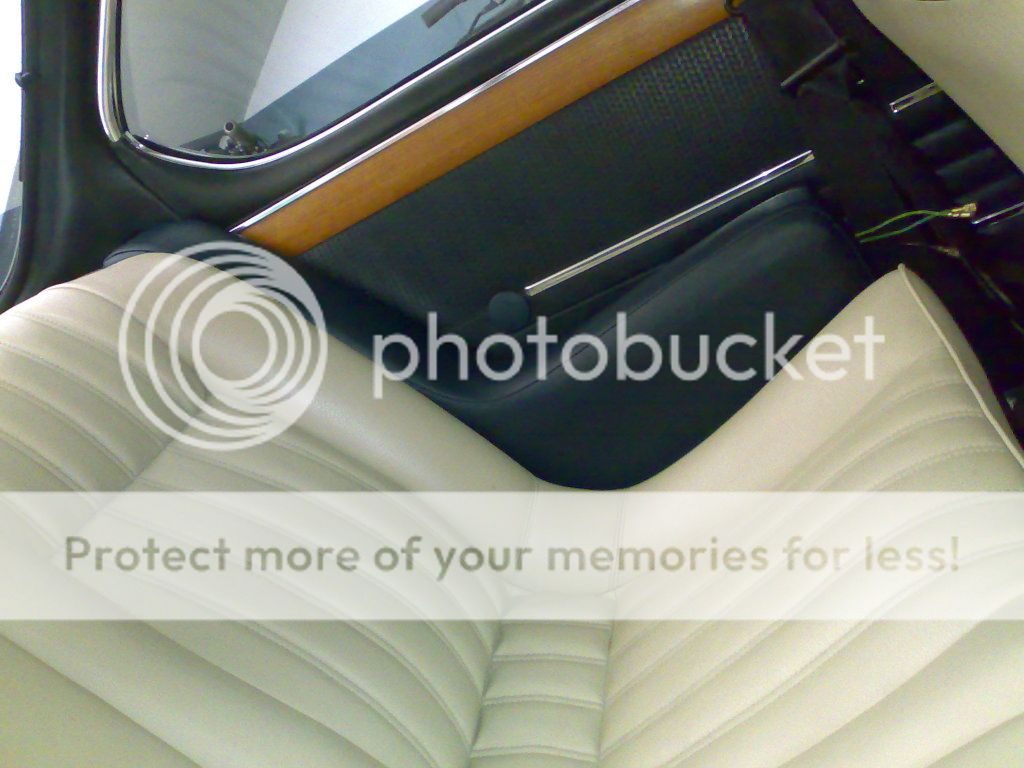

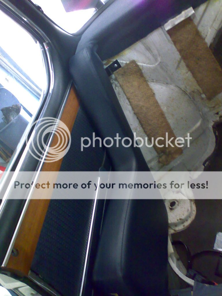

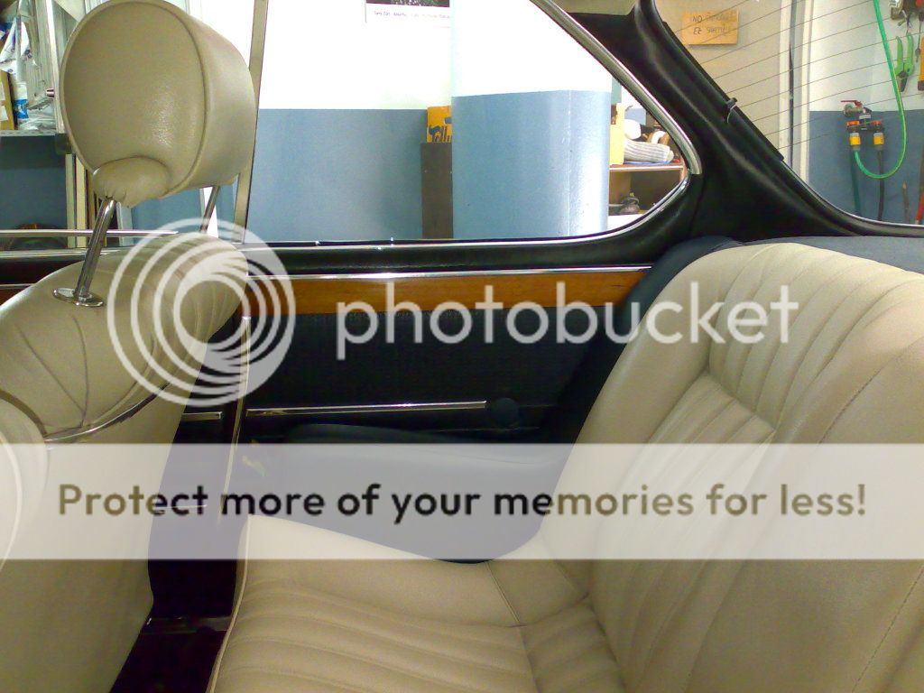

vista general de los lamelunas y sus soportes
aqui tambien se ve el tratamiento sobre la madera, piel y cromados

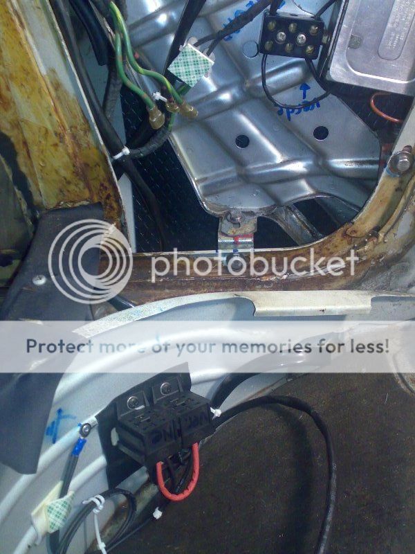

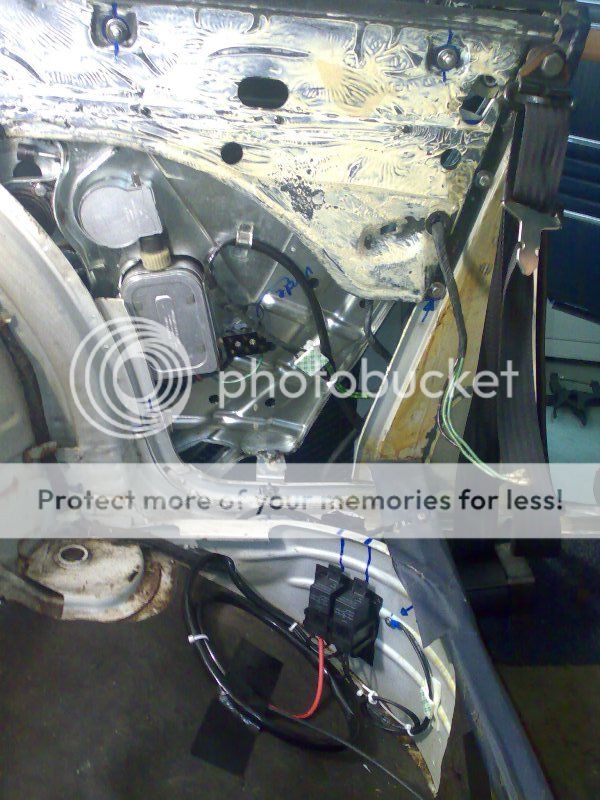

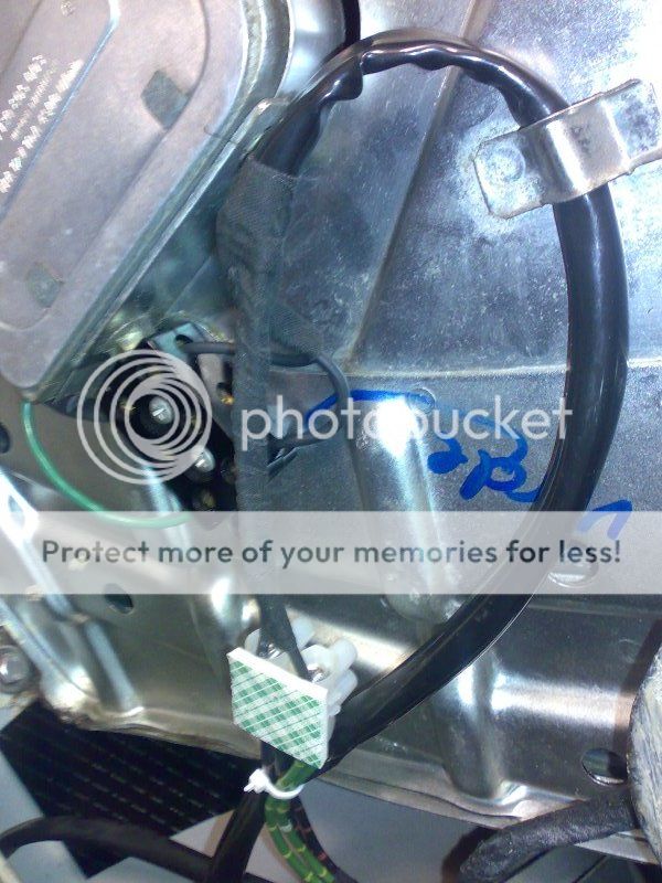

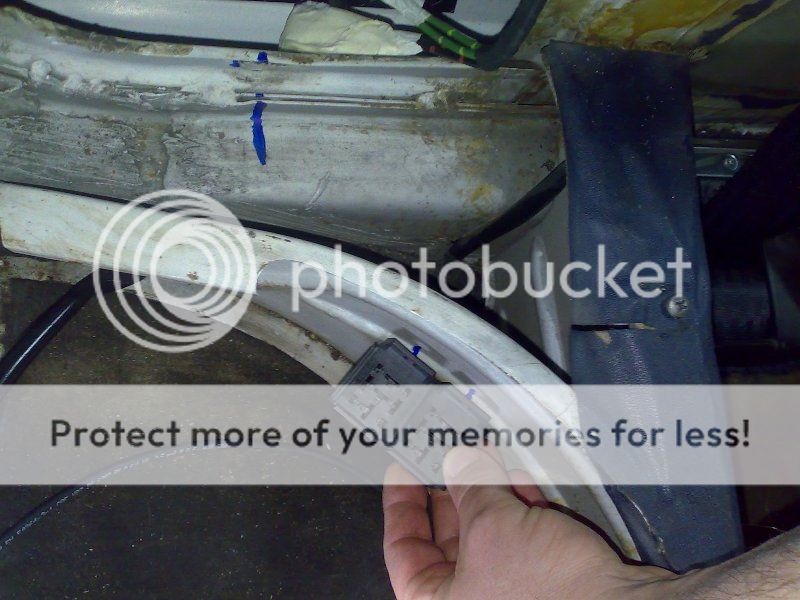

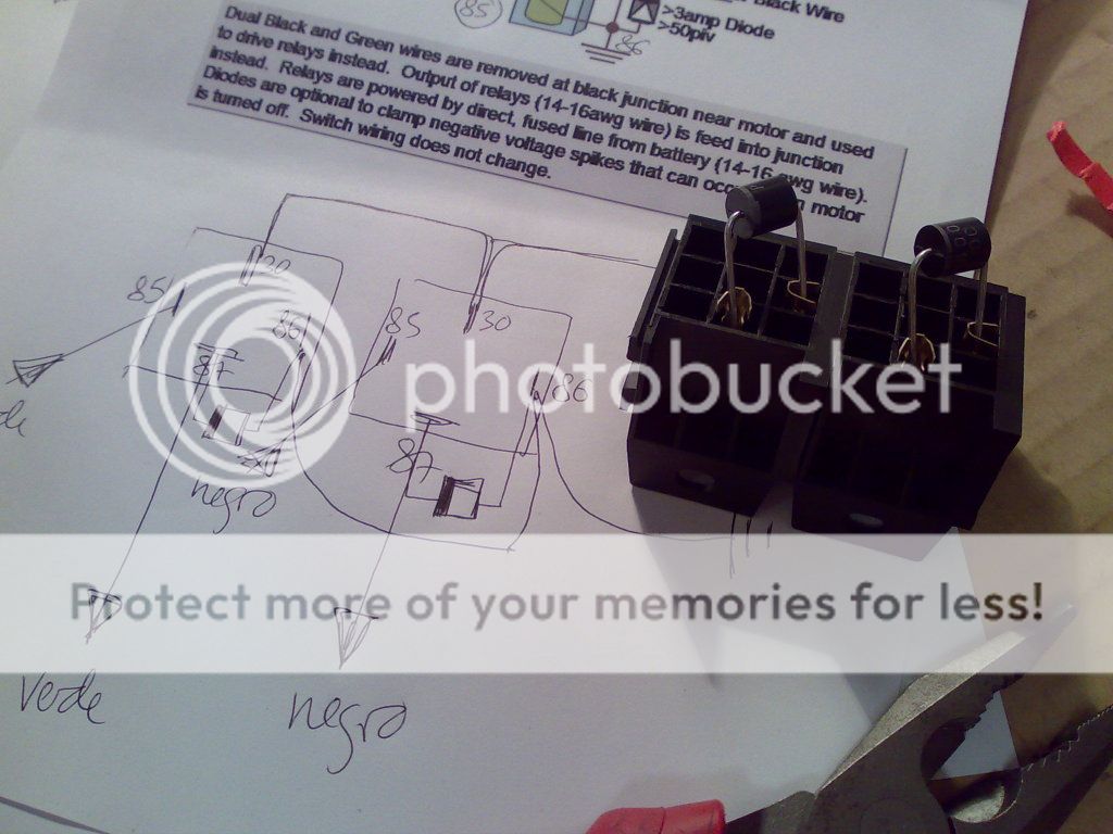

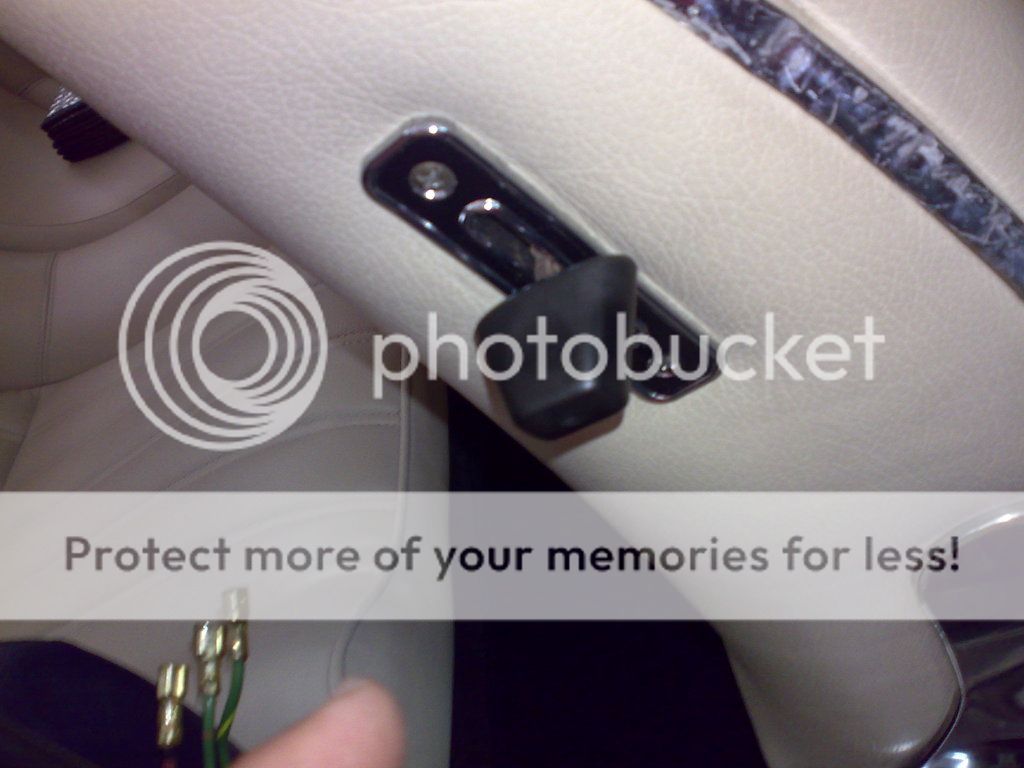

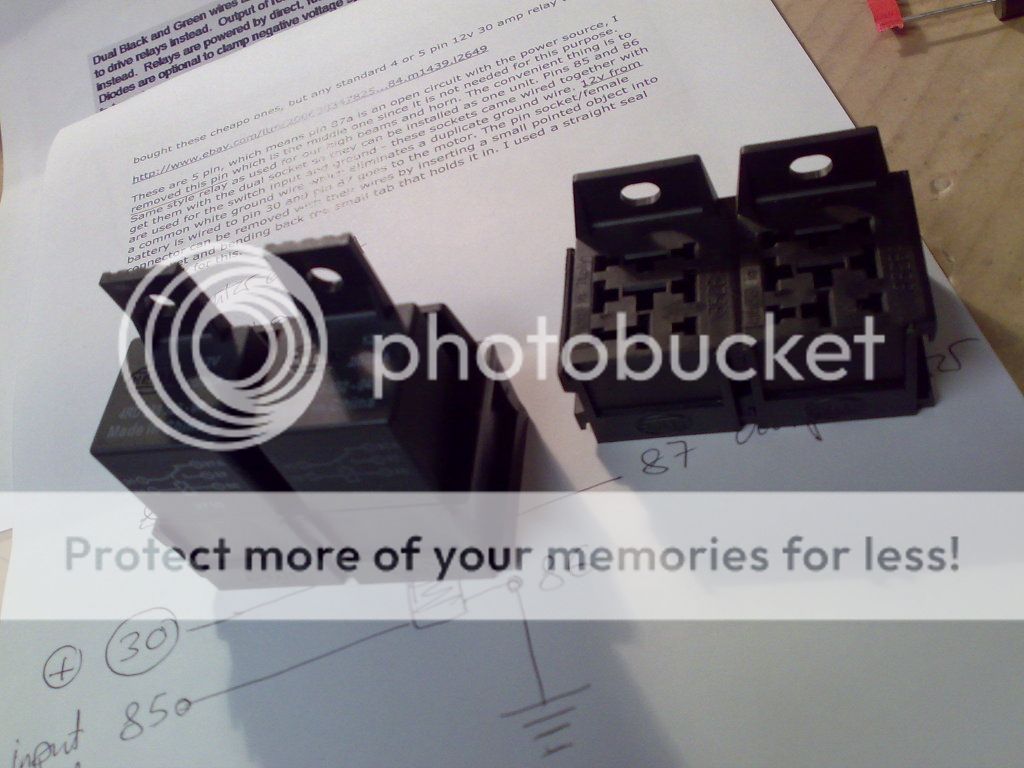

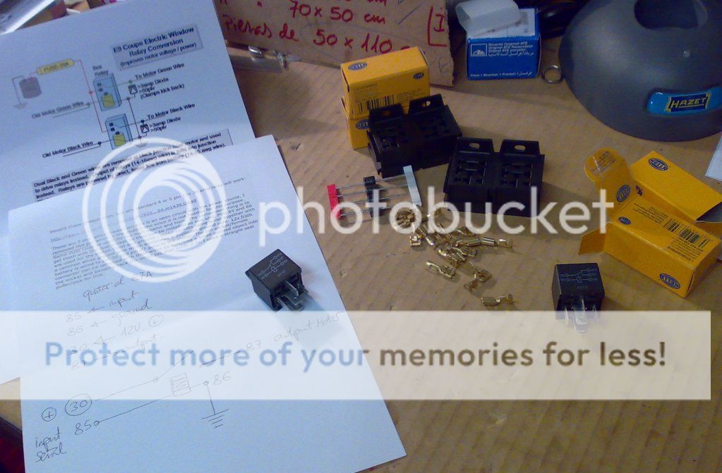

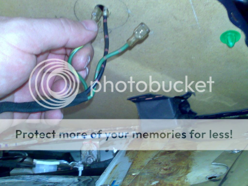

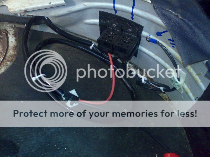

lets go to the electric part
so following the ideas of jmackro, and using the writing of stevehose, this is my particular way of doing it:

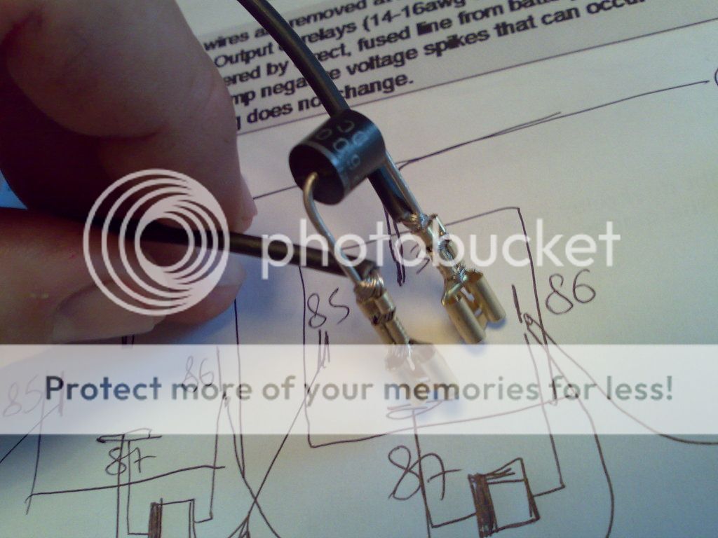

i will use hella relays in twin bases:

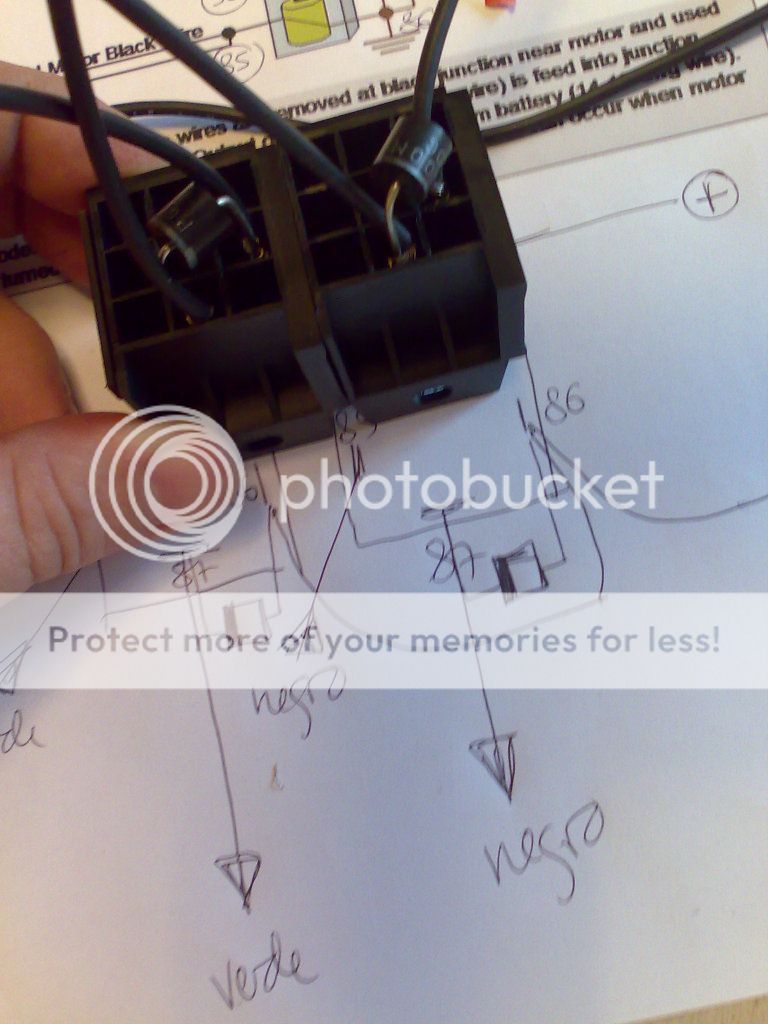

detail of the conections marking the relay terminals, see the arrangement of the diodes
this is the detail of this particular diode conection
translation:
verde=green
negro=black
Part Numbers?
Hi deQuincey- can you share the p/n for the run channel and the clamps? I looked on the W&N website for these 2 items and they don't seem to be listed.
Also, is the run channel that W&N offers rigid or flexible? The one which is on my car (and seems original) is rigid (steel).
Thanks in advance.
Thanks in advance.

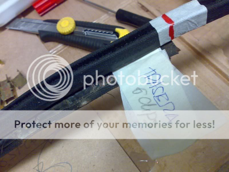

they are listed, probably you had problems to identify them in the drawings
if you are looking at w&n catalogs:
original run channel, is flexible, made of steel but completely covered in rubber and felt,
page: 51/23, references 8 and 9 for front windows
page: 51/27 ref. 6 and 7 for rear windows
the clamps and the run channel is the same for front and rear, you need aprox.
60cm for each front window + 5 clamps
80cm for each rear window + 6 clamps
hope it helps

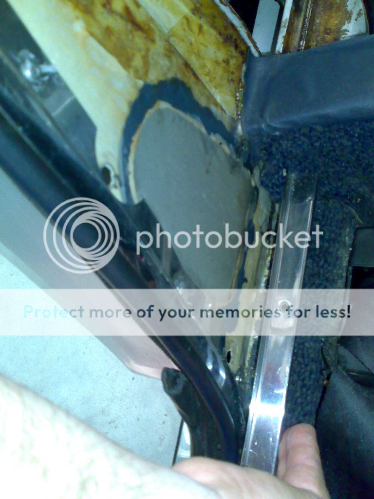

However, I didn't see a place where you discribe how to adjust the rear window position. On the right side, I've got a good fit. On the left side, The window appears that it needs to rotate forward about an inch. I saw the seven bolts that secure the window assembly tot he car, how do you adjust the position with all these bolts?
Left side (driver) bad fit
Right side good fit (how to do this?). Note: the front window is slightly down in this picture
There is a rubber spring/stopper on a threaded rod that you adjust for up and down position, just like the front. Located on the frame of the window unit. This will allow/restrict more or less window movement, although it looks like your upper chrome piece also needs adjustment?
Right, I just tried that but no good. I turned the bumper stop in about three turns and it didn't seem to make any difference. I'm almost out of adjustment, the stop is cranked nearly all the way in. But the arm is still contacting the stop, I can see the frame flex slightly when the window contacts the stop.

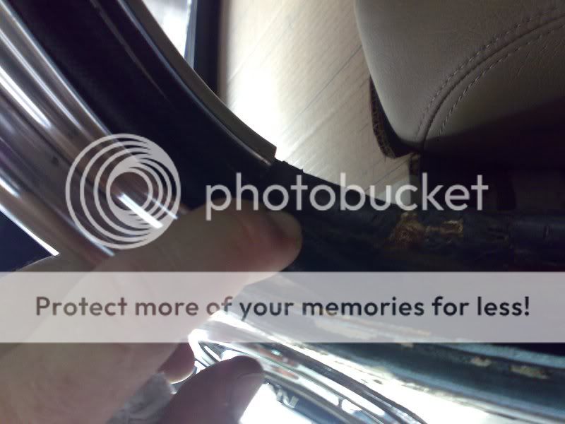

How do you adjust the upper chrome piece??

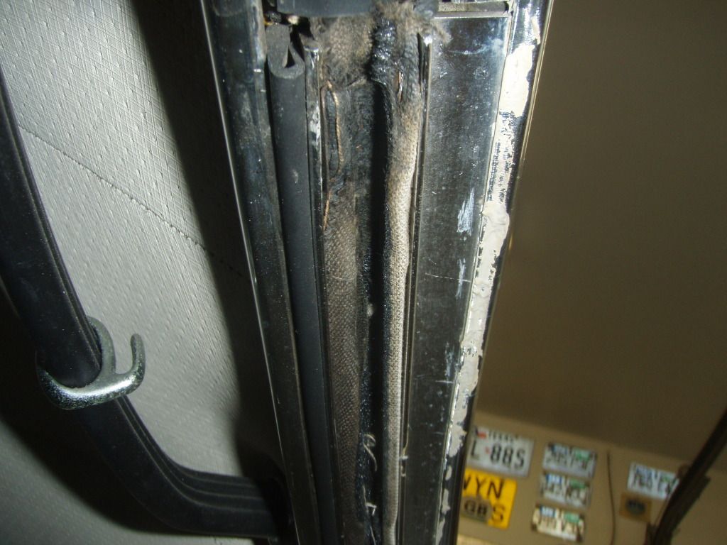

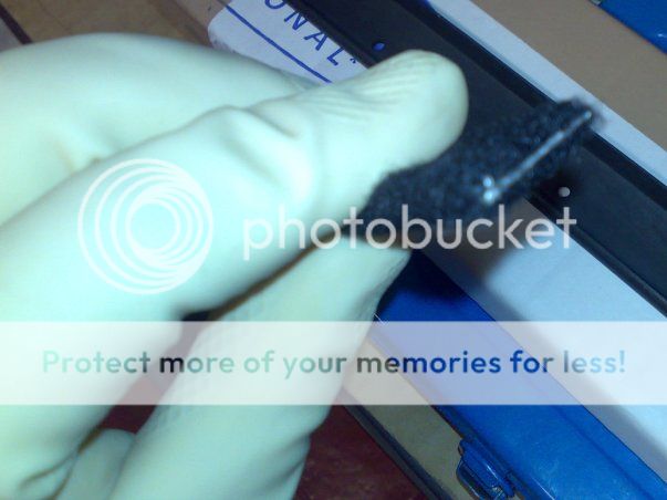

Edit: I just checked the window response to big changes in the bump stop. The window stops at the same place whther the bump stop is all the way in or screwed out about ten turns. The felt/weatherstripping in the upper slot is hard as a rock. Pics to follow
Pic of the felt.
