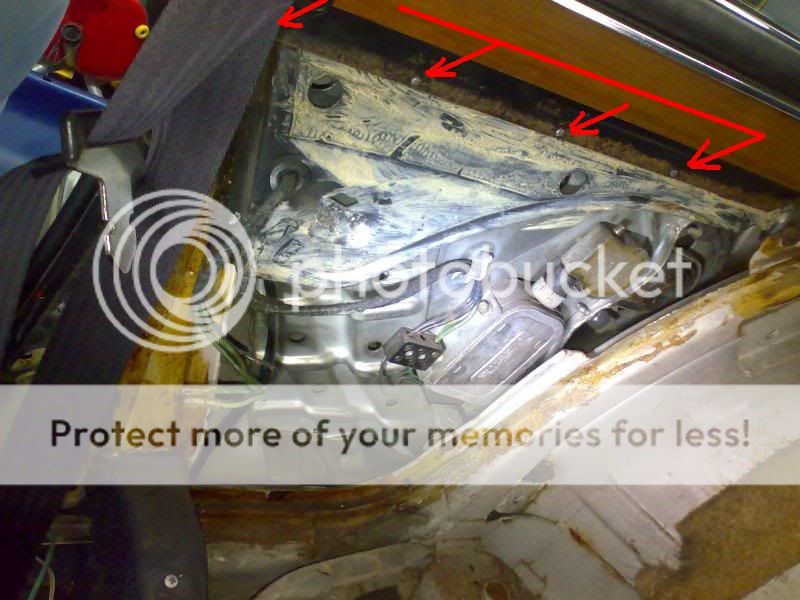

Lan- rear windows, motors, and trim panels - regrease and renewal

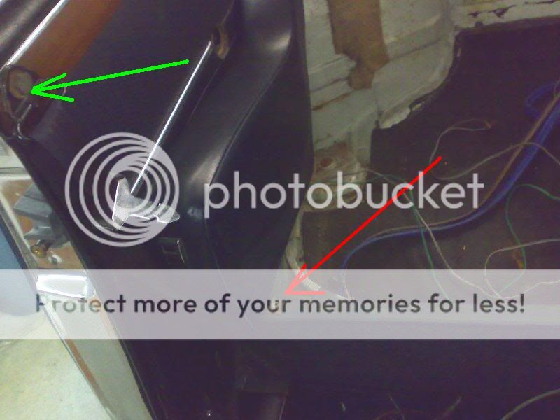

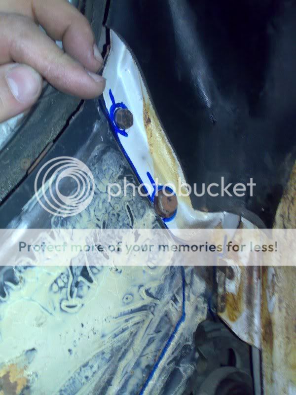

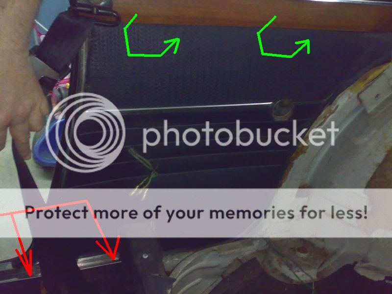

renew all this rear area
you can see the critical elements to be removed marked with arrows

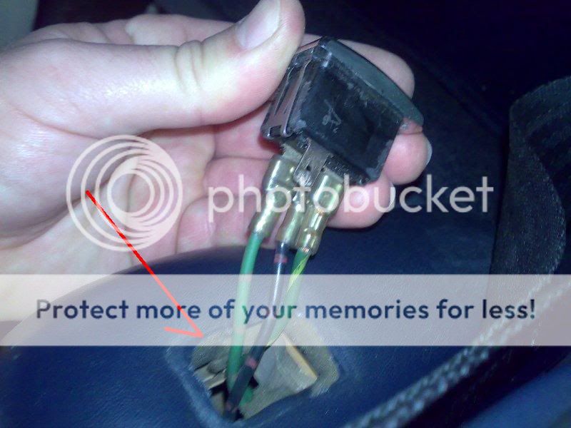

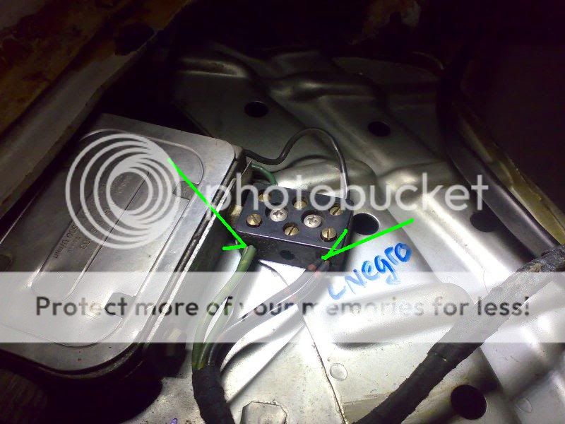

anotar las conexiones del motor y soltarlas

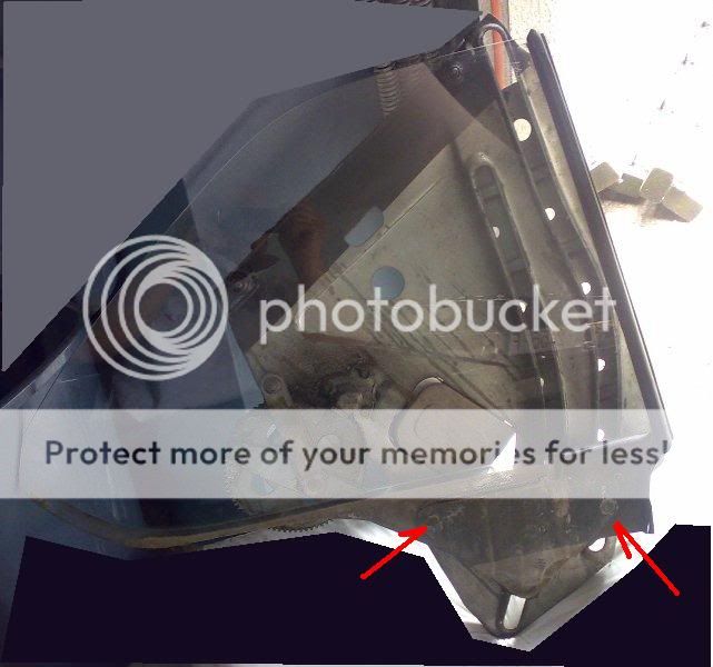

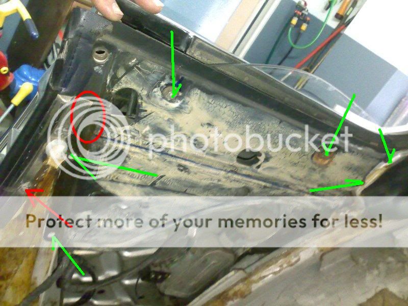

before undoing these last bolts use the electric power to completely open the window to manipulate it and to remove it folded

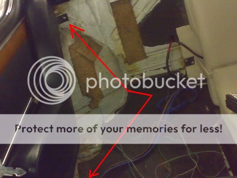

then you should remove the glass, it will be difficult due to the fact that the glass and the rubber and the metallic plate had glued one to the other, a sharp and long blade and you cut the rubber (new rubber elemnts needed)
the two red fixing bolts are only accesible from the "back" side, and there you find access dificulties because the metallic suport is there, you will have to manually operate the mechanism

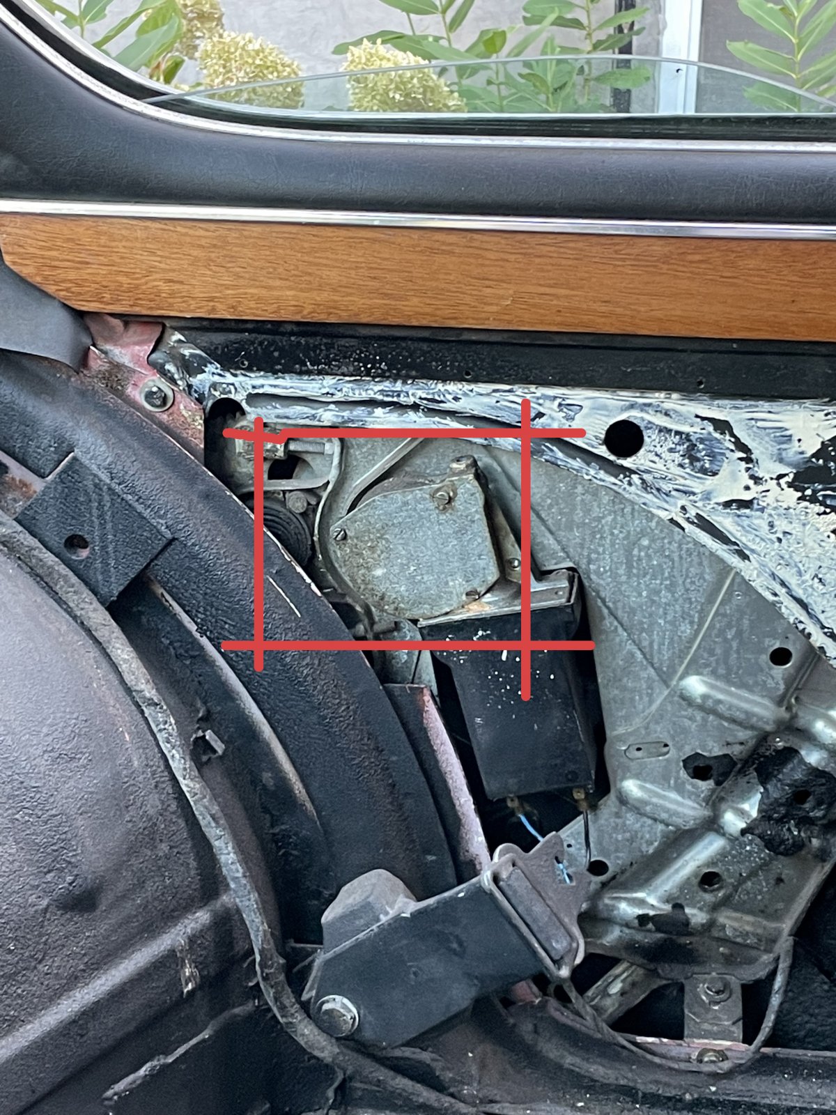

If that doesn't work, and your window motor looks like mine, you can take the cover off (inside the red box) carefully removing the 3 screws. Turning the gears inside should move the windows up and down) It should also give you and idea how much crud and dried grease etc has accumulated inside the "gearbox"

Great success! I didn't use any of the suggestions (although much appreciated since I was really running out of ideas) as I wanted to keep exploring to see if there was a straightforward way to remove an inoperative rear motor and there is:
On the later style motors, the bottom is enclosed in a black plastic case. Take a flat-blade screwdriver and insert that at the top of the case and start prying it down. It's not fixed, it just slides in place. With the microscopic BMW tolerances you have to pry and wiggle and pry and wiggle and pry and wiggle away from the regulator plate but eventually you'll be able to slide it off entirely, exposing the actual motor. Between the lower side with the motor and the upper side with the plastic toothed wheel (exposed at this point by removing the three screws on the back plate), there are two upside down slotted screws holding the two sections of mechanism together. Unscrew them and then pull the motor down; that pulls out the screw post holding the plastic toothed wheel in place. At that point you can pretty easily turn the plastic toothed wheel and bring down the window. I used small long-nose Vise Grips with each of the noses in opposite holes in the plastic wheel, and turned it while pushing down on the window.
