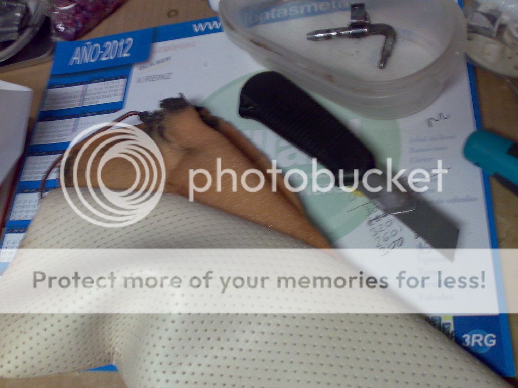

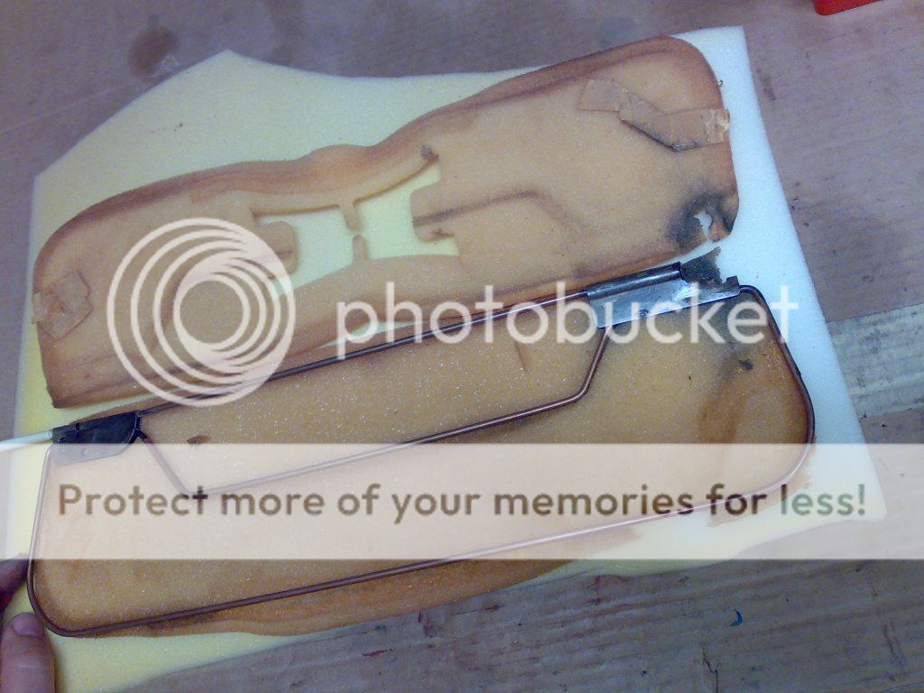

hi i am starting this because the foam inside the sun visors is inflated and left hand side is double the size of the right side one
use impact glue to keep the parts together
my question now, to close this opening which kind of glue should i use ? i am considering cianocrilate, do you agree / have experience ?

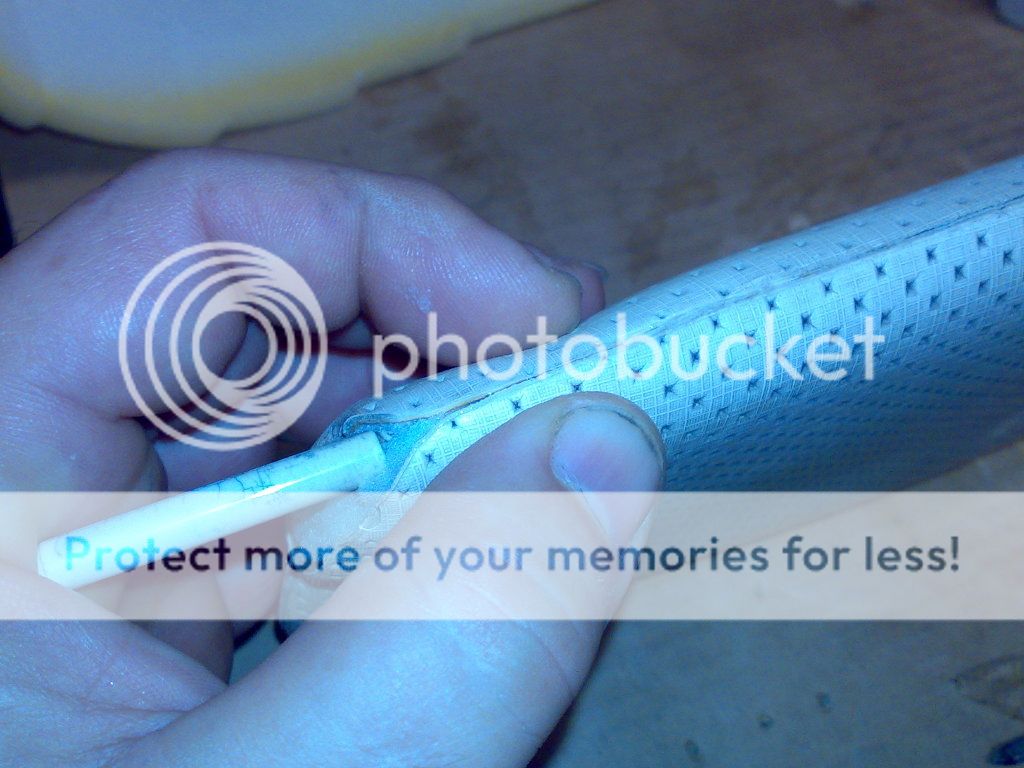

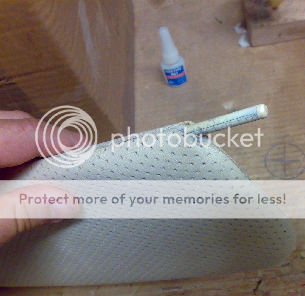

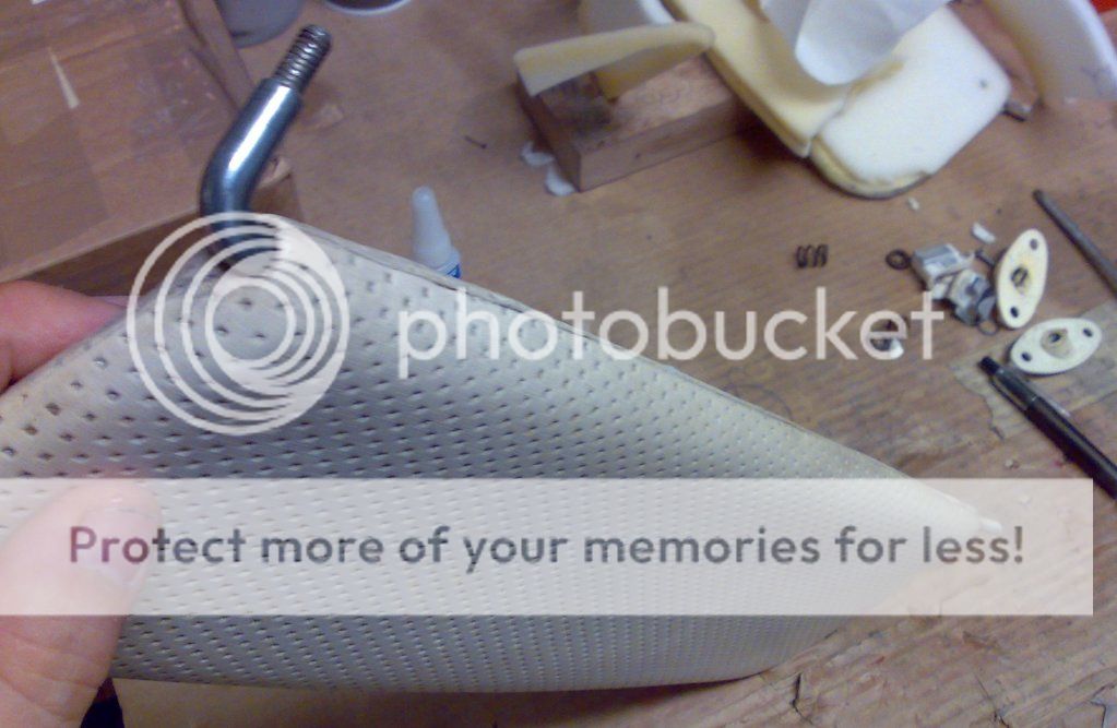

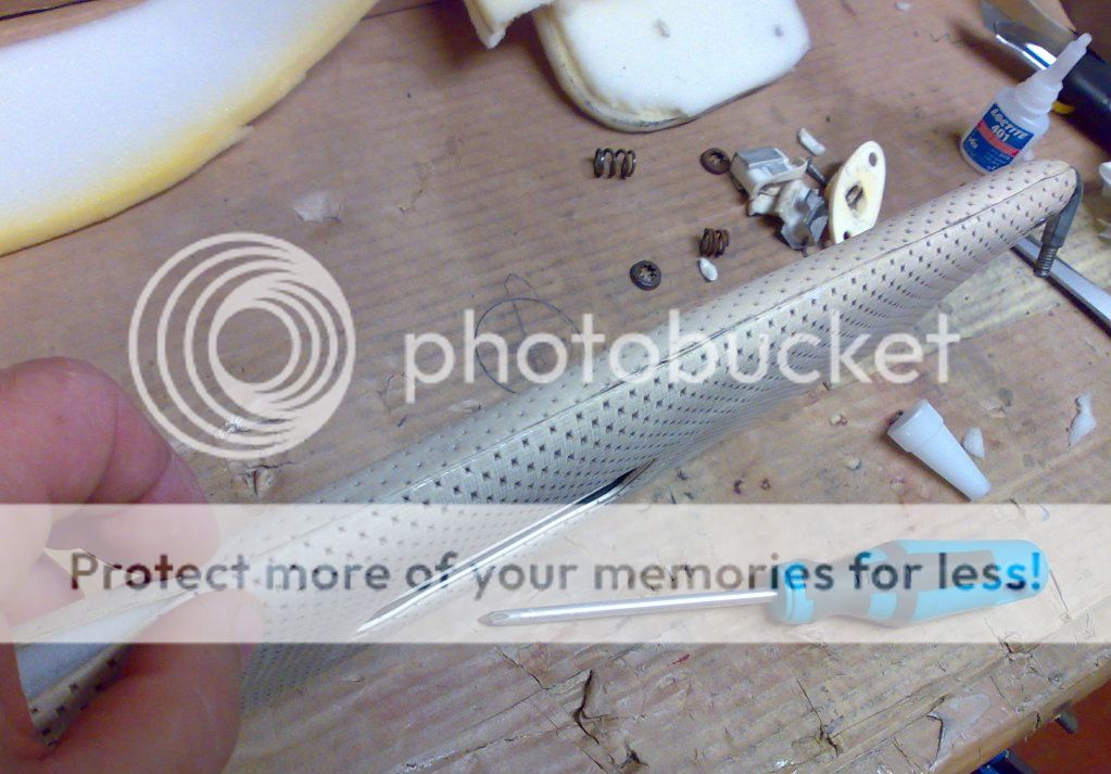

ok, now is done !
I used loctite 401

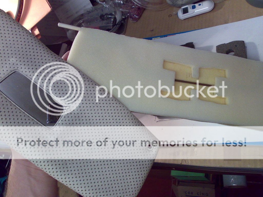

it won´t eat the foam, ok lets say "my foam", because there are different foams, here is a test: it only acts in the close surface of the foam like melting it down a bit, but it stops there
this is a foam used for upholstery purposes
so the work is very straight forward as jerry said, it goes very fast, i used my fingers and a screwdriver to pressa little the top while pressing the laterals with my fingers (this way i avoid my fingers touching the excess of glue potruding the joint), i started from one end, in small increments of one or two centimetres a time:

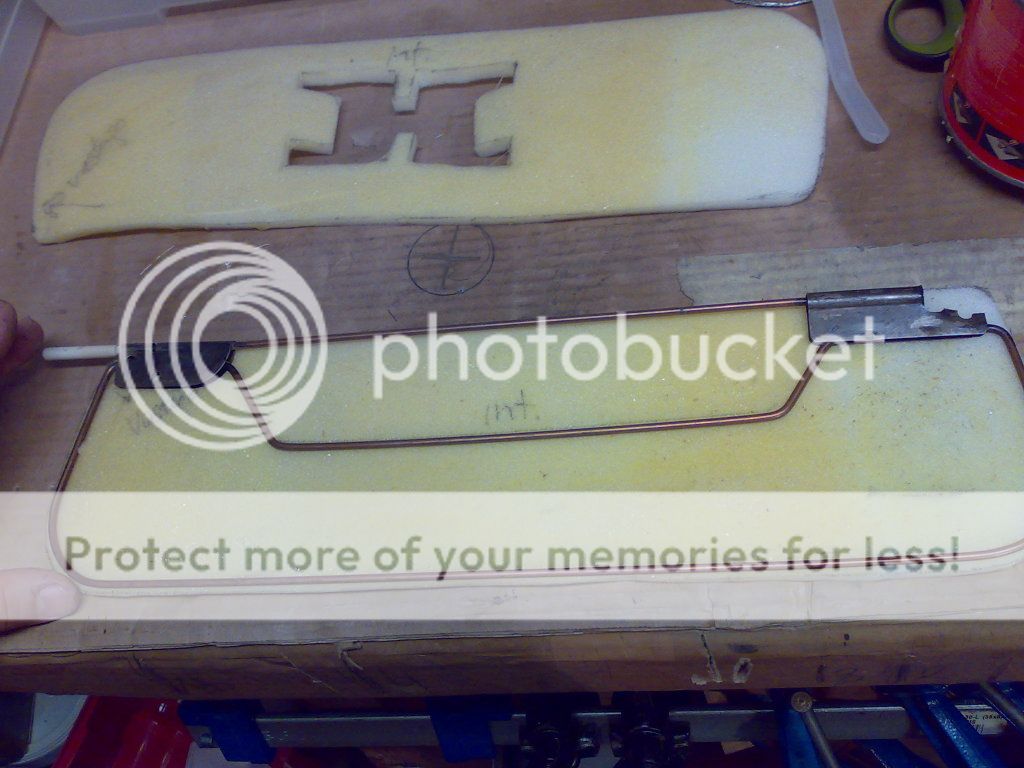

i am very sorry alberto, i can not get any specs of the foam, it was the one that i found in the car upholstery shop
just to sqy that it is 1cm thick and it feels a bit stiff under the pressure of your fingers
i think that this is the sort of thing that you can not buy online, but you have to touch with your fingers

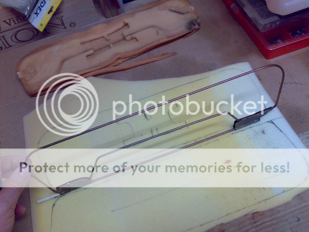

Very helpful. The pics of the exposed metal frame inside the foam helped me fix mine without having to take it all apart. Thank you DQ.
