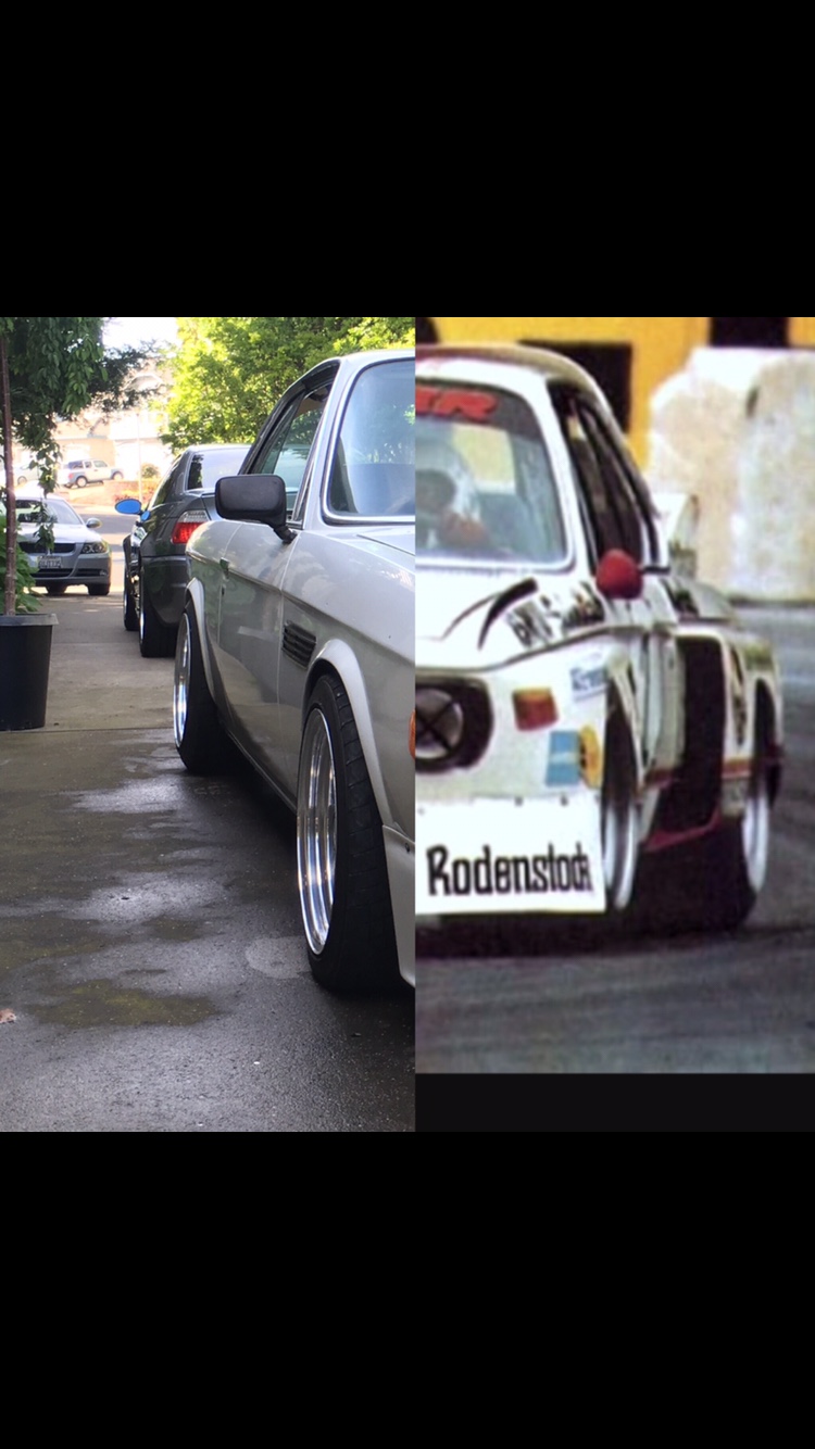

Next time, now I know what car is yours. Nice..... are the rear tires stretched a bit? I see it in the picture and thought I noticed that in person.
Yeah there's a bit of a stretch on the rear tires. No more that on the old Csl race cars
