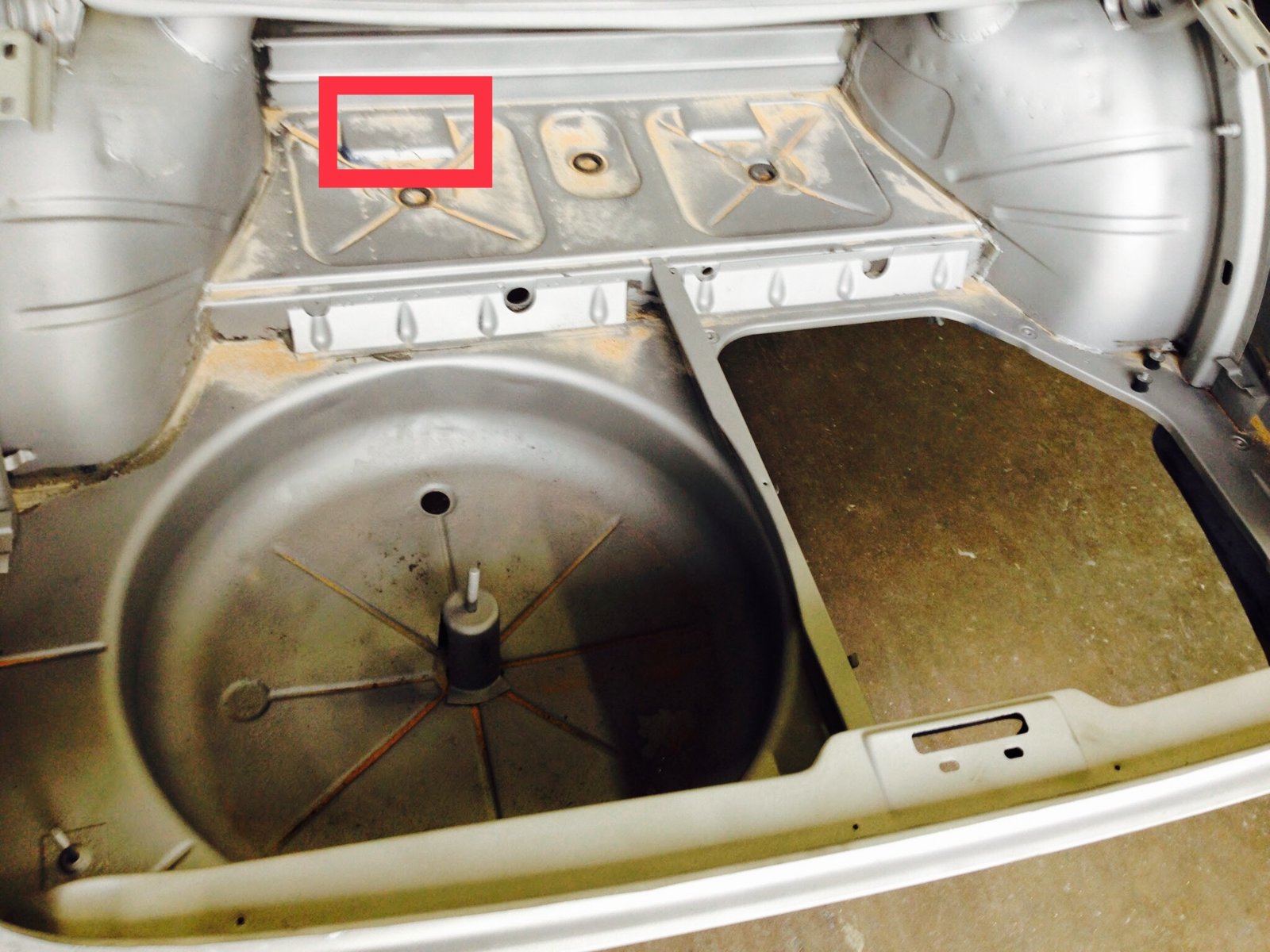

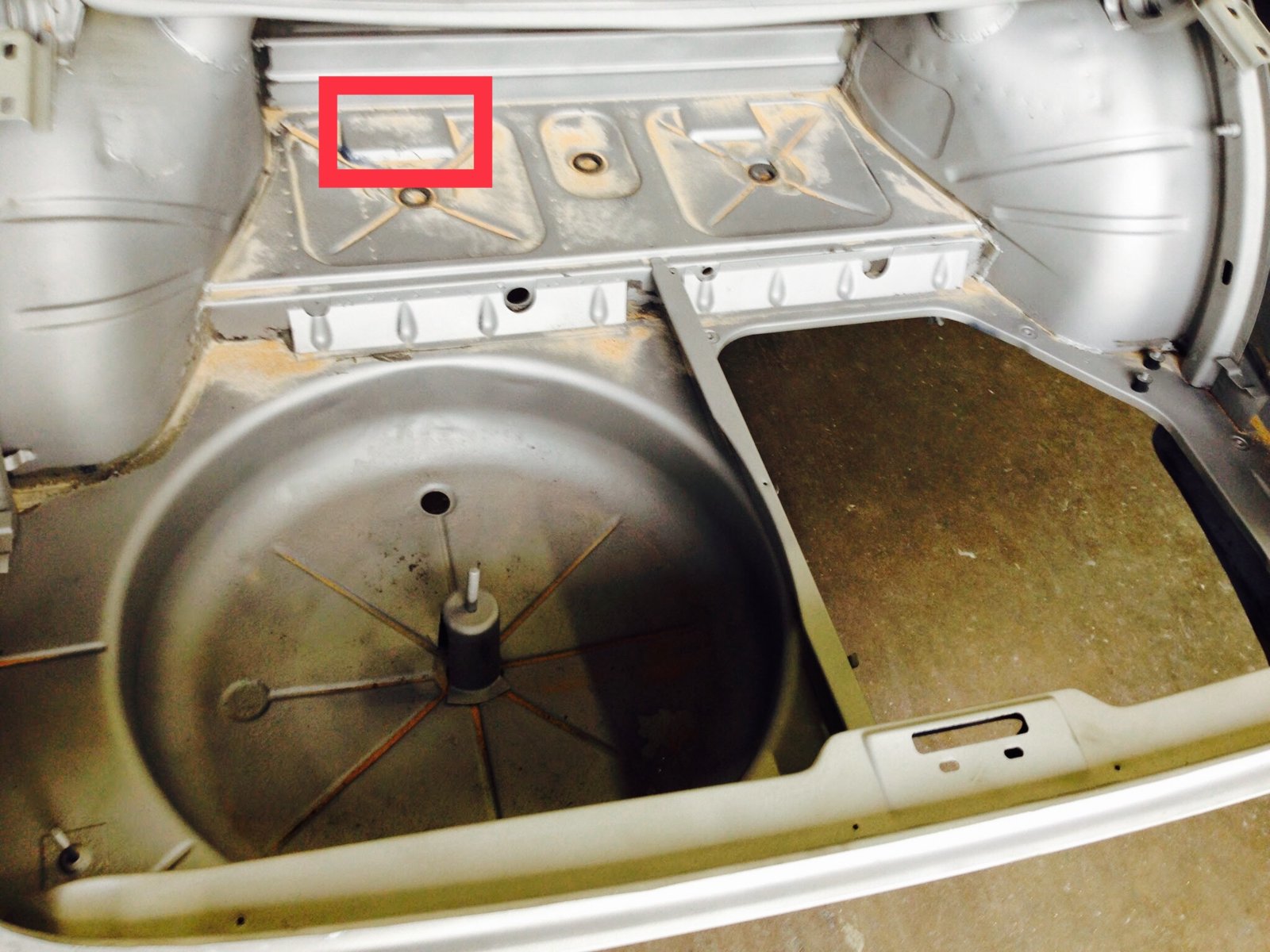

Mark -- as another option, I mounted mine using the bolts that hold the subframe bushing to the carrier. I chose this location in part because the fuel line in that area was dented badly and I wanted to remove the dented section of line. Both my mounting location and Steve's take advantage of the bushings used to mount the carrier to the body of the car as another layer of isolation from the vibration of the pump. If you mount to the underside of the trunk floor using the location in Markos' picture, or if you mount the pump in the area around the gas tank, you will have less isolation and more pump vibration transmitted to the body of the car.
Yep and I added some additional damping to the included isolation mounts and it is not audible when engine is running. Mounted under car not in trunk.

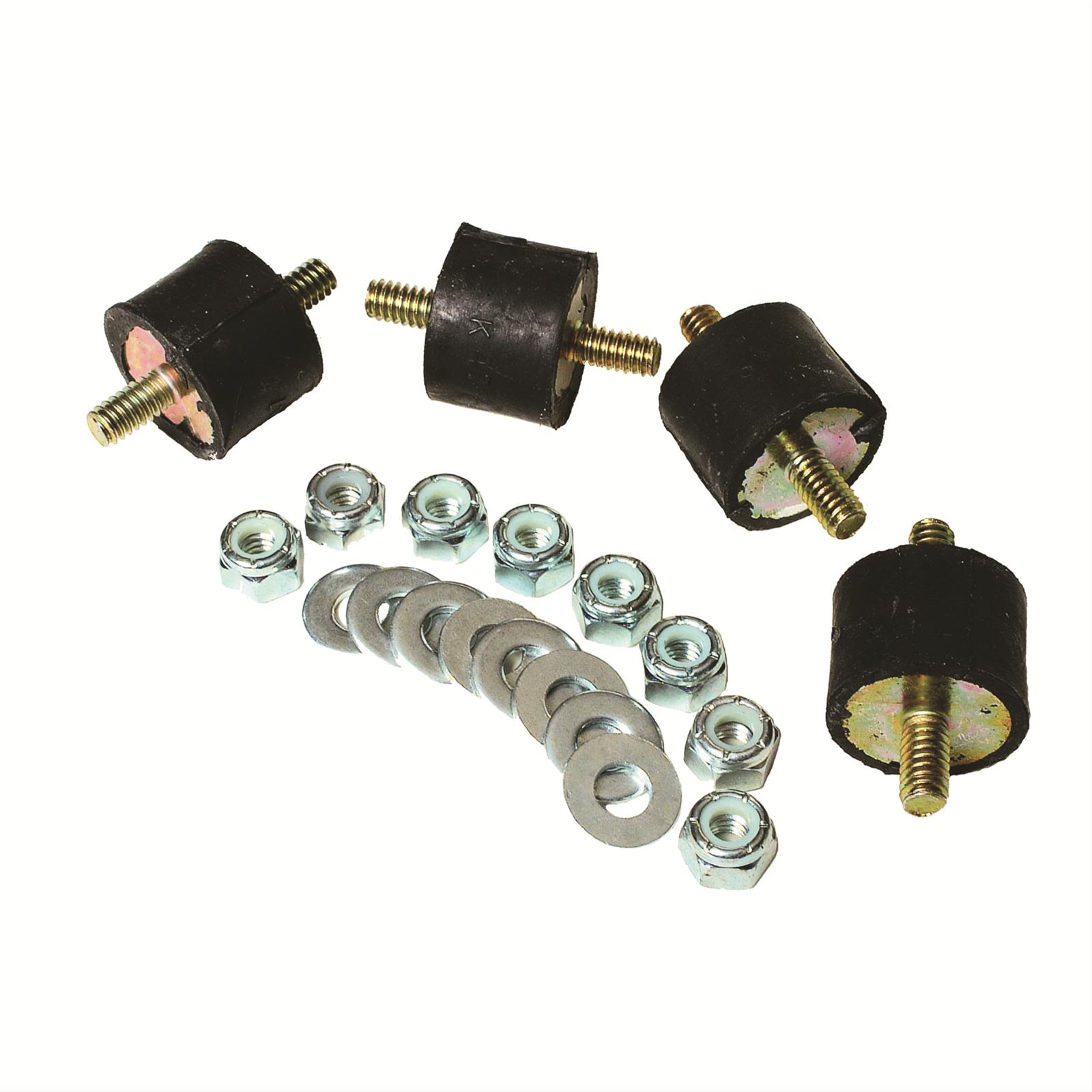

If you mount the pump using bolts that mount something else, and there is a layer of rubber for vibration isolation, wouldn't that prevent the bolt from being torqued properly?
It would if you basically had a big rubber washer. The way OEM’s do it (including the CSI/CSL d-jet pump) is to use these:
Mark, my question about rubber mounting a torque was regarding Steve's and similar, 'reusing' an existing mounting bolt / hole
The isolators you show would require new holes
My pump is quite a bit smaller than Steve's. It is held in place with a wrap around metal strap that has a rubber lining between the strap and the pump. Thus, the bolt is merely squeezing on the two ends of the metal strap. In addition, I am quite a bit less particular about torque specifications on a part that is not intended to move (as opposed to bolts on rotating parts, which I torque carefully).
