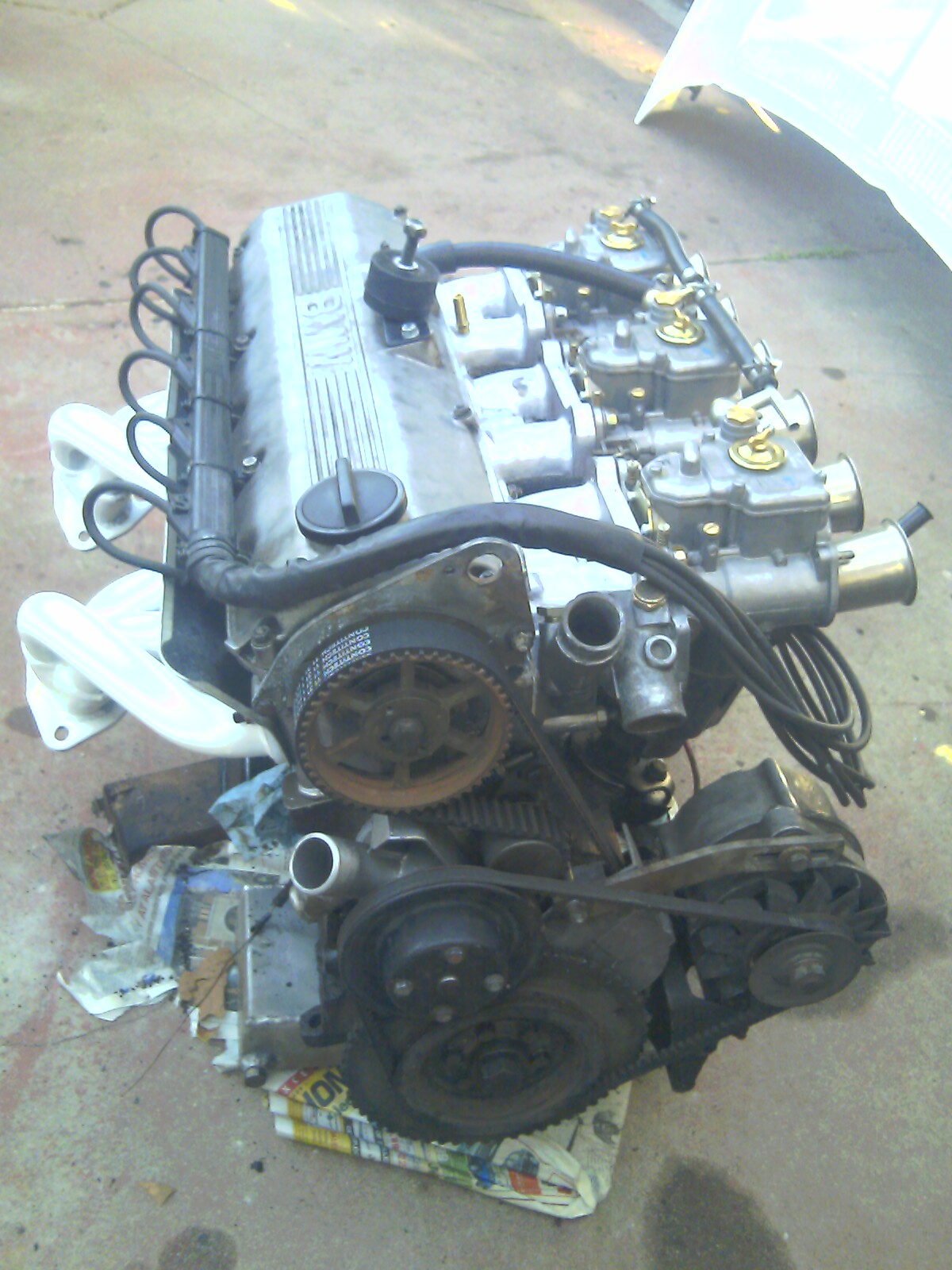

The growl was what originally got me looking at making the change. I love the induction noise. And visually, I think they are a lot more appealing. The performance stuff was what made the change a no brainer.
