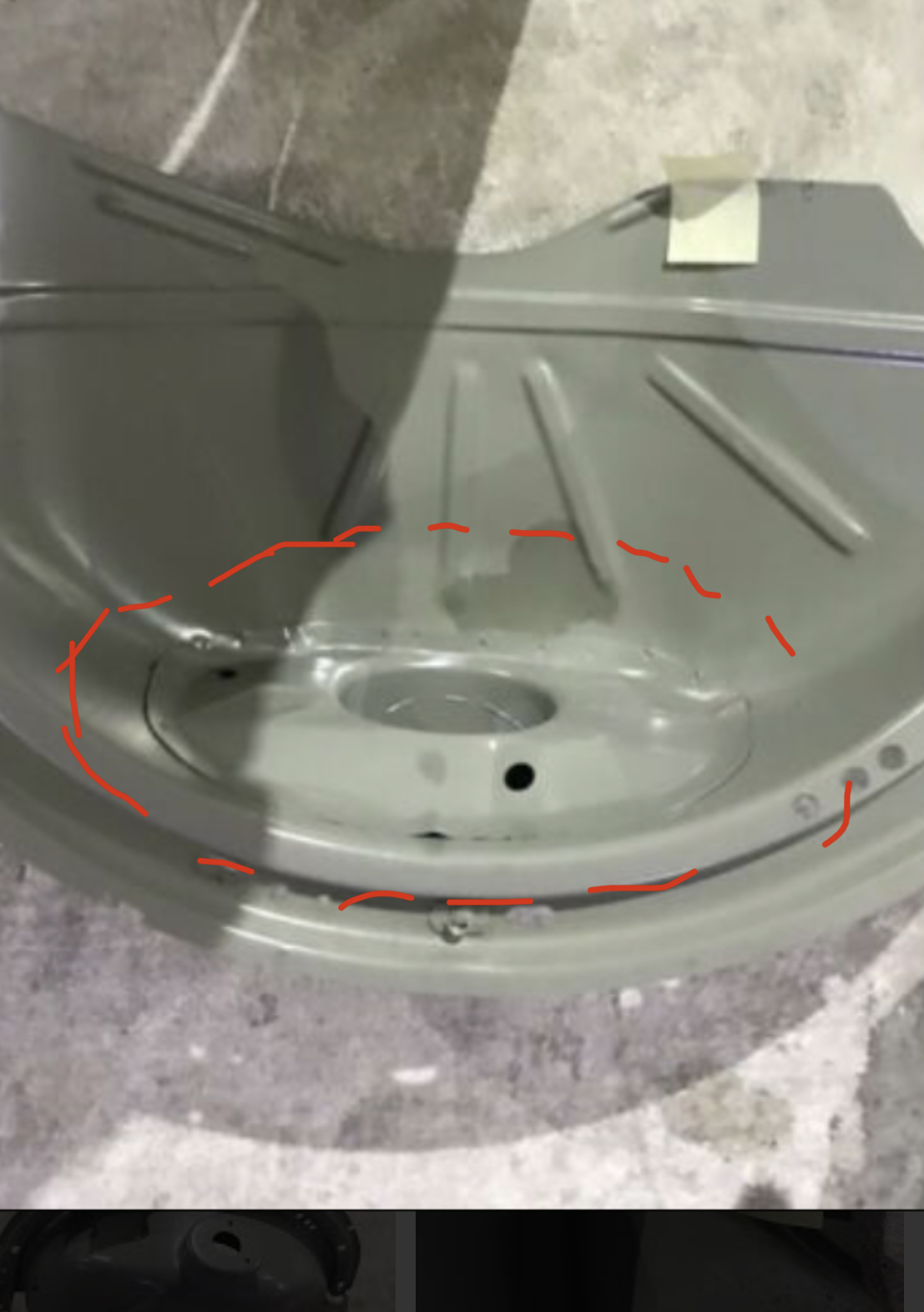

My plan is to cut out the whole strut tower and support from e24/28 and replace the entire strut tower & spring support from the e9 . That should sit hopefully high enough to give the strut the needed space.
attached is a photo, where you can see what I mean with „strut tower / support“
best regards from Germany!
Couple of observations, tower height needs to match your coil over set up, strength, as all the load is there and angle so spring doesn’t bind in the tower.
