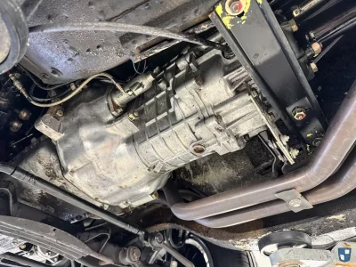

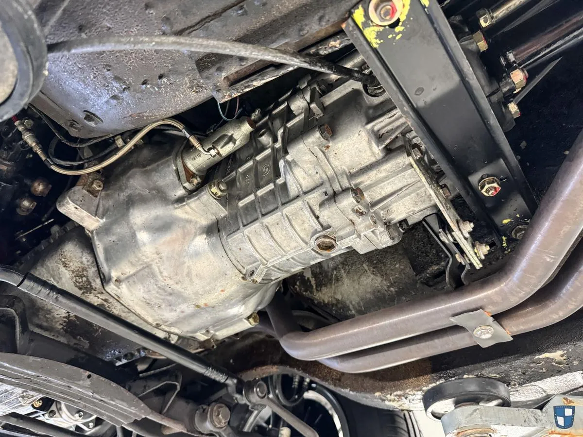

Great idea! that would be cool to bolt right up in place of the slave. What do you need, the bolt pattern for the slave cylinder/bell housing? I have my 4 spd still, and a 5 spd with new bell housing in case you go that way.Are all e9 a hydraulic clutch? Theoretically the linear actuator could bolt right to the bell housing. Does anyone know the bolt pattern on the clutch? I can draw it up and have send cut send water jet it for me.
Larry, Your 5 speed uses the 74 and later bell housing, I assume that is what you have.Hello, I would be interested in this matter due to neuropathy in my left foot.

1972 BMW Bavaria . 5 speed Getrag with 4 speed bell housing.
