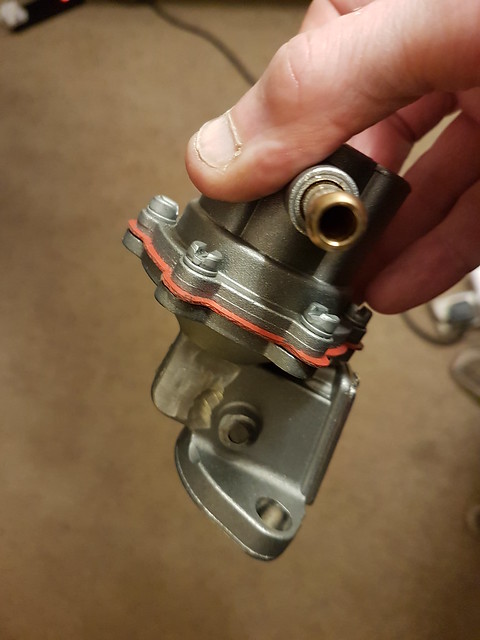

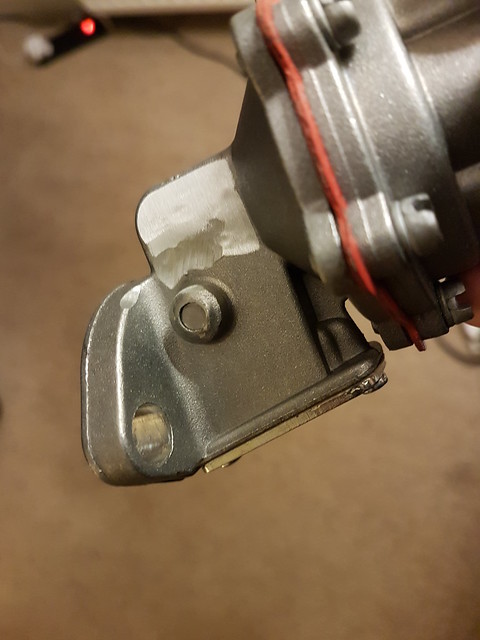

I've ordered a new pump, Pierburg was the only option I could find. To be honest I'm not 100% on this but if I fit the new pump and see good delivery before connecting to the carbs then at least I can rule the pump out. I've never had it run badly on the road, this is a fairly recent development, although wear in a component will tend to produce a slow deterioration, I can't say I've noticed it driving the car. Anyway, I'll report back once I've fitted and tested the new pump.

BTW, we do not know which kind of pump @E3_UK has in his car, i would suggest some pictures

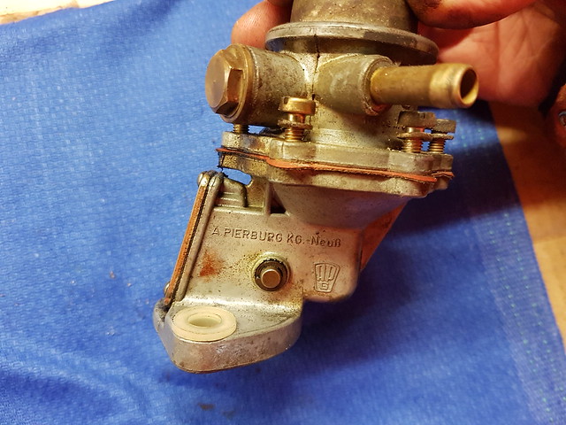

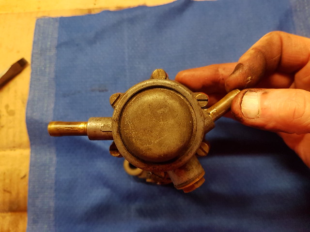

note, my experience with these fuel pumps is that the small piece that transmits the movement between the pushing rod and the memebrane rod can be damaged due to wear, it is yellow metal,...just in case
The current pump is also pierburg, i thought it might be the original but not sure now.
some old information,...
the repair and the case of the wear part,...
The rebuild kit is 13311255184, not sure if it is available any more, save an eBay search. I rebuilt one a few years back, you need to make sure the diaphragm is tightened in place with the pump in the middle of it's stroke so it is not stretched one way or the other. Some other tips here:
that is the veryvery early one
