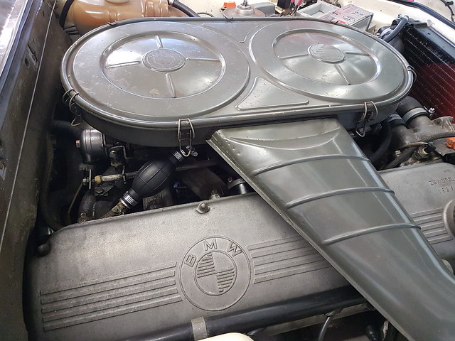

The final solution, the nrv still seemed to be allowing the carbs to empty over several days so I replaced it with a manual primer and it works a treat. Half a dozen pumps and the system is full and the fuel pump is able to keep up with demand thereafter. I know it's not a cure as such but if it works I'm perfectly happy with it.
20200423_193806 by Robin Derrick, on Flickr
