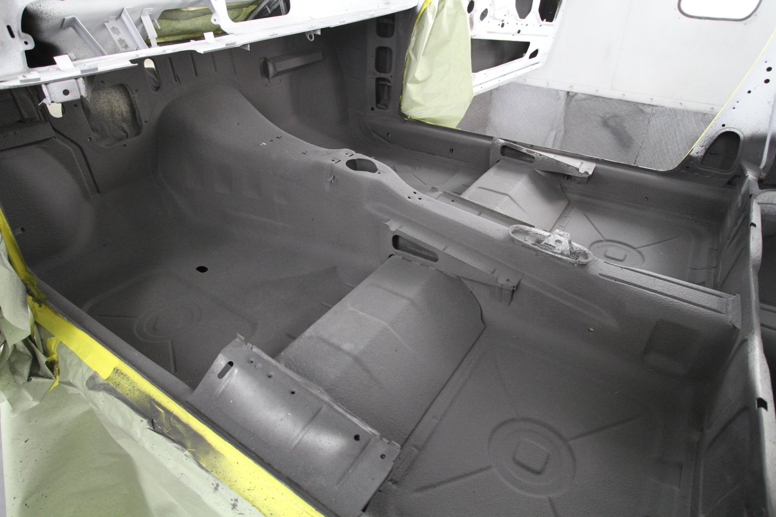

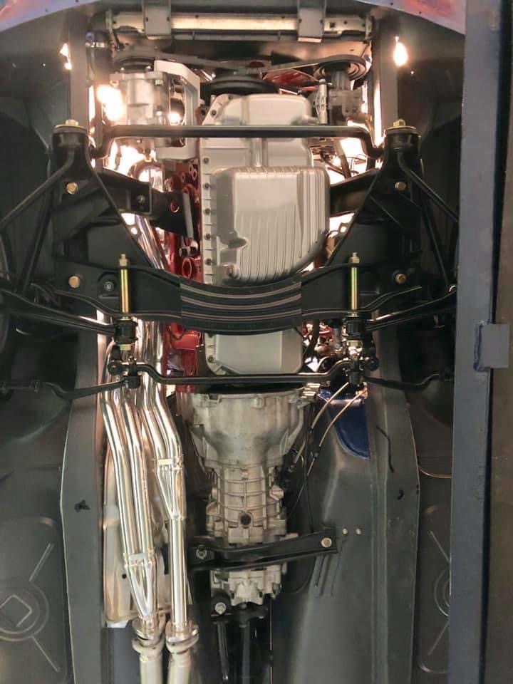

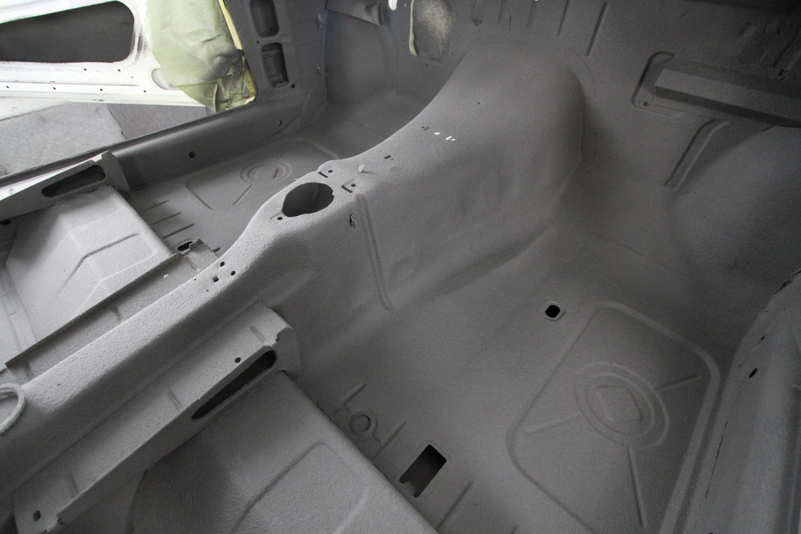

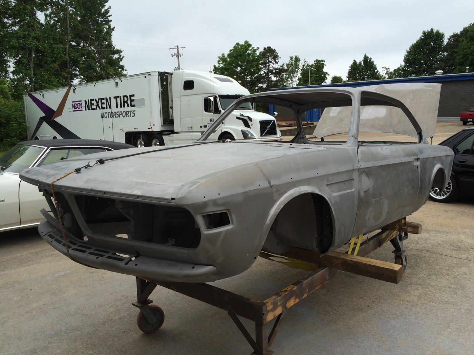

I'm late in here and probably posted something about this 4 years ago when I started my coupe but will provide a little info.
I'm in Atlanta GA and didn't find a dipping process here at that time.
When I read up on this the "cool" thing to do at the time was Soda Blasting.
I did this and cost about $1200 and no warped panels.
There were a few places they didn't or couldn't get to or inside of.
Body was bare metal though and my painter sprayed it with gray epoxy primer to protect it while the metal repairs were done.
My metal guy did have to remove the epoxy paint in the areas where he had to weld.
Overall it was pretty good. 8 or 9 on a 10 scale.

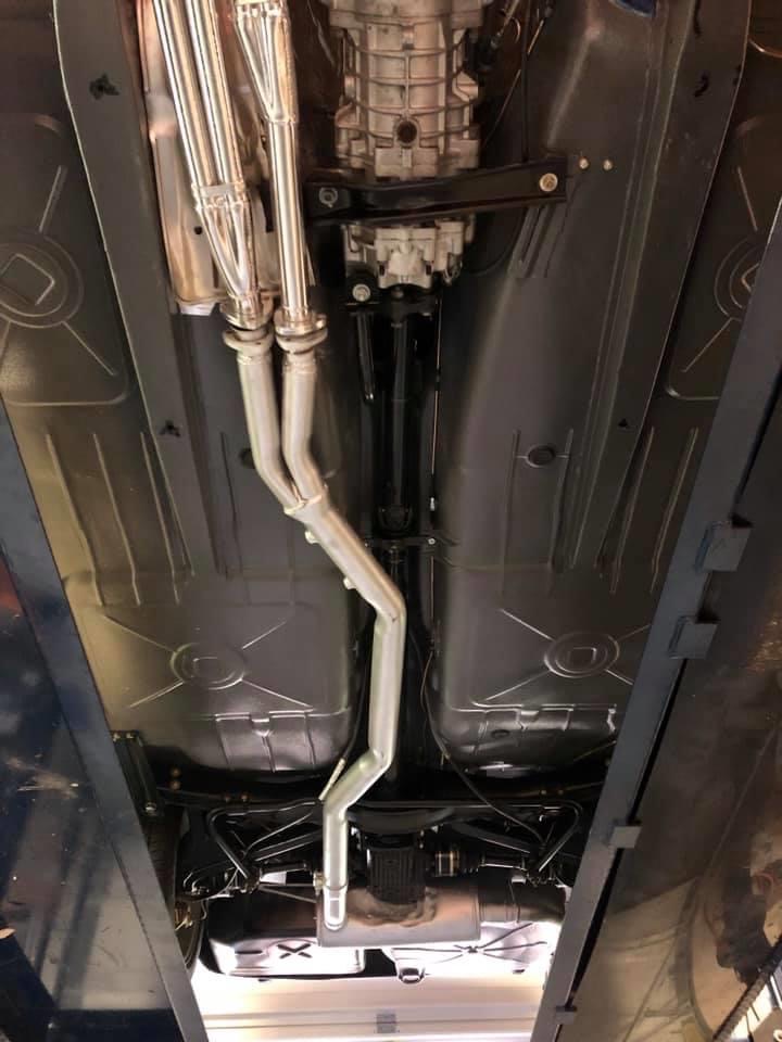

My interior was coated with a material called Lizard Skin. Actually 2 coatings. One for sound and one for heat. We coated the trunk too. Then painted the dark gray with the body color.
My under body was sprayed with a material like bed liner. You can tint it any color you want. It has a little texture to it.
My car is NOT a restoration but a period correct Hot Rod. So I did what was the best to preserve the car as it gets driven, a lot.
