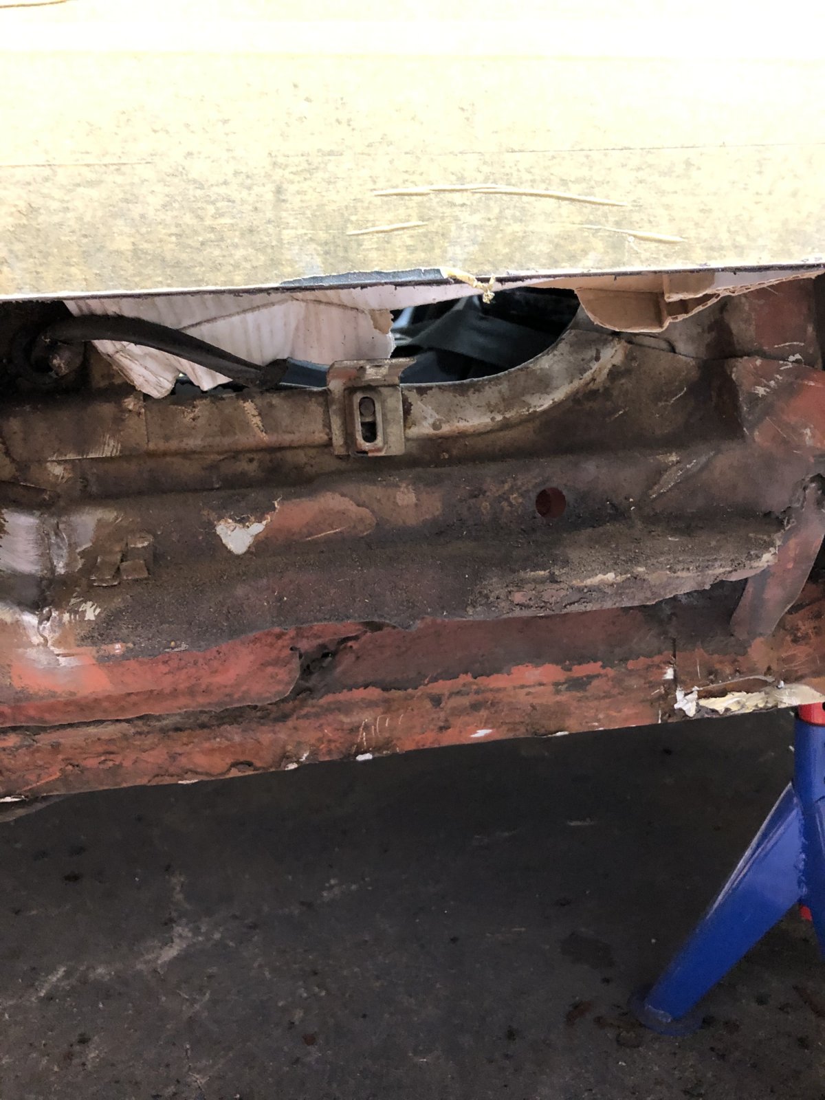

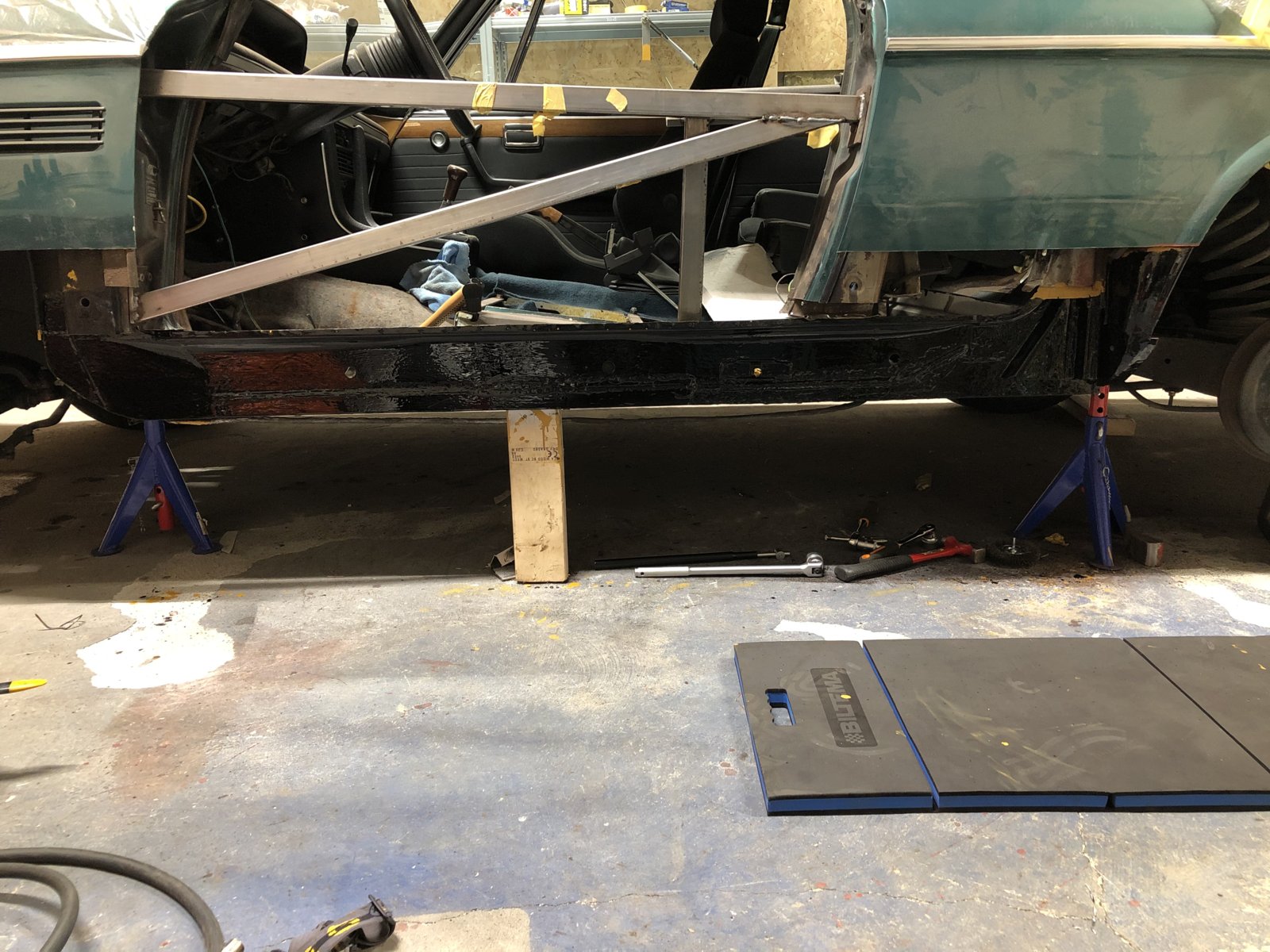

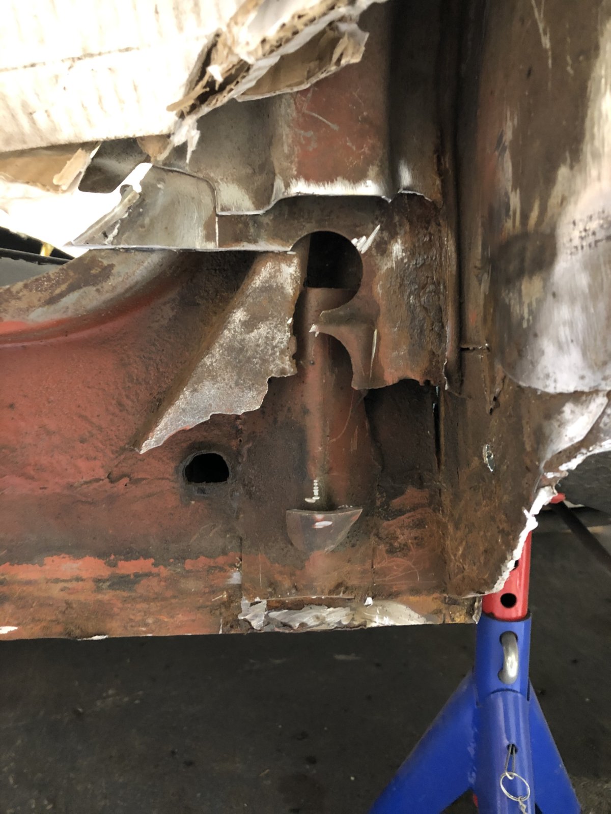

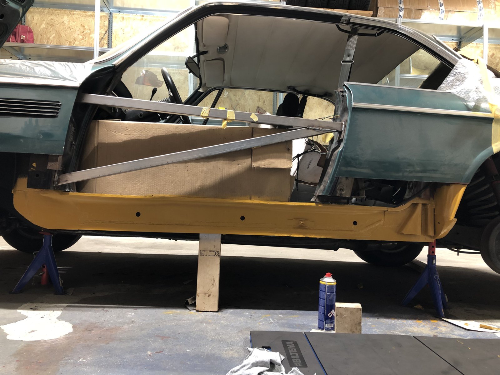

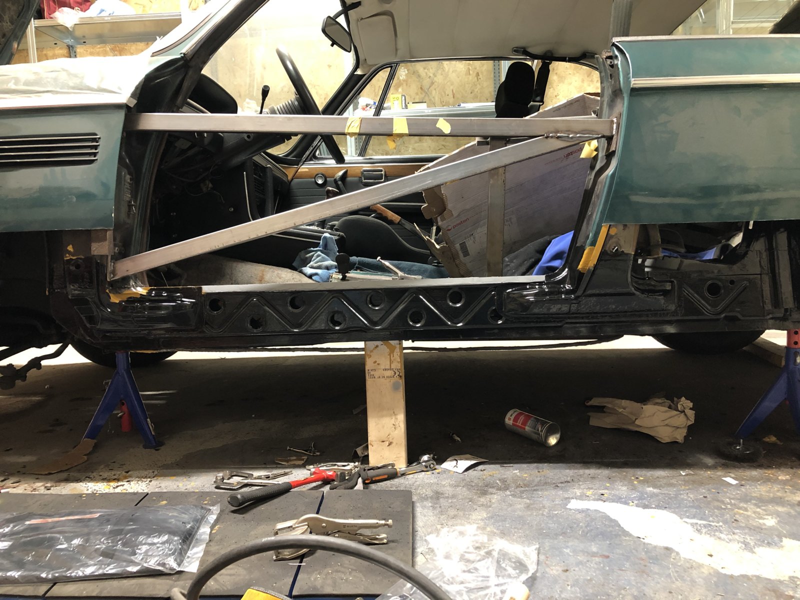

First I cut of a part of the front outer sill and revealed the A-pillar support, it did not look good, pictures below. There was also welded in som extra pieces of metal to the middle sill to substitute the rotted metal that was cut out. Too thin metal gauge and poorly executed. Since I have to buy the entire sills only to get a small section, why not change it all? So I cut off the entire outer sill and middle sill. Doing this, I had to take out most of the interior to weld in some reinforcements, so the car won't bend. When most of it was out, why not get it reupholstered? So i sent the front seats, rear seat, arm rests front and rear, door cards and senter console to a re upholsterer. The interior job will be posted in this thread later.

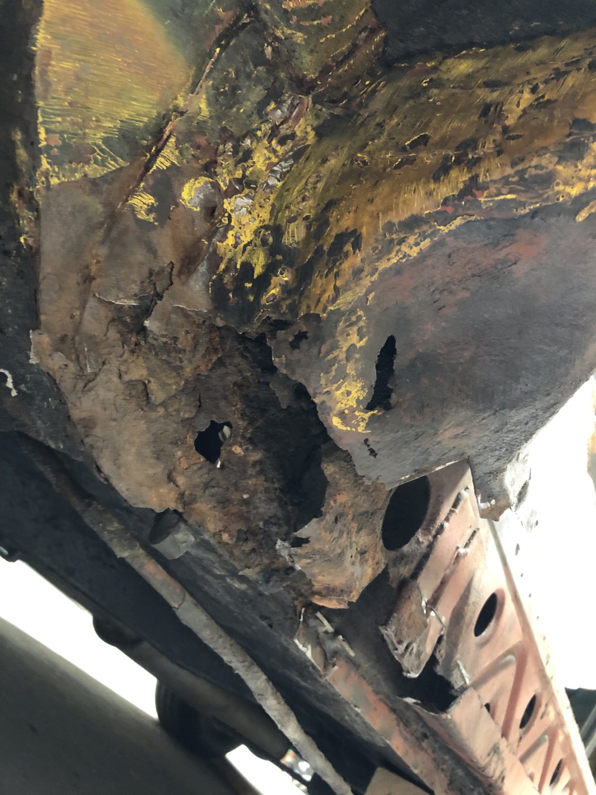

Picture of the bottom of the A-pillar:

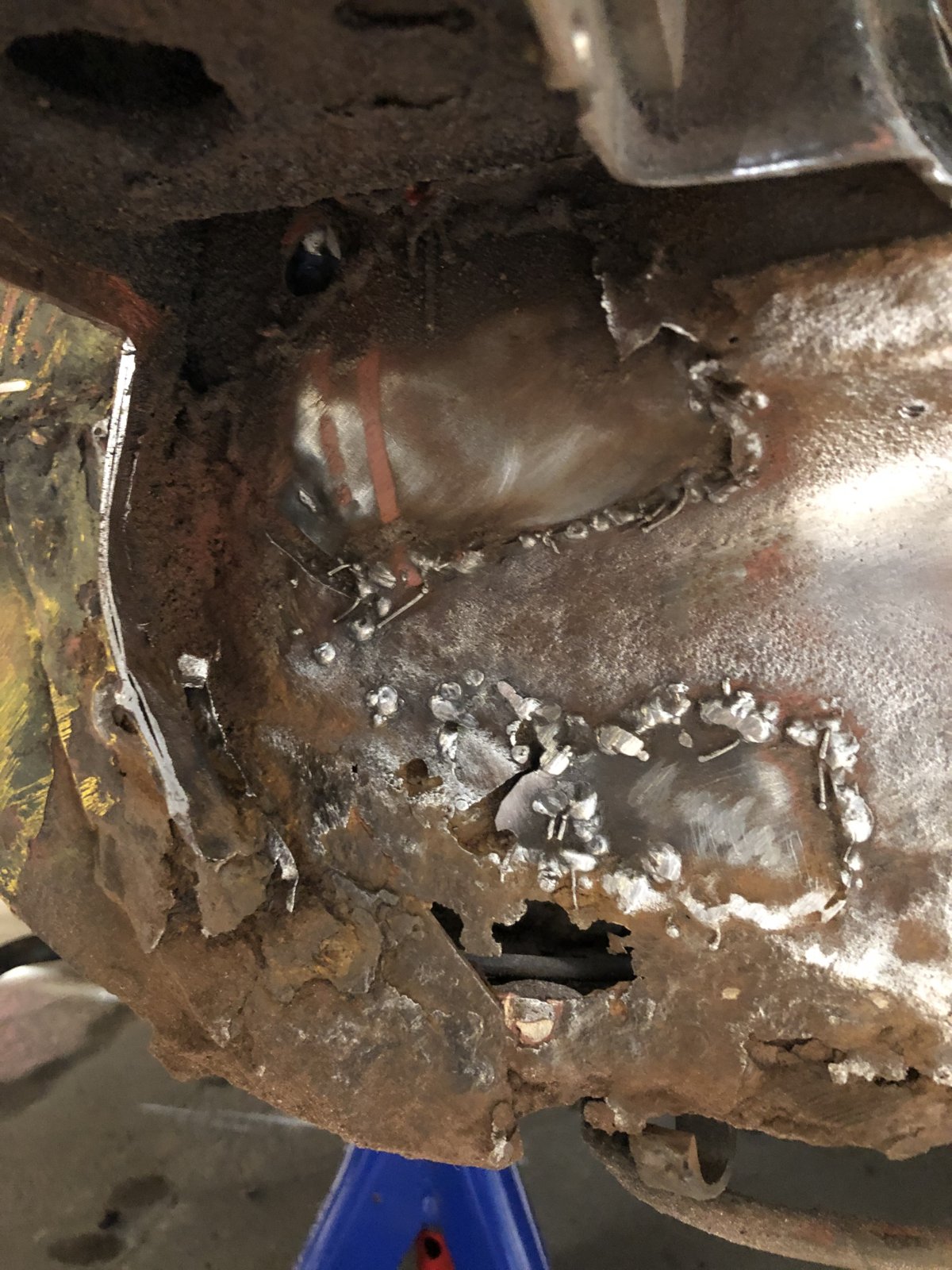

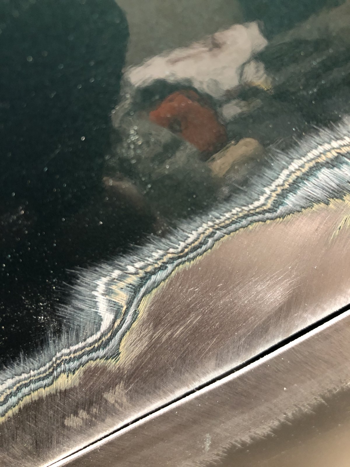

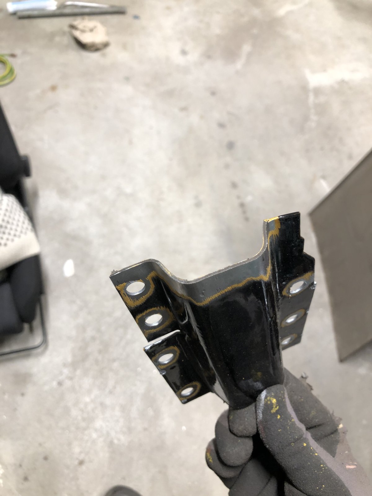

I cut of the bottom and revealed some art work. Some quality welding going on here.:

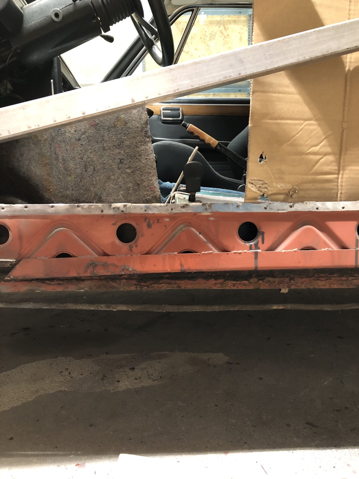

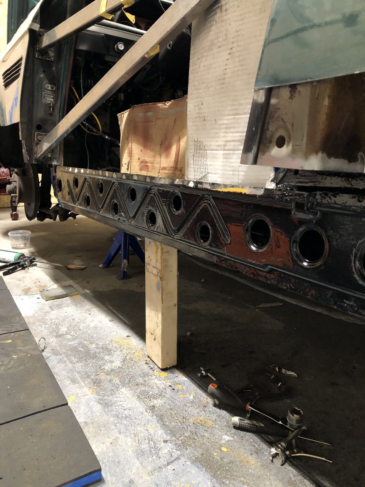

The middle sill didn't look too bad. Most of it was good metal.

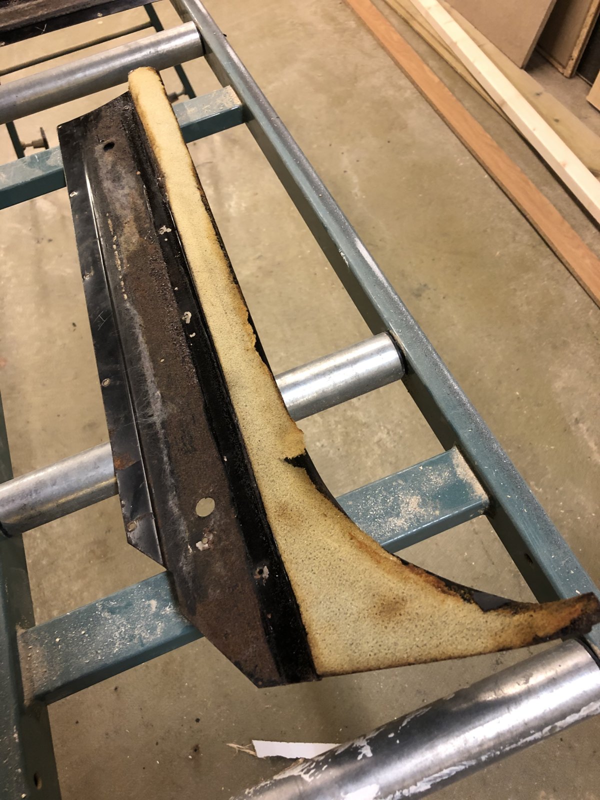

Most of the outer sill was formerly just removed and not changed. I found parts of it in here. The rear fender was just welded over it all an covering it all up.
Where the triangle part is supposed to be, I found a fence post reinforcing the jackpoint. It was probably strong, but not beautiful. I would like my car mostly original structurally, so no place for a fence post in here!

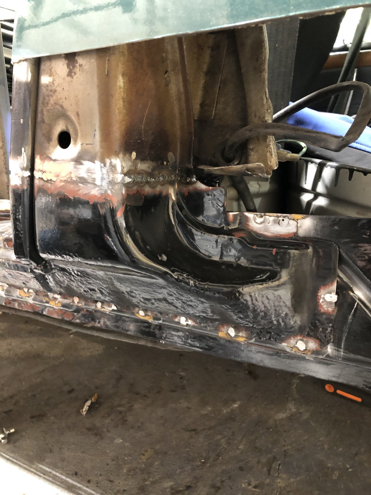

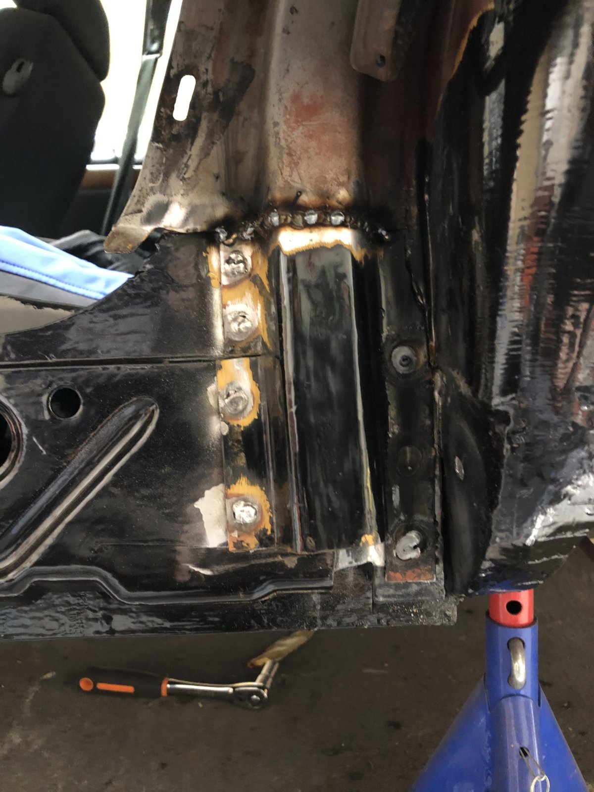

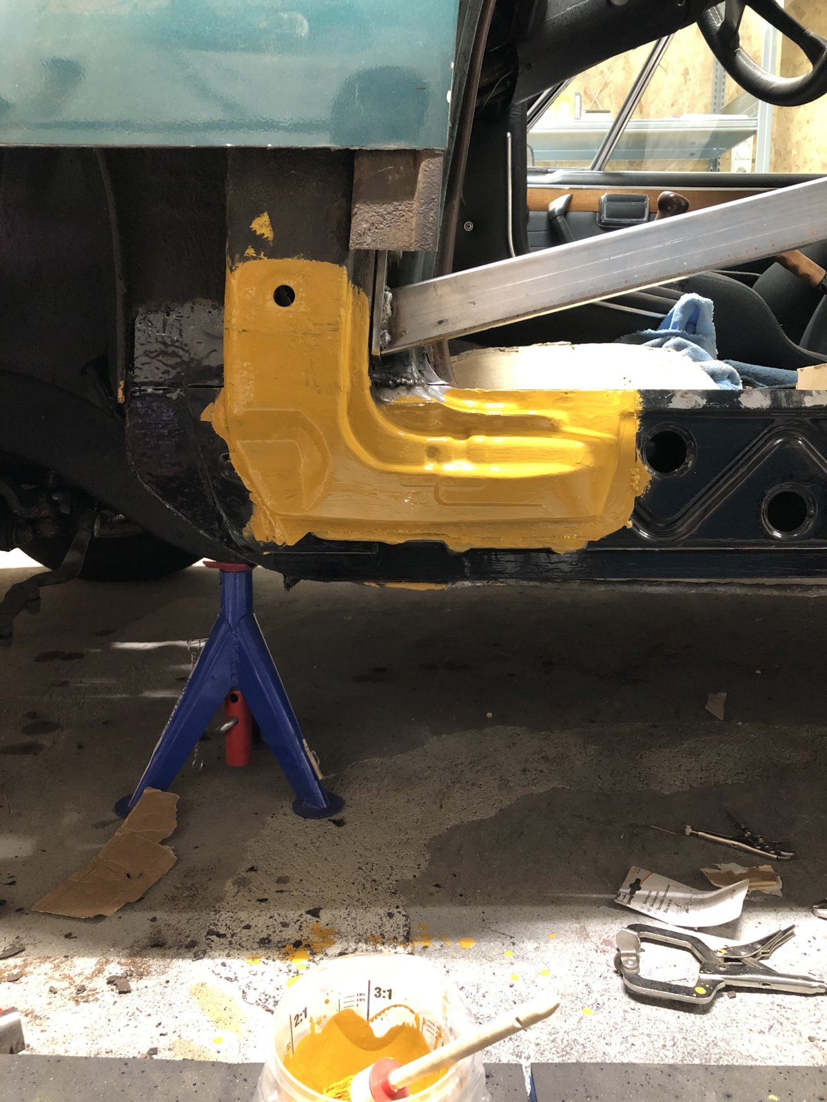

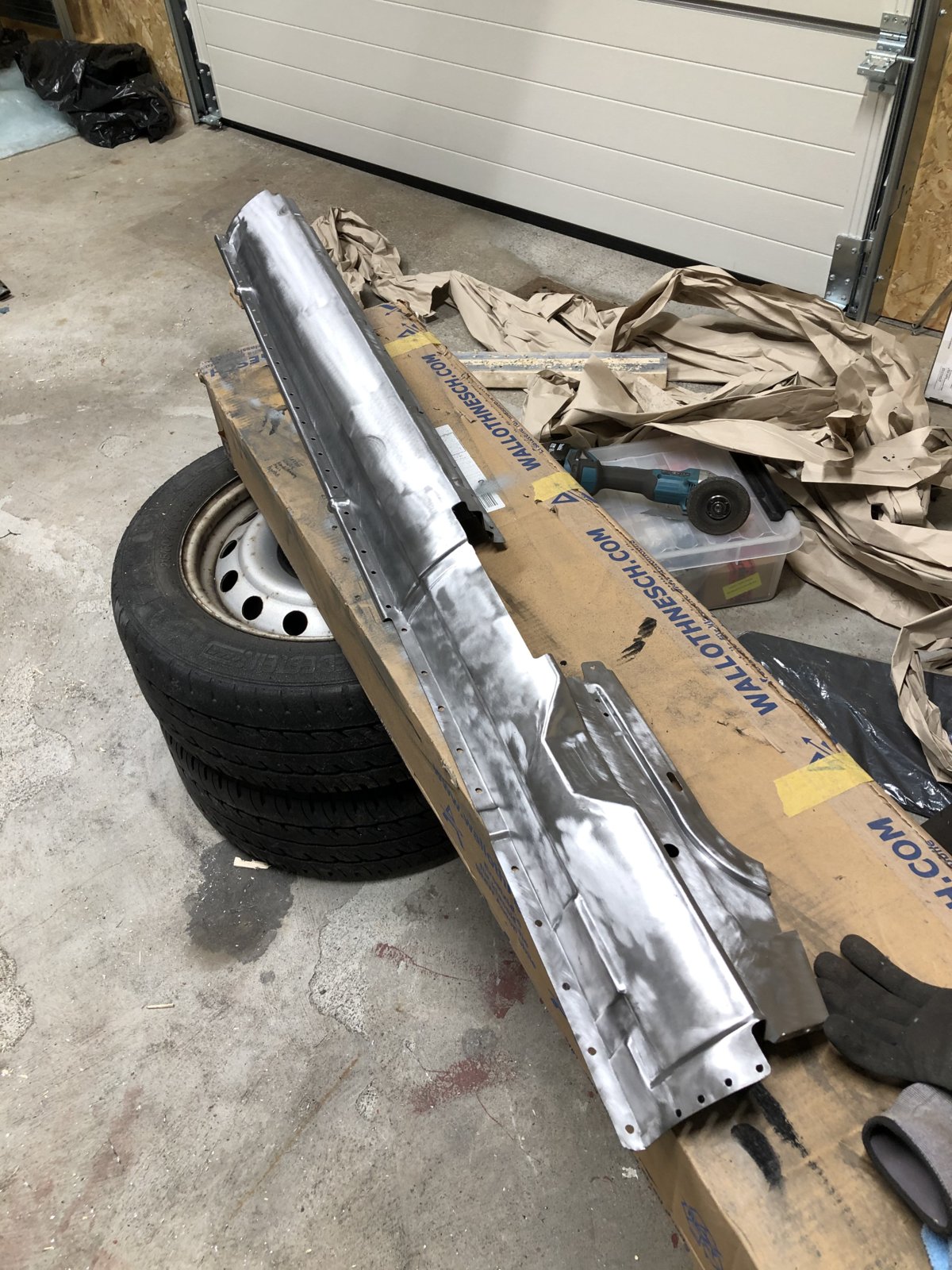

Long story made short; I took it all of and started fixing the inner sill and recreating the triangle parts from pictures found on this forum:

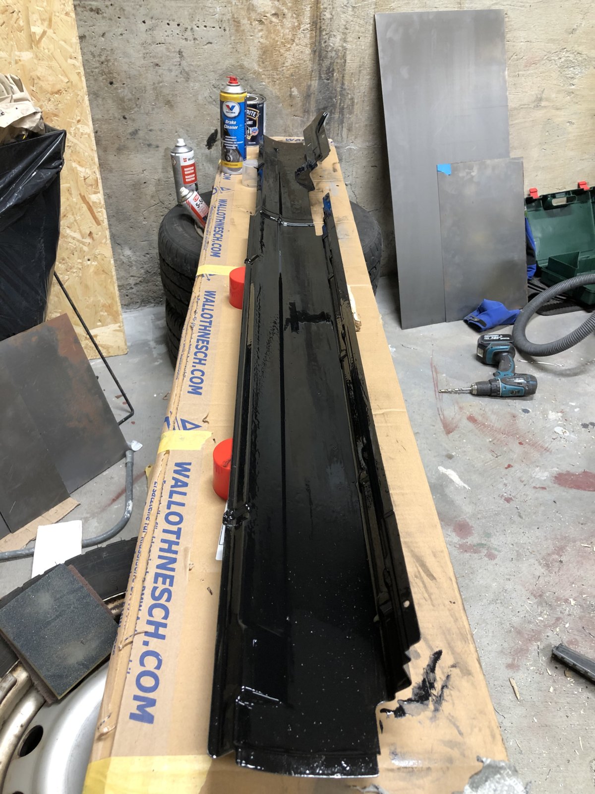

2K epoxy primer:
Painted with a rust preventive "waterproof" paint. I used the same stuff outside mye house on some rusted steel 5 years ago, and it still look like new.

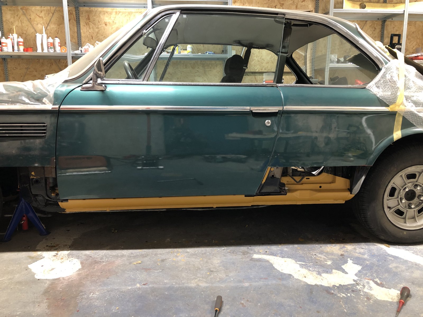

The other sills got the same spa treatment on both sides:
Made a new piece at the bottom of the wheel arch. Dont ask me why i painted it on the outside before welding it in place, I dont know!
The piece in place:
Bottom of the B-pillar was in god shape, so i just sandblasted both sides, painted it with 2K epoxy etc and welded it back in.
A new A-post bottom in place:

Looking like a car again:

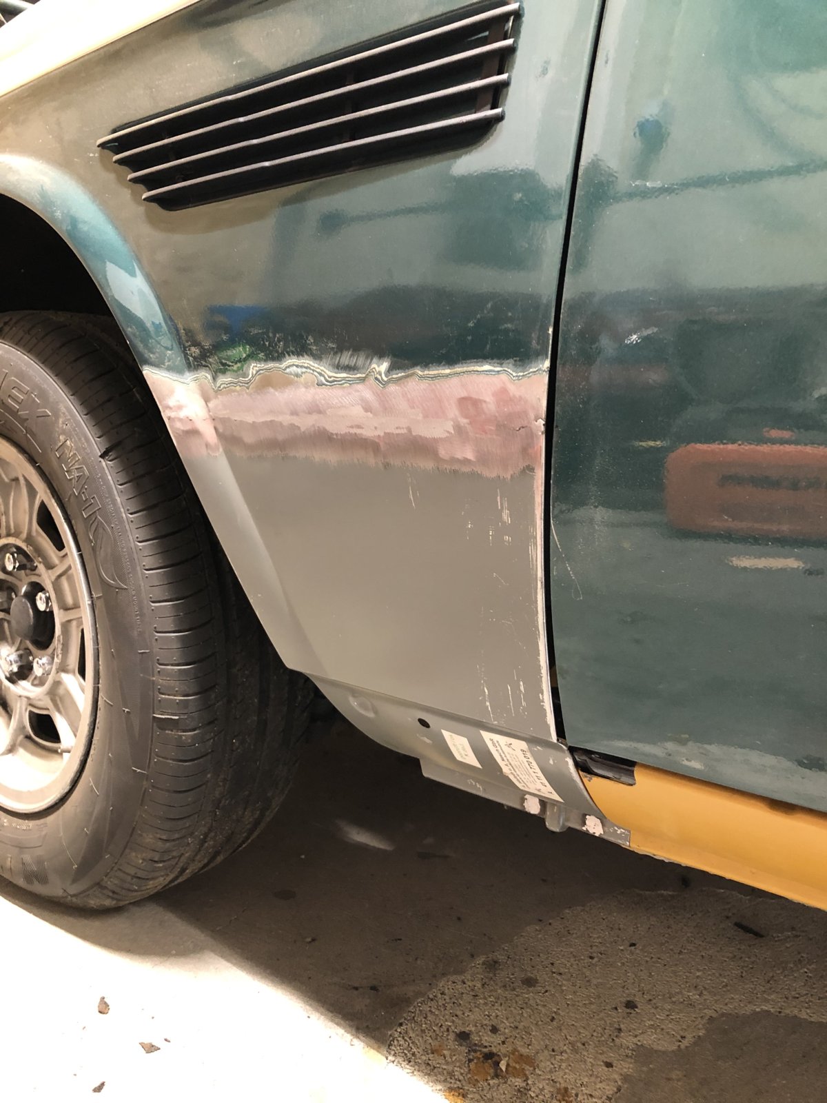

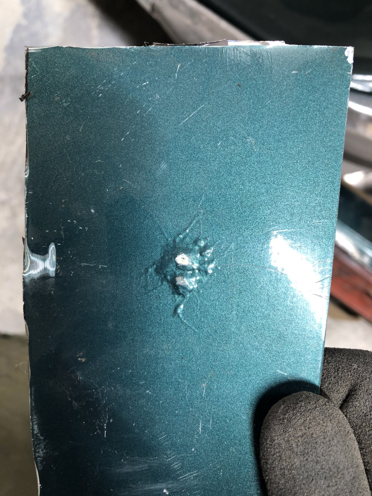

The only thing showing on the front fender was this:

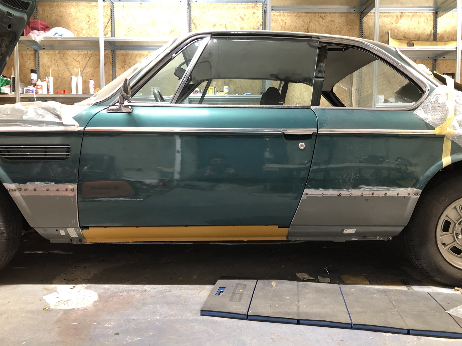

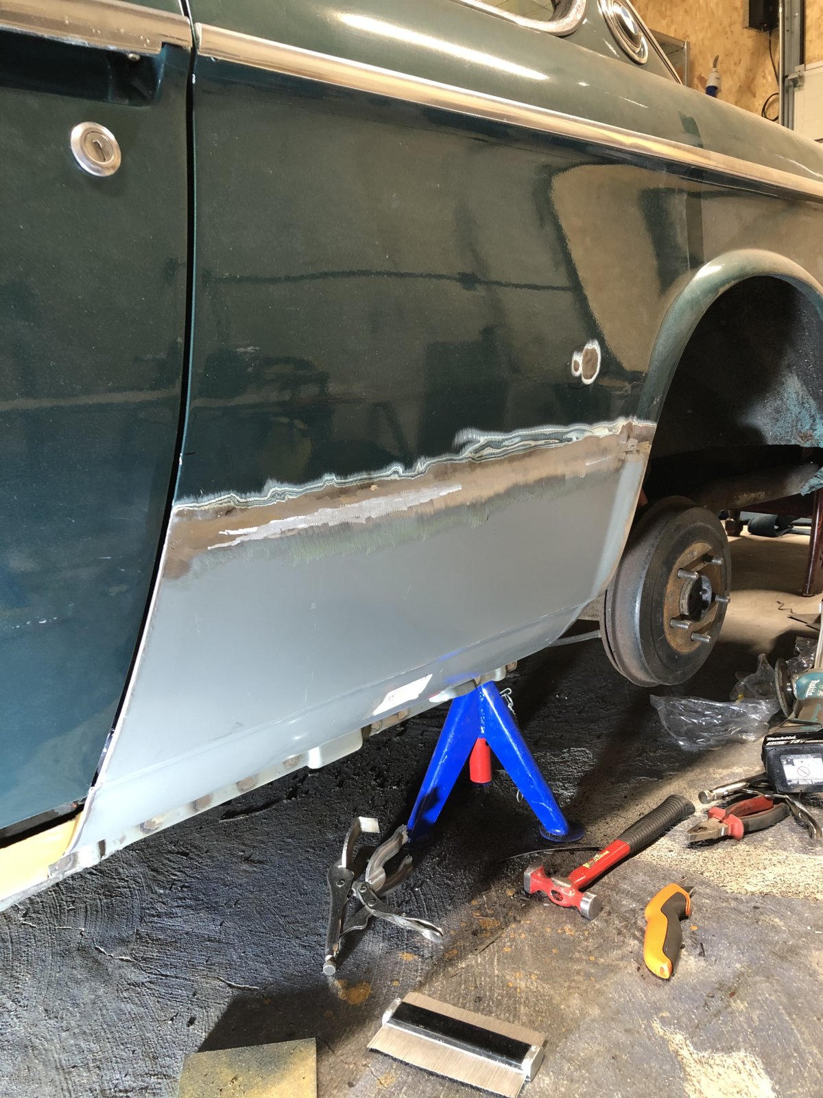

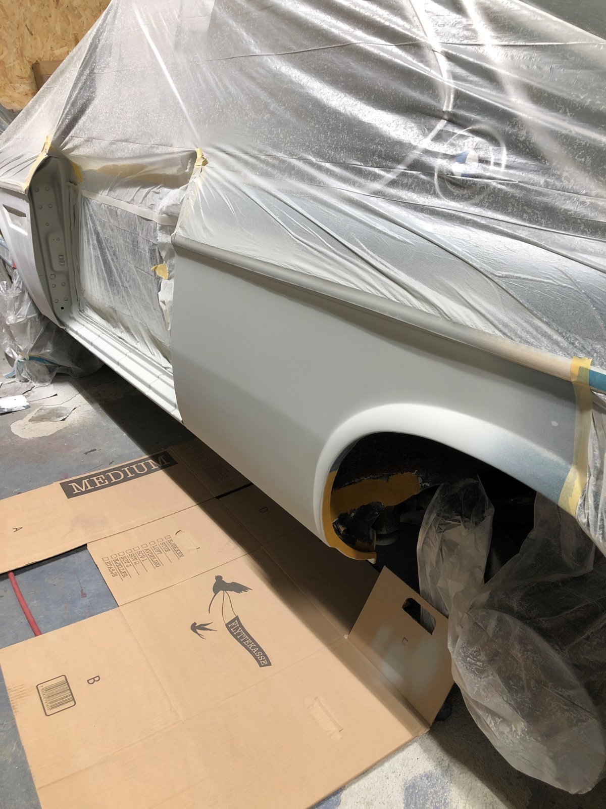

I finished welding, bondoed, sprayfiller and started sanding. I'm waiting for my new sparaygun which gets here probably monday or tuesday. Cant wait to be finished with this!

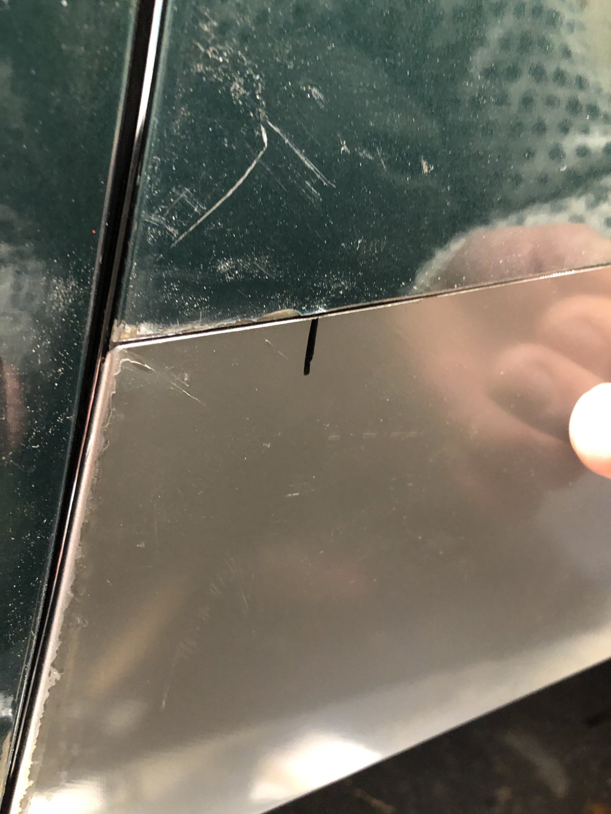

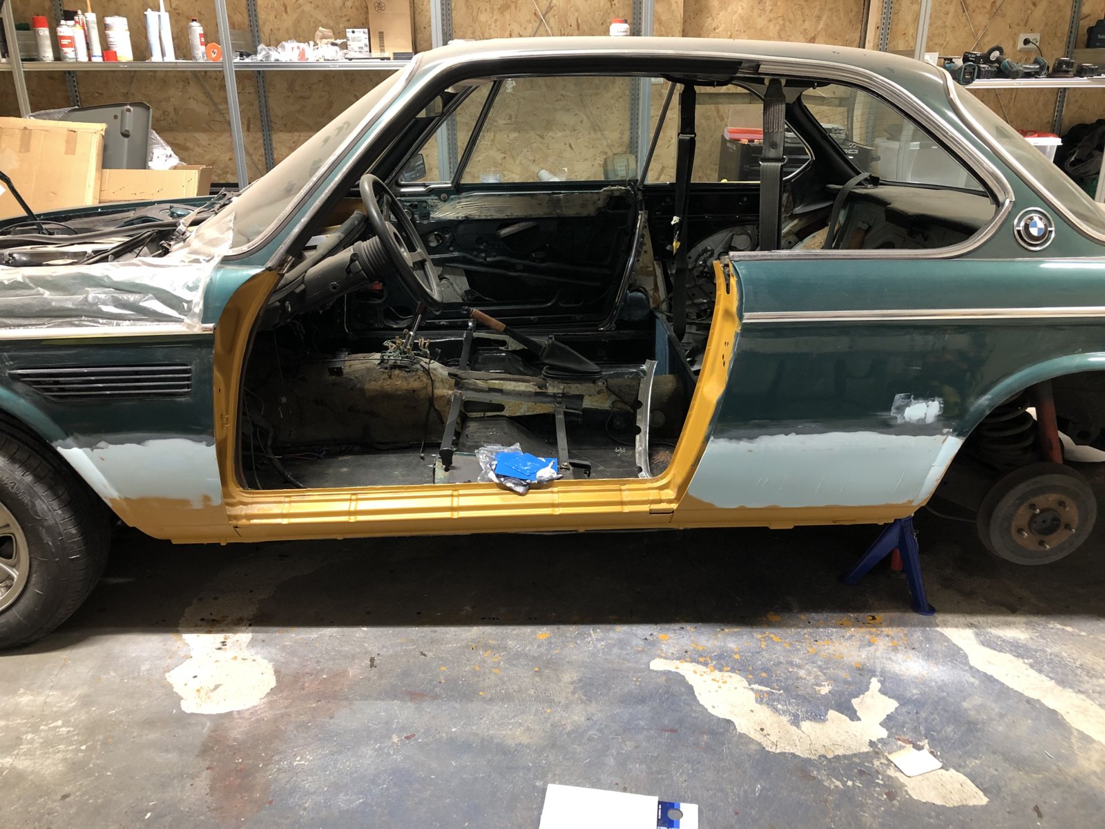

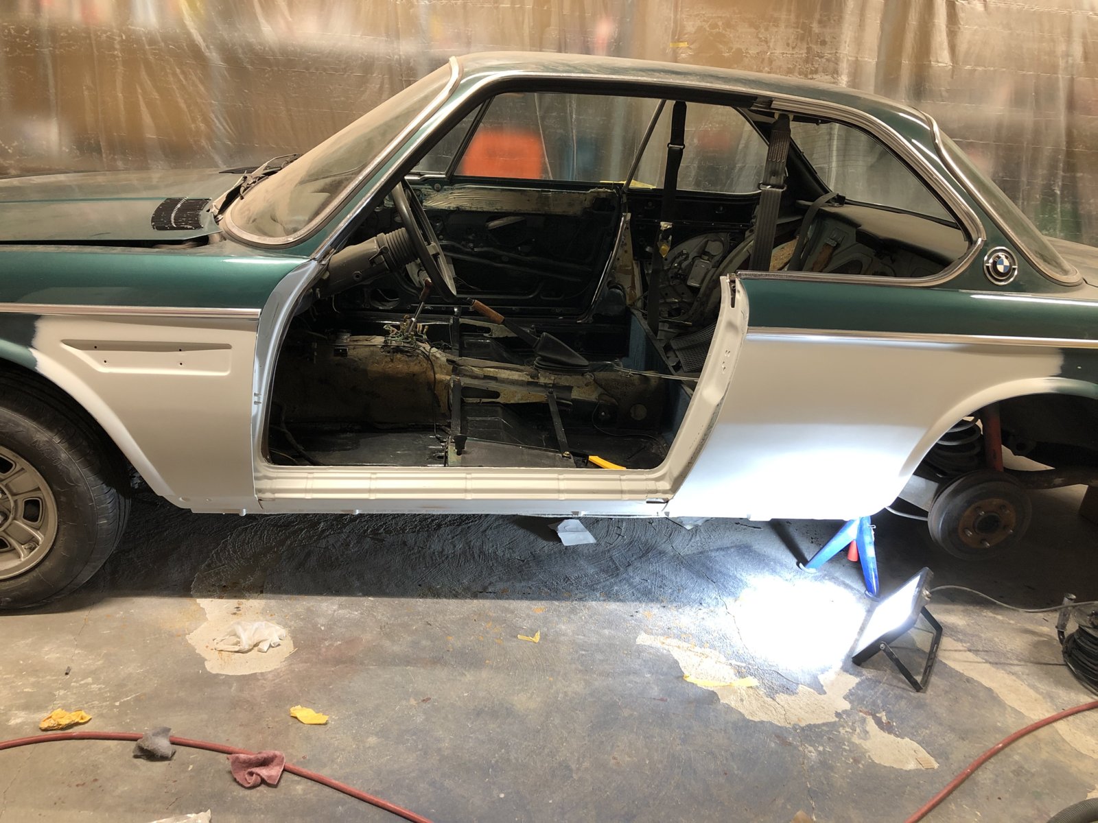

Welding finished: Got into a little panel-gap problem between the lower part of the fender and the door, it looks worse in the picture than it is. I think it's the door that has been fixed poorly int the past, they also have some rust in the bottom, so I bought two new door skins that will be mounted probably next year. I removed all the grey primer from WN, and used the yellow 2k primer on both front and back fender before filler was applied.
First layer of bondo (I use Wurth, not bondo)
Spray filler applied, and sanding started in the front. If you look closely in the rear wheel well you can see the draining tube now exits there:

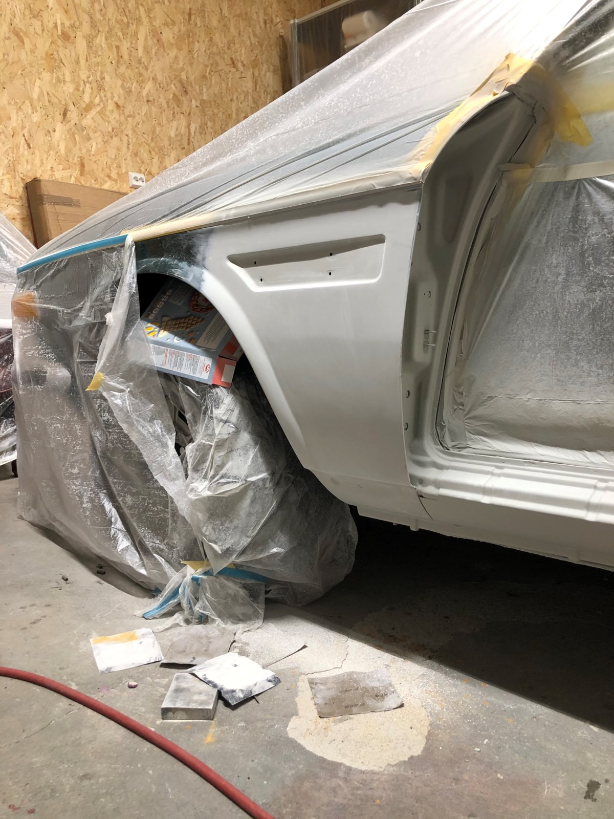

Things a moving along slow, but steady. The painting is done and the interior is recovered and on the way here. Cant wait to see it! Now some photos:

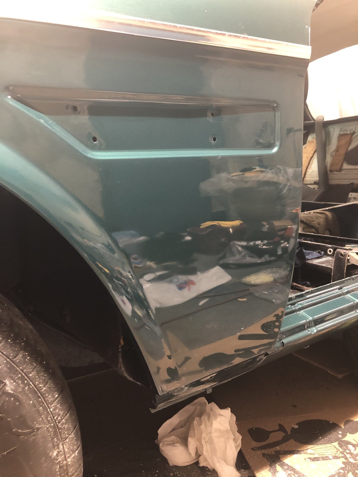

Sanding off spray primer finished:

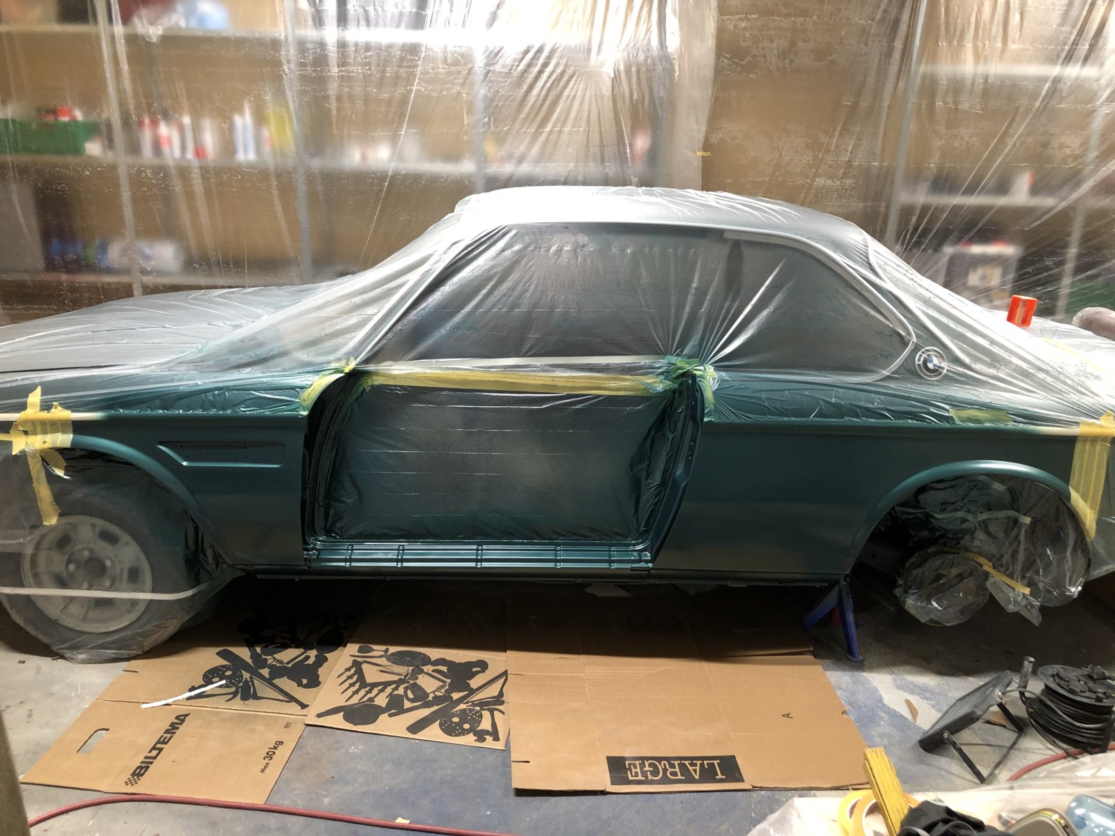

Base coat applied:

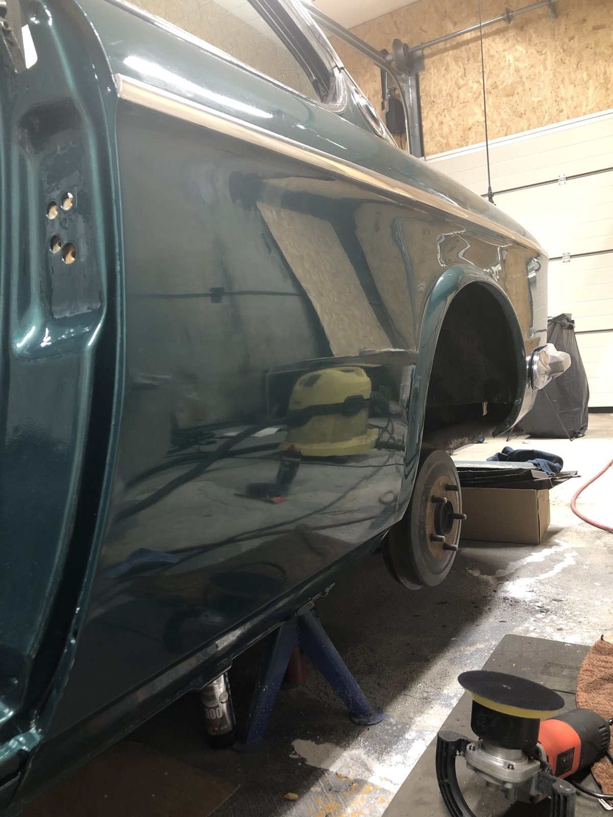

Clearcoated and polished. Not perfect, but good enough for a couple of years before a professional full respray. The color blended in nicely. Very hard to see where the old one stops and the new one starts, better pictures will be uploaded when I finally can take the car outside. It actually got so shiny I might have to polish the rest of the car now :D

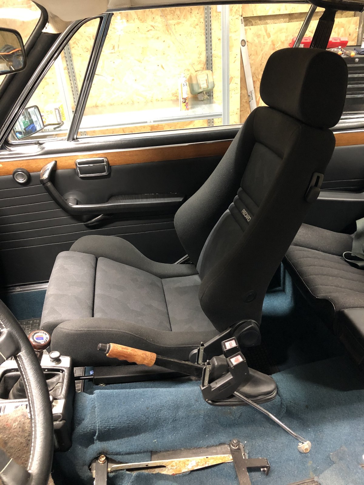

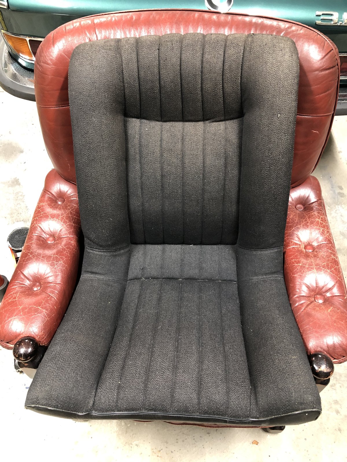

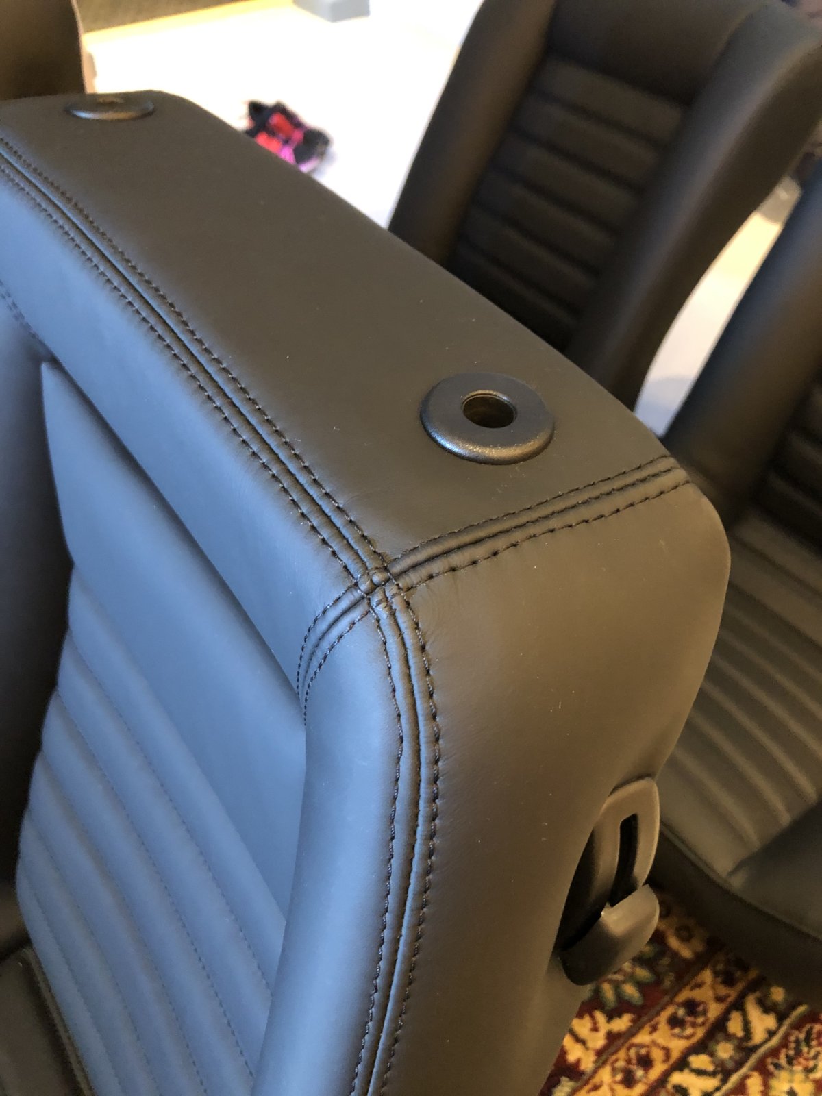

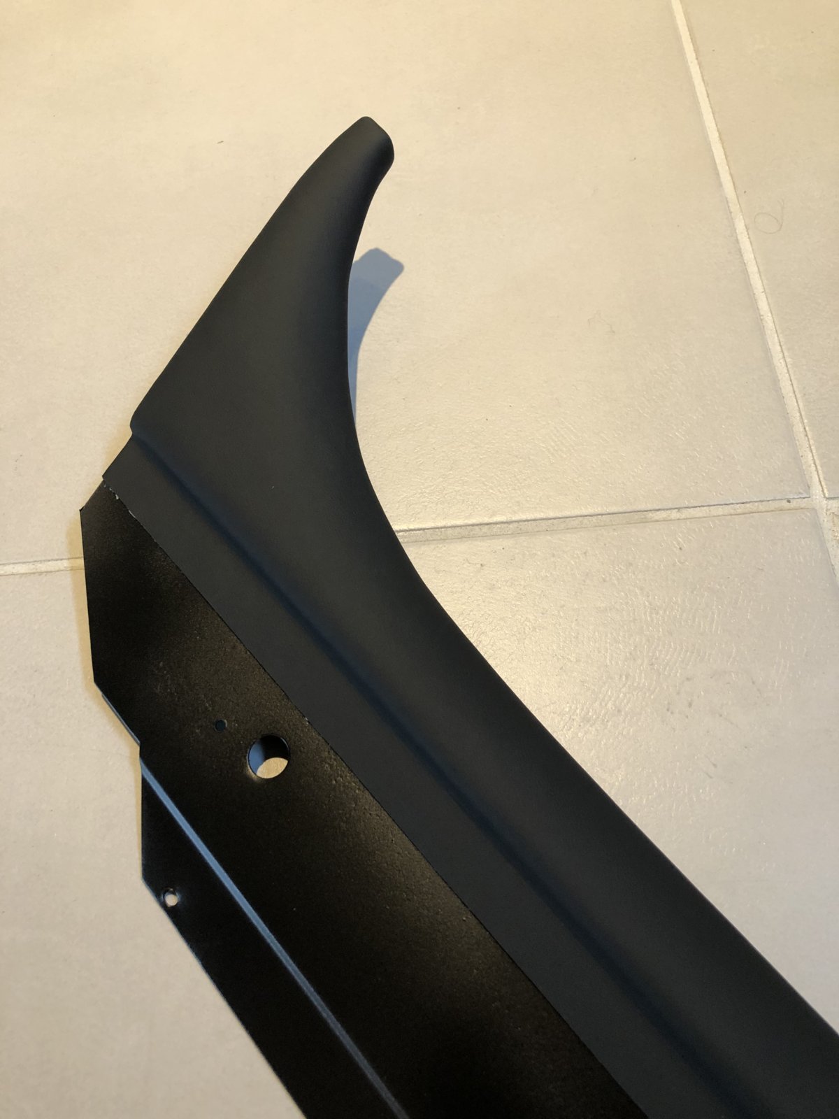

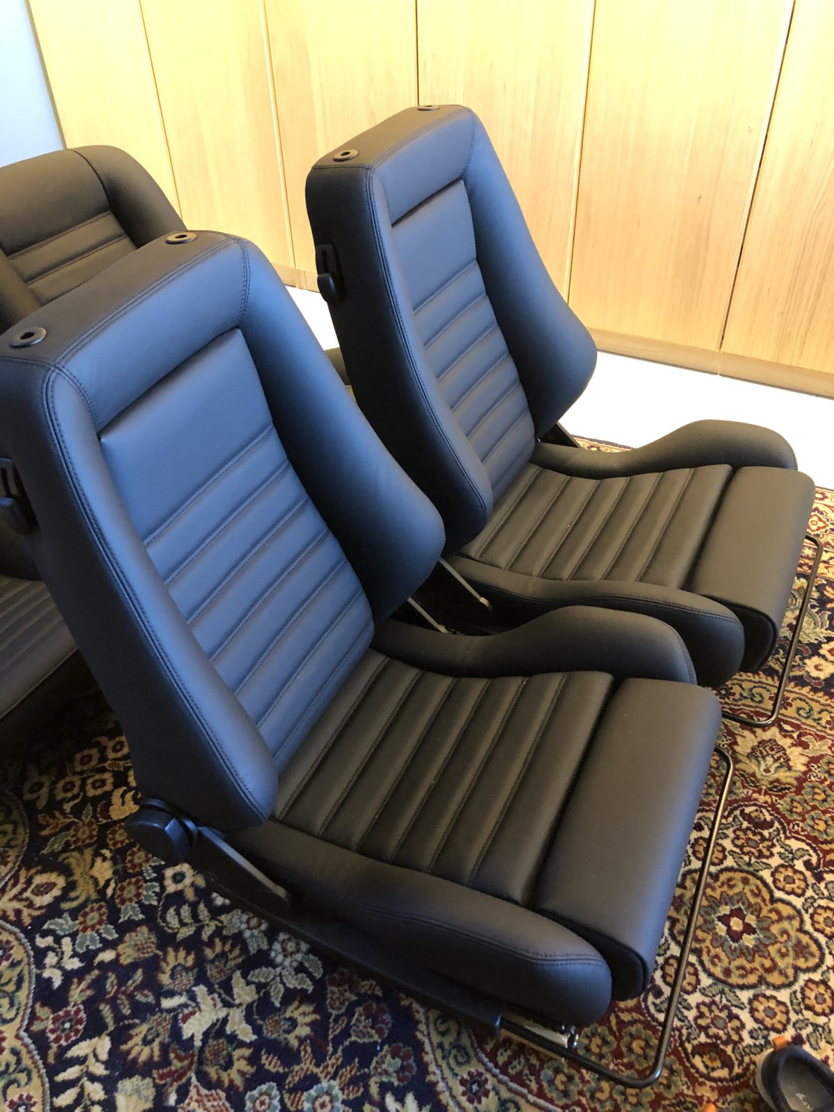

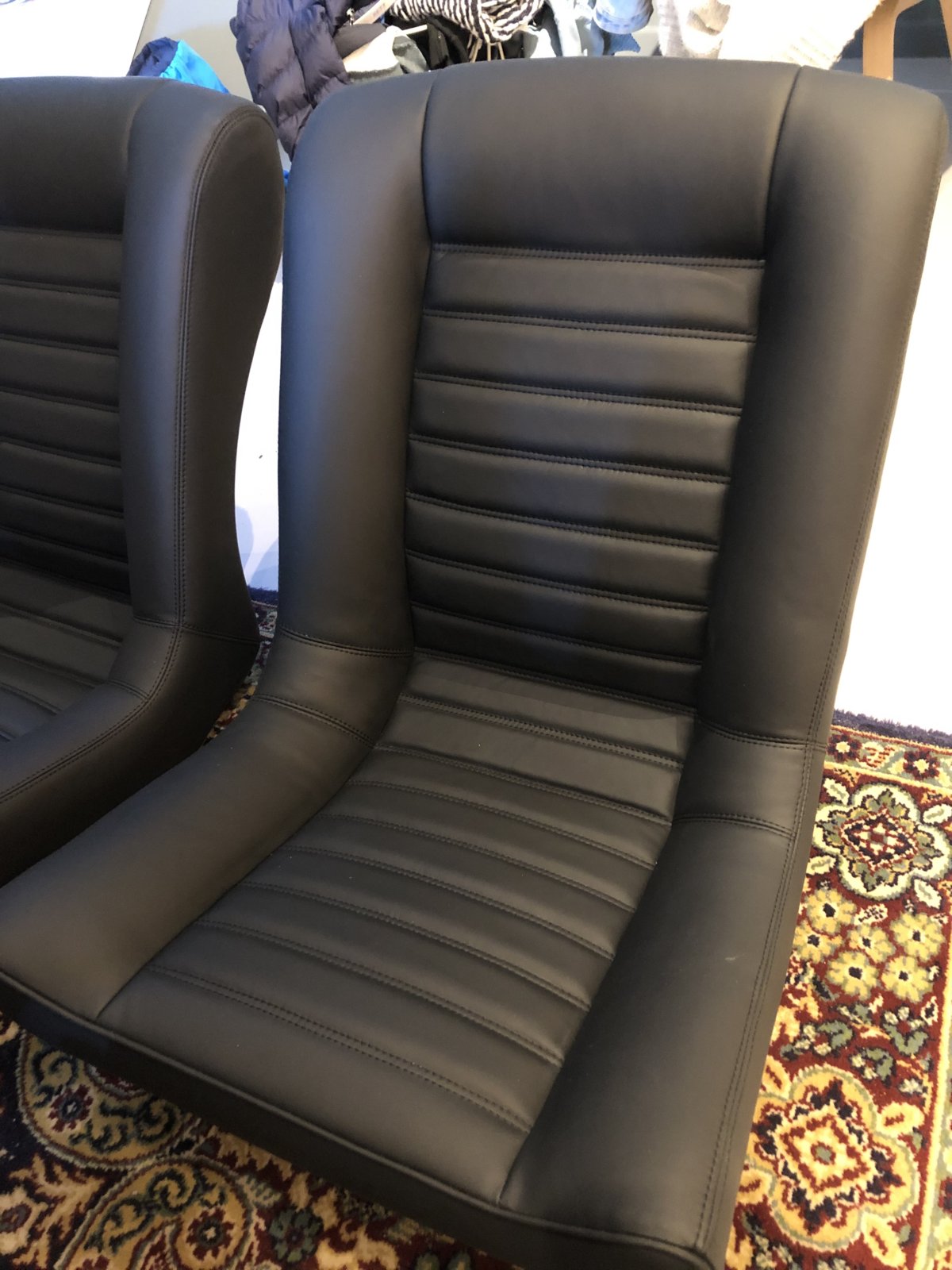

As mentioned I sent the interior to get reupholstered, and my guy did an amazing job with it! He re-did the front and rear seats, front and rear arm rests, rear senter arm rest, all four door covers and the senter console with a new gear boot. The dash etc will be done probably next year. I re-did the leather and made new wood on the upper door panels. I also made new kickpanels left and right as the old ones were shot.
How the seats looked like before. The front seats was very good. Almost not been used and was new in 2010. The rear ones was stiff and sun bleached.
The door cards was homemade in Sweden in the 90's. Also look at the condition of the wood, and this was the better side:

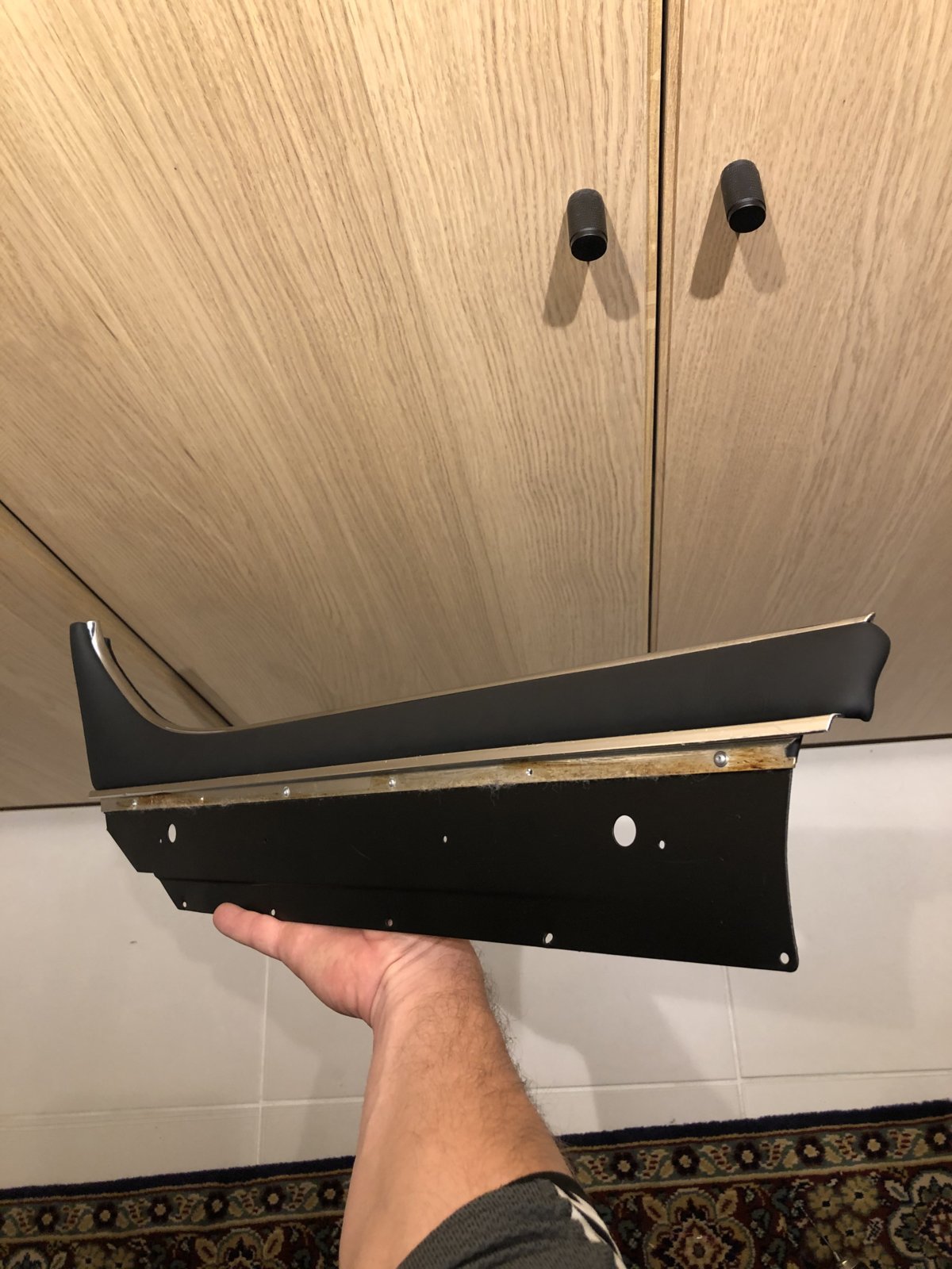

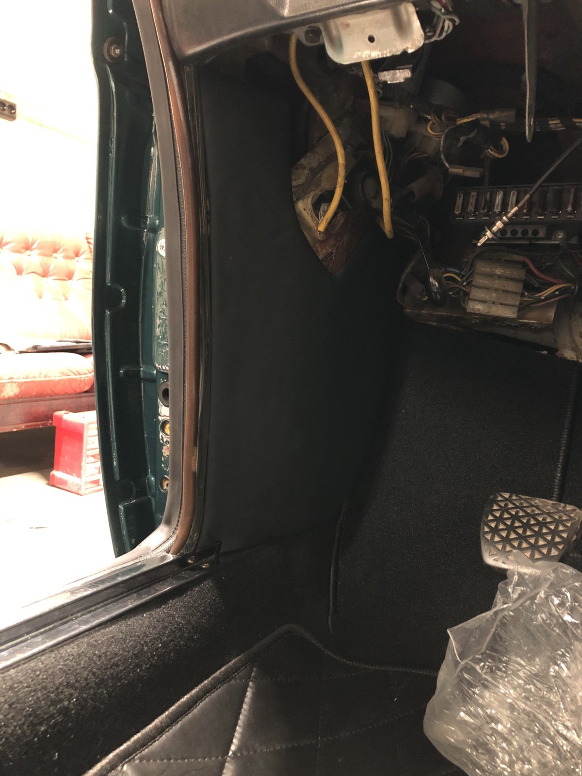

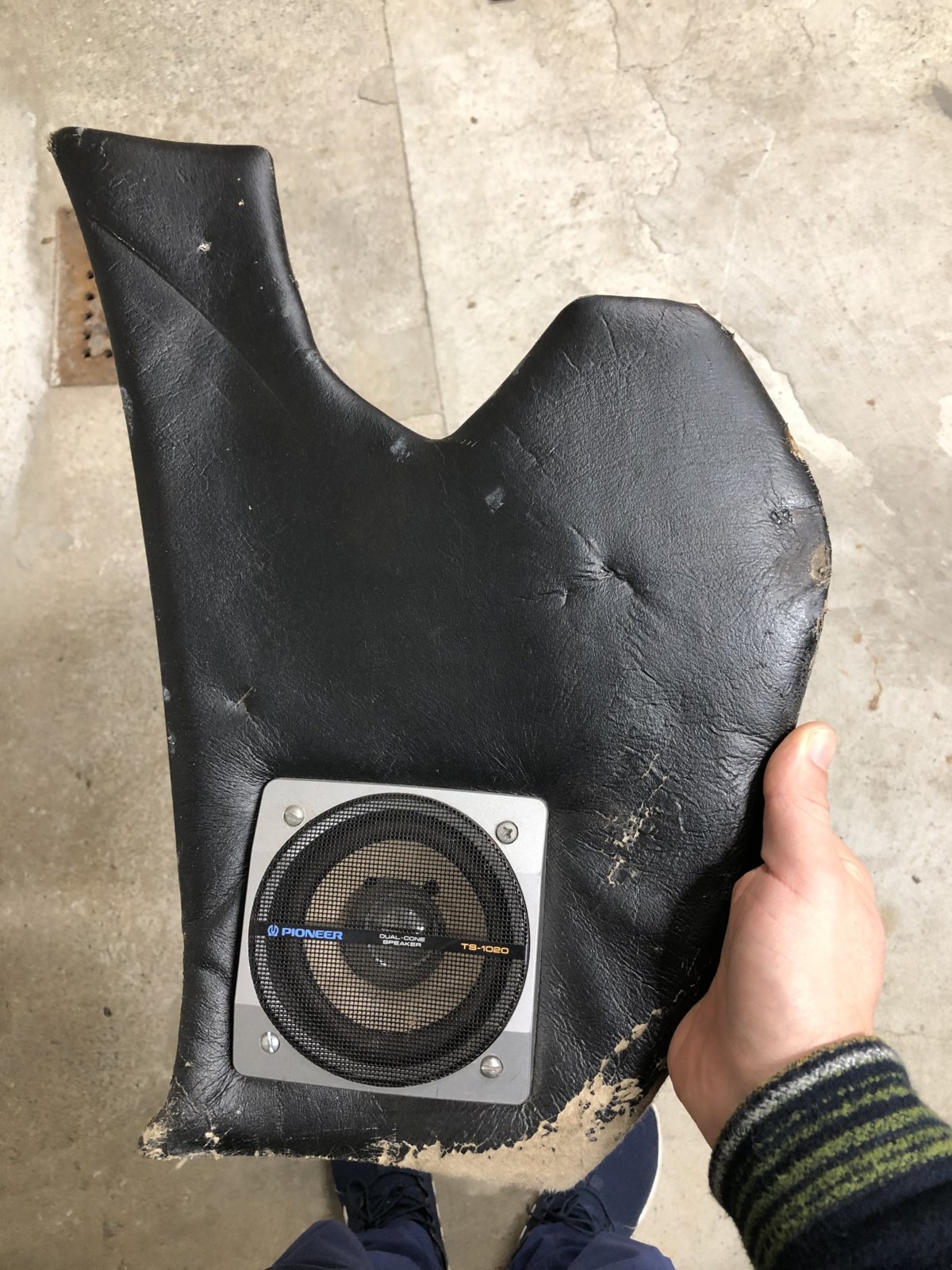

The old kick-panels (?) was kinda poor looking :rolleyes:
The "new" front seats:
The "new" rear seats:
The new kick-panel installed:

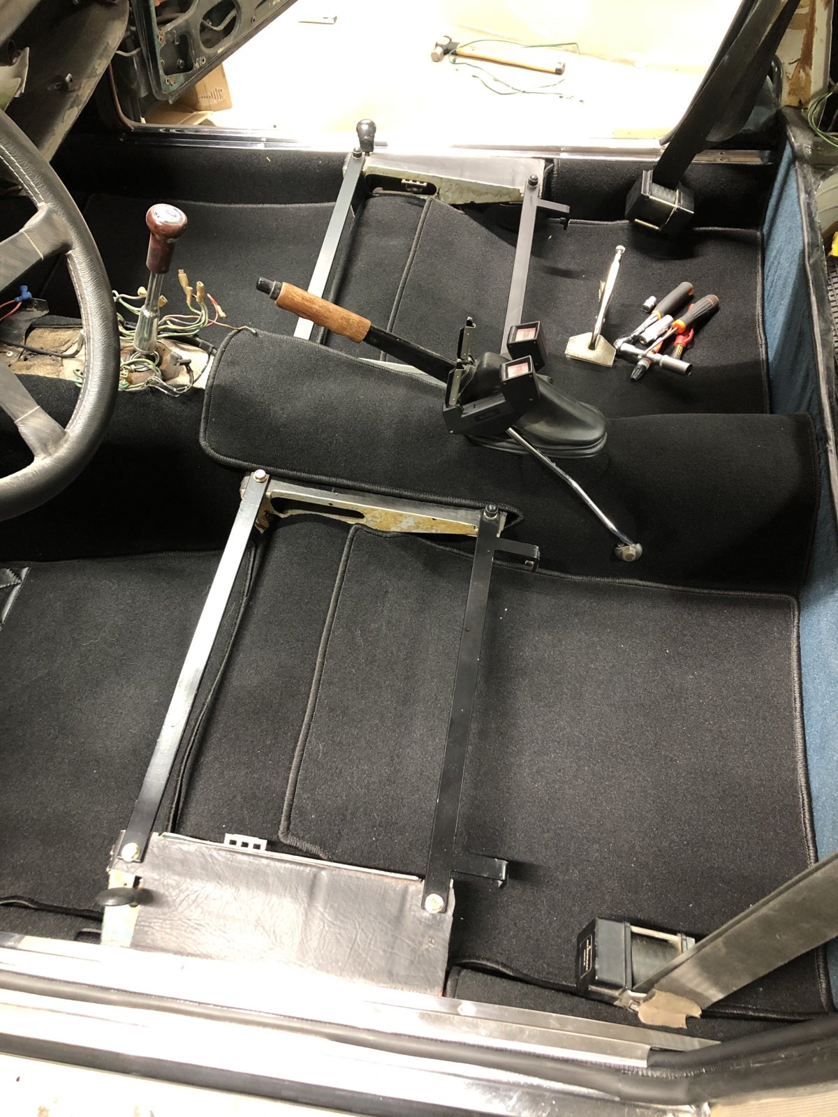

Also changed the carpets! Didn't like the green one, and it was dirty and greasy beyond repair:

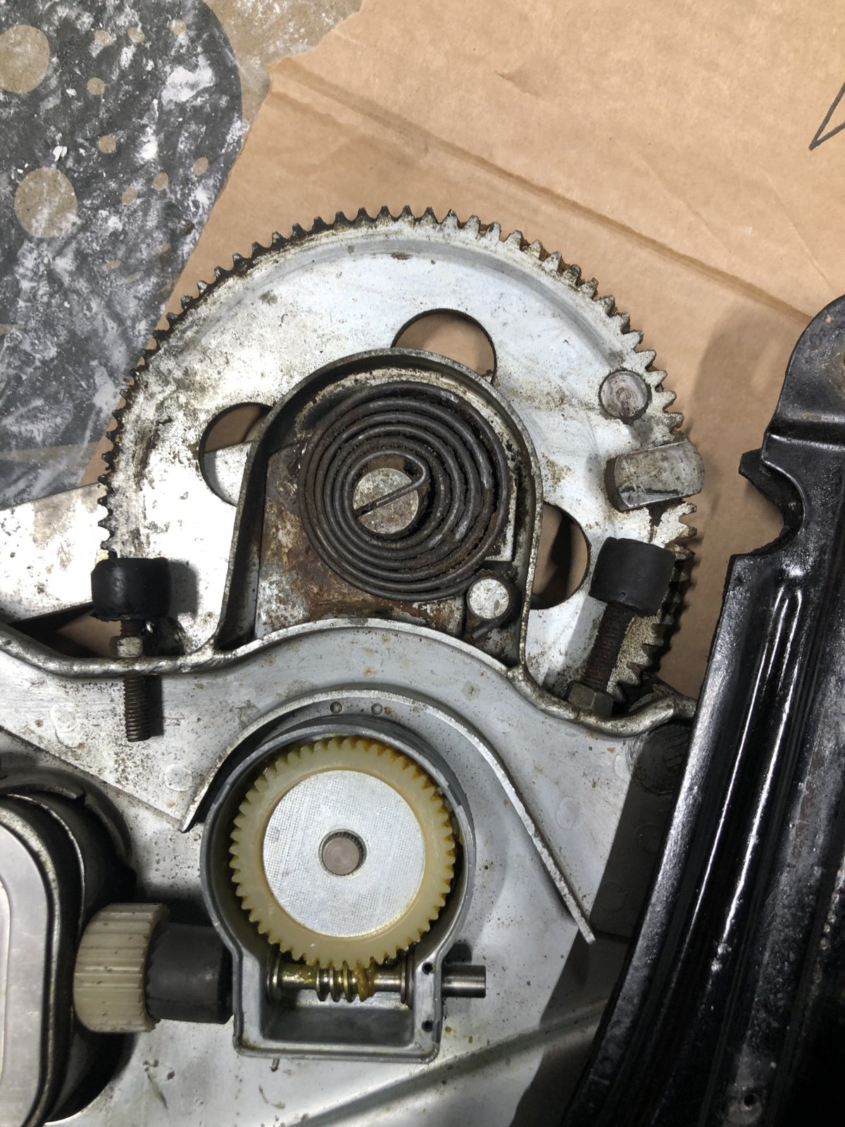

The windows was very slow, so I took out the window mechanisms and treated them the with new grease, a good clean and new stopping rubbers.

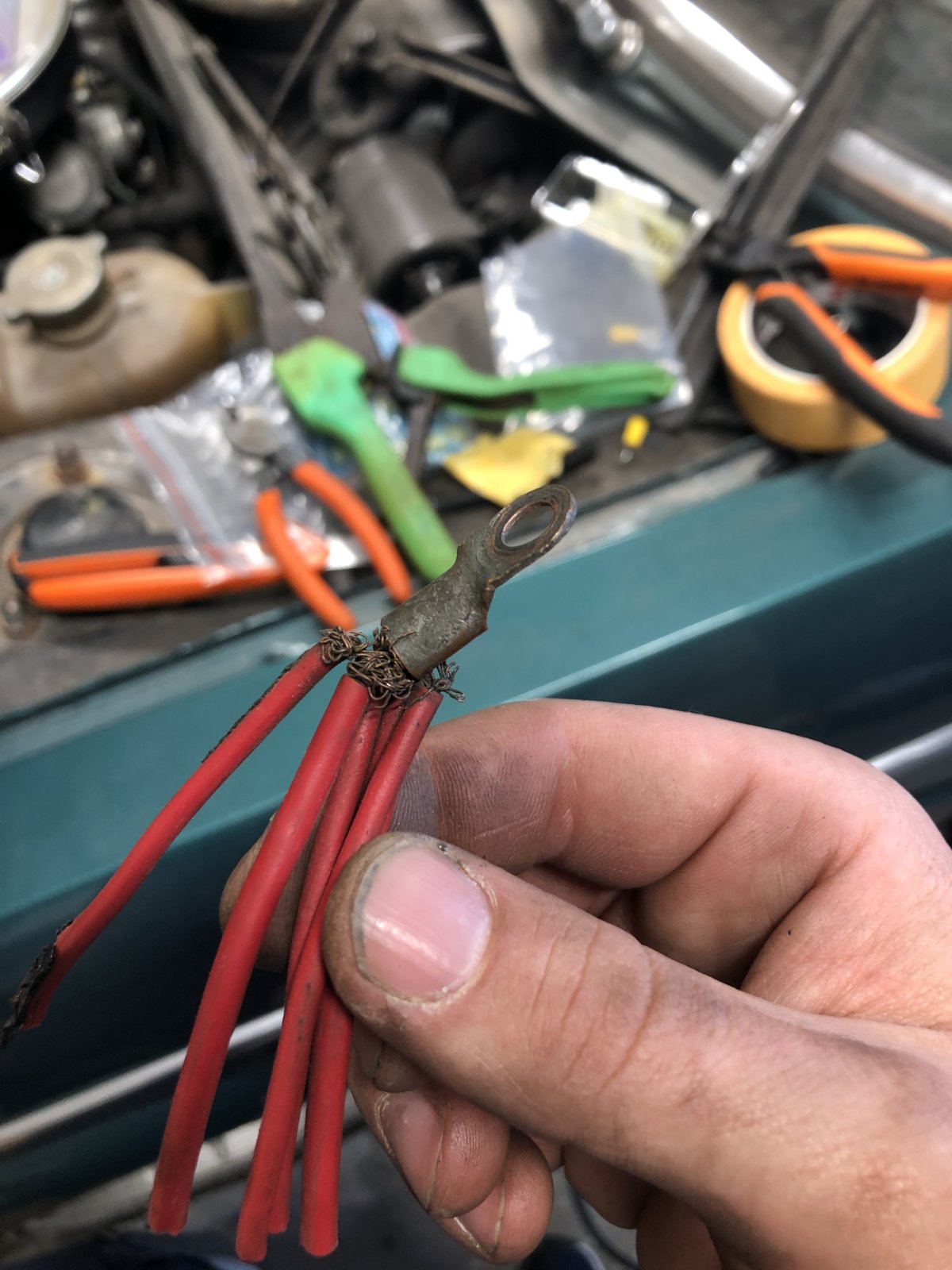

Sadly, they were still slow, so i bought new switches, but still slow. I the rewired all four with relays, they got better, but still not there. I found that the voltage droppet way too much when i operated them, so I checked the battery terminal. It's a miracle anything even worked on this car. This is the main connection to the battery. Sorry @deQuincey for the dirty hands:

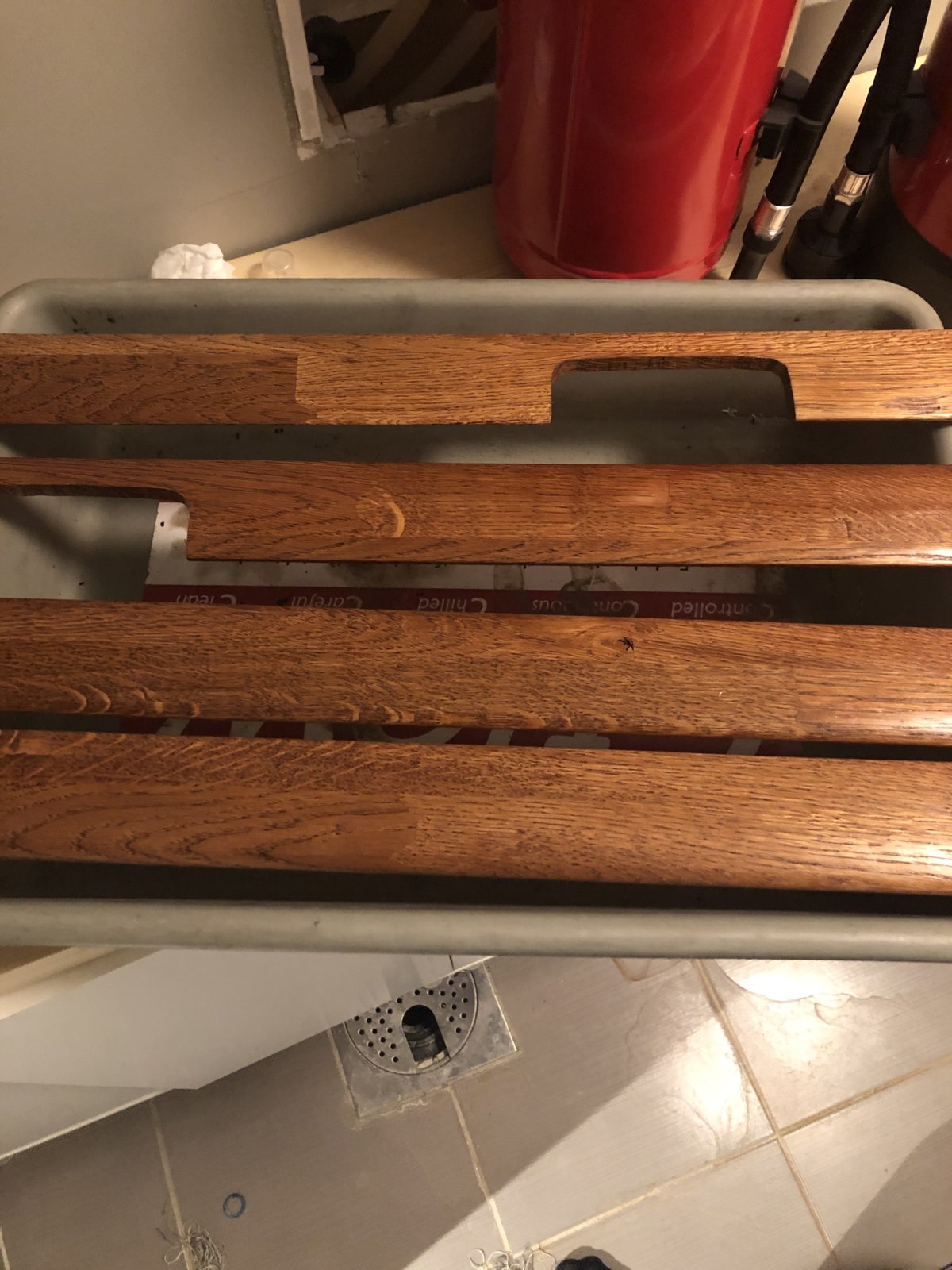

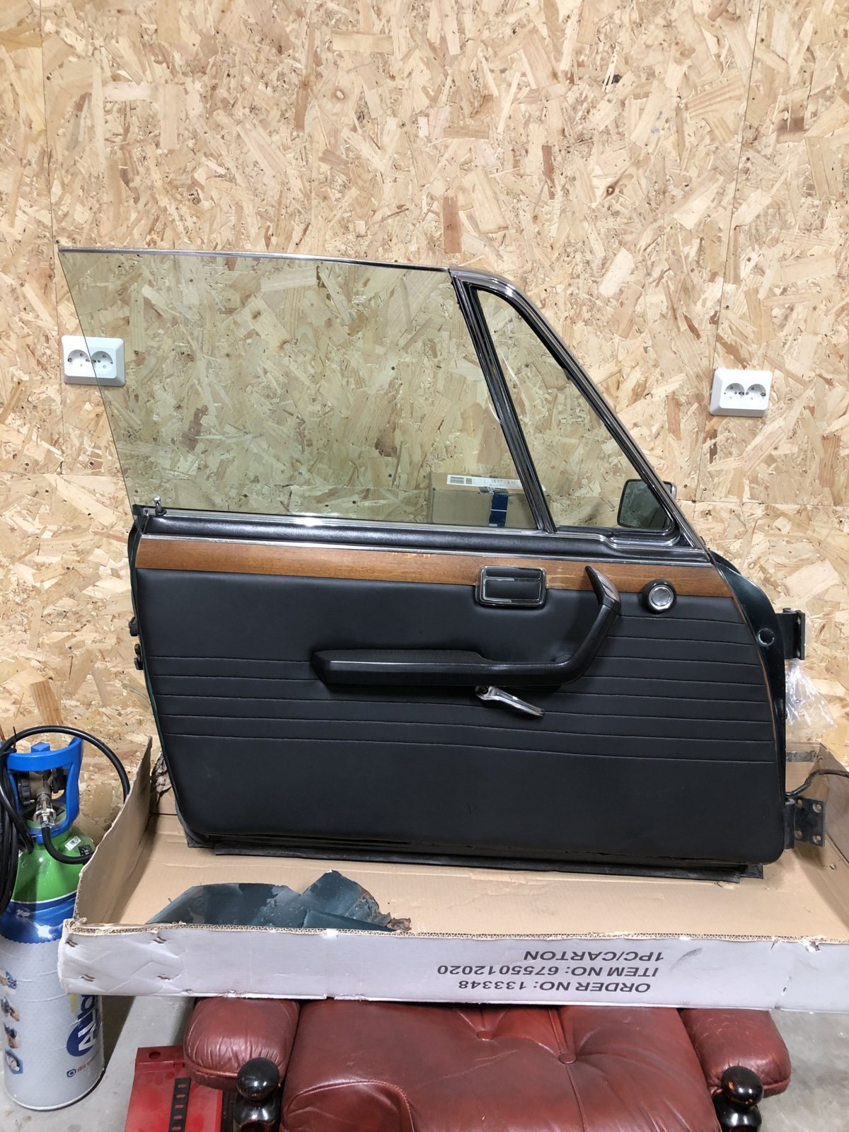

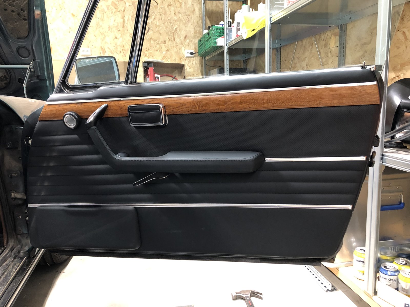

As mentioned, the wood was crap. So I bought a cheap Oak shelf. My dad and me cut it into pieces and made new wood for the doors. I am planing on buying new wood, probably from Bela, later on. We stained it to try to match the color to the rest. Here he is in deep focus:
Today I mounted the passenger door. I'm very pleased with how it turned out! Almost looks like a new door. It kind of look like the panels has waves and bulges, but in reality it is not, its only the lighting reflecting.

I wish, your nicely done oak panels will not bend.
As we know, wood is a "living" material, so that is also a reason why wooden furniture is made of glued parts in different alignment of the layers.
That's why veneer is used even in the most expensive cars (on steel/aluminum base) as it is easier to keep intact thin layer than the thick wood against cracking and bending.
Cheers
Cheers
Yes, you are absolutely right! The wood might bend and twist. It took only a few hours to make and cost less than 30usd, so i'll take my chances. It is only supposed to last maybe 2-3 years before a complete restoration of the car and I will order new wood probably from Bela then :) But thanks for the heads-up!
