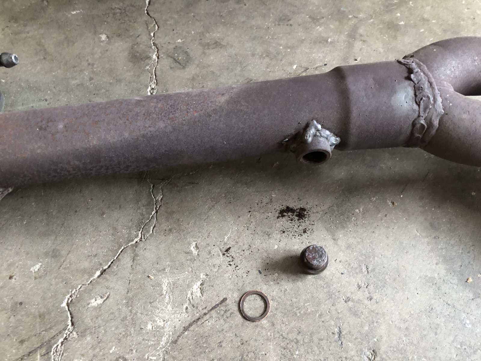

Not sure what your question is ? Normally you would just buy the sensor pre wired along with a controller. If you are trying to reuse an existing one the video covers it I think. The O2 sensor will have a controller which will output a voltage that the Megasquirt will read - the O2 sensor does not directly connect to the Megasquirt.
Umm- I thought I gave you a link to the Wideband sensor you need for MS?
four wire O2 sensor is no good for MS
That looks like narrow band with heater circuit

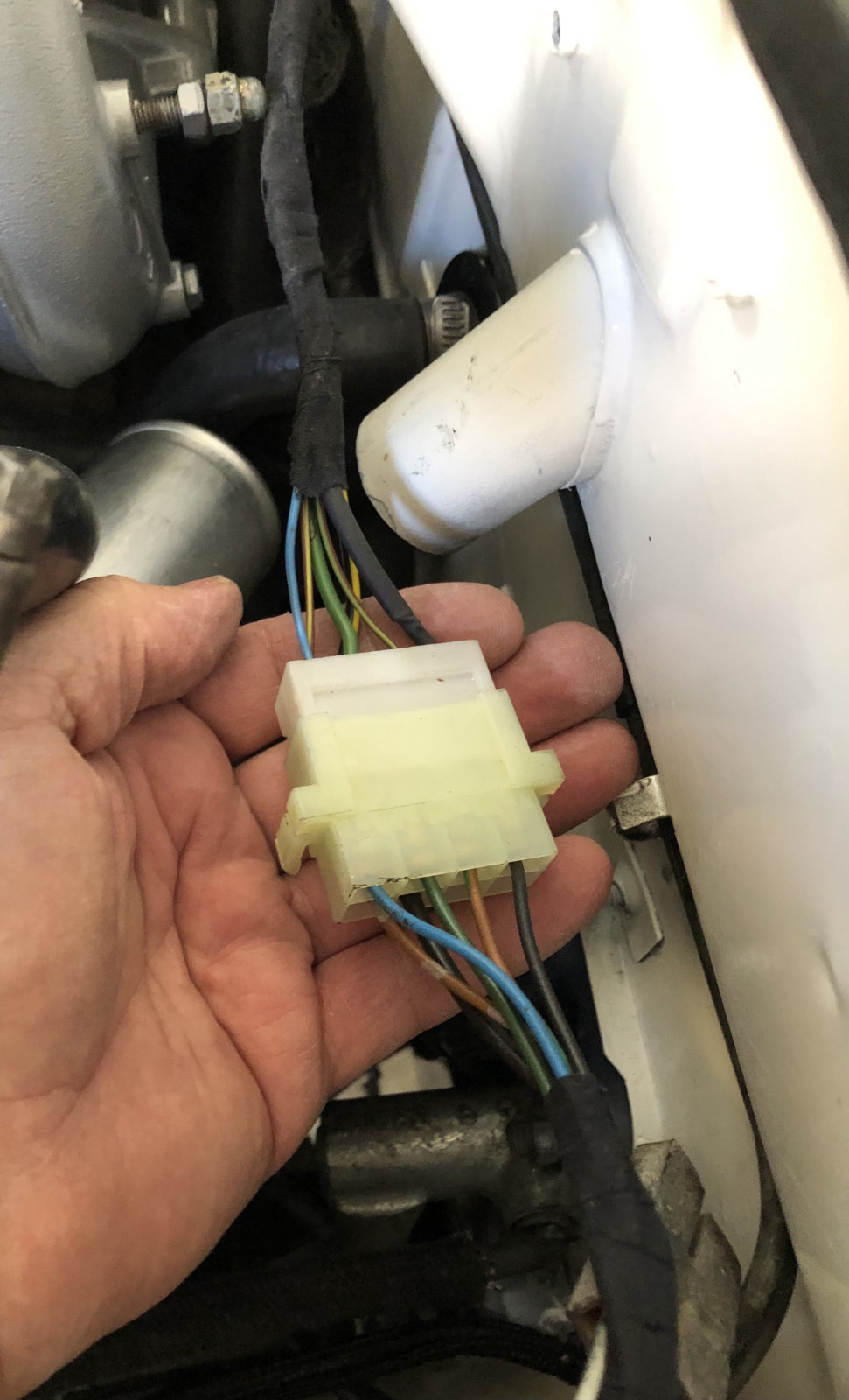

The wide band unit has two inputs from the harness - battery positive and ground. That’s the red and brown wires you see.
They match up to the wide band units red and black wires.
The wide band has one output wire to the harness - a white wire.
It connects to the white/black wire you see. It’s white/black as a visual cue that it starts off as black and becomes white in the circuit. When you buy your wide band unit you will also see a blue wire- trim it heat shrink it- it is unused.
At first I thought this was fake like the World Products M30 aluminum engine blocks that were an April fool's joke a few years ago on R3Vlimited.

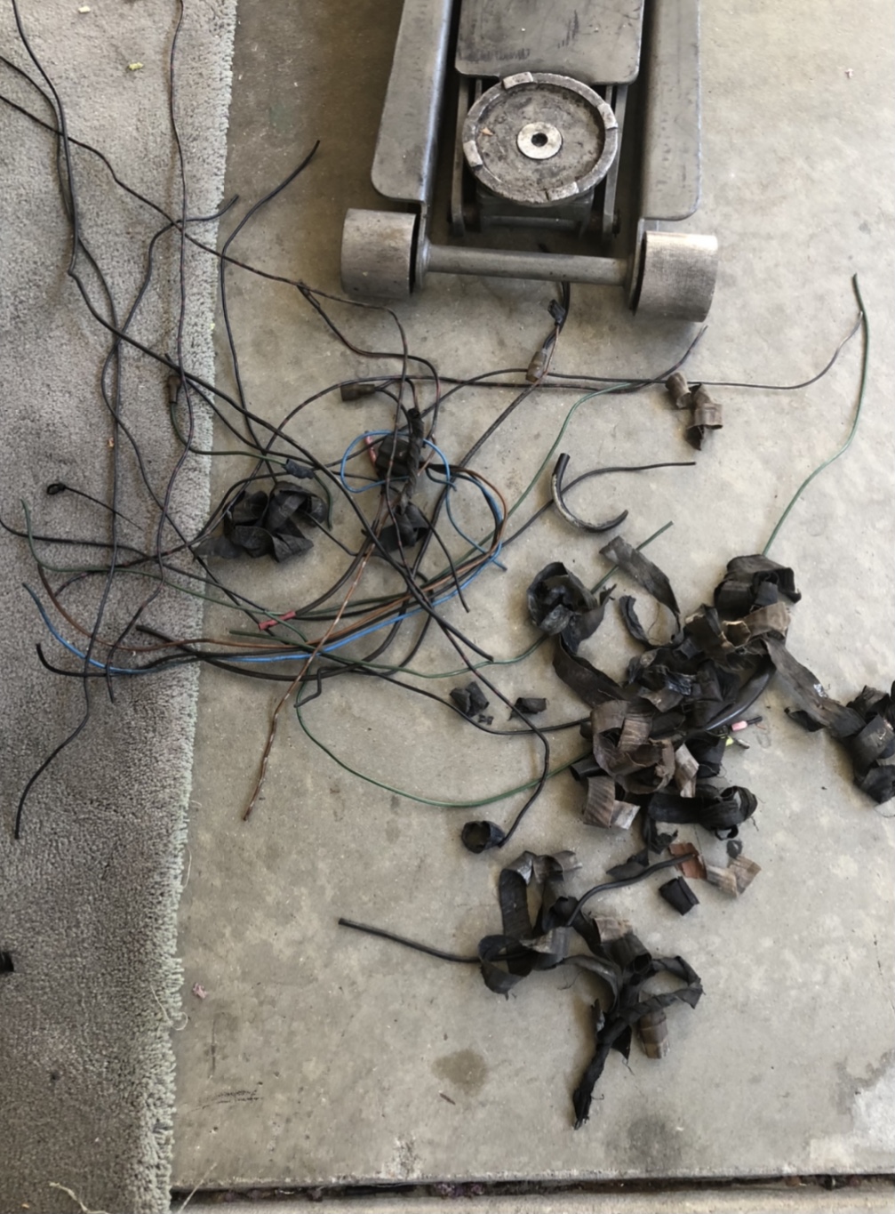

The slow process goes on. This past weekend I pulled my exhaust to get the 02 sensor plug out. I’m not reusing the exhaust but I need to keep it in order to start and communicate with the MS. I will swap it out for the Stahl headers and all new tubing.

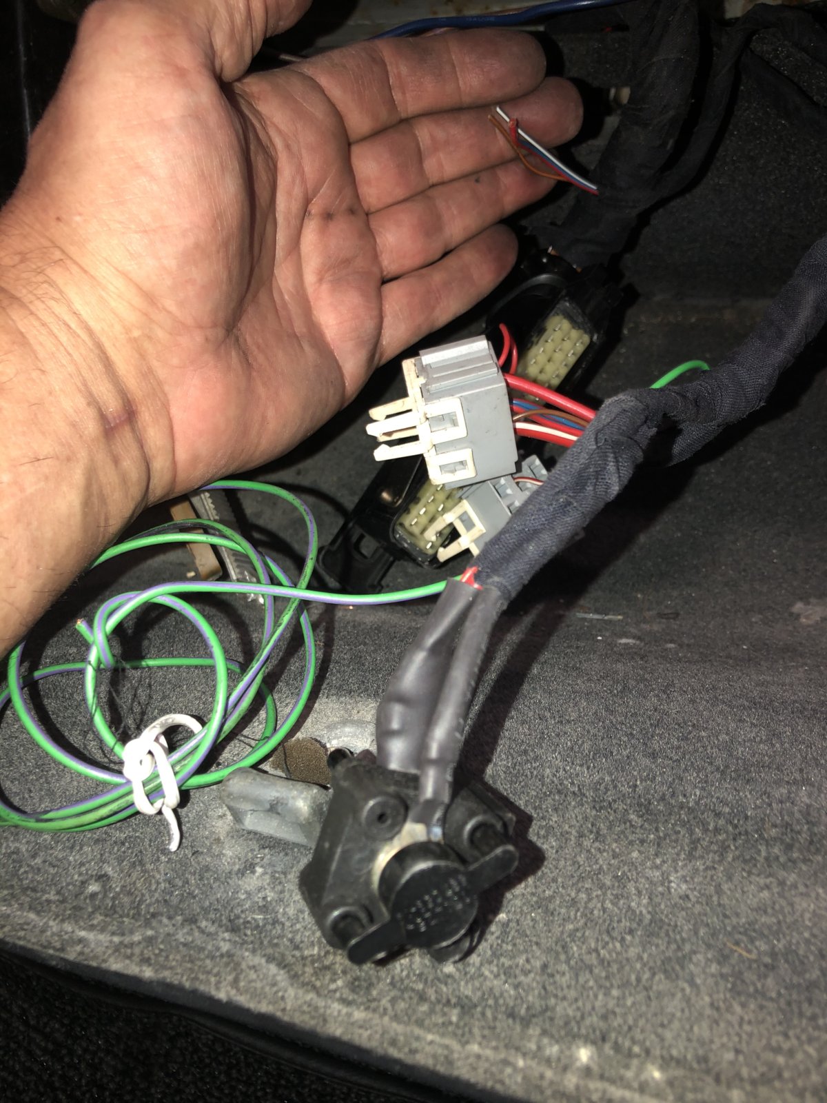

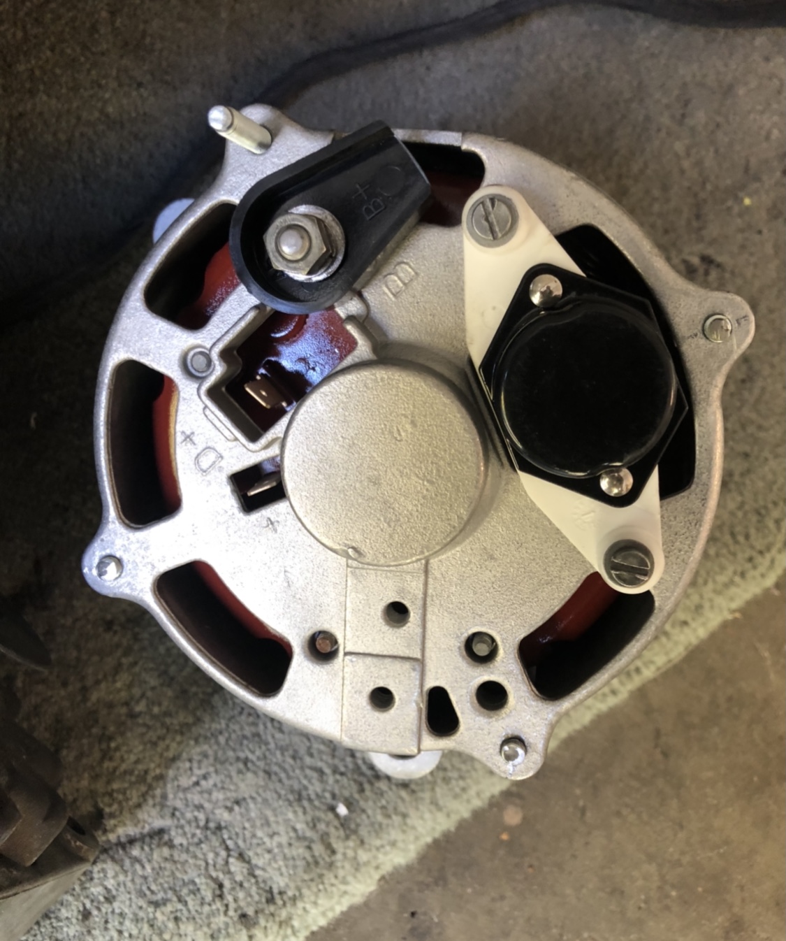

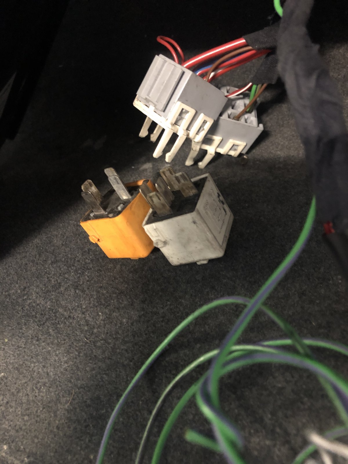

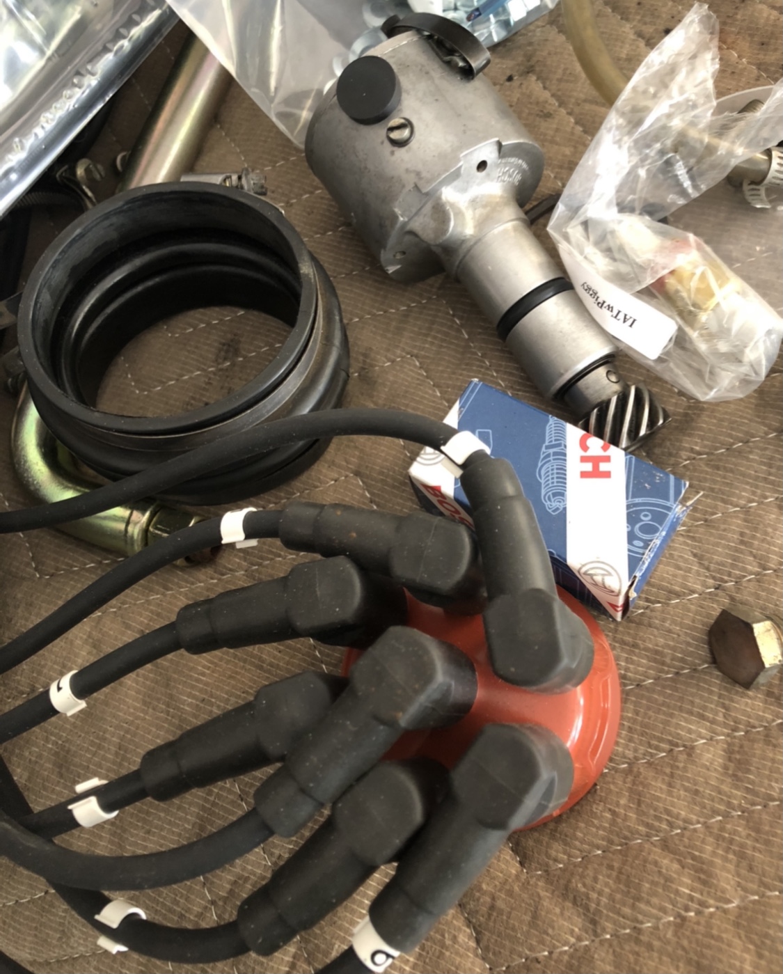

Well I think I’m all hooked up and ready to start the engine up. I’ve had some great help getting the wiring sorted out. I went to a distributor from the motronic cap n rotor. Changed the original alternate to a better one wire Alt. Eliminate the fuel pump relay under the rear seat , didn’t need it because there the harness has one along with the main relay

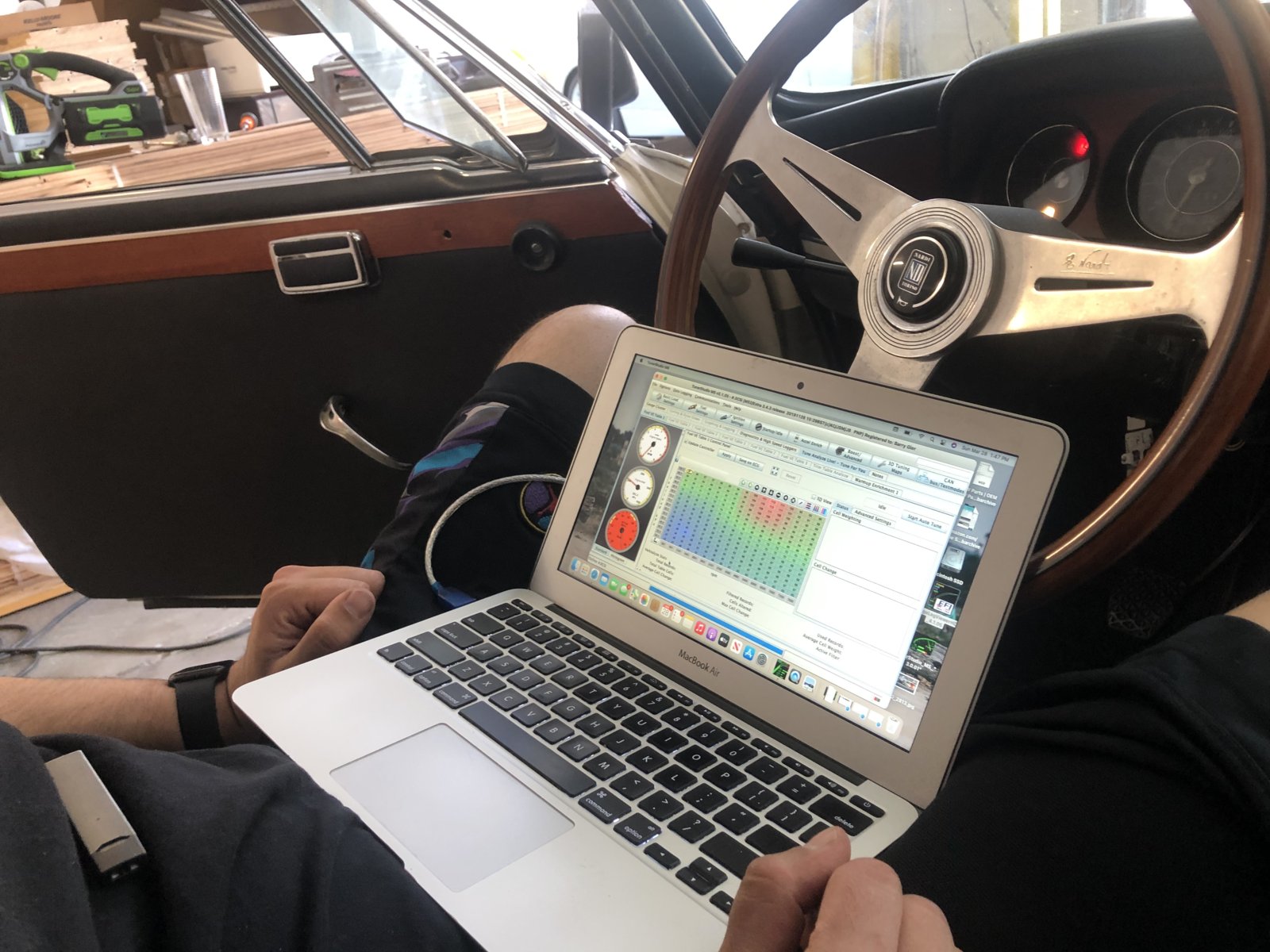

The Megasquirt really smooths everything out,Idles is perfect and the throttle response up to 6 grand is what I wanted. I really don't want to push it too hard with the new head. My son and I take it out almost every day. I have a great local independence shop that will pull the power out in the next few weeks. Oil change and recheck the valve clearance are to come. I need to take my headers to get the surface rust removed and then coated. Then install the headers and off to get a new exhaust built.
