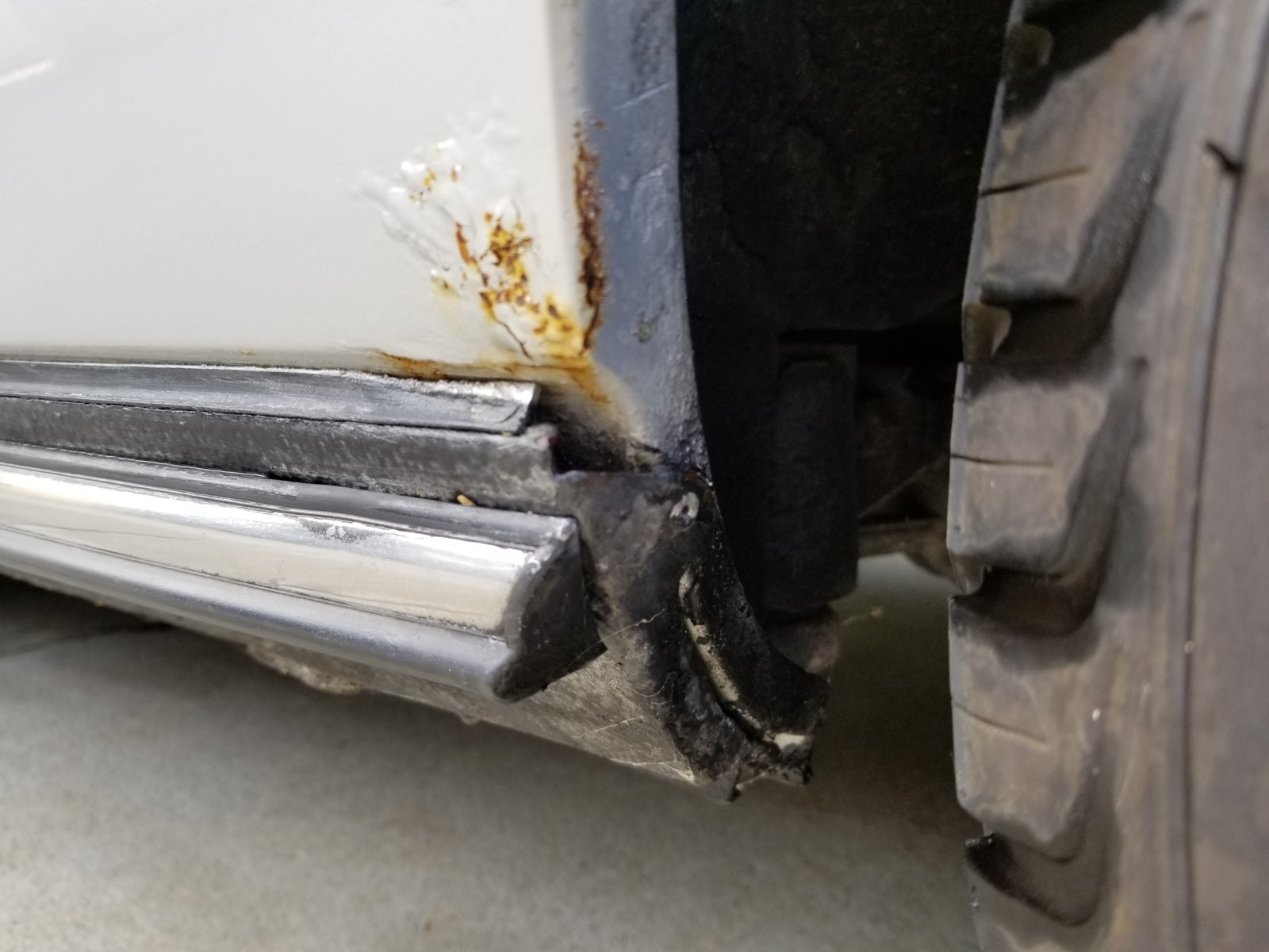

the nachtblau doesn’t have any rust as far as I can tell. The Polaris one has some surface rust in the driver rear wheel well next to the rockers and a pain chip showing some rust(?) in the hood. Polaris one has the refurbished wood from Bella already (dash wood not installed). Seat leather probably needs to be replaced completely

Would you have a pic of the rust of the Polaris one of the driver rear wheel well?
It may be just some surface rust (treat and seal) or, when the rust is through it needs replacing shelter metal. Depending on the place replacing could be easy( a patch butt welded in) or it could be indicative of rust inside the rockers/ under rear subframe mount.
A challenge to myself : show me the rust pic and I'll show you a gestimation of your inside rockers, based on what I've seen in the various resto threads over the 10 years that I've been following them.
I'm no restoration expert but I've always felt one should buy the best body (rust free) you can find. This picture tells me this car has had "restoration" work. I see overspray on the rocker cover. Meaning they didn't take the cover off to paint. Not a good sign.

Thanks for the pic. This is rust in one of the critical area's. You could leave it, but it would grow. You could drive it for another 5 years, and your car wouldn't fold in on itself. It would just have that brown spot in the corner. Just look the other way ( I whish I could have done that...)
But it won't heal by itself, and it will only become more work the longer you wait.
The outer skin that you see isnt that bad to repair, patch panels are 120 euro's or so per side, and it would require you to slice open the rear quarter and butt weld it in.
What I expect you to find below it is more rust in the 5 (!) layers that are behind it.
The fact that some engineer did exactly that, sandwich 5 layers on top of each other, is why it's a difficult place to repair.
I have seen no car where the inside is not affected, with this outer view. Often rust here means also means rust in the layers below. It is a critical corner, as it connects the sill (rocker) end to the structural wheel arch AND it carries an attachment point of the rear subframe.
Indeed there is overspray on the rubber between the cover and the body. A serious tell tale of botchy work if you ask me. Someone only cared about how it would look from a few feet off. Not if it actually changed the rust situation.

For sure I showed you a few bad examples , and HbChris is right; without some more pics it is difficult to judge how good it is. (from the inside under rear seat and from the underside looking at the last bit of rocker sticking out where the rear floor rises).
I sincerely hope that it is just a minor pinhole, and that you get to drive a lot.

When you get it, I would take the rocker covers off and see how things look. It may all be good.
As they say, hope for the best, prepare for the worst.
If that rust spot is localized, easy to repair. Not so easy to match the paint, but no biggie either. Better than rust showing.
