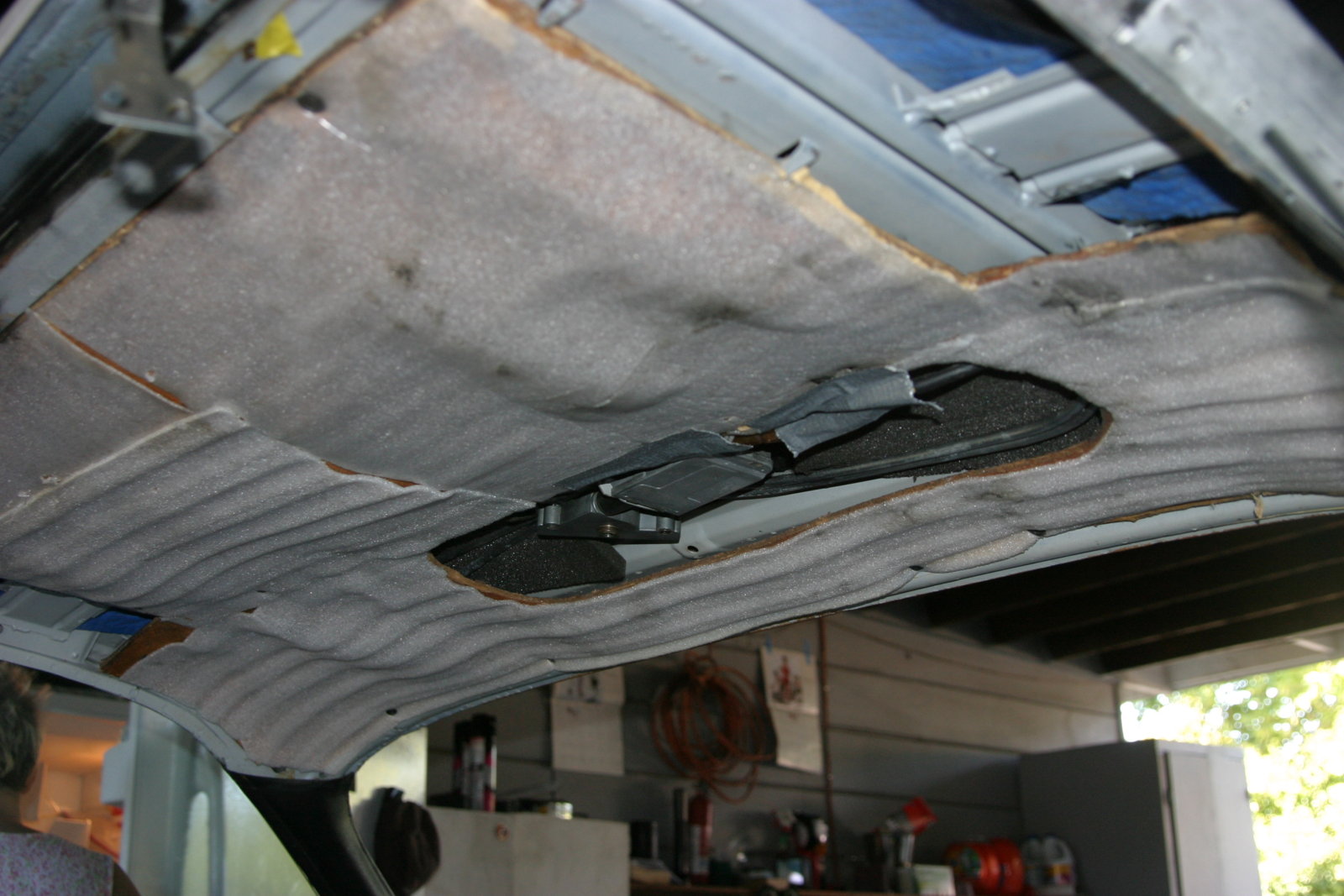

no its sits free in the middle
i added foam for sound deadening
