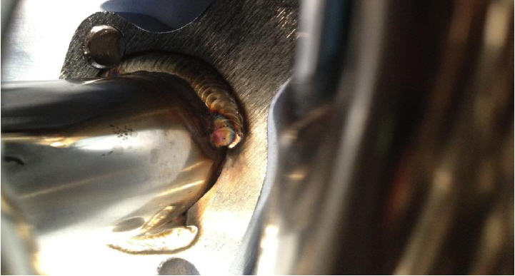

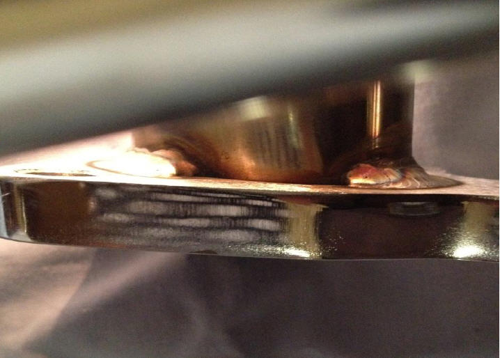

Well I've received my header for my BMW e9, and its beautiful. Stainless steel and beautiful welds.
However, there's one quality problem that jumped out at me as soon as I opened the box, and I was very surprised it passed their quality inspection. One of the pipes, I believe #3, had an incomplete weld. The attached pdf clearly shows where 2cm of weld is missing.
I've contacted Schmiedmann and am waiting to hear back from them on how they want to handle this issue. It's certainly not practical to ship it all the way back to Denmark for a little welding, but it must be fixed before installing.
Again, it really is a beautiful header, and it will compliment my car. I'm just disappointed with the obvious flaw.
I'll post an update once I get this resolved.
$56 and shipped by DHL. Packaged very nicely too.
Here's the weld.

It looks like in the Web photo that it's missing the weld on third tube in like the photo's posted?

Schmiedmann agreed to give me a $15 refund, which is all it cost me out of pocket to complete the welding.
