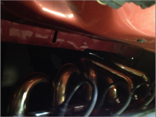

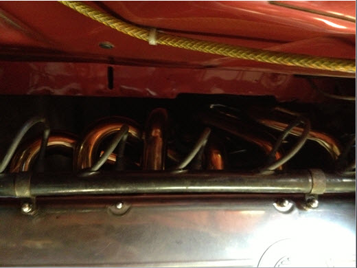

Started install today; the after header hits the frame rail and the front header hits the block (slightly) where it mates to the tranny.
Assessing my options, and I'll take a fresh look at it tomorrow.
Well the tube for cyl 6 hits the rail and prevents the manifold from mating up fully to the cylinder head. I took a bunch of measurements this AM and figured that tube is turned out too much by at least 1/2". The fwd header is tight where it passes by the aft end of the engine block, but not a show stopper yet. It'll be tight at that aft engine block point when both are installed, and right now I can't tell how tight as I need to get the aft header installed before I can do the front.
My next move is to see if I can have the tube for cyl 6 cut and rewelded; I do not want to cut the rail.
This header is a thing of beauty, but I wonder if they ever installed one on an e9. Alt source of the problem is variation in the mfg.
This is not a product I would recommend at this time.
We'll see if the cut and weld fixes it, and in the mean time I'll look at other options.
if memory serves, Korman notes that the stahl header must be modified to fit an e9. might be wrong, but that's what i remember
So I contacted Schniedmann, and they said they could not do anything for me (understandable as its been 14 months), and they did not have a fix for the problem (not understandable).
I'm meeting on the way home with a local welder who does stainless welding and fab for defense products.
I saw the welder today and he's the mechanic on this not me. I gave him the requirements and let him figure out the solution.
I believe this header will work for many M30 applications with more clearence, just not the e9.
I do see that vintageBmwsource.com has a comparable header on their site, and they say they have addressed the rail clearence issue.
We'll see how much the welder can tuck in that #6cyl pipe. I'm inclined not to cut the lip of the rail, but that is an option. The rail already has one notch from the factory, so extending it would not be an issue. Just have to weld it and paint.
Saw the welder's pre-welded arrangement of tube 6, after he cut some small pie slices out of it, and it tucks in tha tube as far as it will go. Won't be as pretty as it was before, and there's some, but not much, added restriction, but it's as good as we can do with what we've got. Will post pics.
Well here's some pics of the header as finally installed. Photos don't do it justice as it is beautiful. You can see where I lengthened to the rear the existing cutout on the frame rail at the near point with the header. The mod to tube 6 isn't visible, and you'd have to examine it closely to see its been cut and welded.
But was it worth it? Here's the talley:
Purchase including shipping $348
Mods to Tube #6 $135
Weld up to existing exhaust $109
Total $592
The weld up to the existing exhaust would be required anyway, so the cost should have been $457 if the header had fit to begin with.
I'd have to say I cannot recommend this header from Schmeidmann's. If I had to do it again I'd get one from Carl Nelson, or from http://vintagebmwsource.com/.
