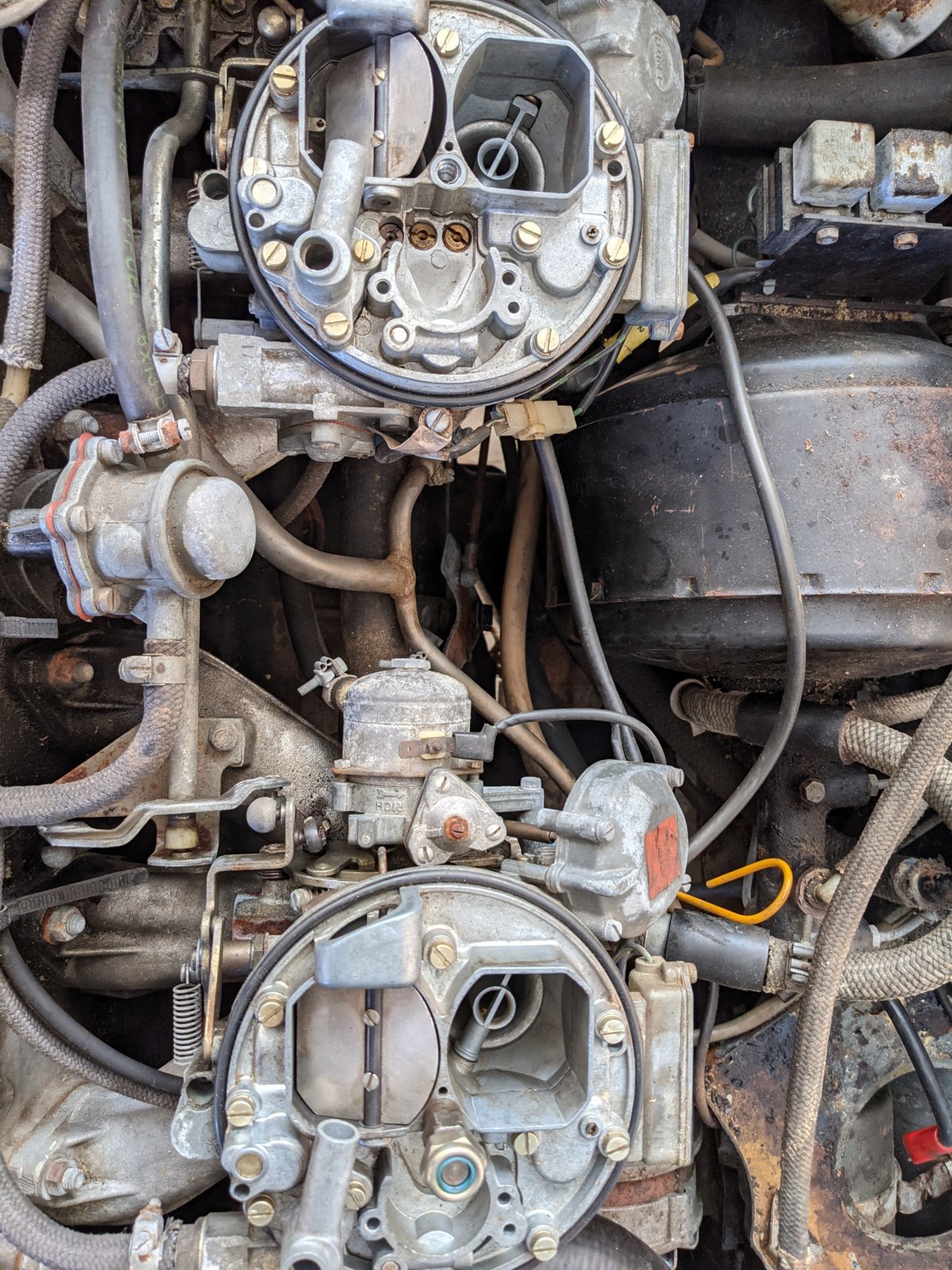

Thankfully the fuel tank is empty but I do plan on cleaning the entire system before starting the car. I do have a decent amount of knowledge about reviving a car that has been sitting a long time (though not this long.) Thats mainly why I have been putting this off.
Carbs look clean and not gummed up. The linkage seems to be stuck though, you cant work it by hand and the pedal doesn't seem to want to move either.

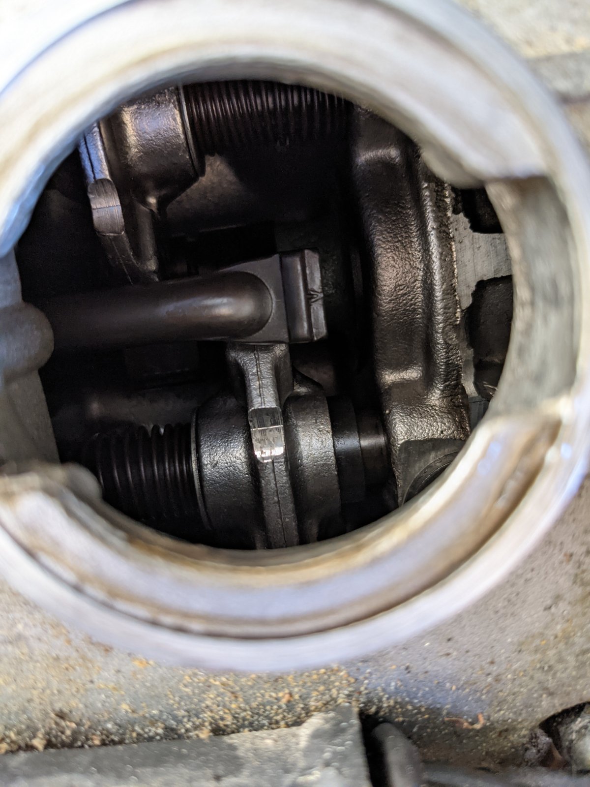

a look through the oil cap, looks brand new to me.

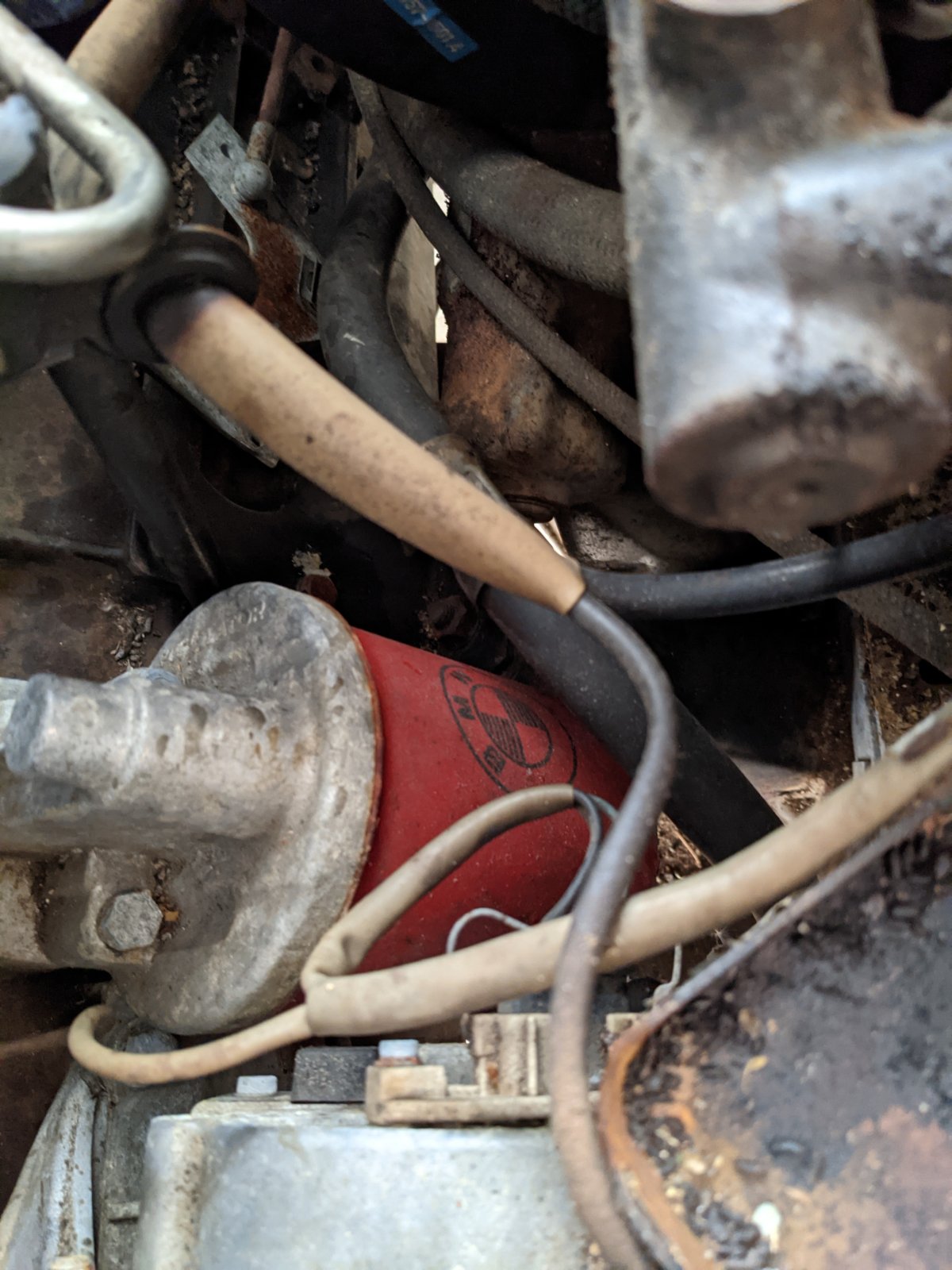

authentic bmw oil filter, pretty neat

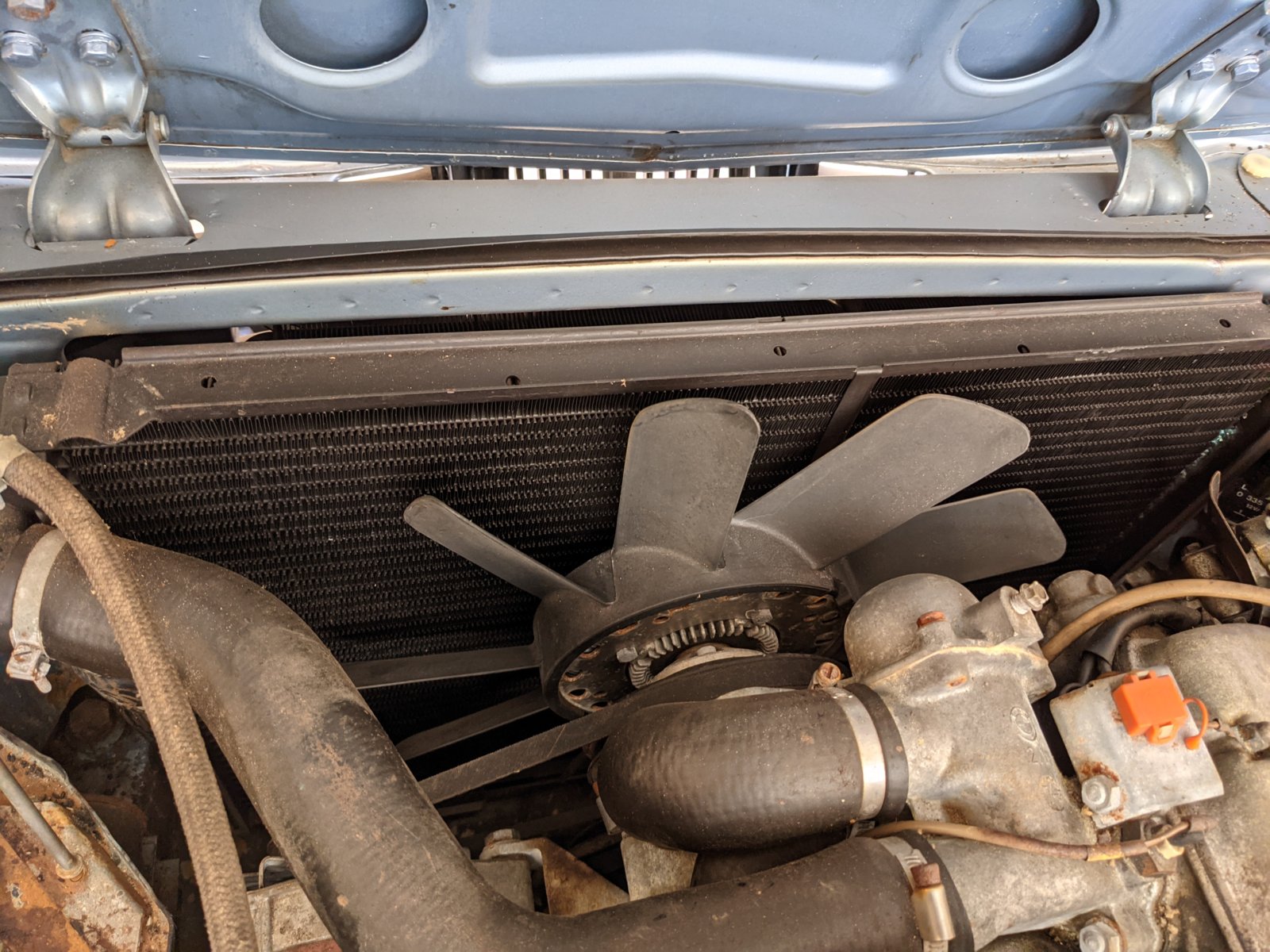

Radiator looks new to me?

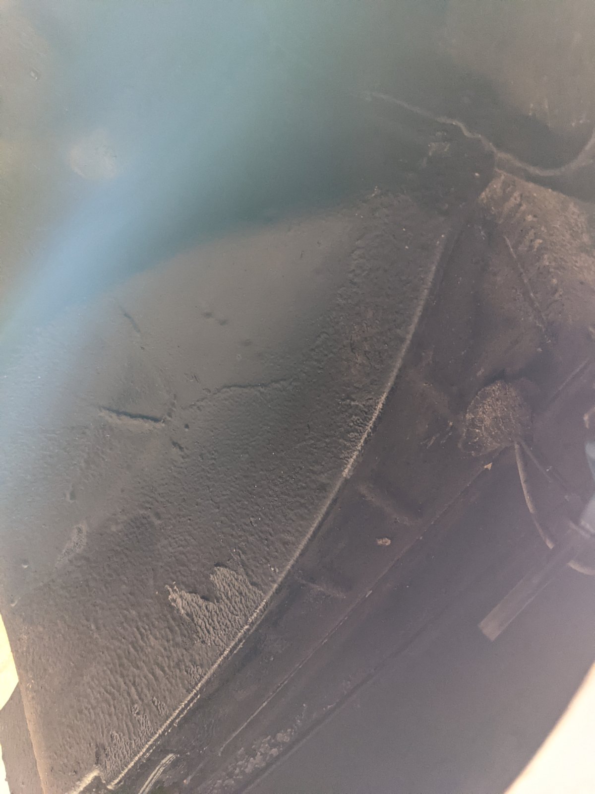

Inner fender shot, no visible rust and when I knock on it it seems solid. I really think there is pretty much zero rust on this car.

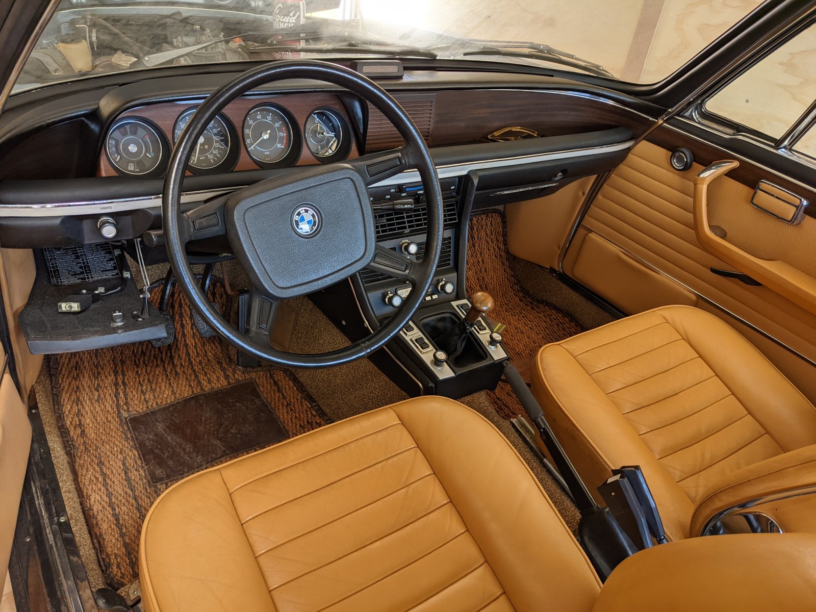

Just another interior shot can't mention enough how pristine it is no cracks everything seems in working order just a little corrosion on the chrome trim pieces should be able to polish those out.
