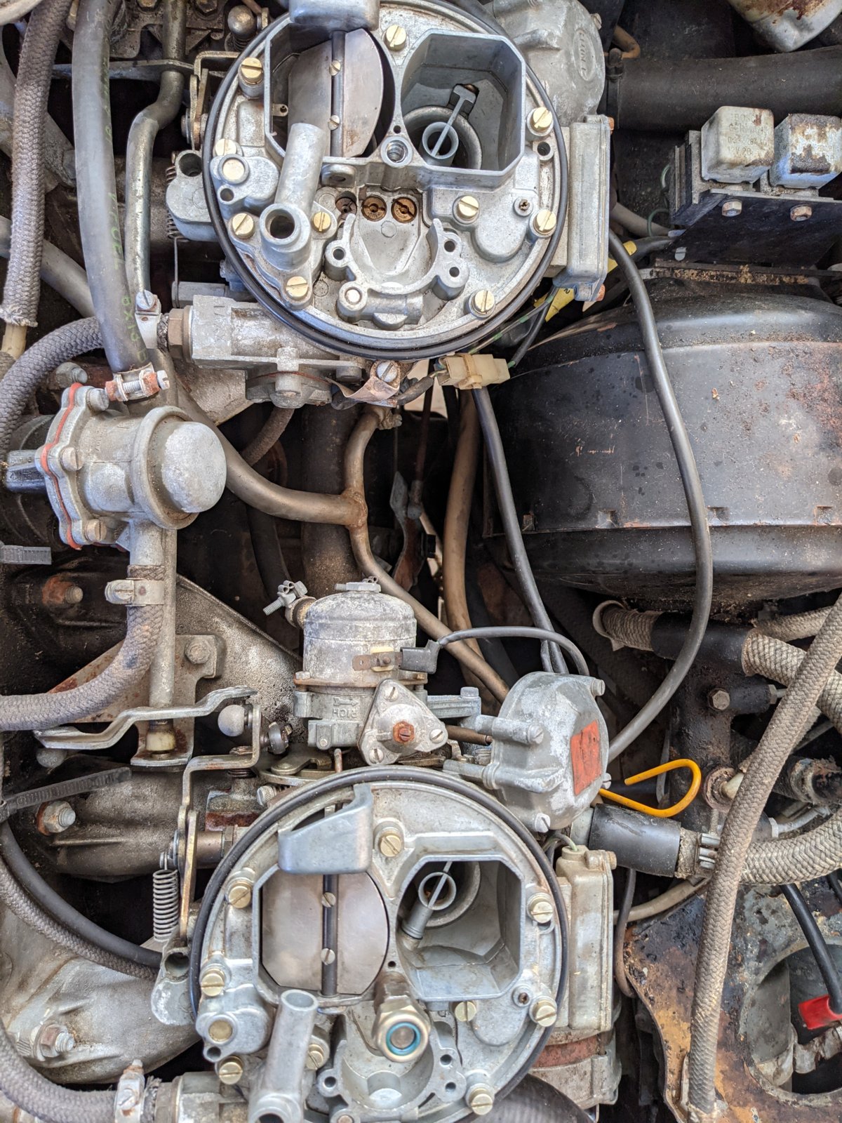

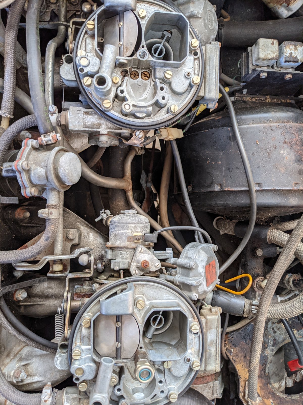

Carbs look clean and not gummed up. The linkage seems to be stuck though, you cant work it by hand and the pedal doesn't seem to want to move either.

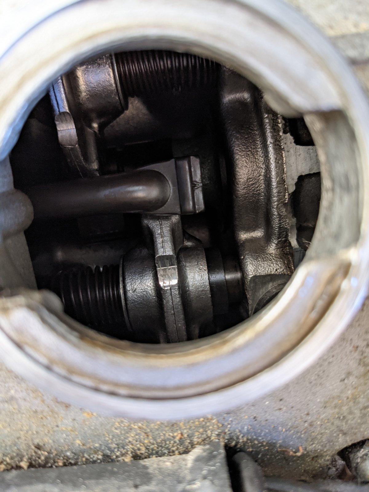

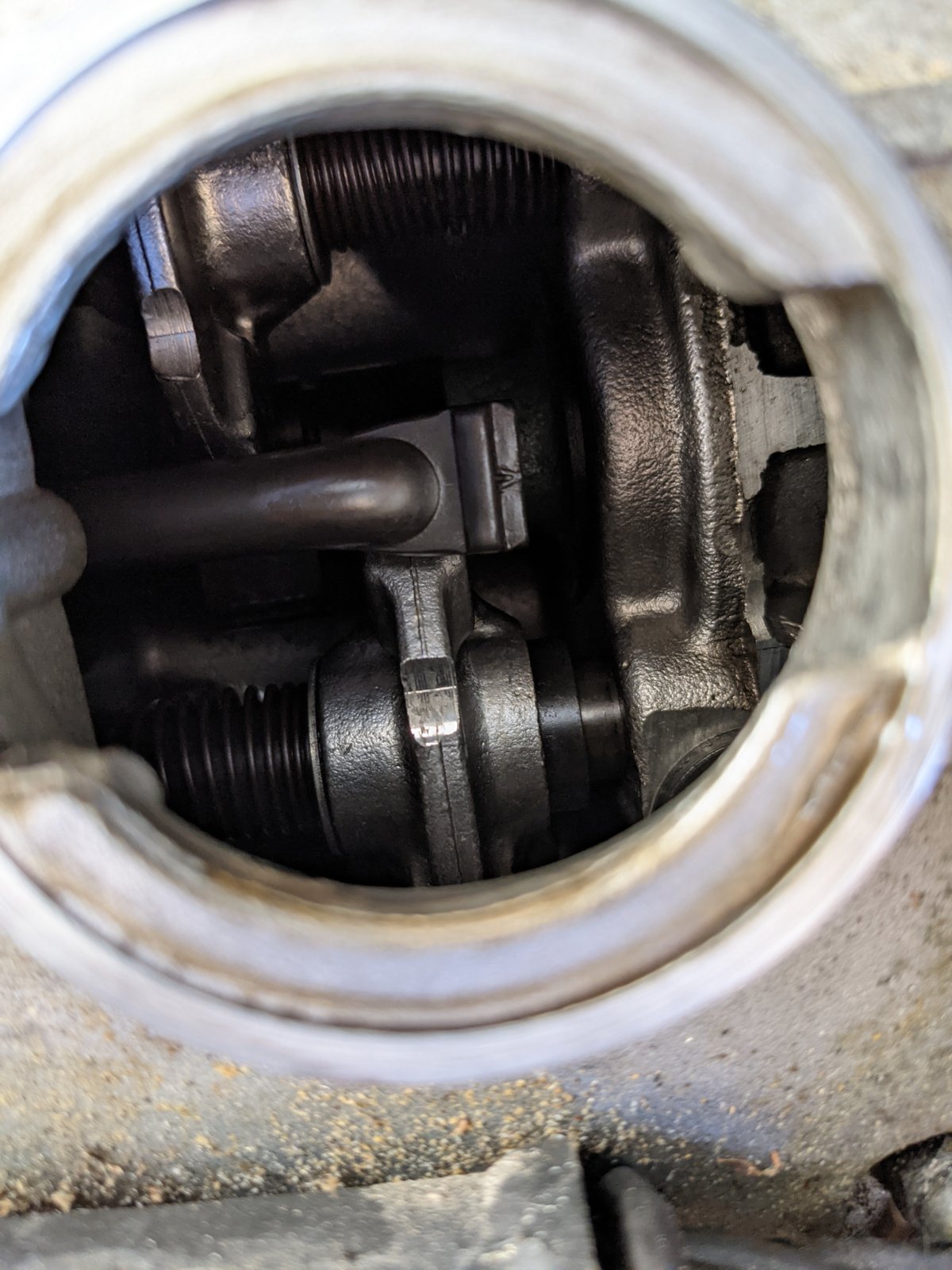

a look through the oil cap, looks brand new to me.

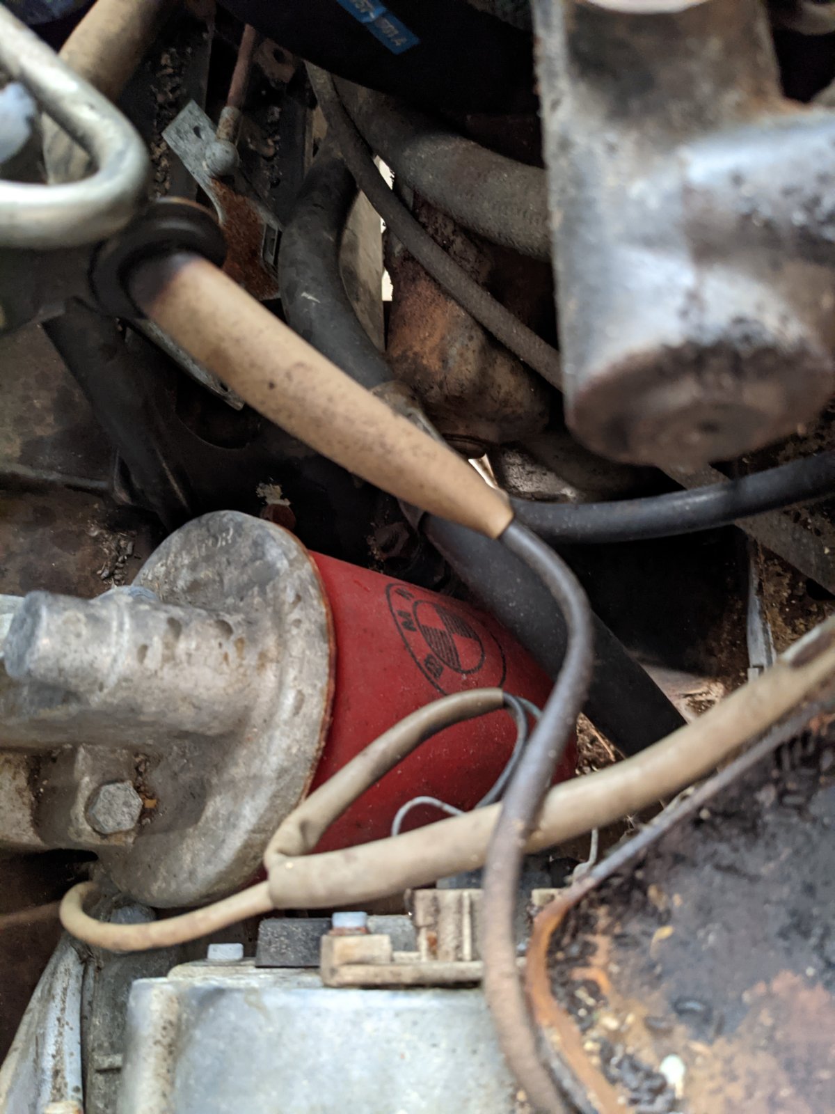

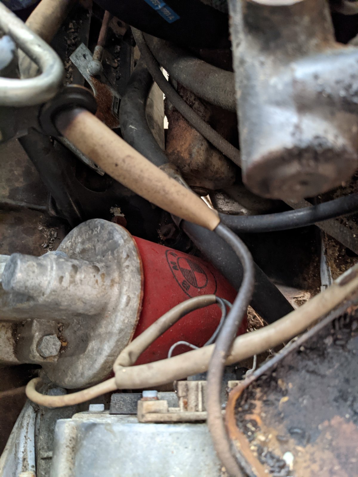

authentic bmw oil filter, pretty neat

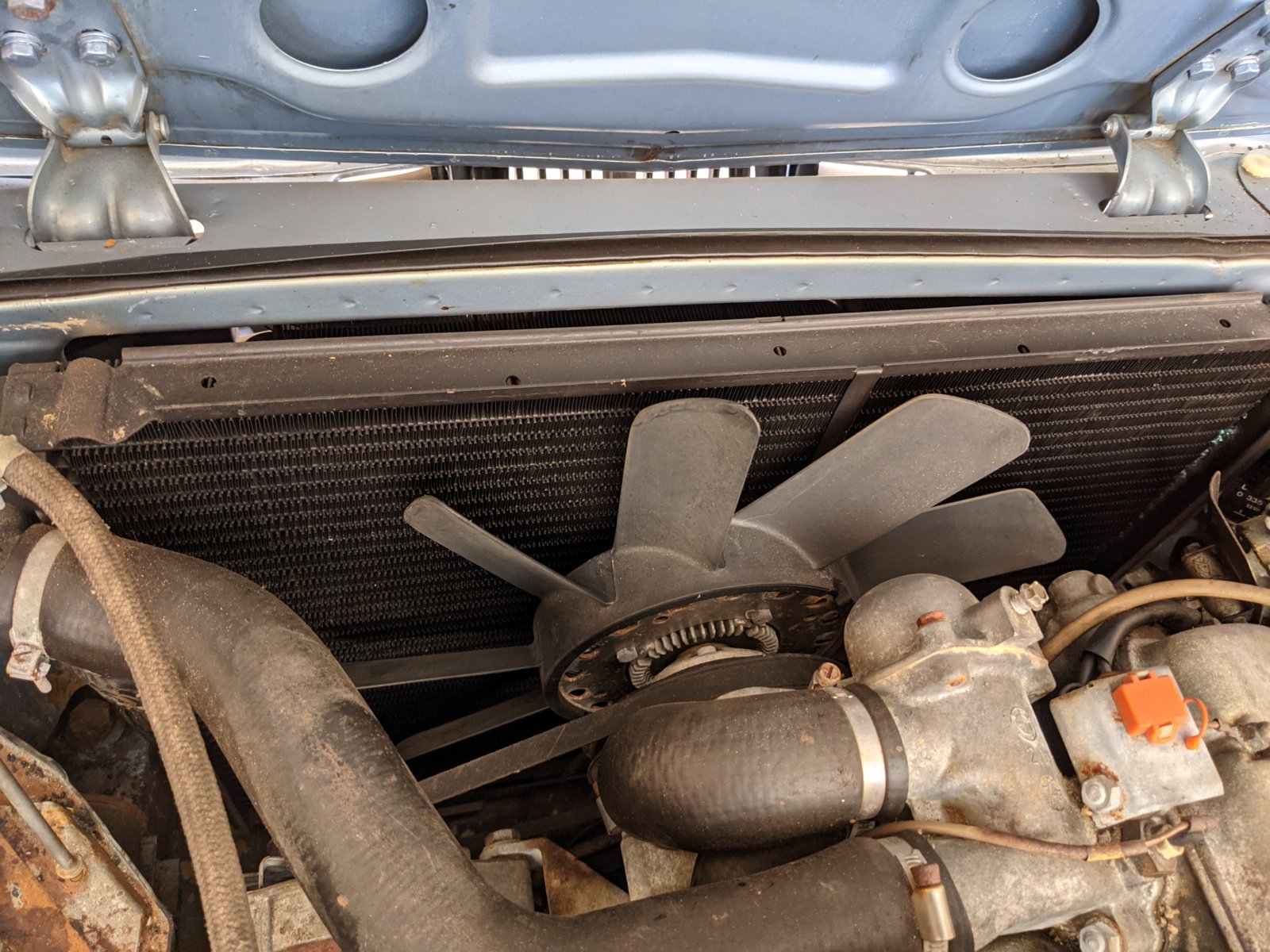

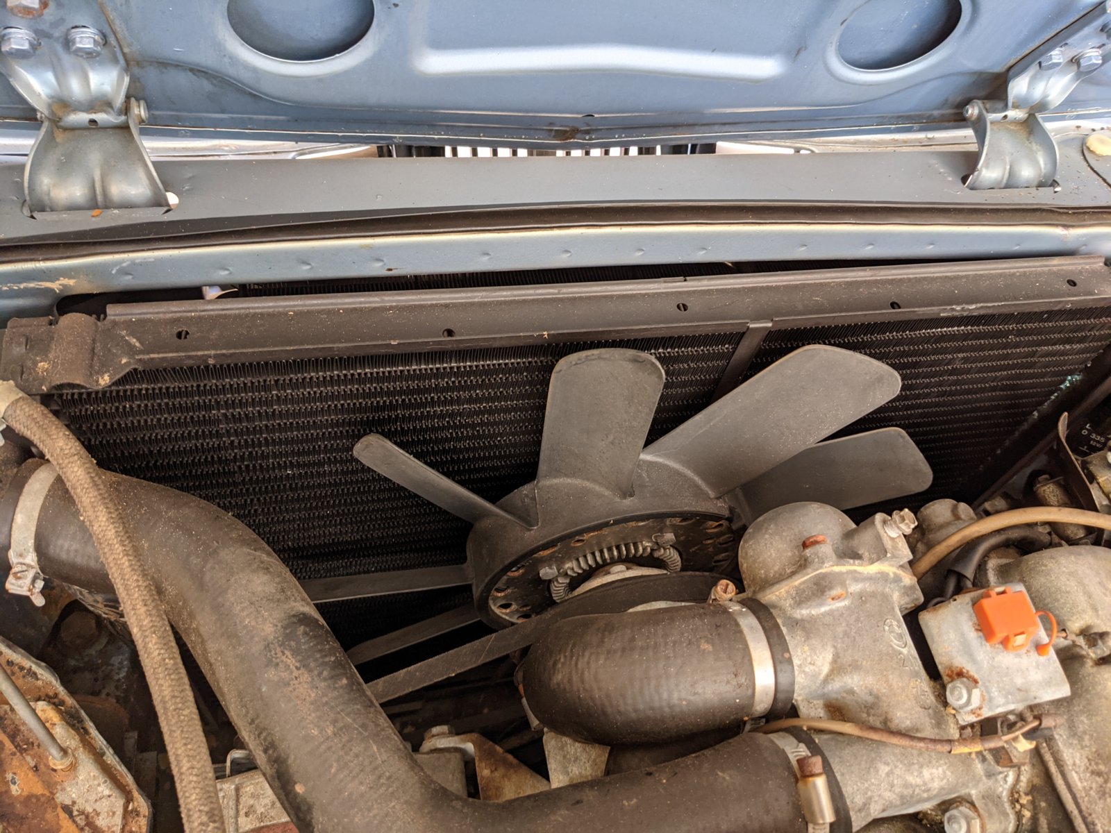

Radiator looks new to me?

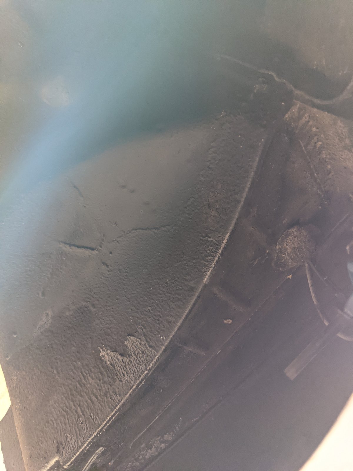

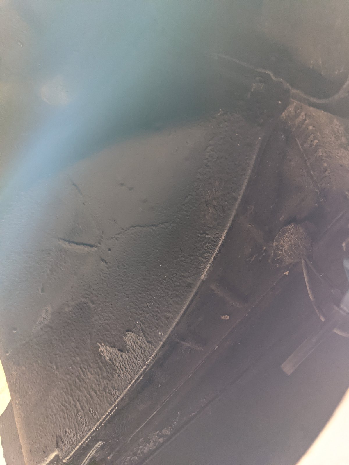

Inner fender shot, no visible rust and when I knock on it it seems solid. I really think there is pretty much zero rust on this car.

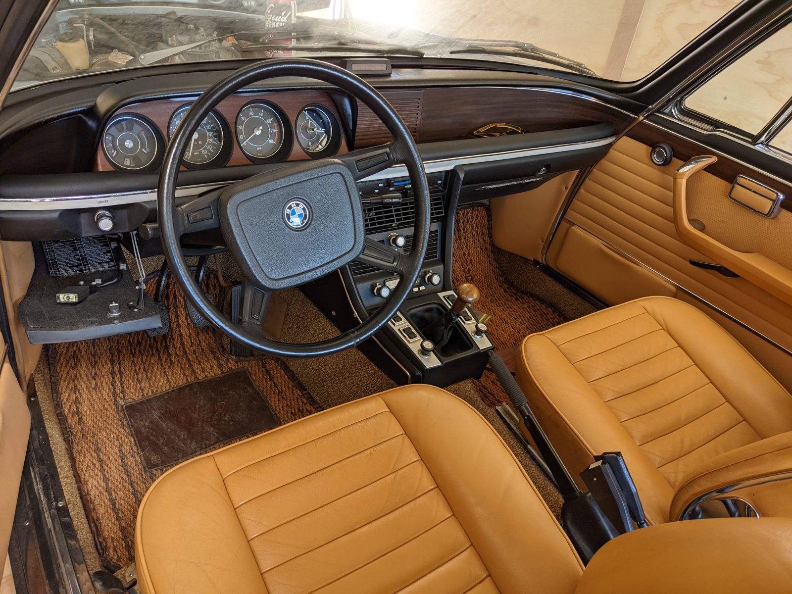

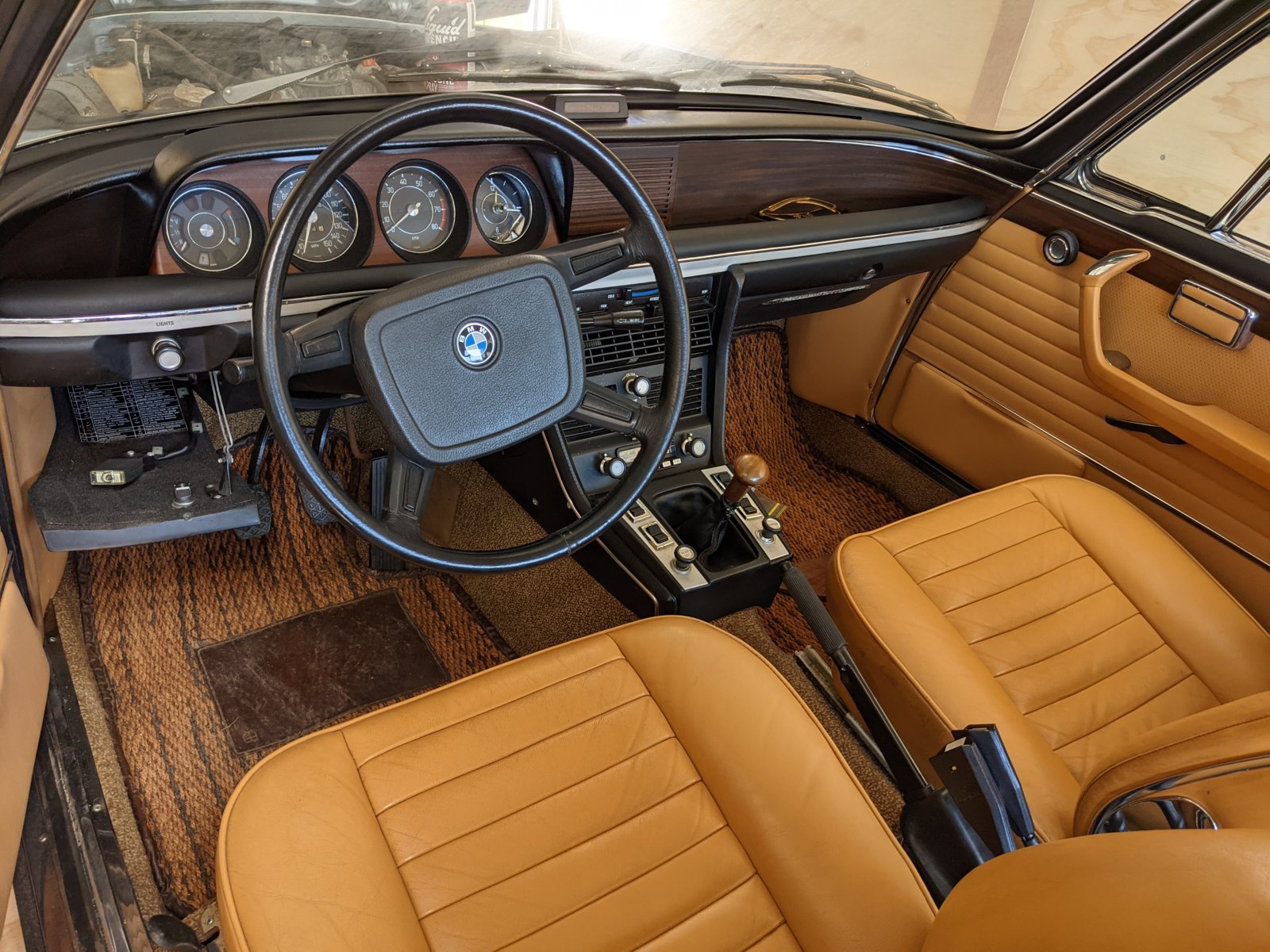

Just another interior shot can't mention enough how pristine it is no cracks everything seems in working order just a little corrosion on the chrome trim pieces should be able to polish those out.

Couple observations: looks like an attempt was made to improve the cooling system. You have a later style 9 blade fan with fan clutch from 1980’s era M30 engines, so water pump had to be replaced to accommodate it. Radiator was likely replaced at the same time. Check the casting date of the head. Look on the intake side of the head with the air cleaner off. If it’s original it will have a circled “74”. Early heads were known to crack if overheated. If will have a later casting year if it’s been replaced. I suspect your great uncle would have kept a record of such a repair. That log book and window sicker are strong evidence of the great care he took of this car.

The 74 had a viscous clutch for the first time.
Chris,
Must be later manufactured models?
Mine was built in May 74 and had the old style non-clutch fan. Early viscous clutch fan were orange 8 blades? Later 9 blades are black? If memory serves.
Chris,
I think this is one of the cases to check the log book and see what (if anything) was done.
Wow, what a fun thread to read through! I think we got him hooked guys! Did you read his excitement for finding the bmw oil filter? That's the nerdy stuff people say when they're hooked.
