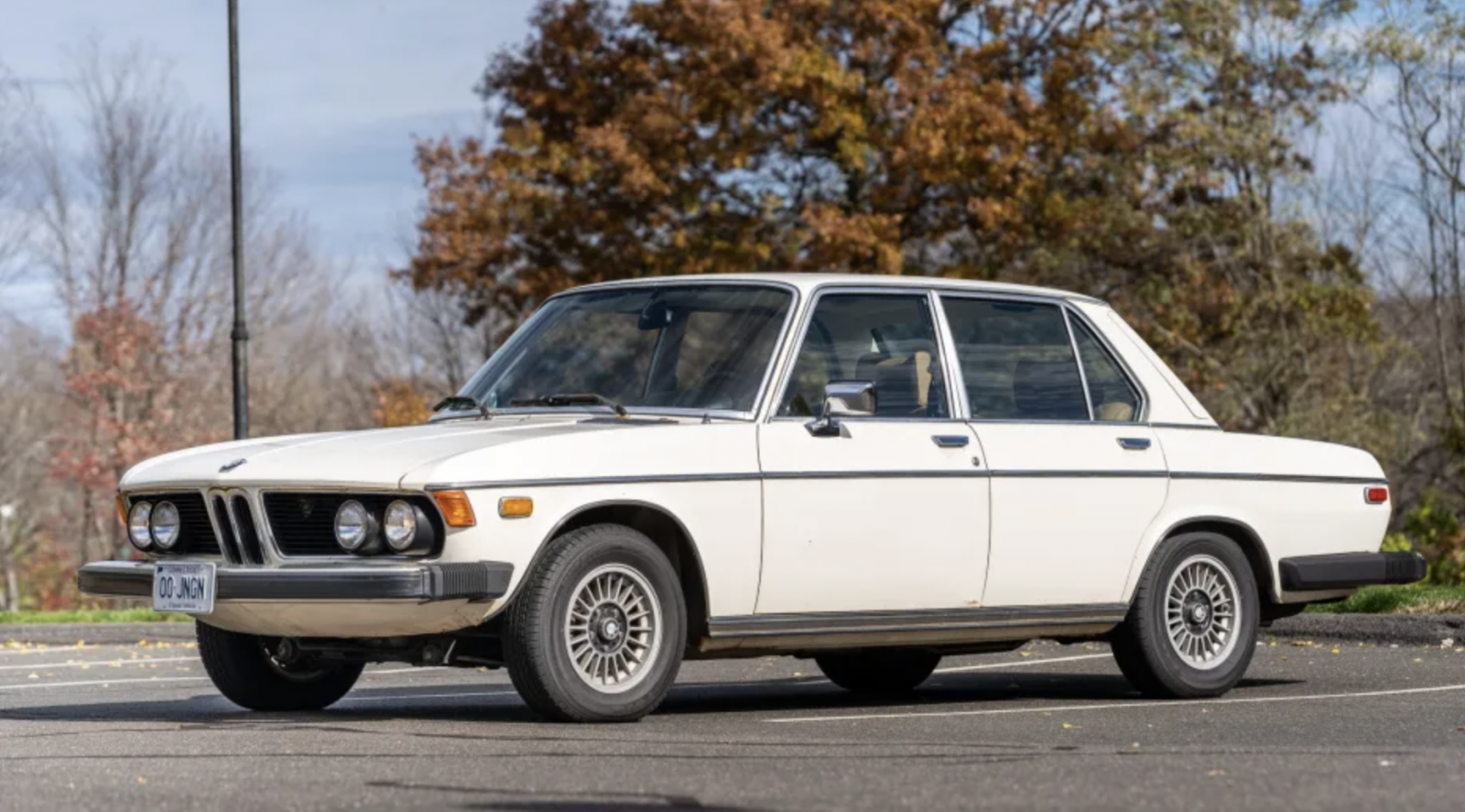

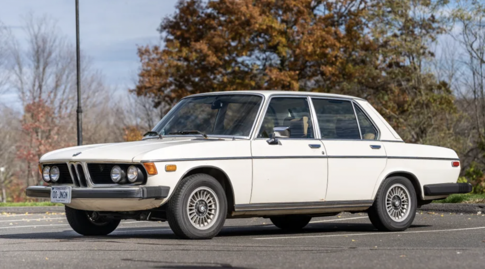

Here is 3105537:
1973 BMW Bavaria 3.0 S
View the 1973 BMW Bavaria 3.0 S at Gooding Christie’s's Amelia Island 2019. Contact us for more information.www.goodingco.com

That's a 3.0 S Bavaria 4-speed Series 2 built in 1973, most likely February. Not quite the car in the picture.3105114 is the number...
