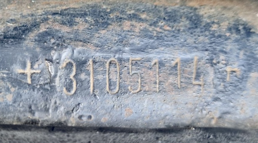

Here is 3105537:
I would take a closer look at your VIN plate. It should be clean metal. The area doesn’t rust out. There shouldn’t be filler, weld spatter, or cooled weld puddles. You may see paint drips, or a visible rectangle around the digits.
When I look at this VIN, obviously biased by the info above.. I wonder if that is weld pooling above the 3 and spatter below the 3 and less so across most of the digits (see the base of the 0 and 5). I also see an artifact between the + and the 3 that may have seen an angle grinder.
Like I said I’m biased, because the VIN range doesn’t match the chassis.

They look stamped to me, and looks like a factory e3 stamping. The area around the stamp is suspect.
Always stamped. Some pictures create the illusion of raised numbers which is hard to fight. To me, the small piece with the seven figures looks cut out and welded back in. The two crosses might be original.
3105114 is the number...
That's a 3.0 S Bavaria 4-speed Series 2 built in 1973, most likely February. Not quite the car in the picture.
