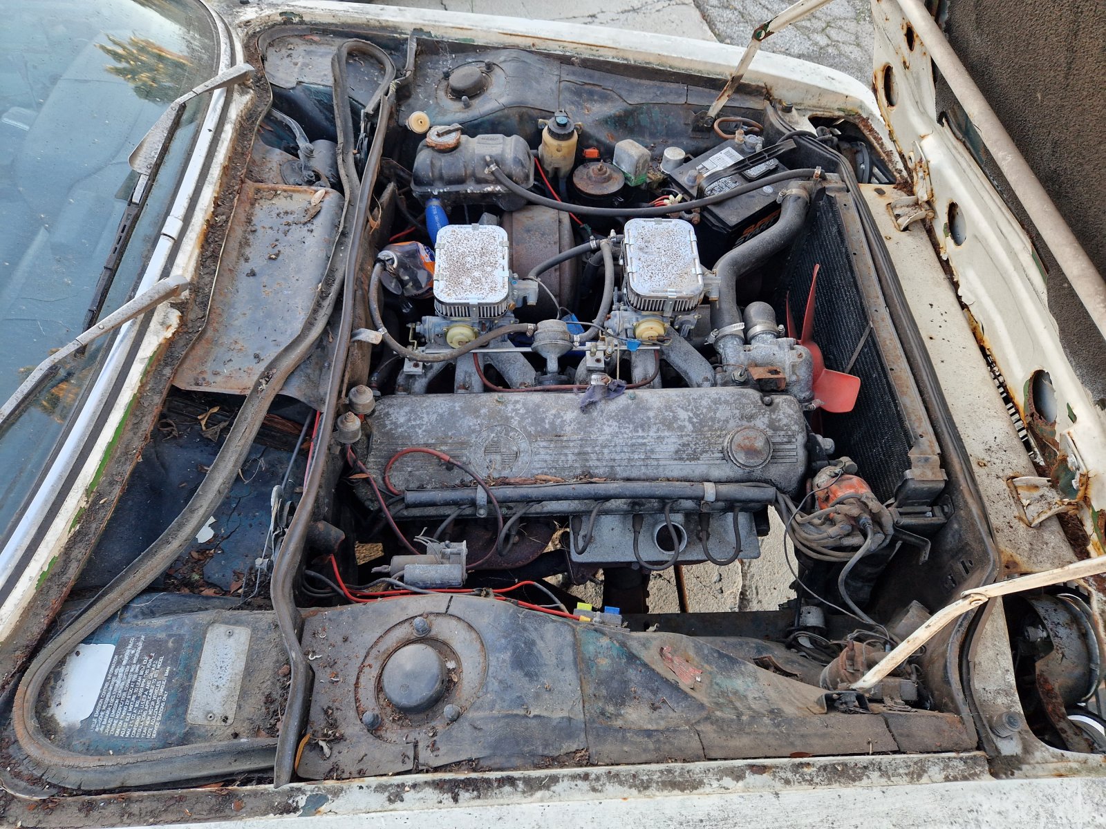

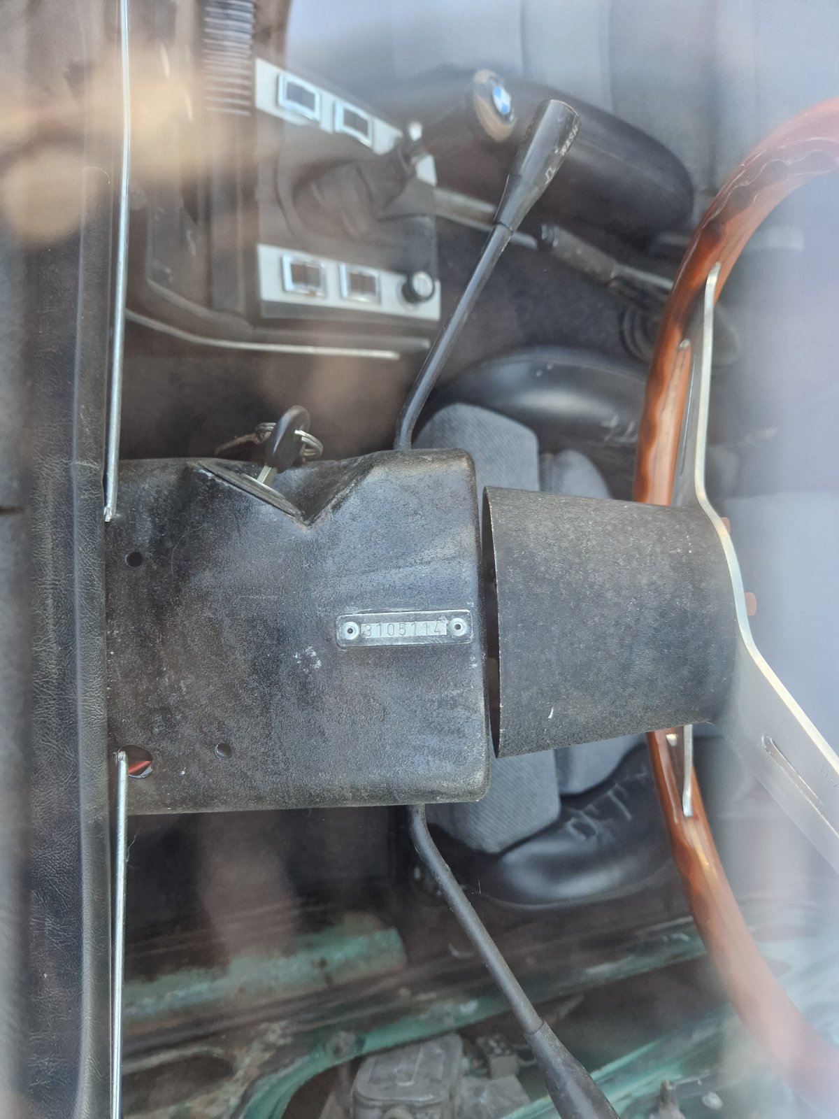

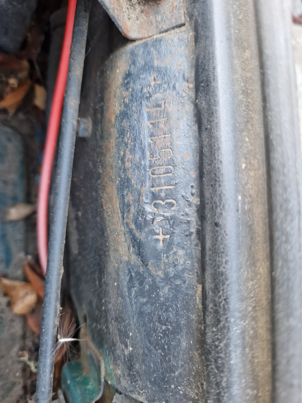

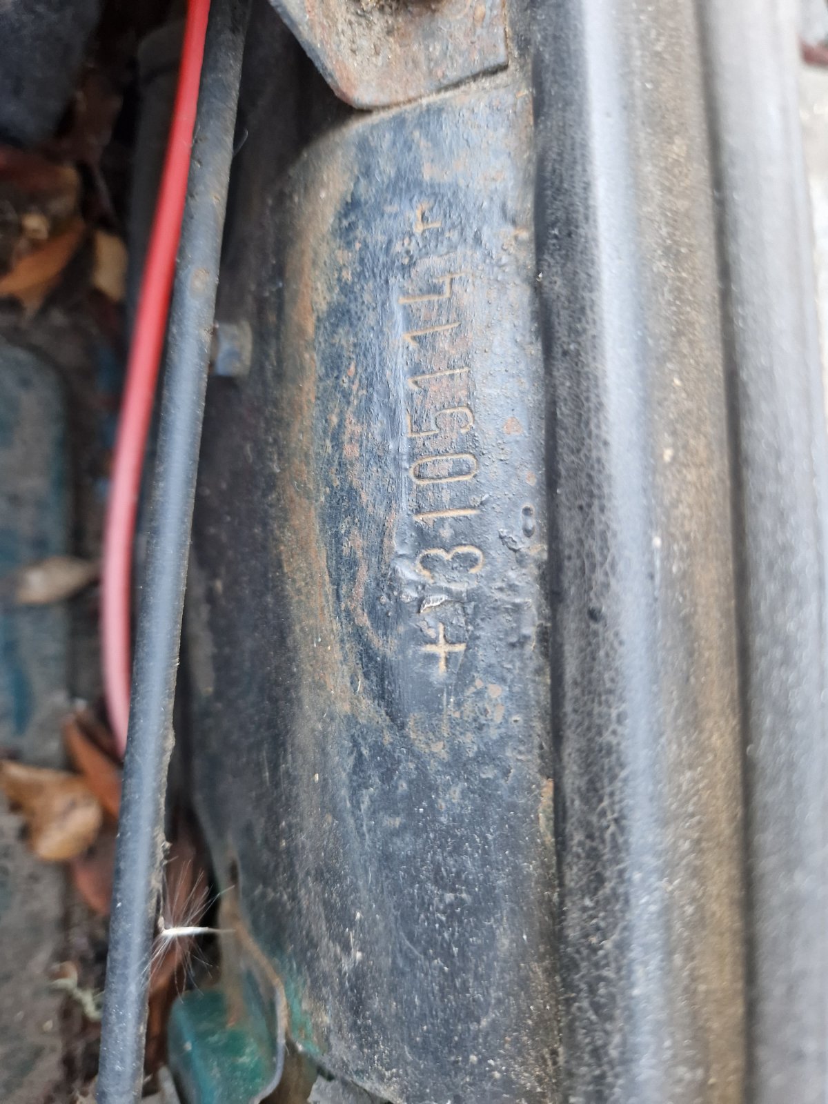

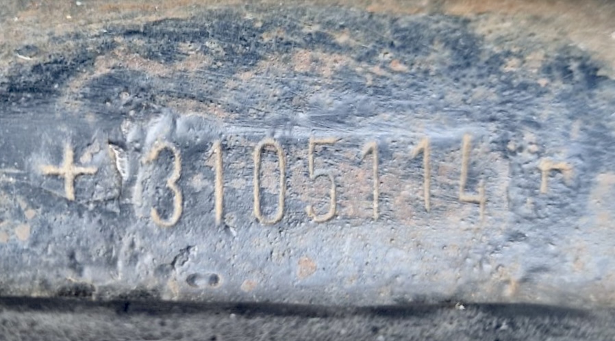

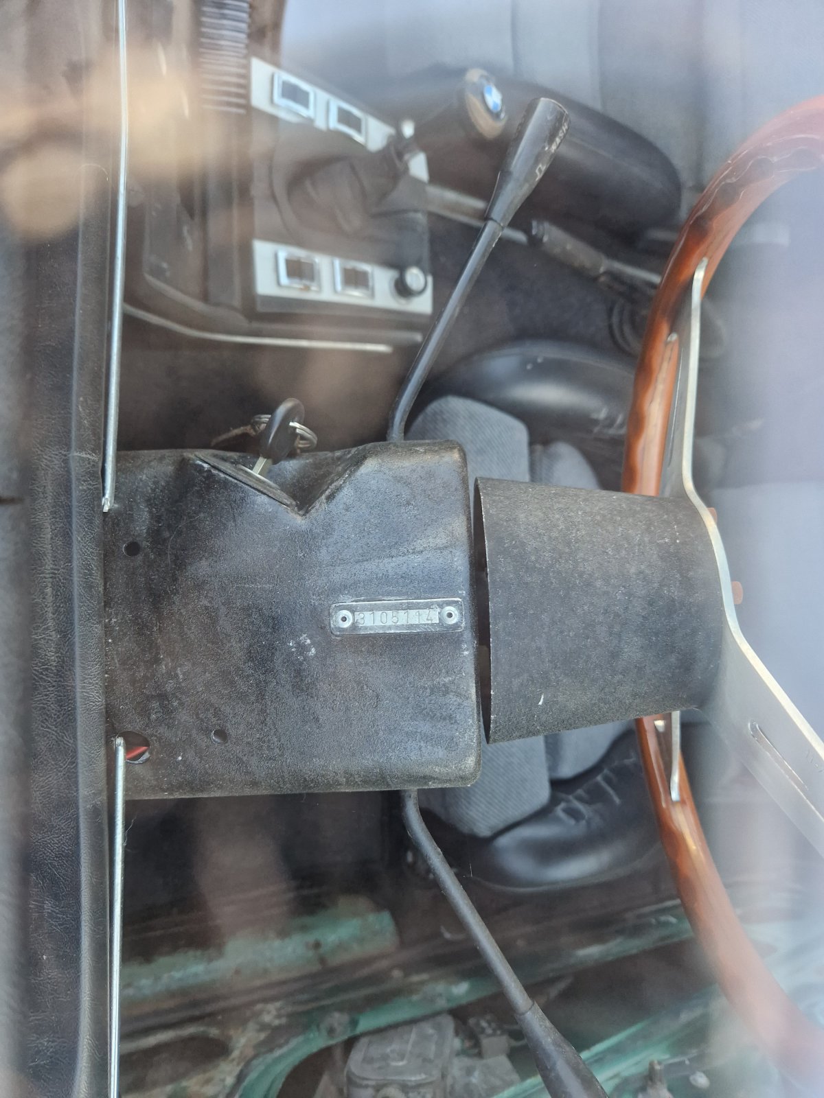

Got some photos of the firewall and steering they match the plaque. Could not get to the starter and the cylinder head is clearly recent so maybe not original motor.
Title agrees with the vin and e9 model as a 3.0 CS 1973.
Strange.

The engine is basically meaningless at this point.

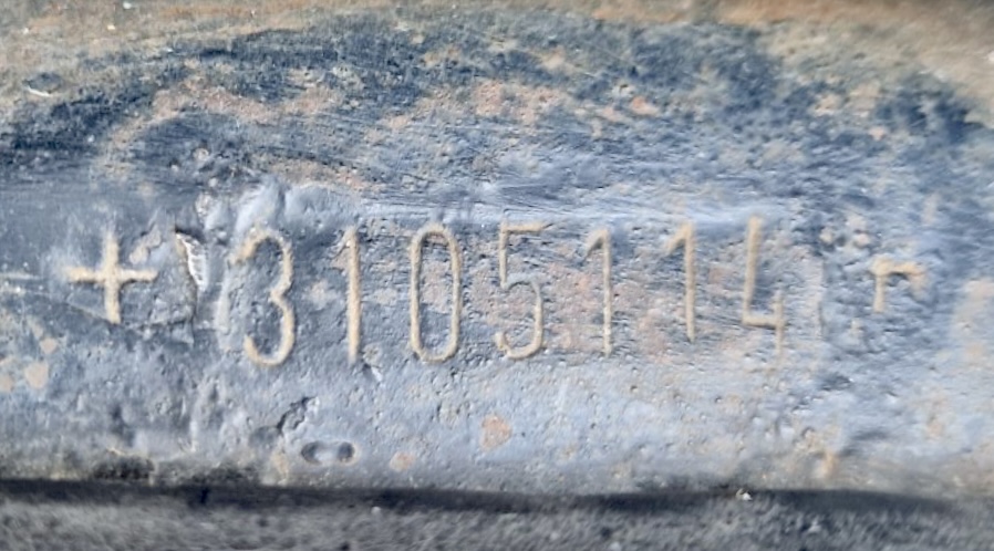

Find, clean and photograph the VIN on the firewall.
Posted the firewall photo. I looked a little and could see no signs of tampering.

Here is 3105537:
I would take a closer look at your VIN plate. It should be clean metal. The area doesn’t rust out. There shouldn’t be filler, weld spatter, or cooled weld puddles. You may see paint drips, or a visible rectangle around the digits.
When I look at this VIN, obviously biased by the info above.. I wonder if that is weld pooling above the 3 and spatter below the 3 and less so across most of the digits (see the base of the 0 and 5). I also see an artifact between the + and the 3 that may have seen an angle grinder.
Like I said I’m biased, because the VIN range doesn’t match the chassis.

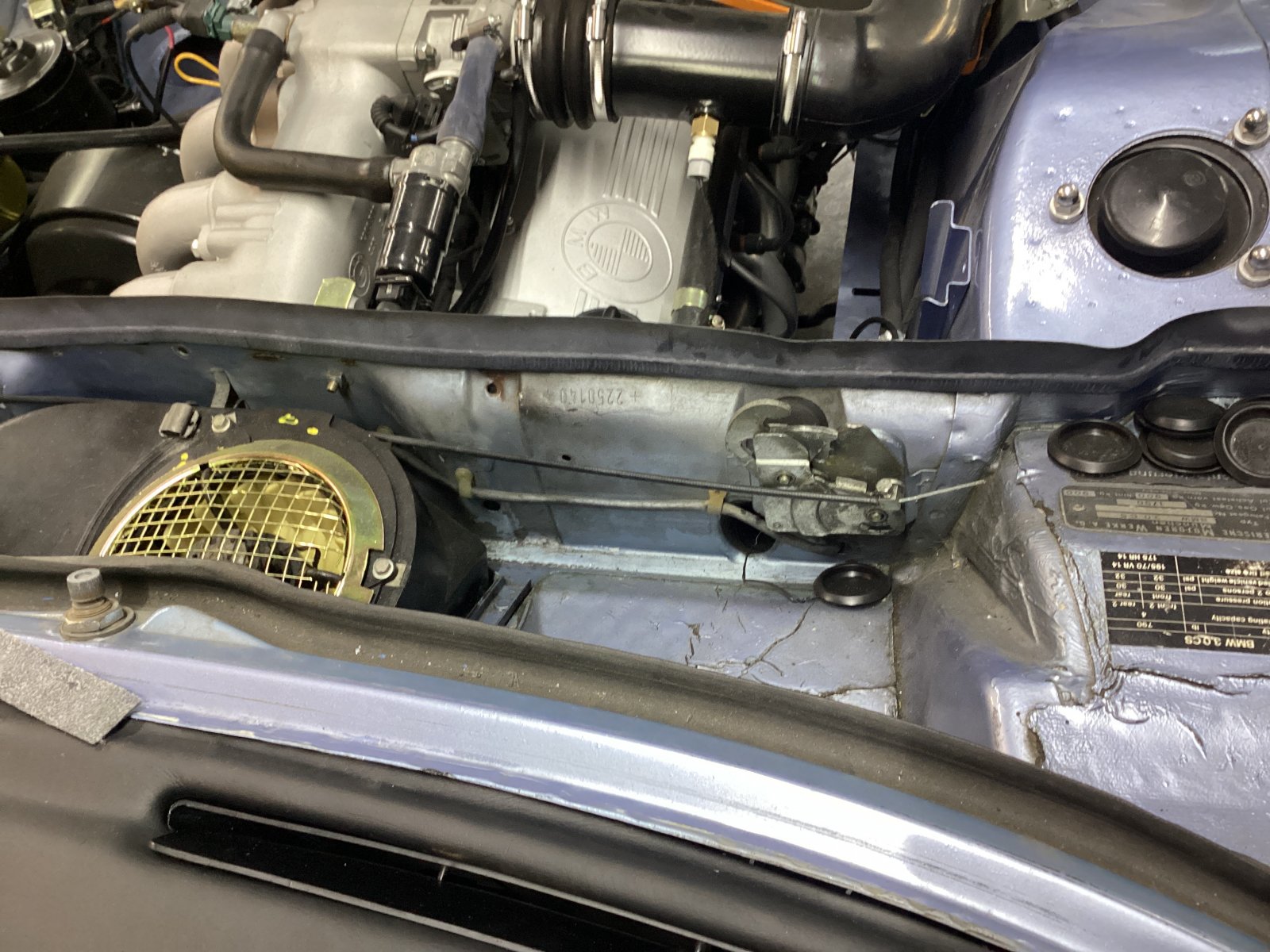

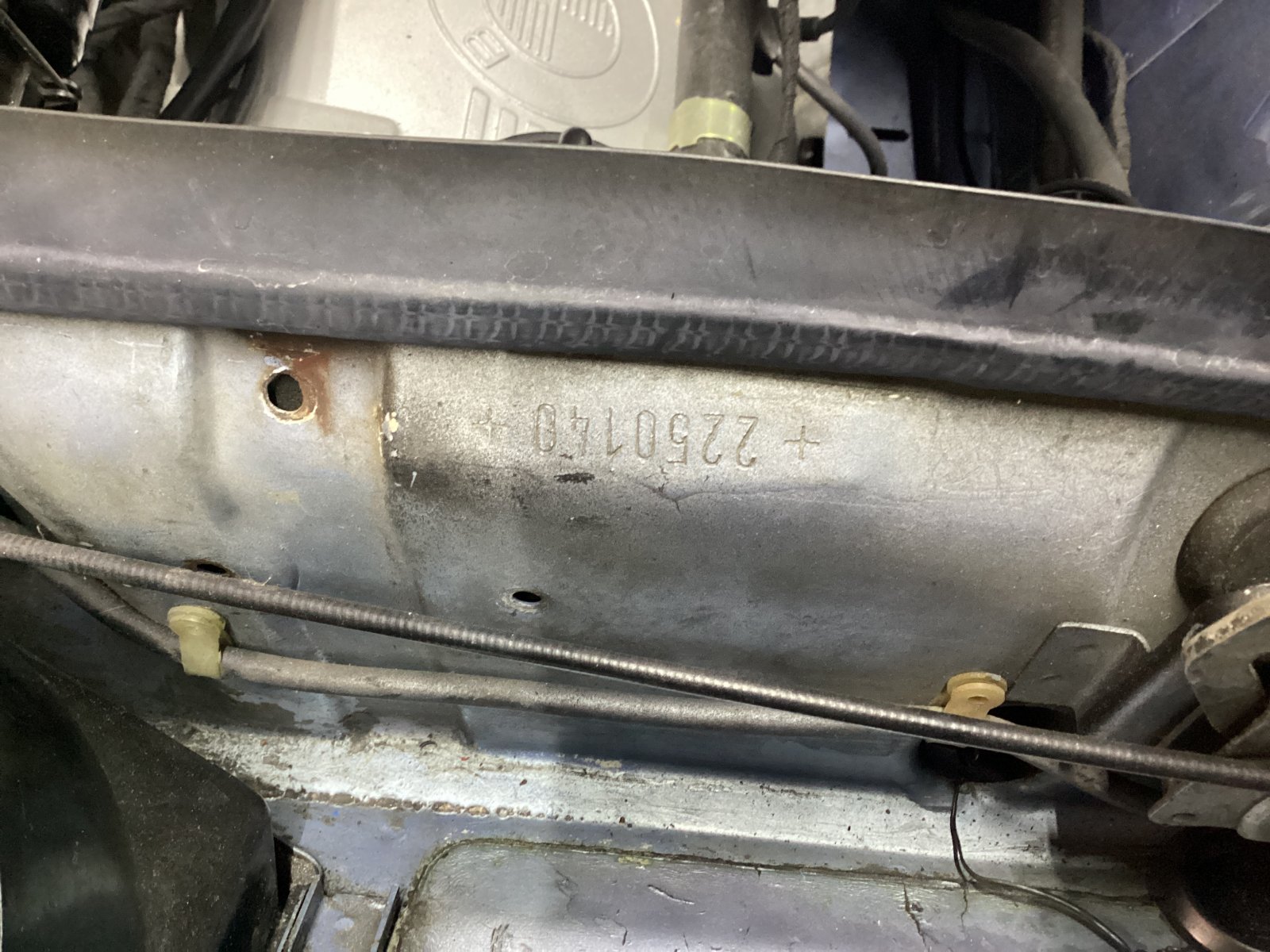

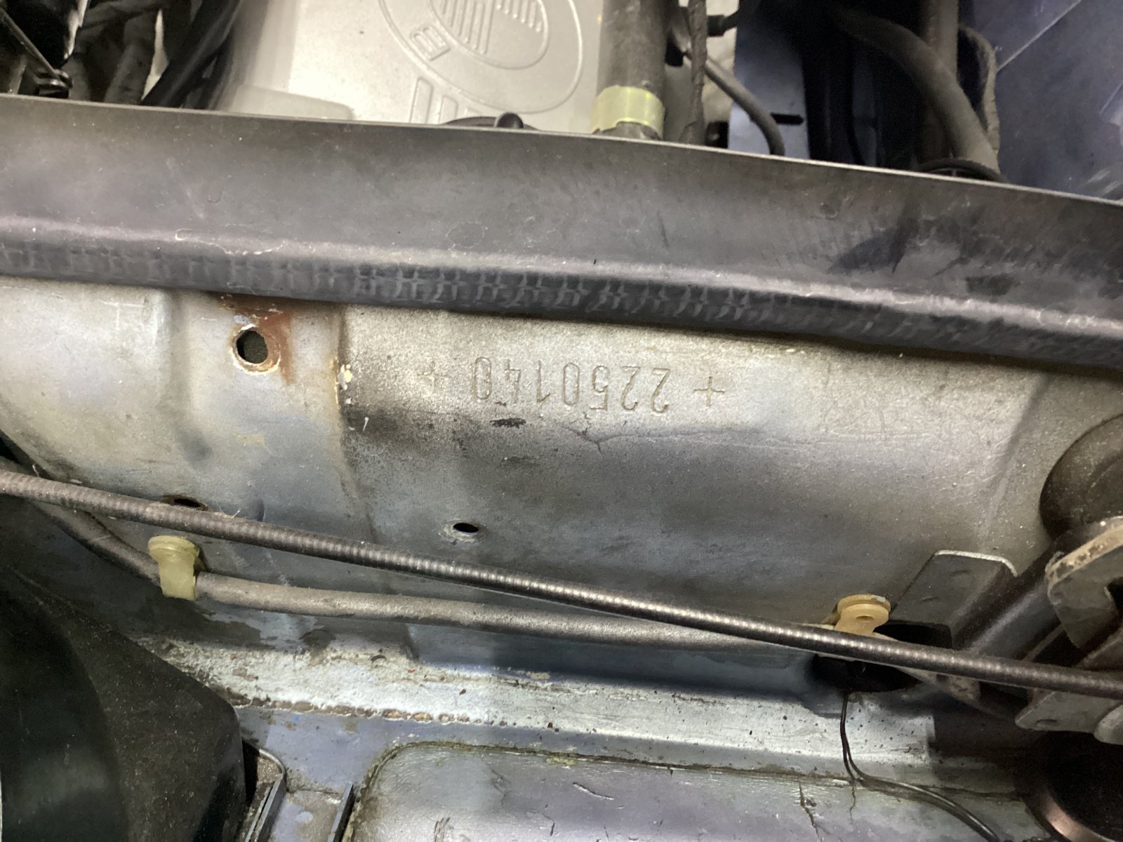

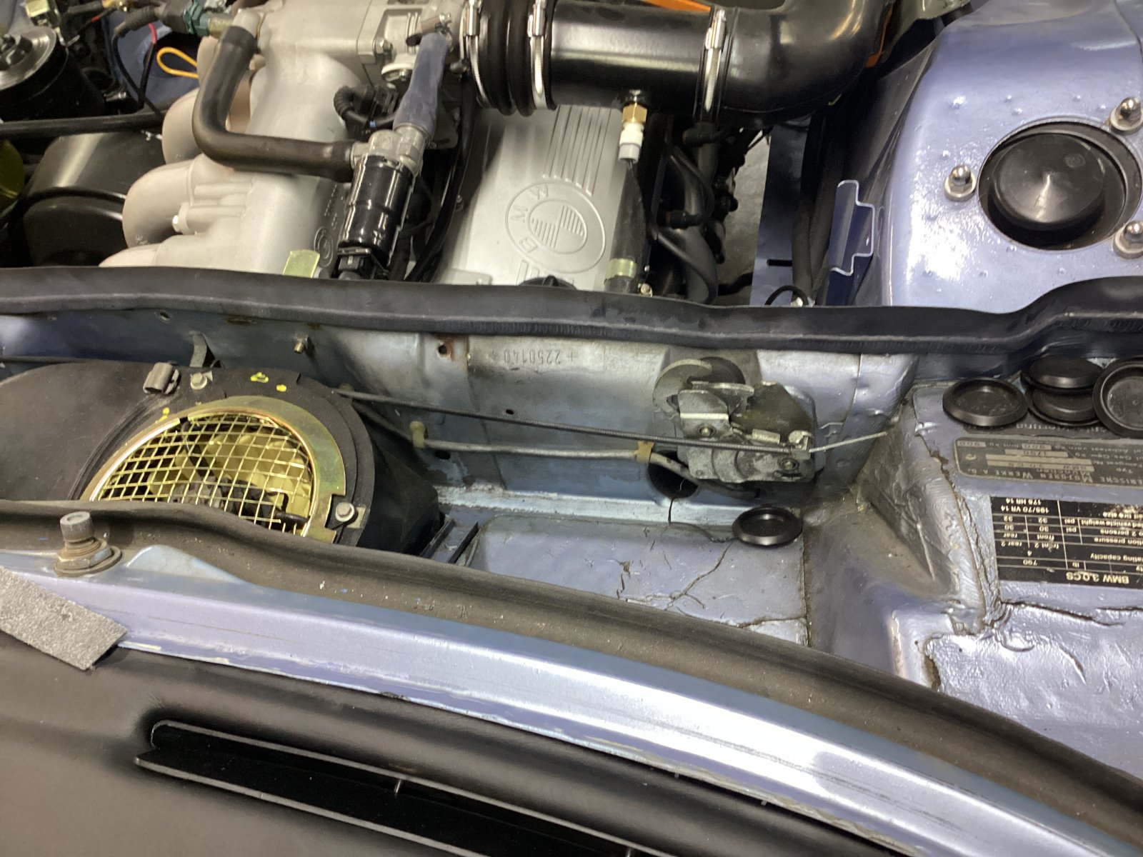

Are all the numbers in firewall VIN etched/stamped in or are some raised up?
Good question. Mine are stamped, as are the ones Don posted. The numbers on this car's firewall appear to be raised.
One would need to investigate that firewall stamped area more closely (in person), but it sure does appear to be tampered with. I think the theory that some PO (before the current poster's friend) had falsely transferred the VIN identification components from an E3 to an E9. Why? Maybe the E9 had a salvage title. Maybe the E9 was stolen so the VIN was removed to conceal it's original identity. All just speculation, but a coupe with a sedan VIN is not something that would have come from the factory.
They look stamped to me, and looks like a factory e3 stamping. The area around the stamp is suspect. The only way that VIN got on an e9 is if it was added by an owner.

Yes I will carefully clean up the area and take some more photos. Wonder if the firewall top piece could have been swapped..

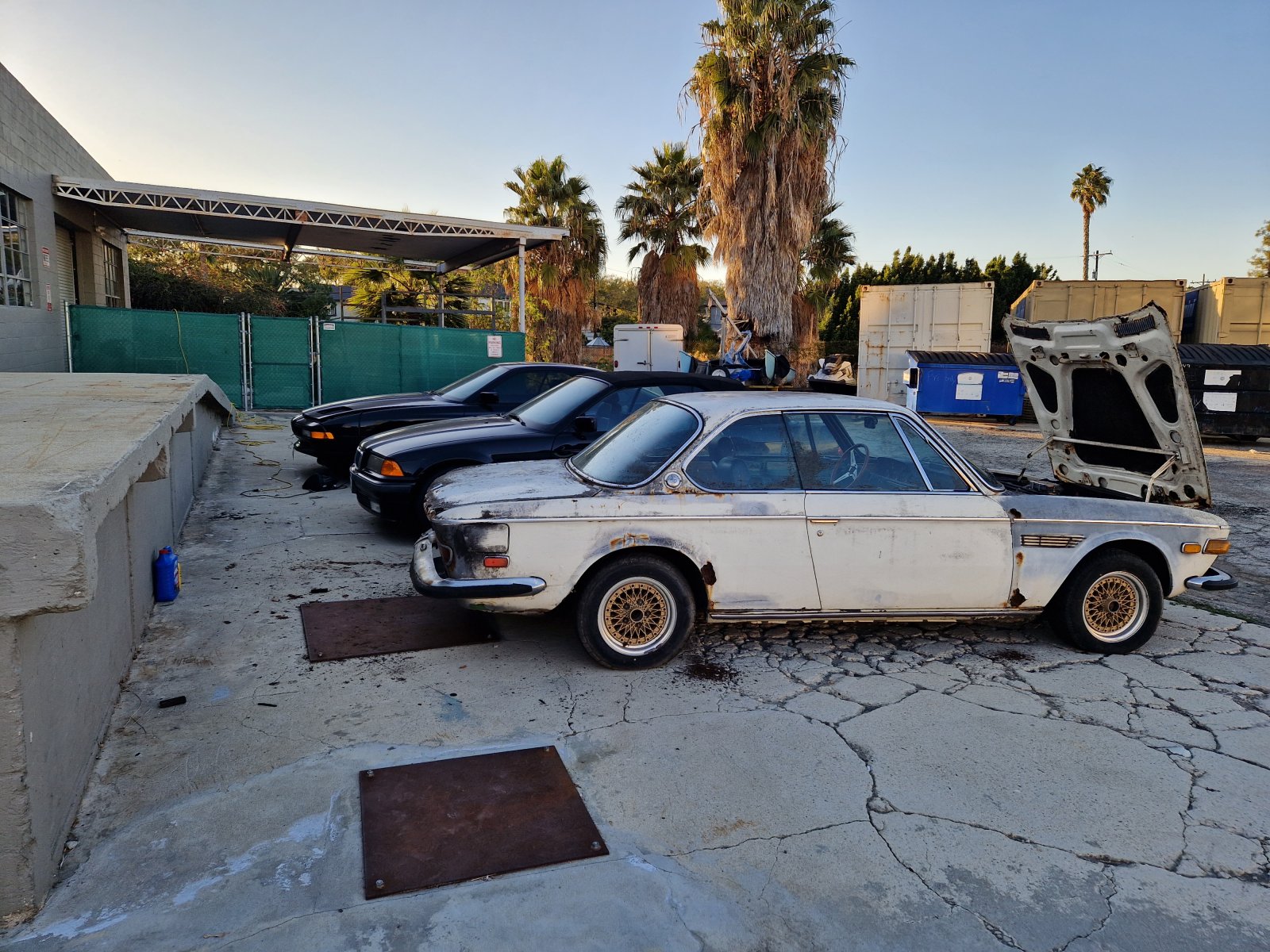

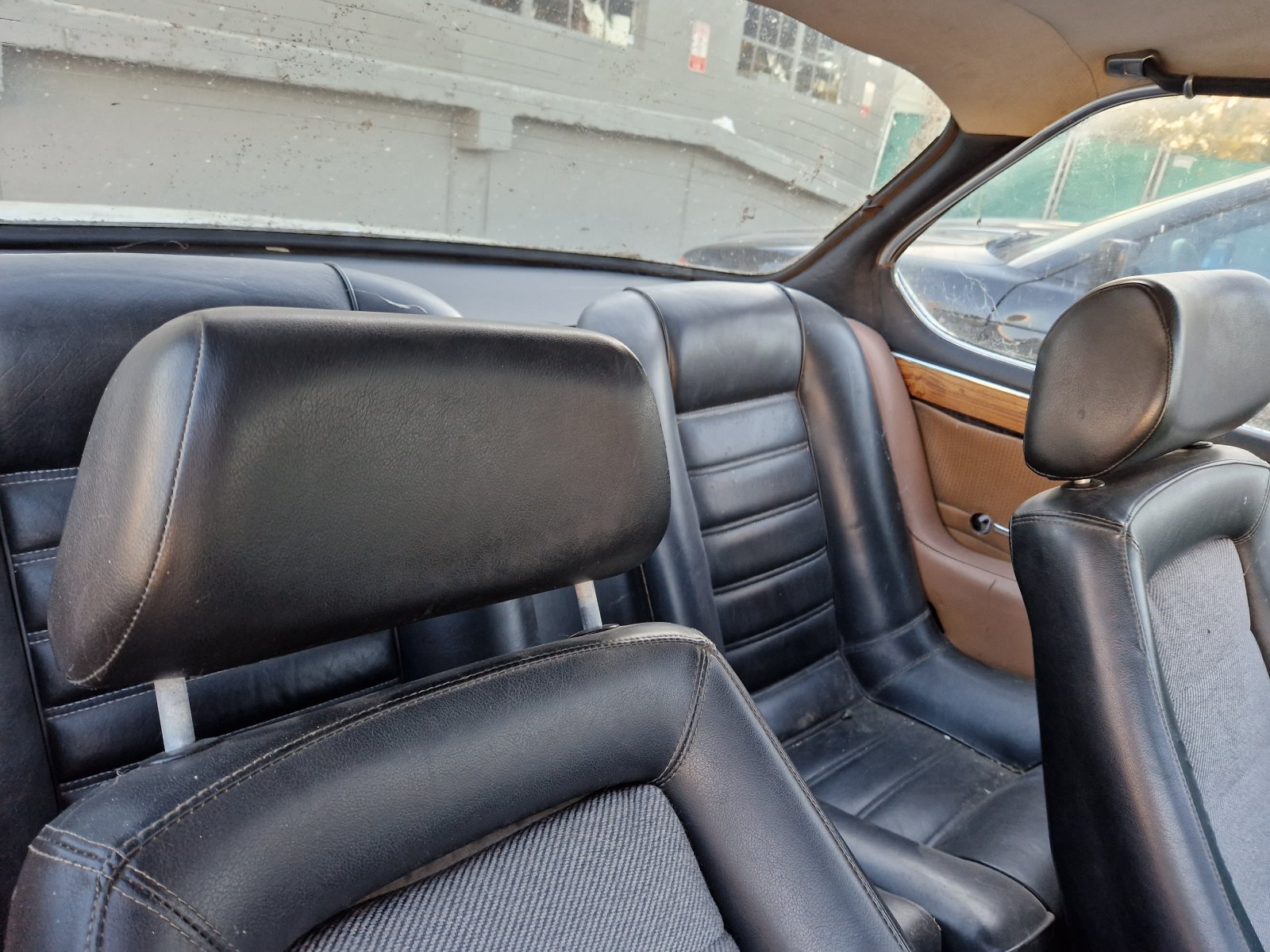

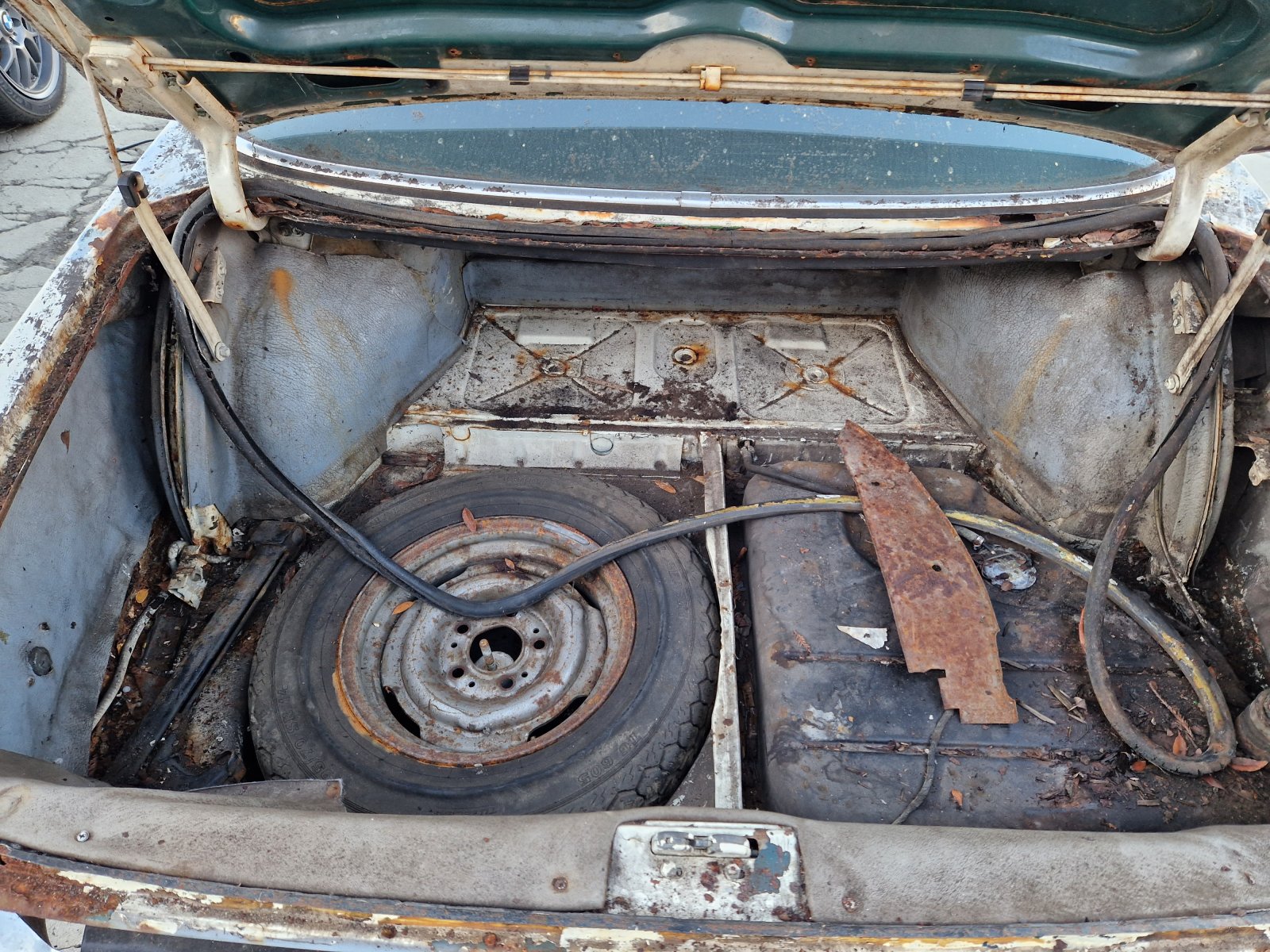

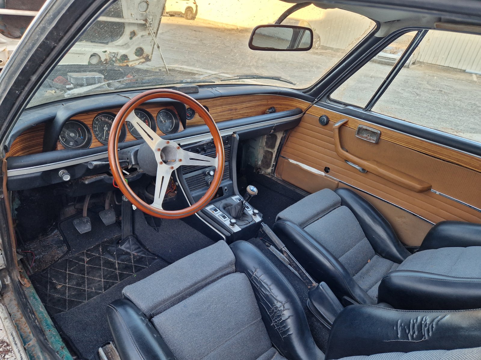

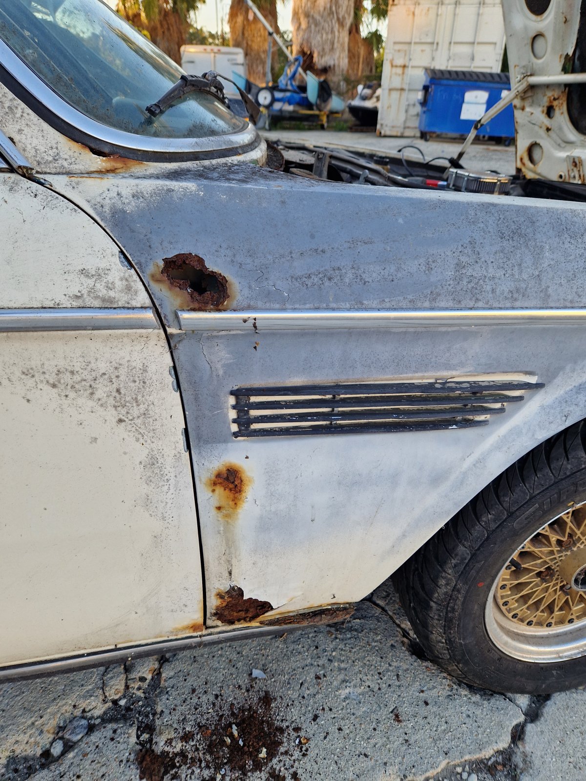

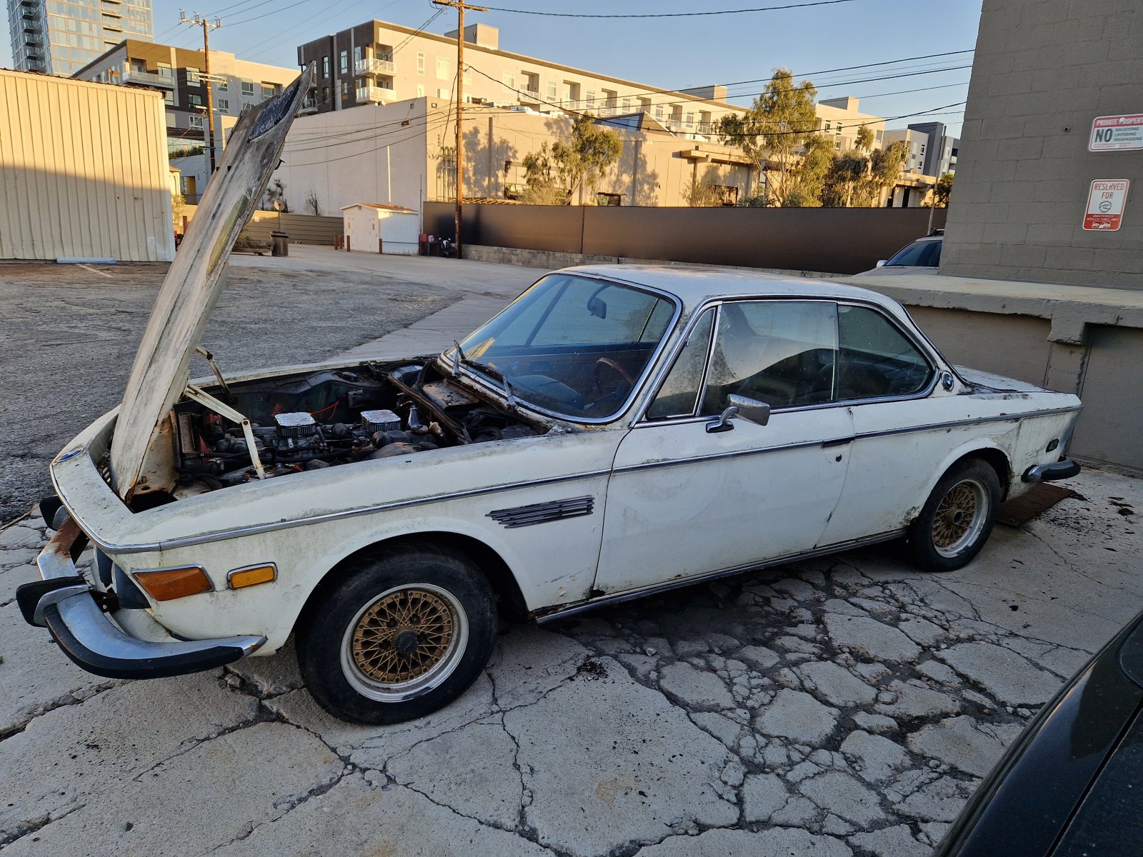

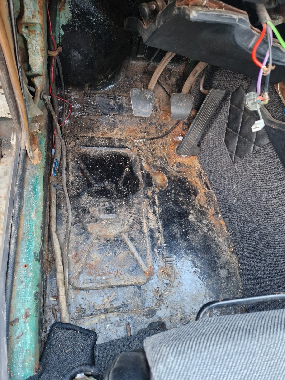

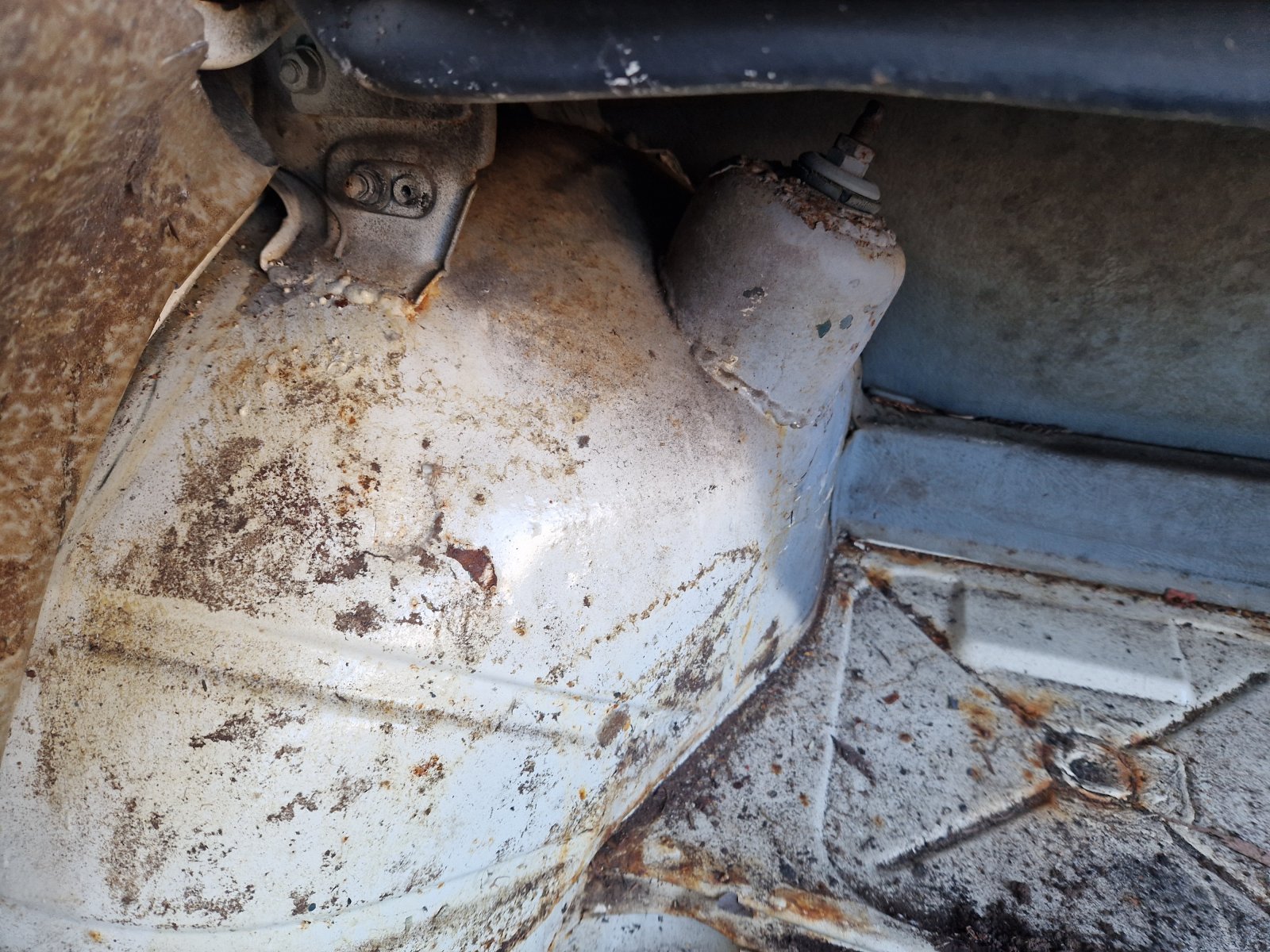

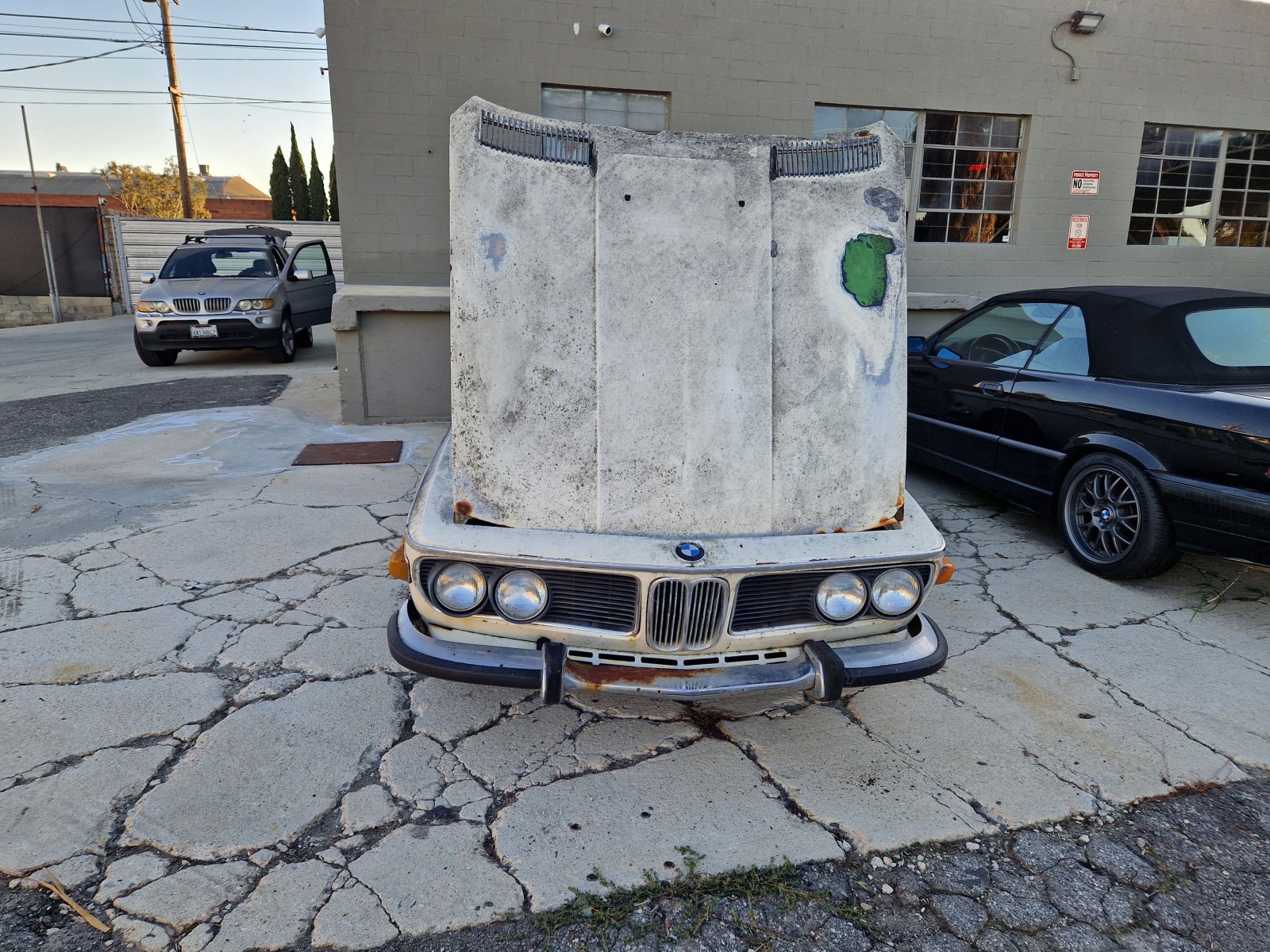

Anyway the car is in bad shape and I will likely not do a "full" restore. Here are some photos that may help identify the actual year and model that it is.
Note inside has been redone with new floor plates and recaros with back seats from an e24. original color was clearly the green.

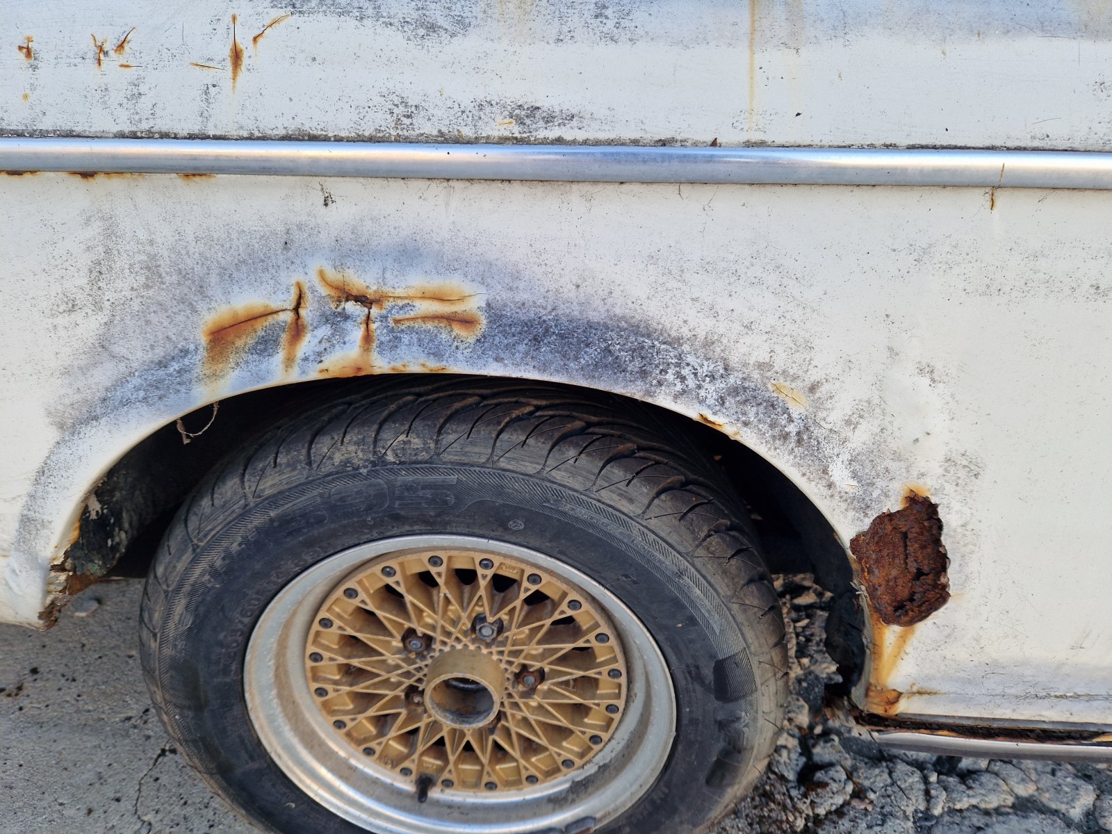

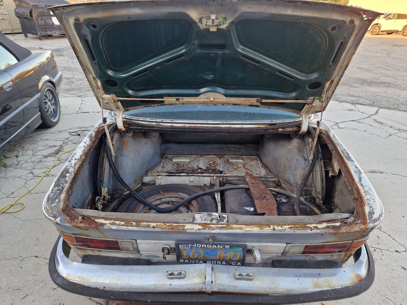

Car is quite rusted which will take a lot of time and effort to get anywhere near to correct so the VIN issues really present a value problem...
Actually most of the rust is confined to the areas shown. It is deep but crawling under the car shows very solid undercarriage and when driven it handles quite stiffly.
For example the shock towers front and rear are fine, diff mount looks ok as do the subframe mounts. I will get it on the lift and have a real look tomorrow.
Not interested in making it perfect just good enough to paint it and have the paint last 5 years or so.

You've got to cut both front fenders off to get to the rust that's likely destroyed the a-pillars. It's not a small undertaking. Not impossible by any means it's just what do you want to do with it. If you plan on selling it down the road the VIN presents some relatively serious issues. Again, it's all down to what you want to do with it. My 2 cents!
Car appears to have 73 US bumpers.
In addition to the concern about the A-pillars, the trim over the rockers/door sills does not look good. Usually with extensive visible rust, the stuff you can't see is worse. I would pull off that trim and evaluate the work needed. Pulling off the fenders and repairing the rockers is pretty expensve, but imperative to make the car sound.
It is an early US 73 as it has the 73 bumpers and early window motors so built before Feb/March of 73. I personally think it is too far gone but our friends in Europe would probably give it a go.
The car I am seeing in the photos above, in fact, appears to have serious rust issues. I would surmise from the photographs that the sills are quite rotten. This is the longitudinal structure of the car. I am usually very generous with my "save them all" attitude, but this car seems to be structurally challenged. I suspect the corrosion is worse than you think - but I hope I am wrong.
