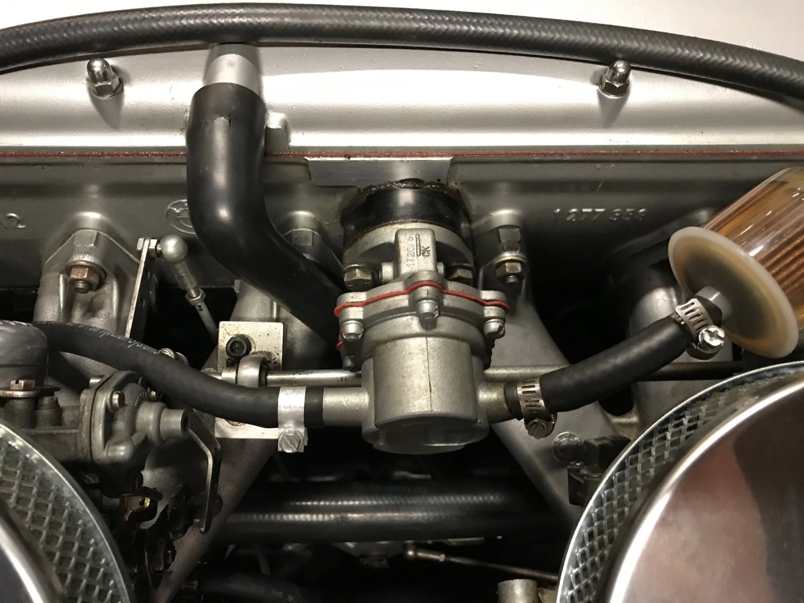

Has anyone had this situation? The Weber linkage is in the way of the newer style Pierburg fuel pump. I can get it on there but to tighten it down all the way puts pressure on the linkage.

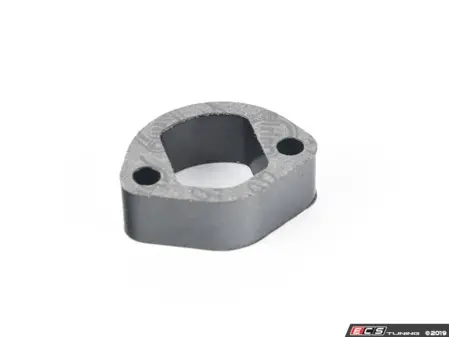

The insulator is there along with the stock push rod.

Knowing this isn't an normal issue motivates me to examine the rest of what's going on. I think the pads that those eye bolts sit on (left side in my first picture) might be the wrong way around. I think they're supposed to sit on posts that protrude from the manifold.

The mount for the throttle rod seems correct and reversing the pads does nothing as they're symmetrical. When tightening everything back up I pulled on the rod and took up any slack which improved it slightly. All the pictures I've seen have the pump behind that rod. Finally, I ground down a bit of the pump body and screw so it's not putting so much pressure on the rod.

I measured the pump push rod and it's about 1mm short so I have one on order. In the meantime and sanded down my extra spacer about 2mm with no improvement.

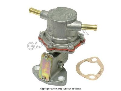

The pump pictured is one I bought at the outset of this project assuming it was an exact replacement for the smooth (no screws) original. After the fitment issue I did some searching and found one HBChris had suggested (I got it off of Ebay for less but this link might last longer)- https://www.autosurplus.com.au/bmw-2800-3.0s-3.0cs-3.0csl-525-mechanical-fuel-pum
This one fits a little better but no improvement in running. Three pumps, all the same.

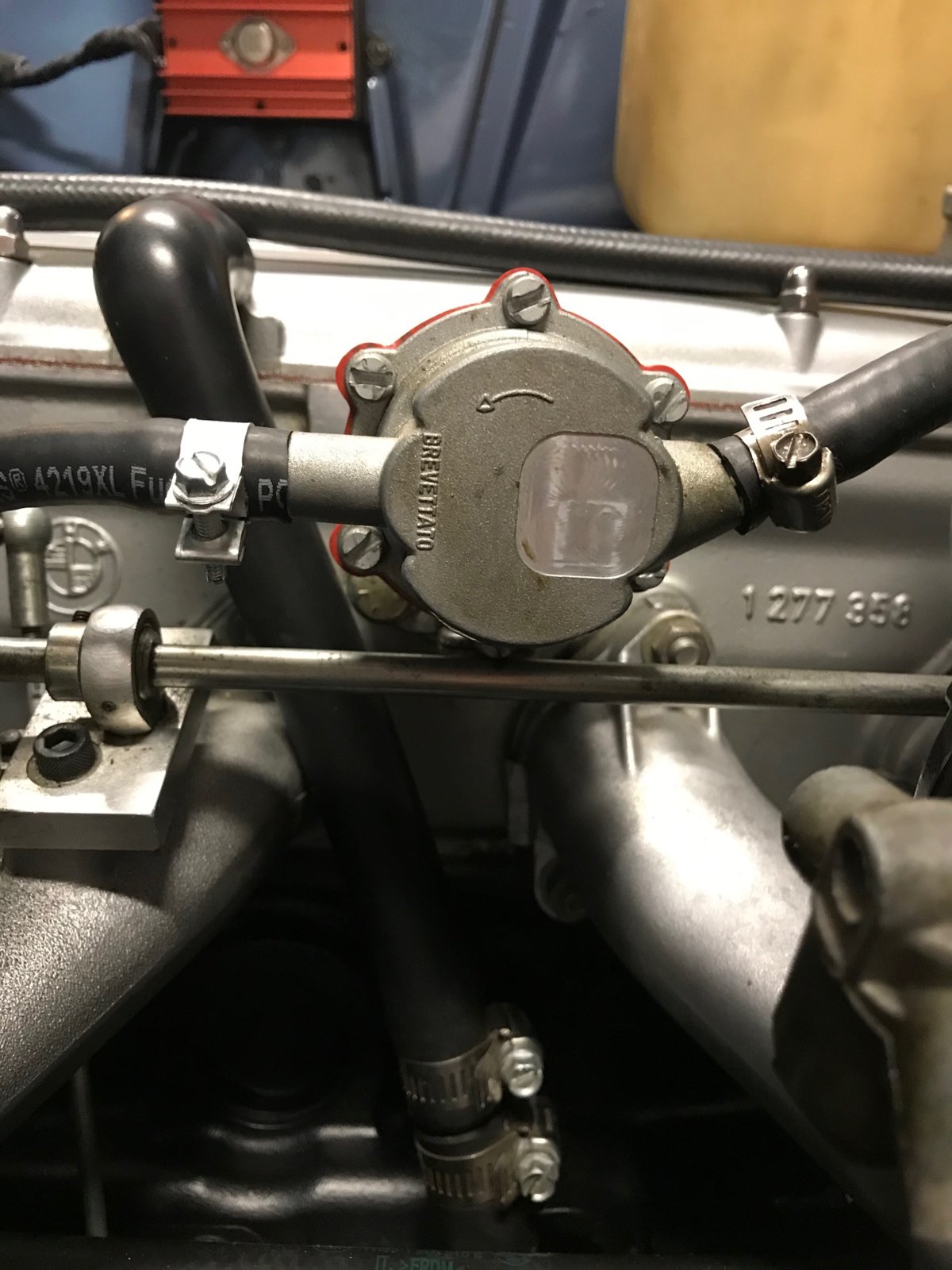

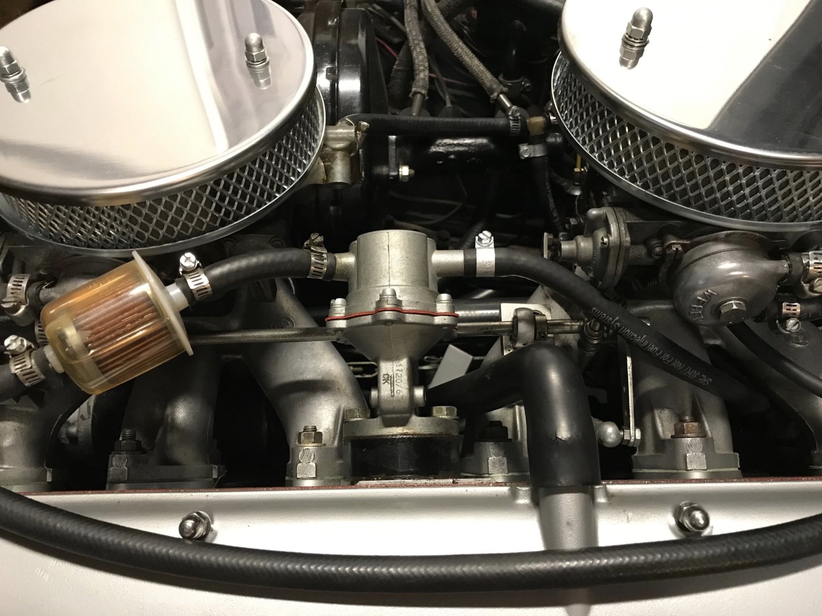

@bluecoupe30! - thanks for the pictures! Nice and clean in there! Looks the same- bottom part of fuel pump resting on the throttle shaft.
Here's the fuel pump I linked previously. It fits a little better.
