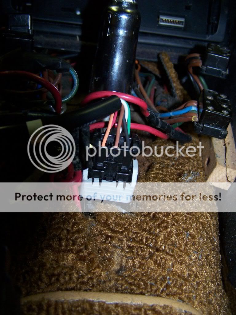

Just the AFR. Being D-jet, the fuel pressure should be constant 30 psi. Can't see the need for a gauge other than periodic checks of the regulator setting. Nothing radical to the engine has been done to my knowledge (stock cam) 3.3 block. I used the AEM Performance Electronics
unit #34-4100 UEGO Gauge. (www.AEMPOWER.com) Under $200 if I recall. I slotted a small amount of sheet metal from the tunnel behind the shifter to accept the connector for the O2 sender. I did take pictures of this but they are not very good.

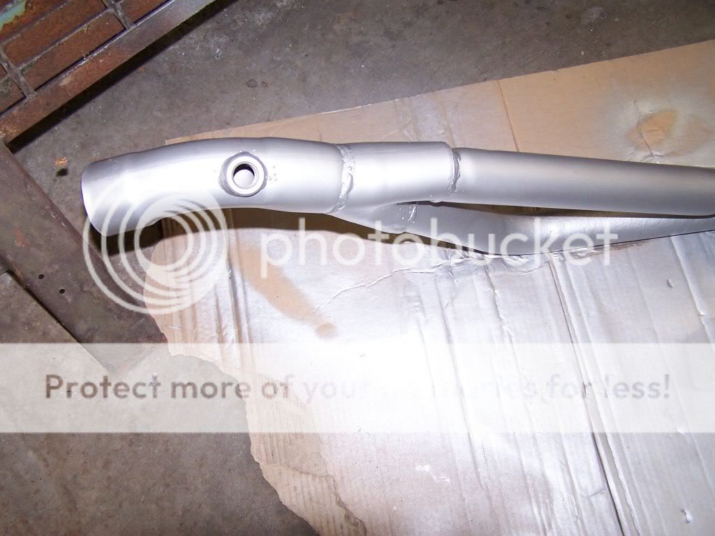

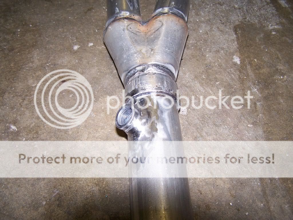

I have been putting pieces in place as to the eventuality of running stand alone EFI (such as megasquirt) The O2 sensor, B35 thermostat housing (has the additional sender ports) I do not have the room for the toothed wheel I have, A/C compressor and bracket limits what one can do here unless I do a delete, not in the program. I am kind of sitting on the fence here for sure as sfdon and sven (among others) work the systems to maturity. On the one car I have ridden in with M/S, the A/F numbers seemed to be jumping around a bit. The O2 sender located on one down pipe for ease of the install. I wanted to see if I could get stable numbers running with the sender as would be on a B35 using the 635 csi exhaust as a model. I built two merges, one for my own pipes and another to fit stock pipes. All in the interest of the science.
