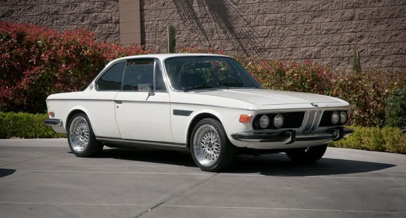

Here is what my E9 looks like with the new shoes.
My suspension is all stock and to me it looks like I need a slight drop in the front of maybe an 1" or so. I know I might get flamed but I was gonna try to cut about one coil off the fronts.

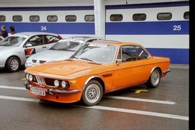

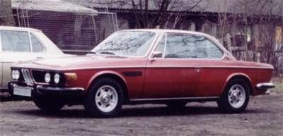

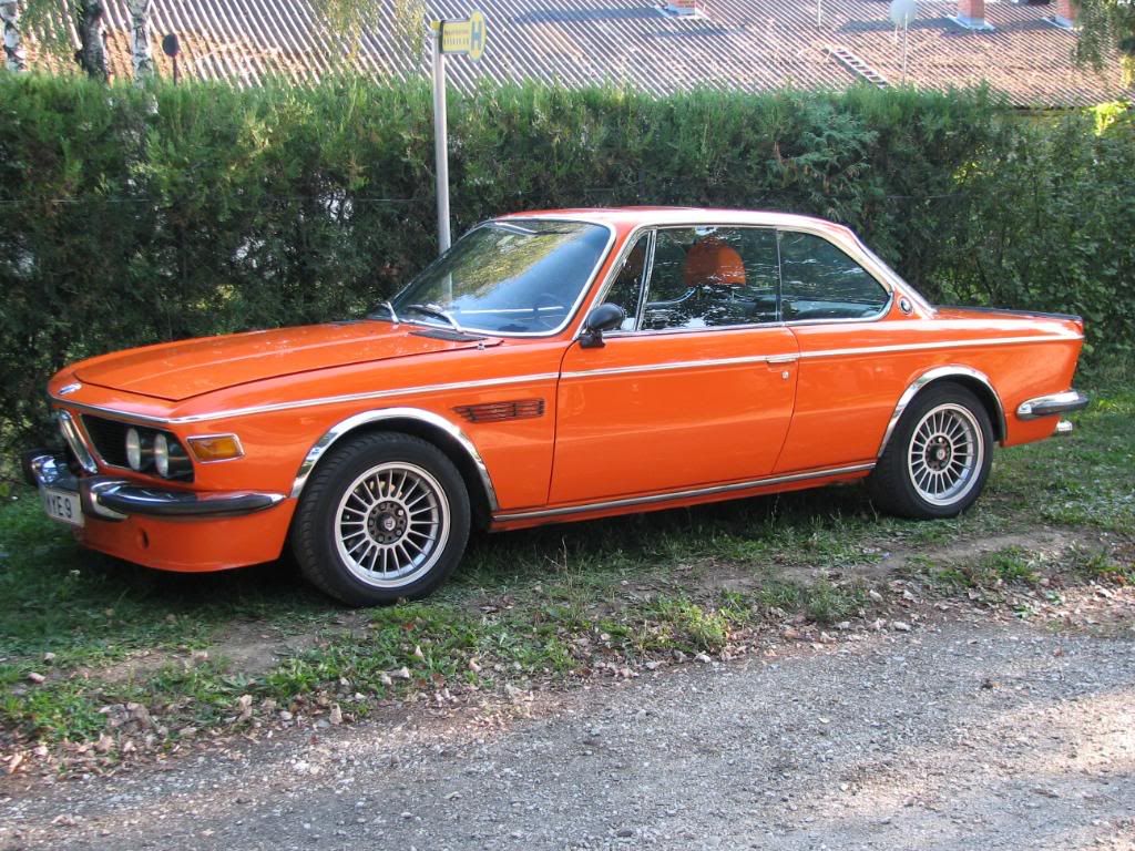

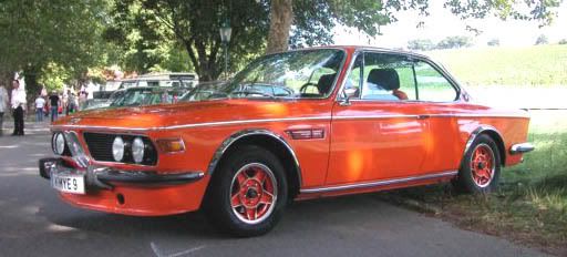

Here are a few pics of my "Orange" over the year, I had a lot of alu´s on her.... Wolfrace 7x14"
7x16"R 8x16R" Alpinas
6x14" ATS
MSW 7x15"
And here, thats when I bought her, in 1997, with the original 6x14"
2 years ago in Hungaria :
