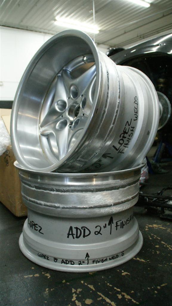

<<<Can't be done as the wheels in questions are 2 piece (single barrel and wheel center) and not 3 piece wheels.>>>
The work decoupe is referencing is cutting and welding of the barrels, (though he seems to indicate the outer lip on the style 5's cannot be modified, only the inner.)
This is correct and maybe there is a good reason why a two piece barrel can't have 1/2" added to either side instead 1" on the backside of the hub - don't know but cost would double at least so not much point. Pamp has a set of 3 piece style and spent a great deal of time and effort tracking down outer collars to get the stagger he wanted and they are gorgeous. No cutting necessary that way.
I'm refinishing a set of style 42 and wanted 9" for the rear but they are very rare and no doubt pricey - adding the 1" to the inside is an affordable option at $550 to do a pair but the lips would remain the same as the fronts and require 10mm spacers and new lugs. Still considering but probably stay with 8" at all four corners.

As my good friend from Alberta stated, I run BBS RS 16 X 7 front and 16 X 8 rear. I started with a square set 16 X 7 and got the the stagger by going 1 inch to the outer lip on the rears.
I rolled the rear fenders. Front was good. I did experiment as I am wont to do with the 17 inch wheels from my E39....Rears were no problem...fronts hit the strut. I would be louth to use spacers....you must consider "track" Most modern cars are a bit narrower on the rear vs the front ....shopping cart effect to ease parking. The E9 stock is this way. The stagger makes the track square....equal front to rear and makes for better high speed handling. That said, do not kick the track wide on the front by poor offset or spacers. Trial and error for sure...this is what I know.
