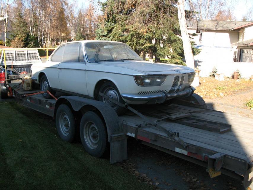

She arrived home today; 3600 miles over the road. You can tell from the pictures she looks a bit pissed and humiliated. I couldn't force myself to keep it in the driveway and use a hose because I did not want to douse it with any extra water. I will use the damp towel method to clean off the extra weight gained on the trip.
I'll tear into the brakes next, while soaking the engine cylinders more with Mystery Oil. Then we'll see if we can get it running with the motor in its present form. We'll need to do a kitchen table rebuild of those Webers first, of course.
I am worried about the rust but I'm going to get it running first no matter what because it will at least be drivable from what I can see. There is rust under the passenger side rocker and what you can see in the pics on the passenger side fender with the hood up. I don't have room in my garage for a proper survey of the rust. I'll get it to a friends house / shop next spring to plan the extent of the cut and weld. I tore away more of the grey plastic trunk liner tonight and am very happy with how solid the shock towers and surrounding area is. More pics of this soon and I will draw on your collective opinions for where to look next.
