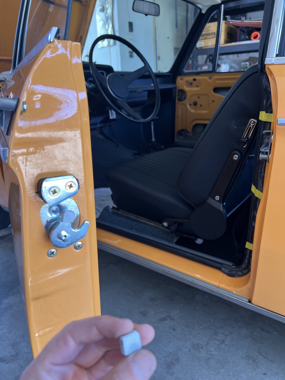

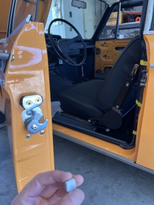

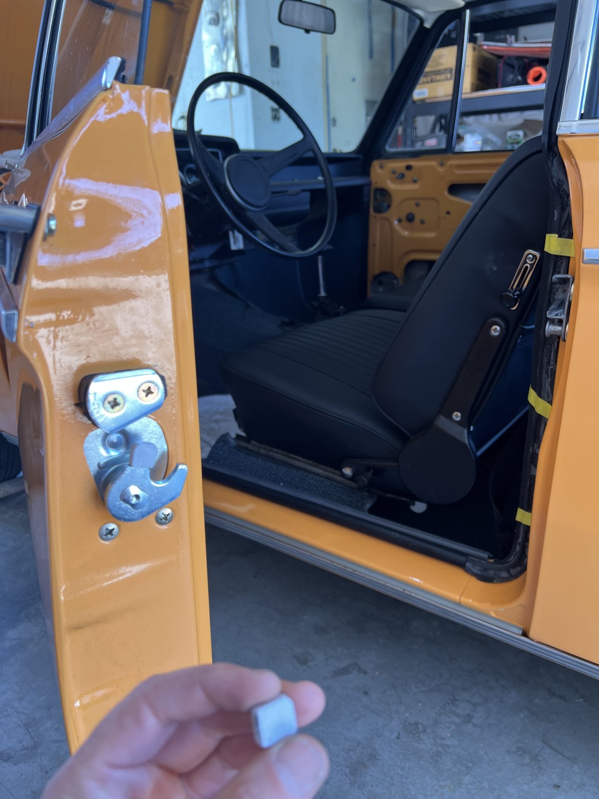

Yes they’re hard to push on. Warm them with a heat gun or hair dryer to make them a bit more pliable.
Thank you for the explanation and photos. I don't recall those on my locks when I disassembled. I better order a few.

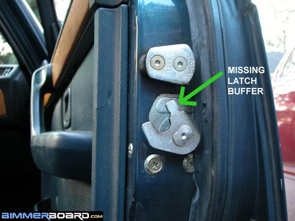

The doors on the 2002 and the E9 have them. Some people will use a piece of clear plastic hose to cover that part of the latch. The doors really have to be slammed hard to shut without them. Steve's name of "lock buffer chiclet" is the best I've heard in almost 50 years...

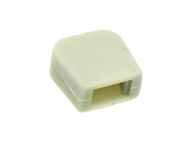

And where is the best place to pick up a pair of these door latch kernels?
Walloth sells them.
Right after I bought my 2002 (back in 1983 or so) - I took to an independent BMW shop in Monterey.
Nothing too much that they had to do - but when I picked the car up after they worked on it, I noticed the drivers door was much easier to close.
I went back in and asked if they did anything to the door - The fella smiled and pulled one of these covers out of his pocket.
He noticed mine was missing, so he just replaced it.
