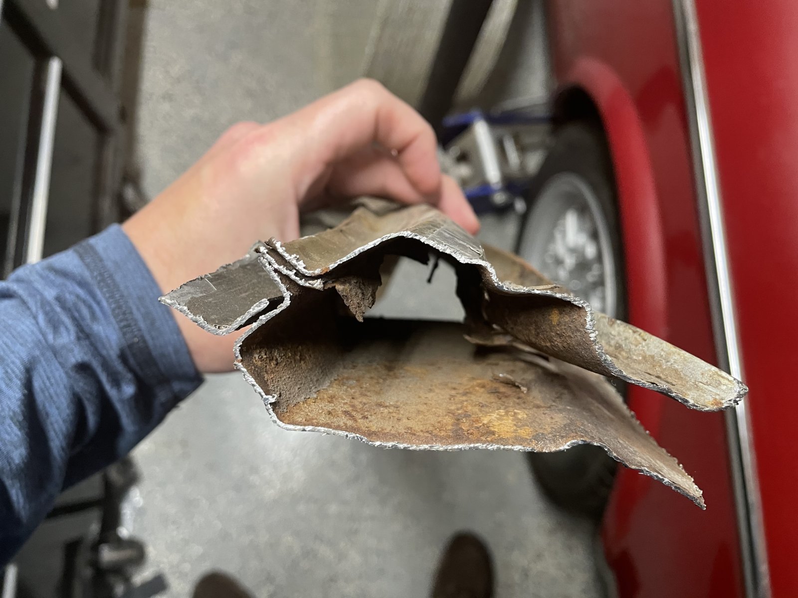

Brace yourself folks! Wait at least 30 minutes after eating before watching. This is why it is a good idea to remove your rockers, and to get a PPI.
I went into my budget-purchase knowing full well that the rockers would be toast. I know what I’m in for, and I look forward to the journey!

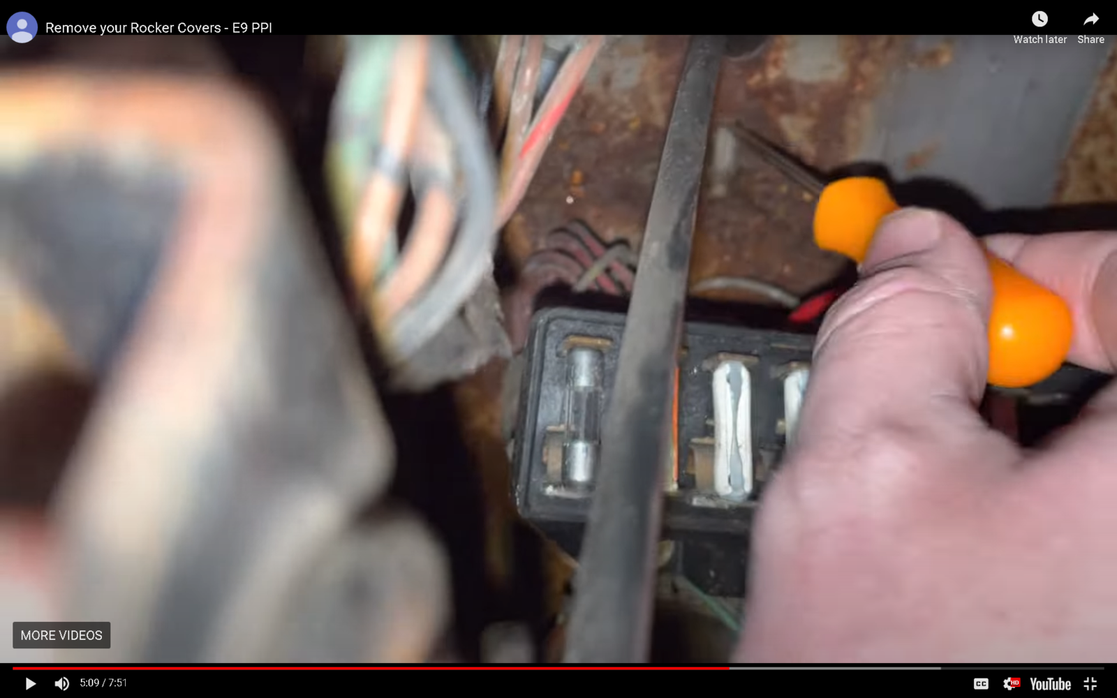

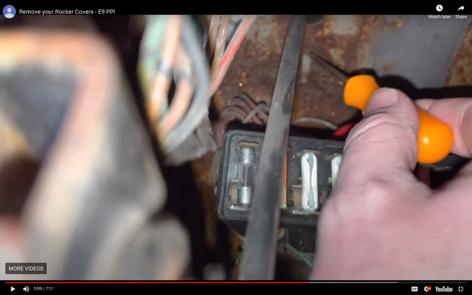

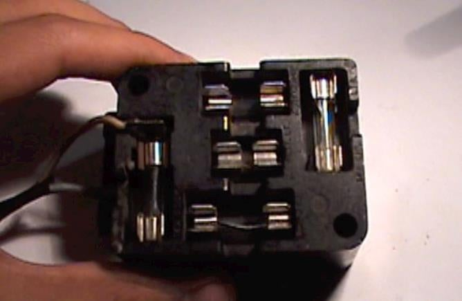

It was interesting to see on the movie from Markos usage of home appliance type of protection in the fusebox :D
Thanks for info! You got me! ;)

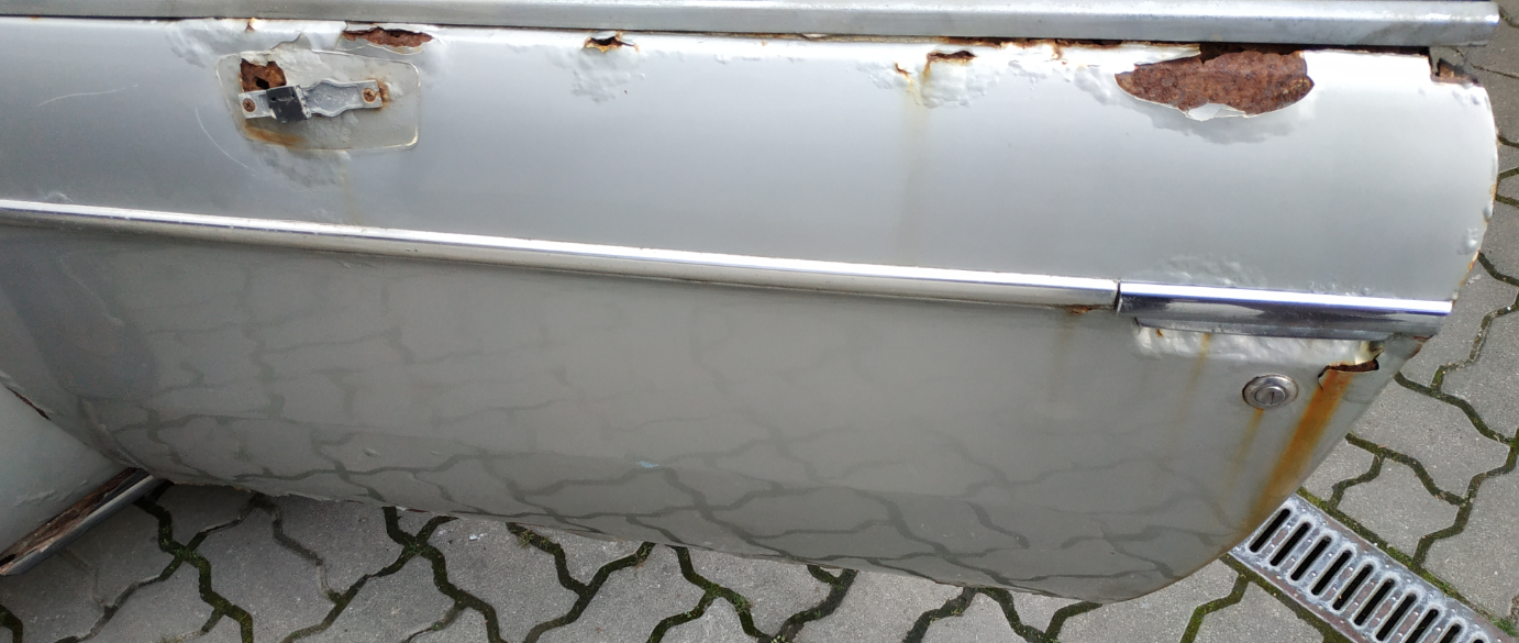

Very common in E9's the rust below window's lower chrome trim. There are two steel sheets one over another...
For a car driven for 30 years and then parked for 20 years...

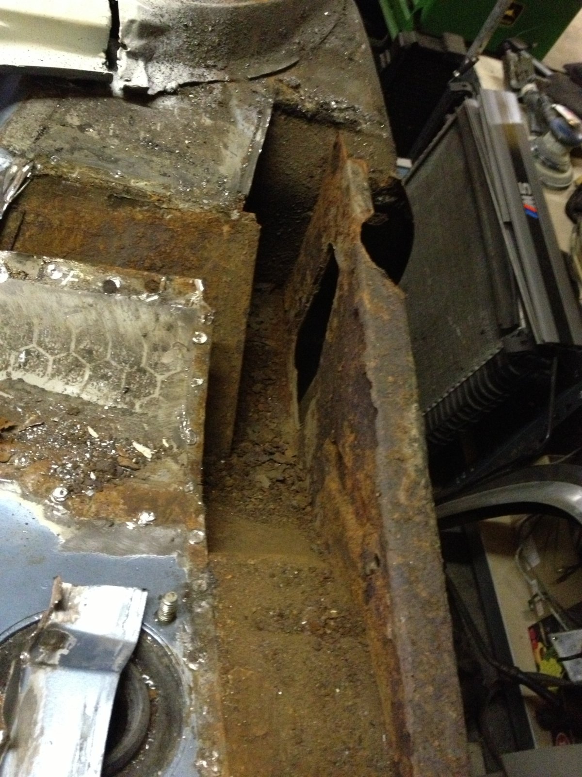

This surely is a weird place to rot:
It is not so weird, when you consider that in this spot the front fender panel ends, and is welded to the bottom window frame. Normally all leaded up, but it can rust out from the windshield, and creep along the line. The right side actually follow pretty accurately the quarter panel end. Or, as mentioned above, it may have replaced poorly. (Which was an investment that likely prevented the car from being scrapped in the 90's)

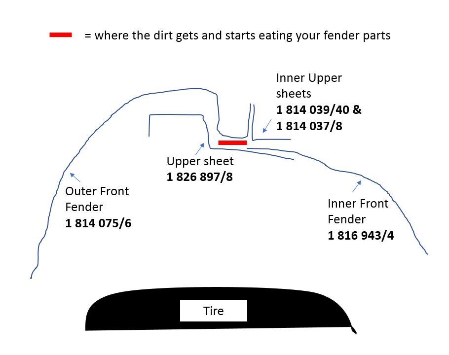

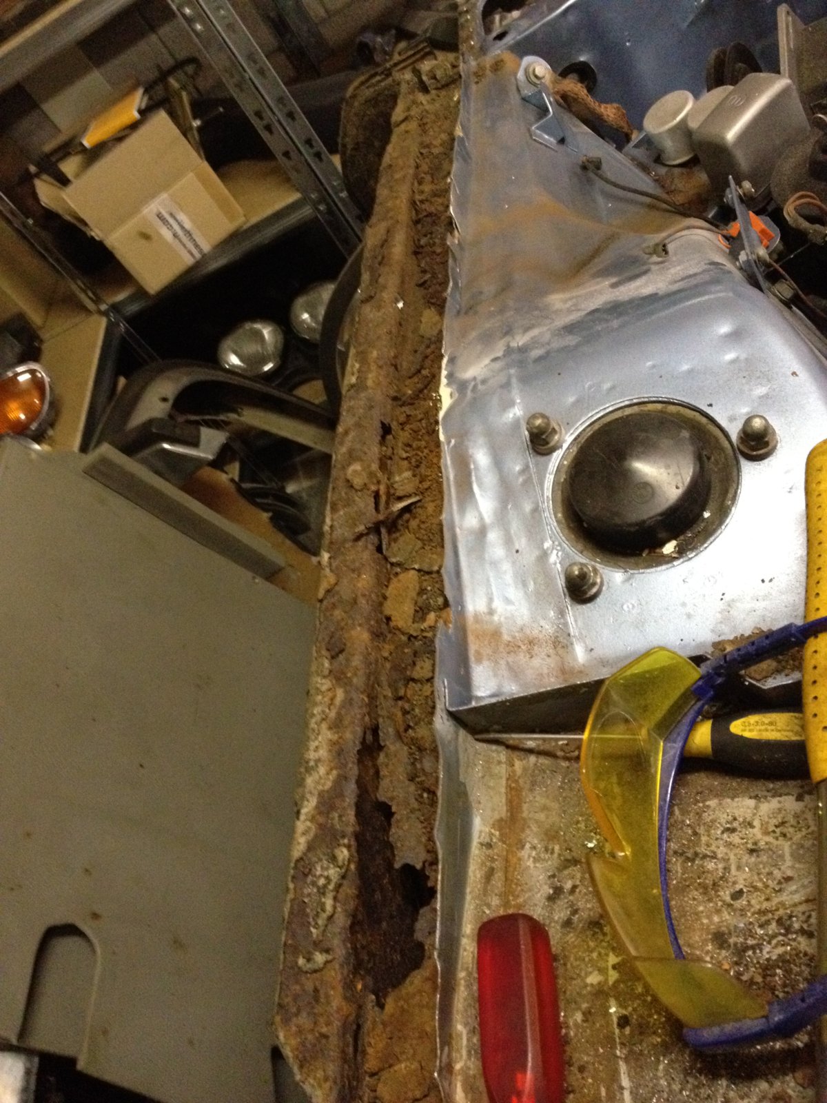

If I may add for #1 & 3, made a small cross section of the front fender for understanding and added some pictures to illustrate what to expect for #1 & 3 when you take the front fender off. :oops:
One thing to note is at least with the first third of the fender, you can run your fingers up and over that channel. One thing I have learned is that my passenger fender was replaced, and I have a gap across the entire length. I would like to know if others can run their fingers through the entire gap or if this lip meets the fender top above the center of the tire.
Also, here is a cross section of the windshield frame where the front fender meets the body. The front fender is spot welded the the windshield frame, and extends about 4+ inches imboard. In the pic below the fender metal is present, and the windscreen metal is present. The metal that should be directly under the fender has rotted away:
I can confirm that the lip meets the fender top just before the center of the tire, seen from the front.
