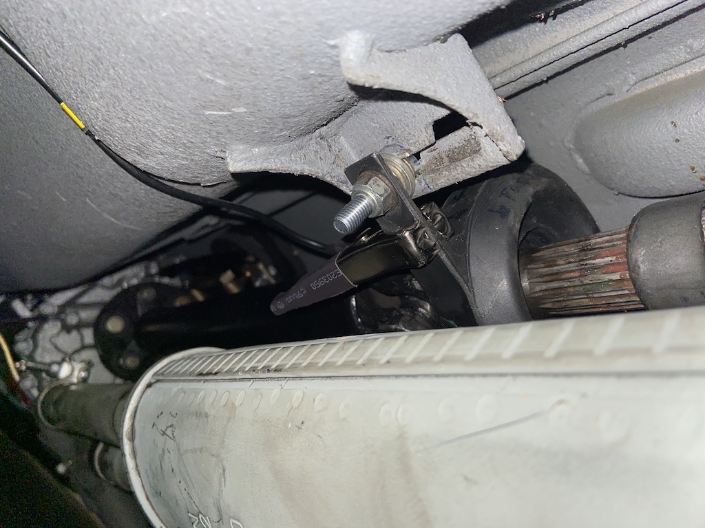

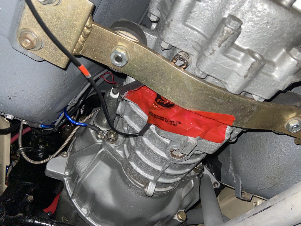

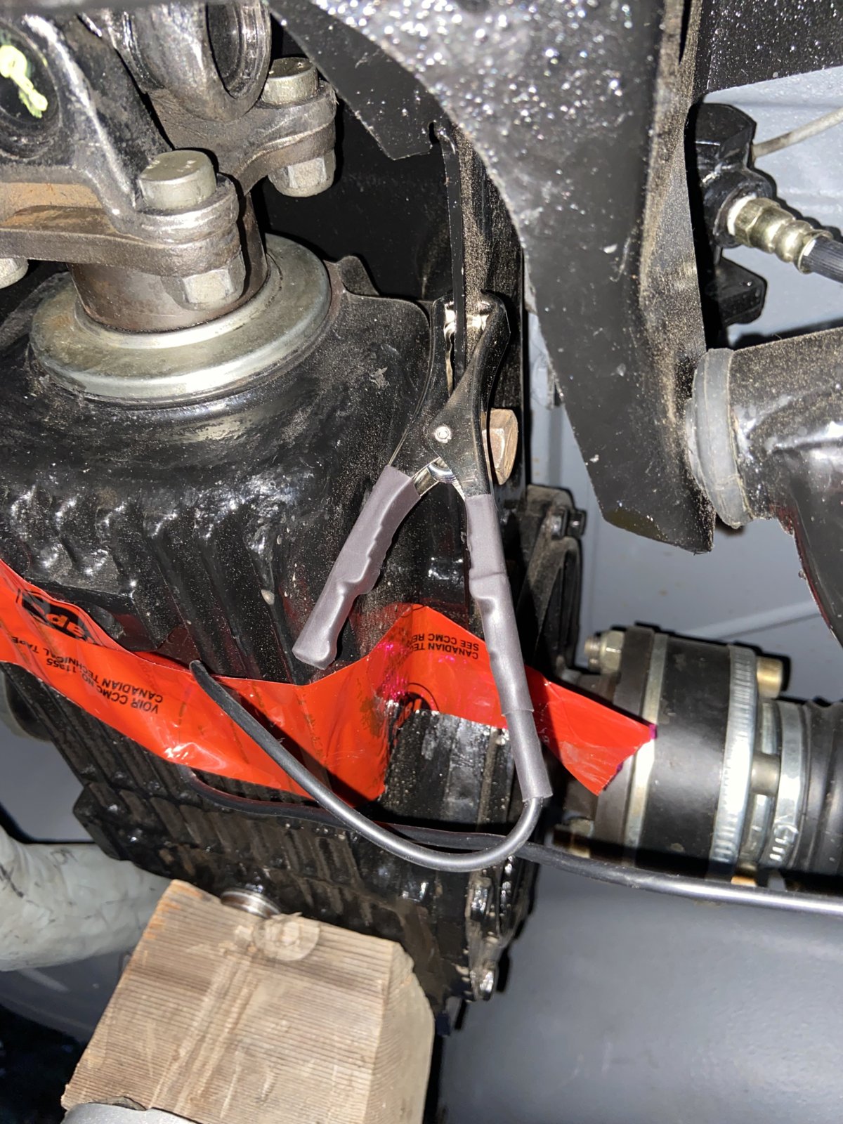

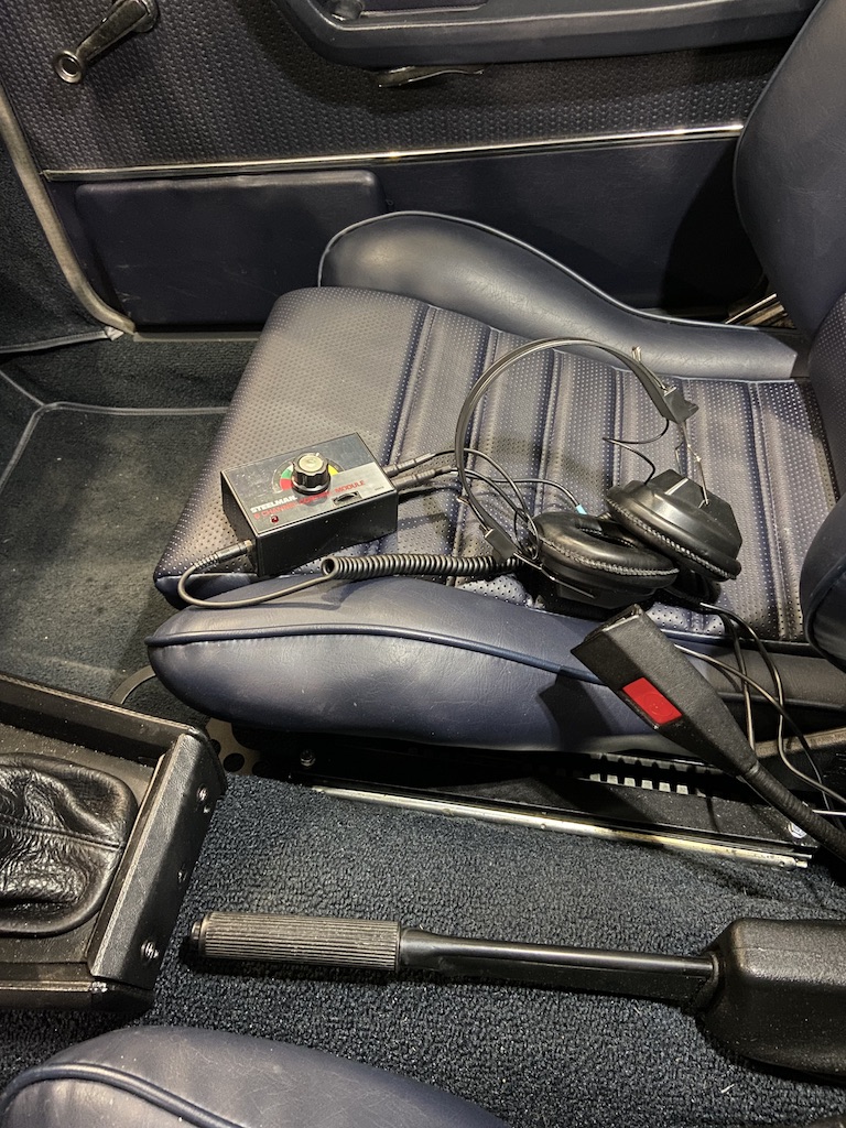

Interesting and to be absolutely certain, I used a 'chassis ear' to listen to the 3 main things that rotate on the driveline (gearbox, centre bearing, and diff). Switching through the channels of the chassis ear, it was obvious the gearbox is the culprit. The (rough) sound from the gearbox mic is the same rough sound heard while the car is idling (clutch engaged, in neutral) or being driven. The sounds from the centre bearing and diff were smooth and consistent. Videos and pics attached for interest.
