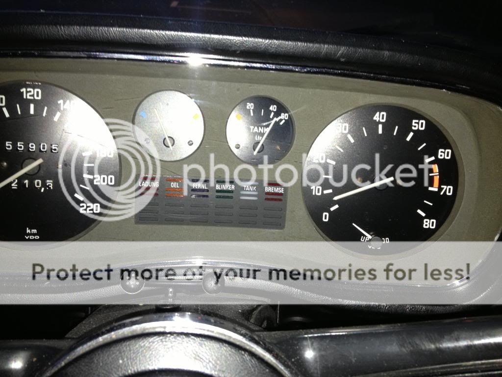

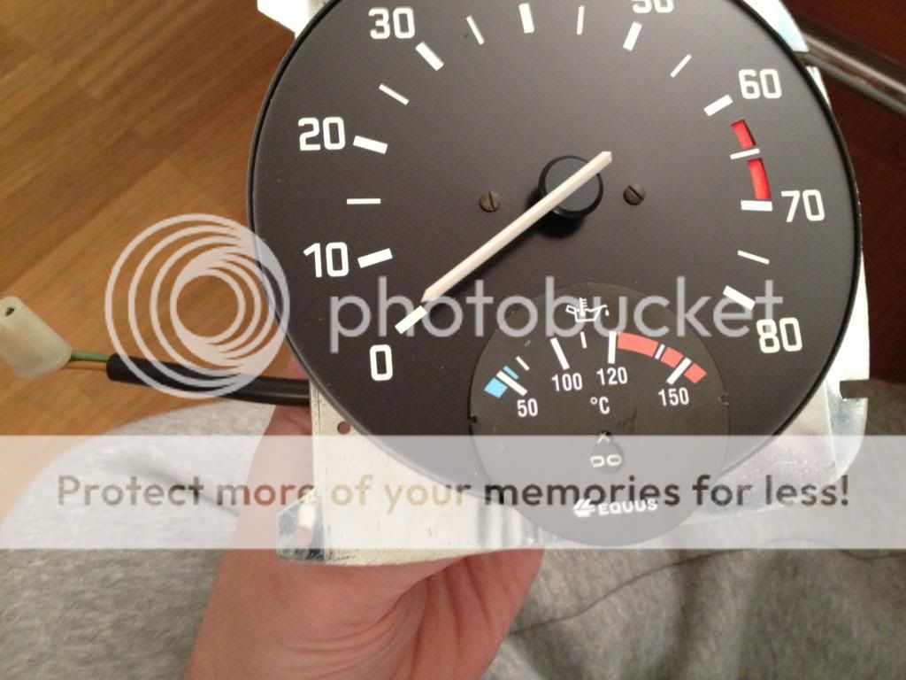

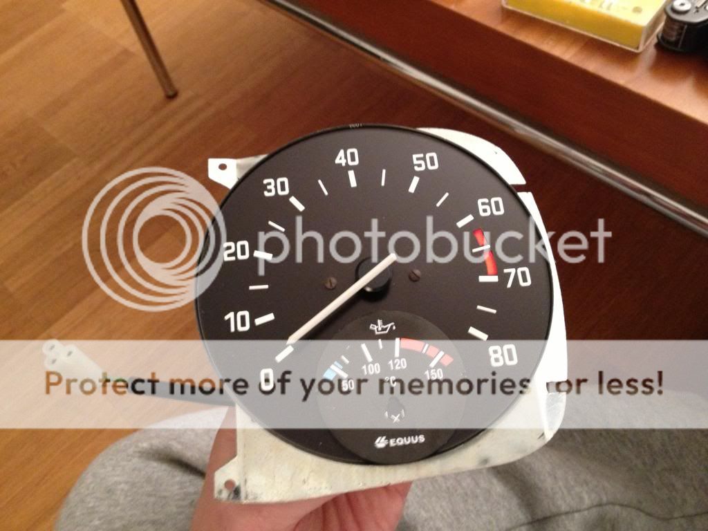

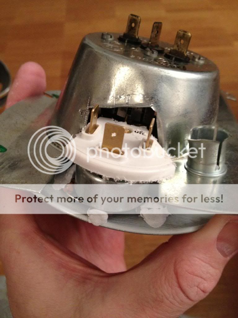

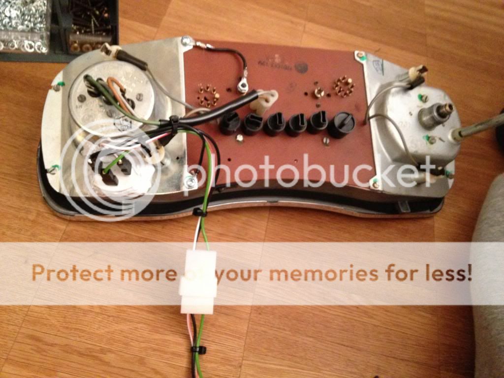

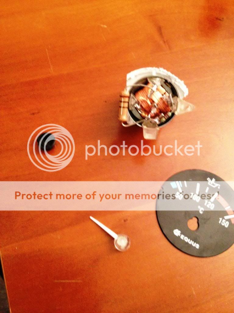

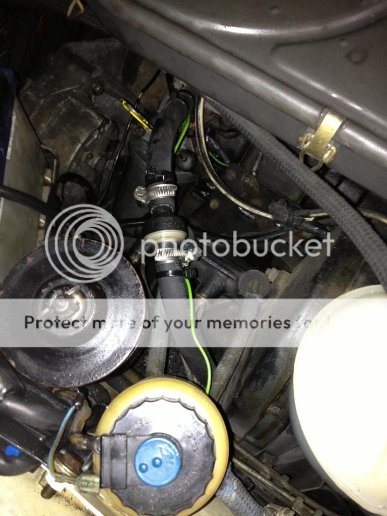

Just a little documentation of putting a discrete oil temp gauge into my BMW E3 (bavaria)

nicely designed and performed
couple of questions:

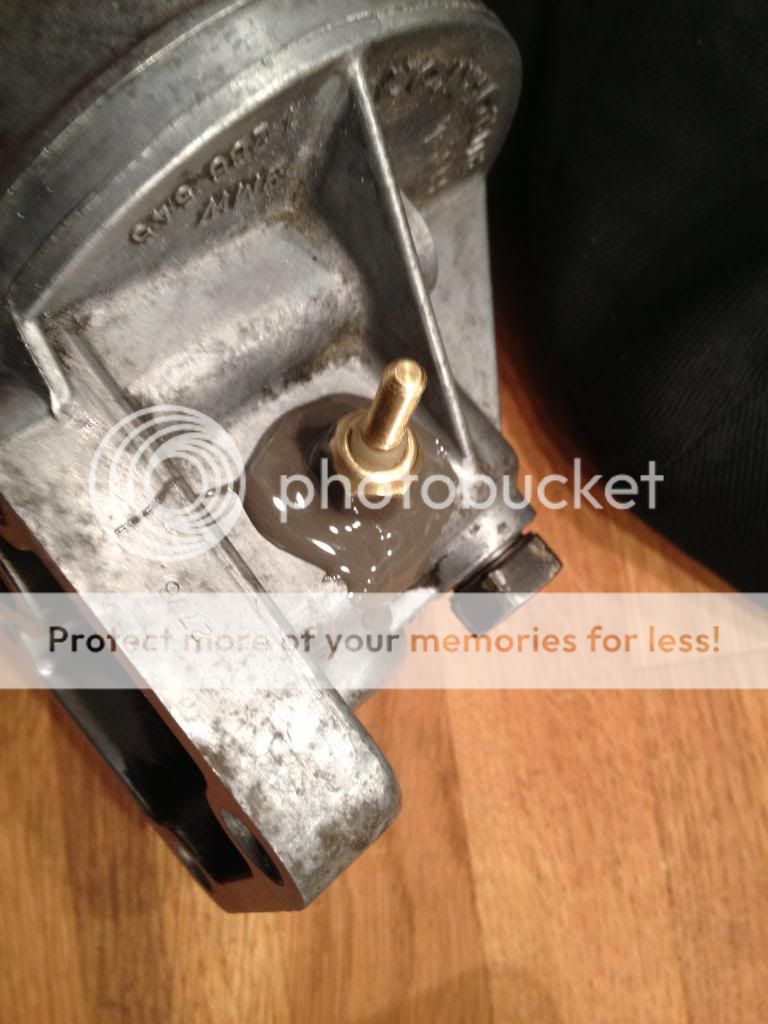

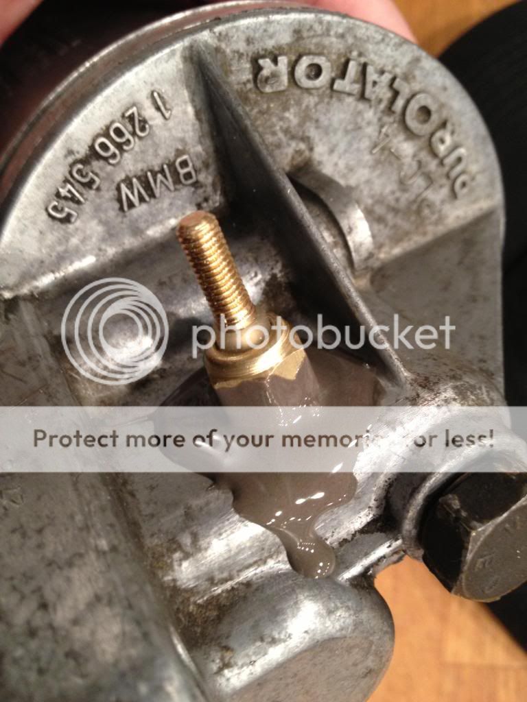

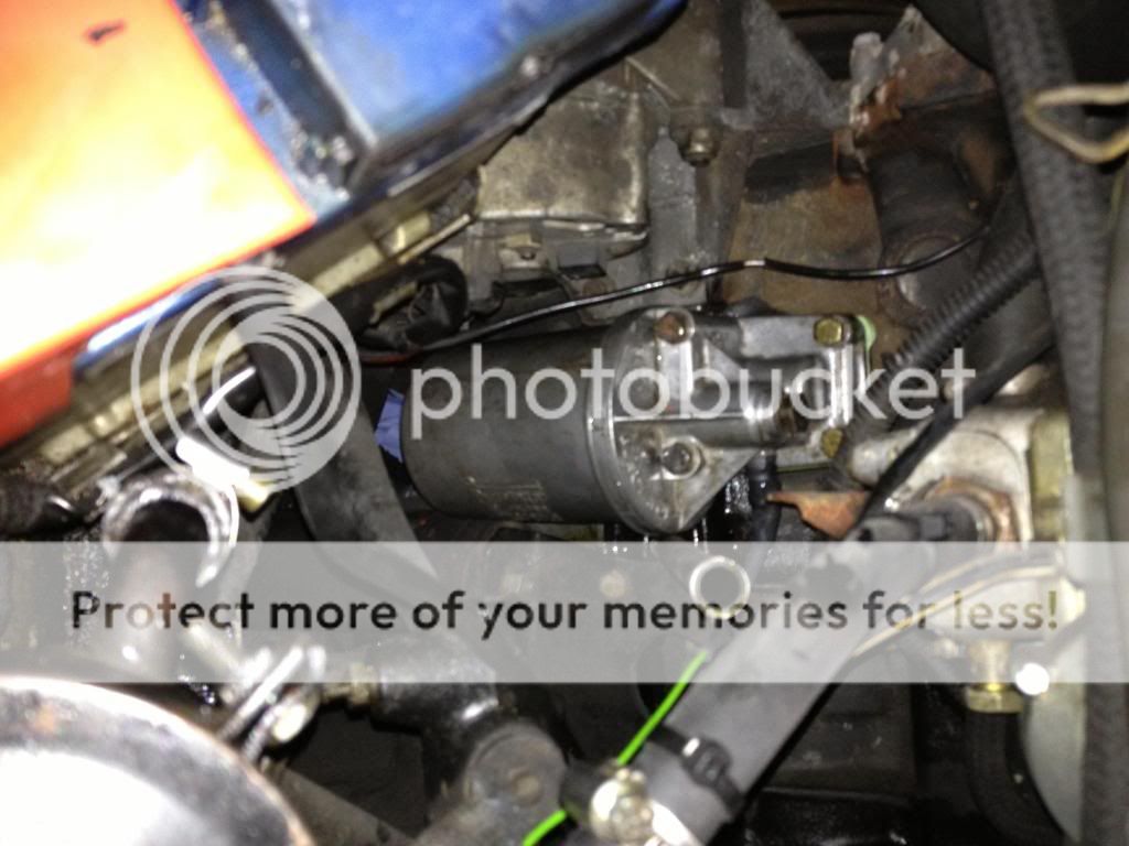

- what is the grey mastik that you pour over the sensor in the oil fliter housing ?
- are you considering placing a red mark or you will guess when it is too hot ?
regards
and great to read from you again
Hi Arsenico
yes, very nice to hear from you again as well.

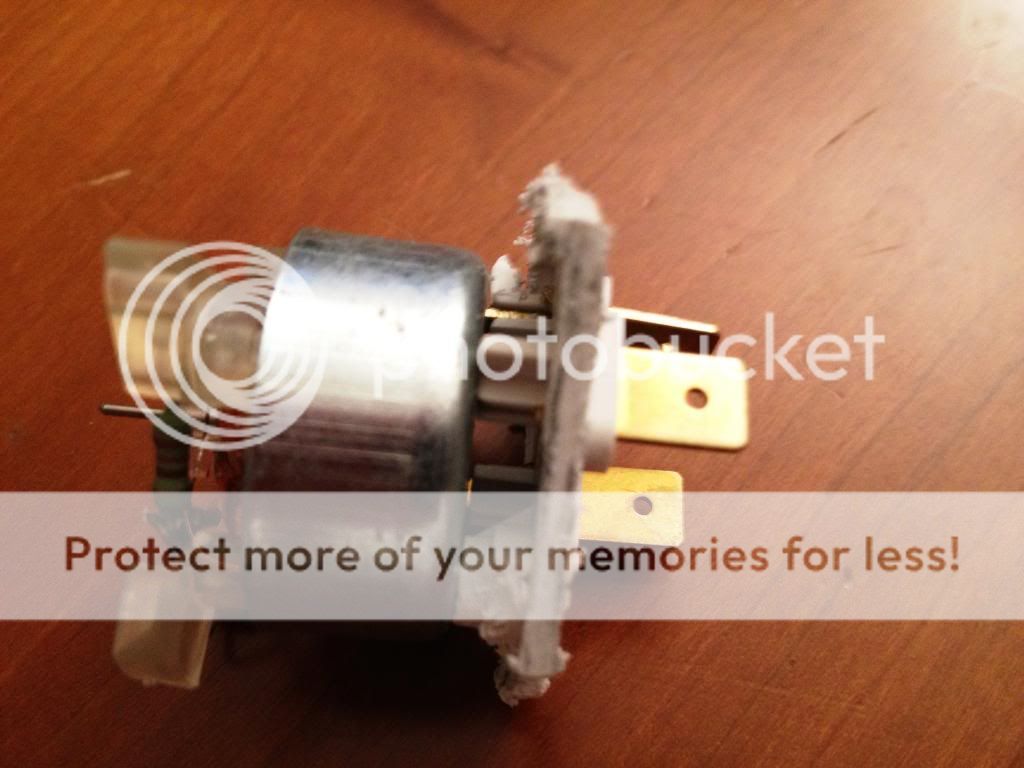

They grey mastic I used on the instrument is a two-component putty by pattex
http://www.pattex.de/do-it-yourself...lebstoffe/reparaturkleber/repair-express.html
the grey stuff I used at the oil filter housing is JD Weld
http://www.jbweld.com/

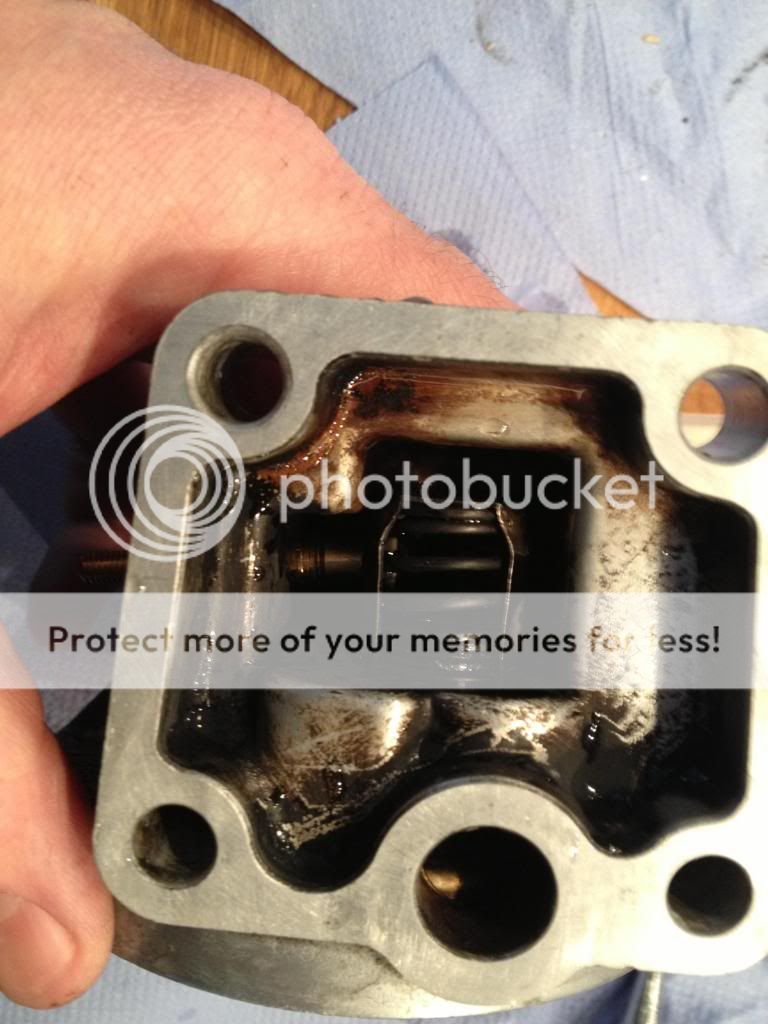

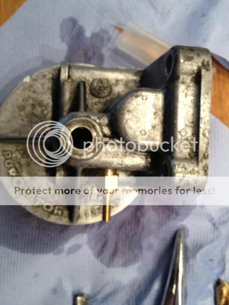

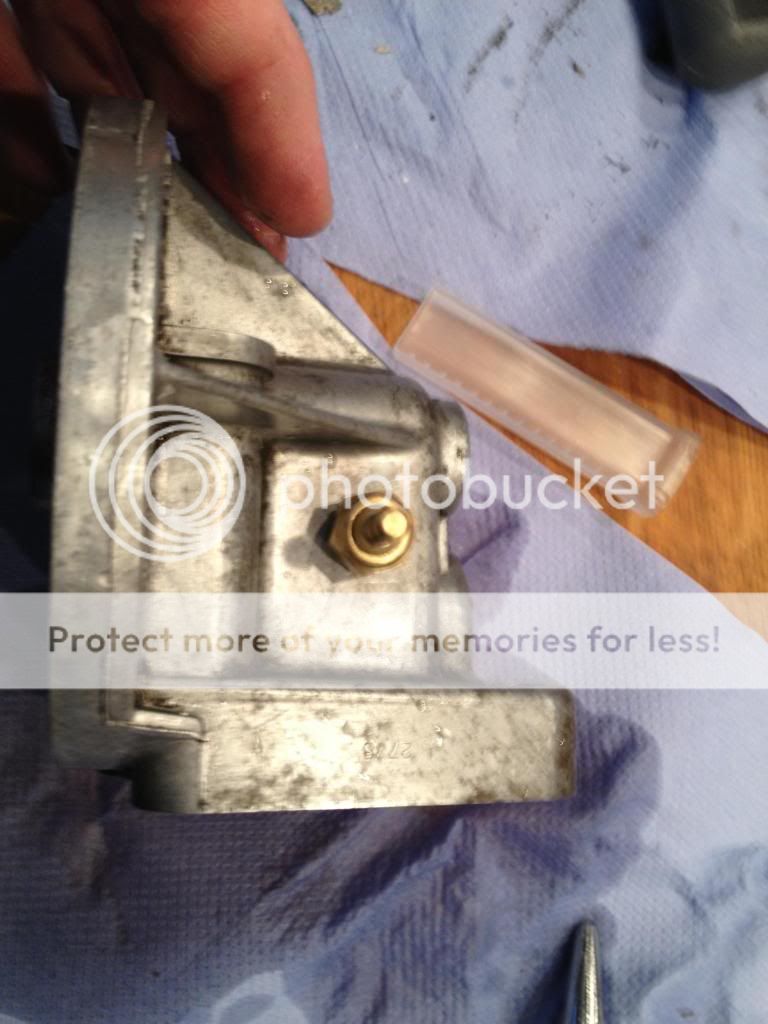

(just a precaution, I did actually cut a 1/8 27 NPT thread into the housing and screwed the sensor in with Loctite 272)

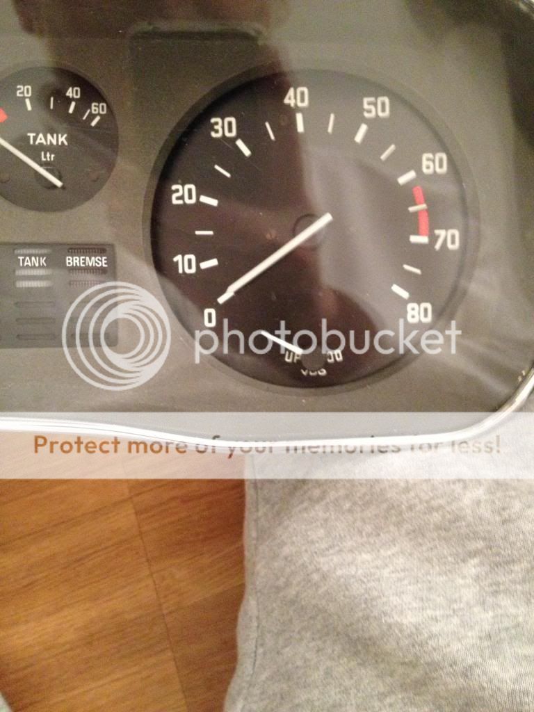

as for a red area: no, I don´t think I´ll need it. I can´t imagine any situation where the oil will actually overheat that wouldn´t be indicated by the water termperature or the oil pressure (idiot light) before.
I just want the oil temp gauge to make sure the oil is up to operating temperature before I floor the throttle.
I did do some calibrating runs and then reset the needle to be almost vertical when the operating temperature is reached. That way it´s easy to judge and keep an eye on.
Some more testing has shown that the oil temp (at least on my carburated 3.0) is very stable once warm and even longer higher speed autobahn runs (limited for now because of the winter tires) does not let the oil temp rise noticably. The M30 seems to have a pretty bullet proof oiling system.
So if the needle ever does wander to the right, I´ll probably investigate long before any imaginary red aread would ever be touched...

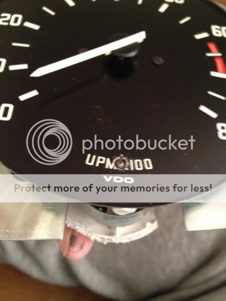

Nicely done! Why didn't you glue the original oil temperature face plate onto the tachometer face like in the third picture?
Because the writing on the typeface was "whiter" than that on the revcounter and because I would have had to trim it at the bottom and because there were small cutouts at the side of it that would have looked odd.
In short: I looked at it and didn´t like it. Besides I really don´t need the scale (for oil temp). As with the water temp gauge: all I need is for the needle to be upright and the engine is fine. Lower: keep my foot in check: Much higher: slow down...
