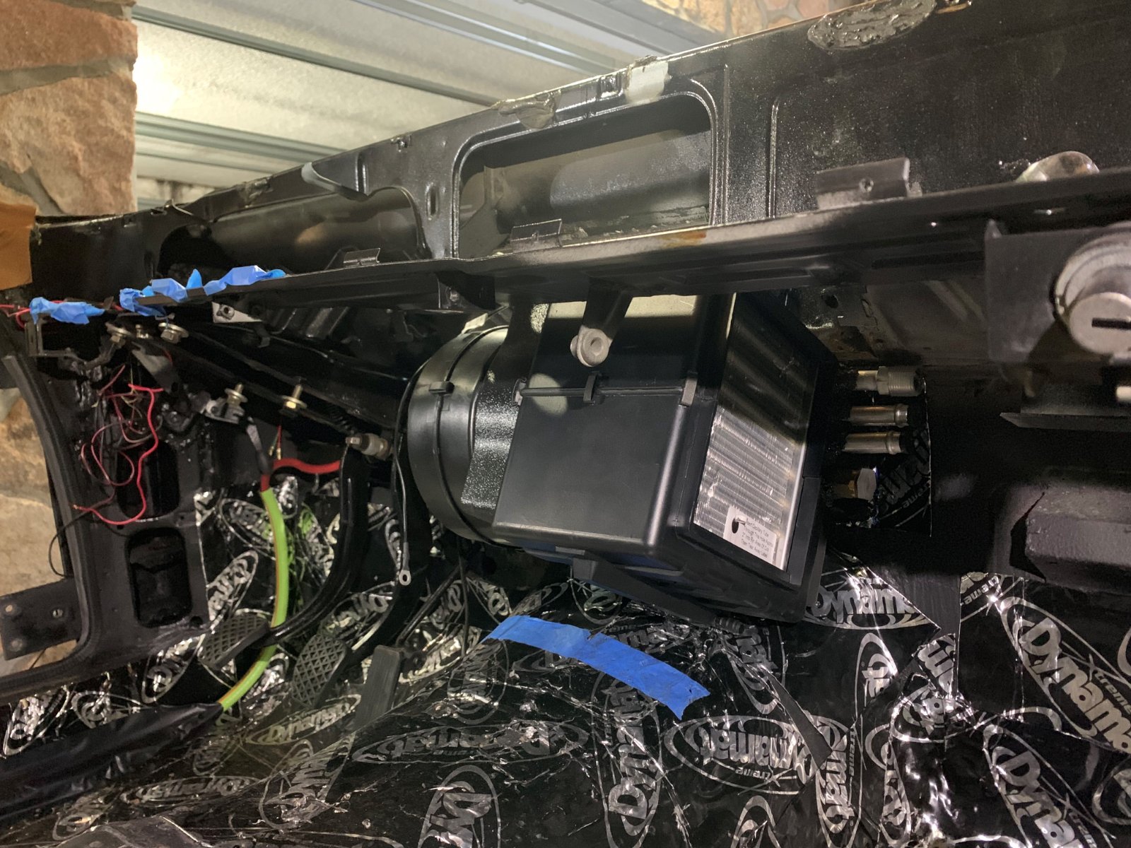

yes, it all fits. The unit sometimes fits at slight angle. We are refining install instructions with new projects. We have turnkey instructions and pics for other cars just don't do as many coupes but have 3 in facility now ready for final step of modern AC / heat install
here is one pic of a customers install in Europe
Need to take more of our approaches. Fits easily simple. Only part of install we have not documentd is how to fit the new cables we ship to existing slide controls in E9. The AC and non AC console plates slightly different
Is a simpler much better option then anything we know of. Comes with pretty solid instructions but as we finish 3 projects in house will be even more detailed on control cables. Replaces heat and air so lots of space

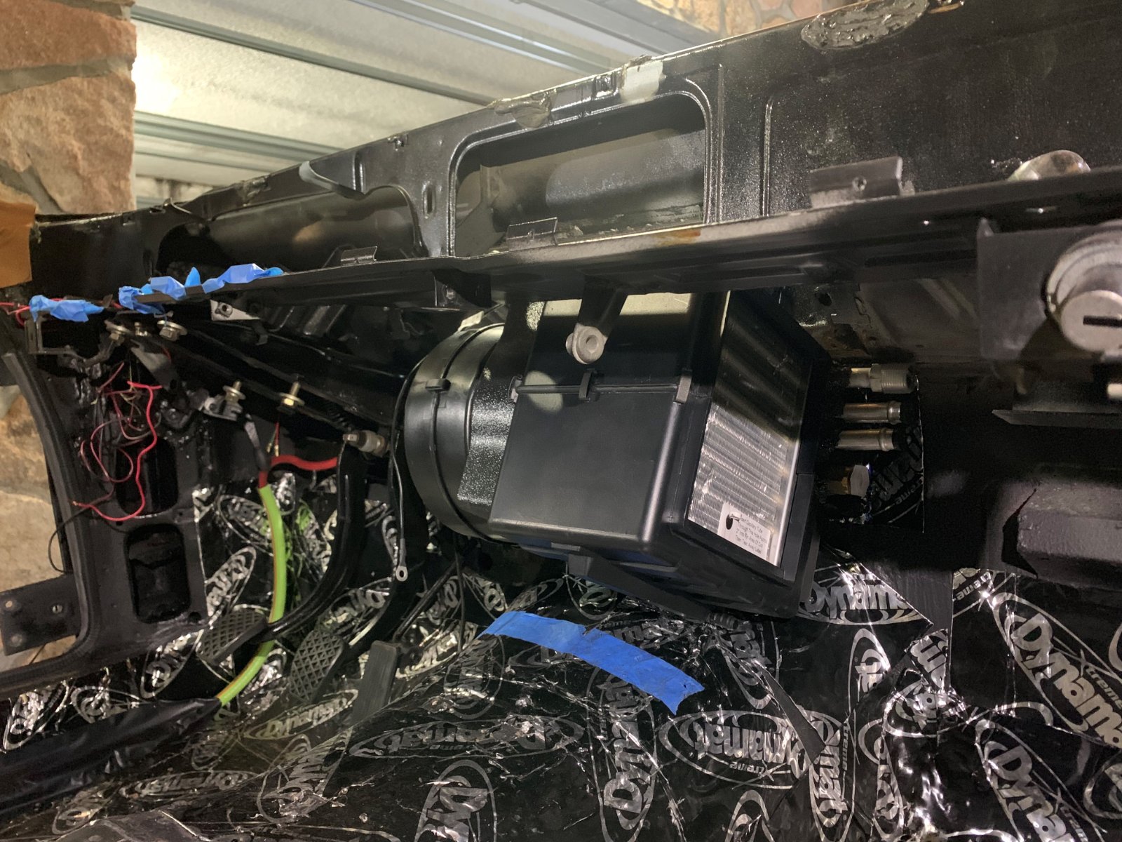

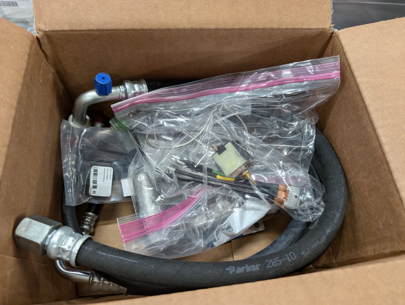

different approach - Oldenzaal kit if for cars that didn't have A/C to begin with. what Don puts together is all of the stuff to improve the existing A/C and bring it up to a more modern system. i believe the evaporator doesn't change.

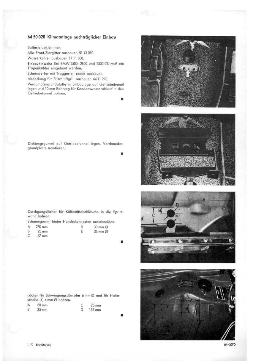

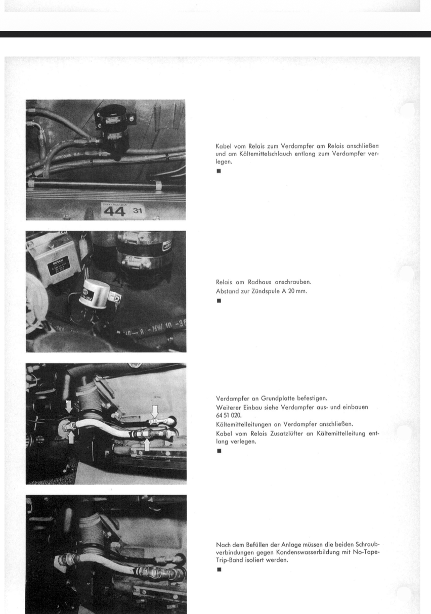

Rob Siegel's book is a very good source, and there is the official E9 Repair Manual that includes a step by step guide on how to retrofit AC, including pictures. I have used this extensively, but only have the German version.
Ah, nice. I have the 2-volume blue books but looks like this is a different publication, since I don't believe the blue books have info on the retrofitting. If you're able to post the relevant pages here that would be great for me and others to follow. German-only is fine, that's what Google Translate is for ;)
The blue book repair manual in English (Vol 2) contains the same step by step guide for a retrofit/subsequent installation in section 64-50/5 on the back end of the second part.

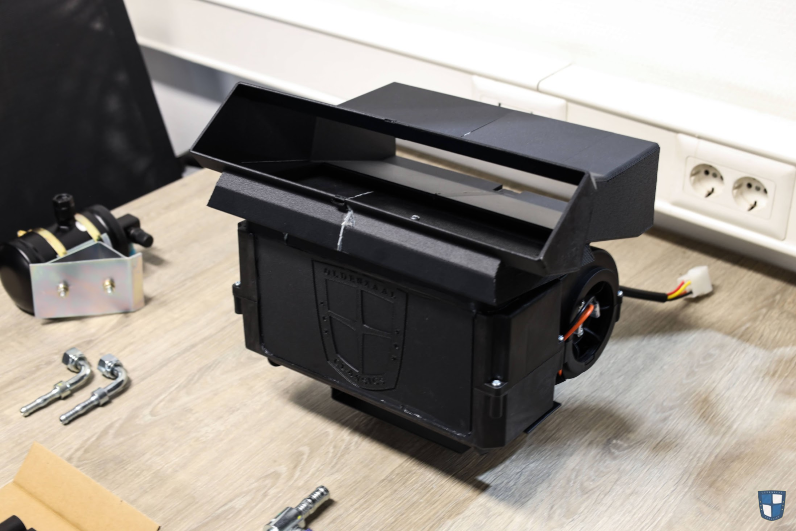

when i look at the oldenzaal evaporator, i'm asking myself - what happens to the heater / defrost controls? how does that work with no way to connect the cables from the controls to the heater box.
Brendan, i was looking at the pipes and was curious why you would need 3 pipes for the a/c.
the O/Z evaporator unit operates in the same way as the Behr stock unit - judging by the pictures I have seen - it is a separate stand alone module not connected to the heater core and its controls. Main difference I notice is the evaporator core - different size than Behr, and with an external TXV, therefore the AC hoses go around in front of the evaporator. This design eliminates the hard lines.
there are 4 pipes going into that unit two for ac and two for heat , I Have a client where someone tried to put this in thier car I pulled out , Those of you who know me Know Im not afaird to try things outside the box and this was further outside the box that i cared for , trying to reroute the heater system etc like I siad earlier seams like more work that its worth , But if some one like this I know where a unit is for sale !
are you referring to the Oldenzaal evaporator (as pictured above) - or to the Ditech unit referenced on top of this page?
It appears that the Ditech unit is an integrated heater/AC unit.
