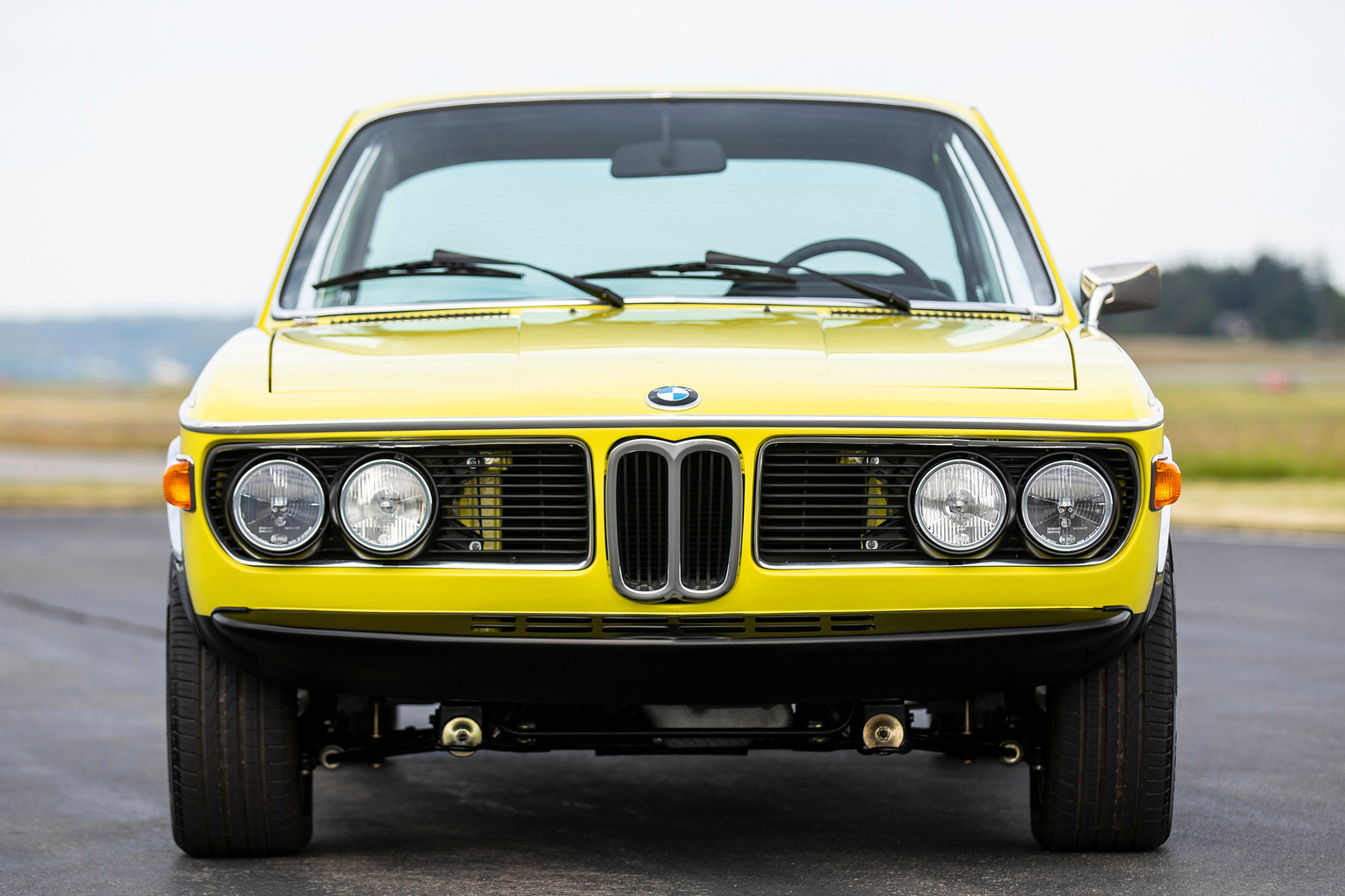

Seems like the big visual miss is the missing air dam (to my eyes). Like my old CSL, the chin spoiler has no bumper mount slots, so wouldn't this have definitely come from the factory with the dam? And the gap around the front kidney grill looks atrocious. The interior wood looks a couple shades dark as well. Pretty but there are a few items off. Love the color...
The carb CSL had no air dam and no bumper slots. This CSL has the bumper slots welded shut (pic 81). The nose must have been part of the replacement metal.
@Markos isn't 2275363 an injected car? My 2275177 car was and I was under the impression we were well into the series 2, injected cars. I also know another car 2275447 that's a 3.2L Batmobile.
Sorry I wasn’t being clear. You stated that if the bumper slots were missing, an air dam was present. My point was that this isn’t necessarily true given that carb CSL’s had no air dam. I can’t say if all 2275’s had air dams. I have no idea. Yes 2275 CSL’s were injected.

Looking at the listing again I see a few more non-original issues here.
Wes, underside paint is khaki with a green tint, then sprayed with grey soft undercoat. This CSL has no undercoat but grey paint including wheel wells.

So Chris, are you saying that at some point in mid 73 the outer slots became standard on all CSLs and before that time, they weren't? (if a front bumper wasn't optioned)
Valance on chin has narrow outer slots which is mid-73 change so it was replaced.

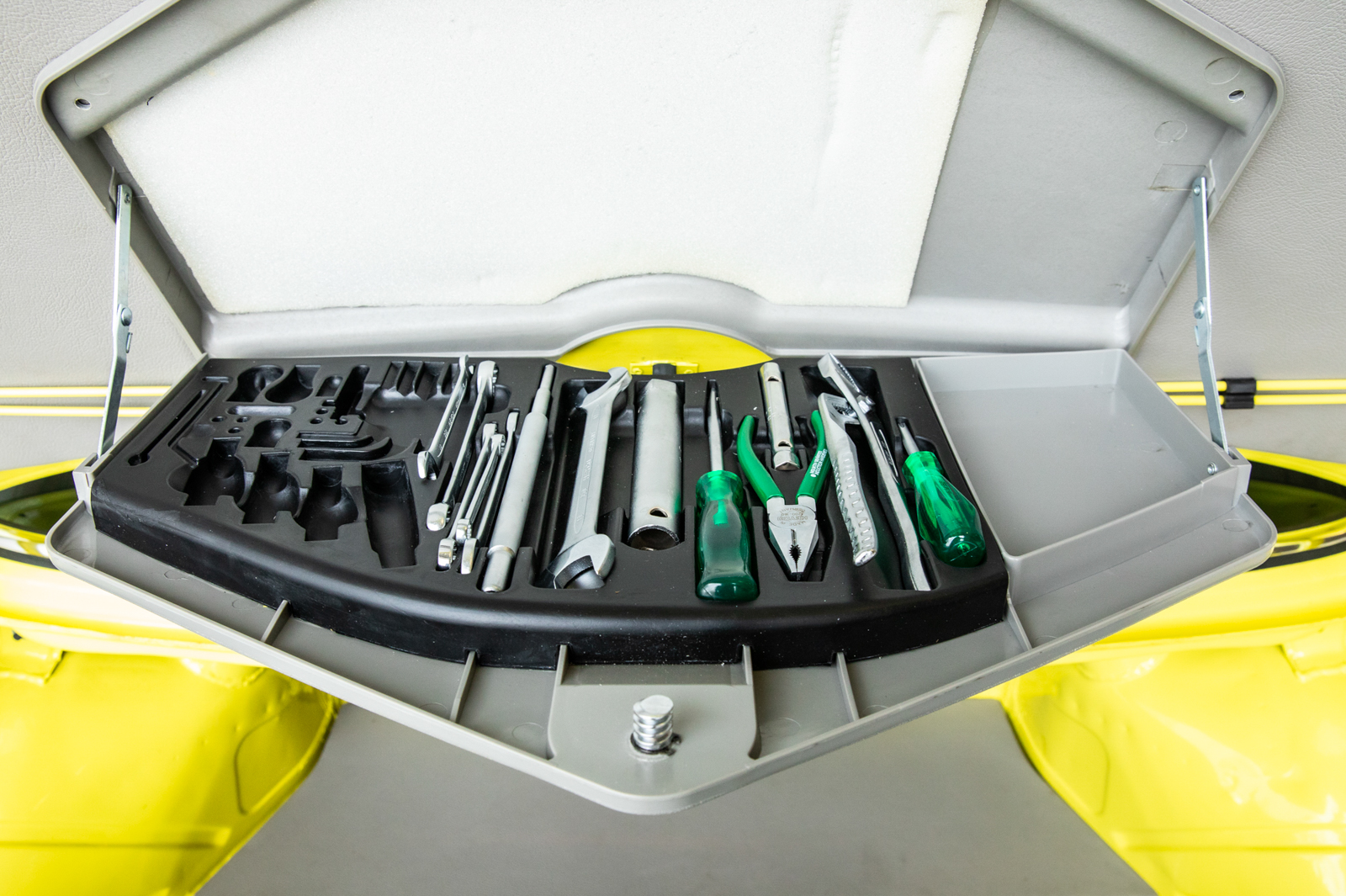

Toolkit: Late model, wrong tools, missing tools

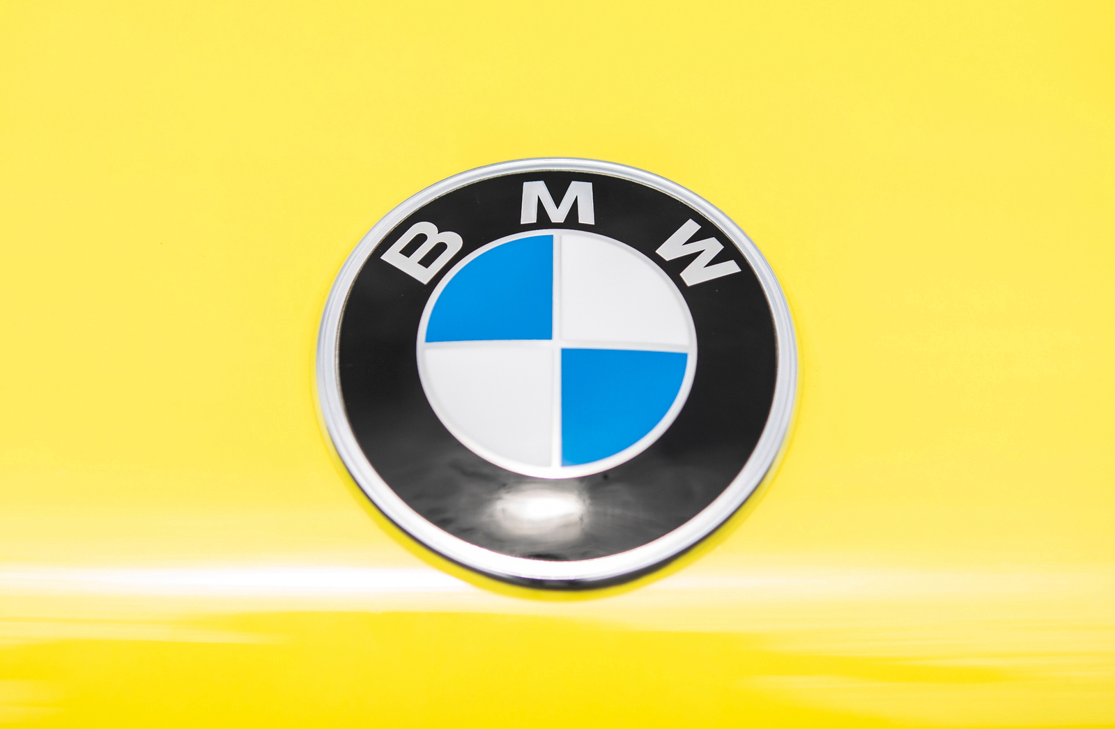

Trunk Roundel: Wrong badge, no badge pedestal, no pedestal gasket

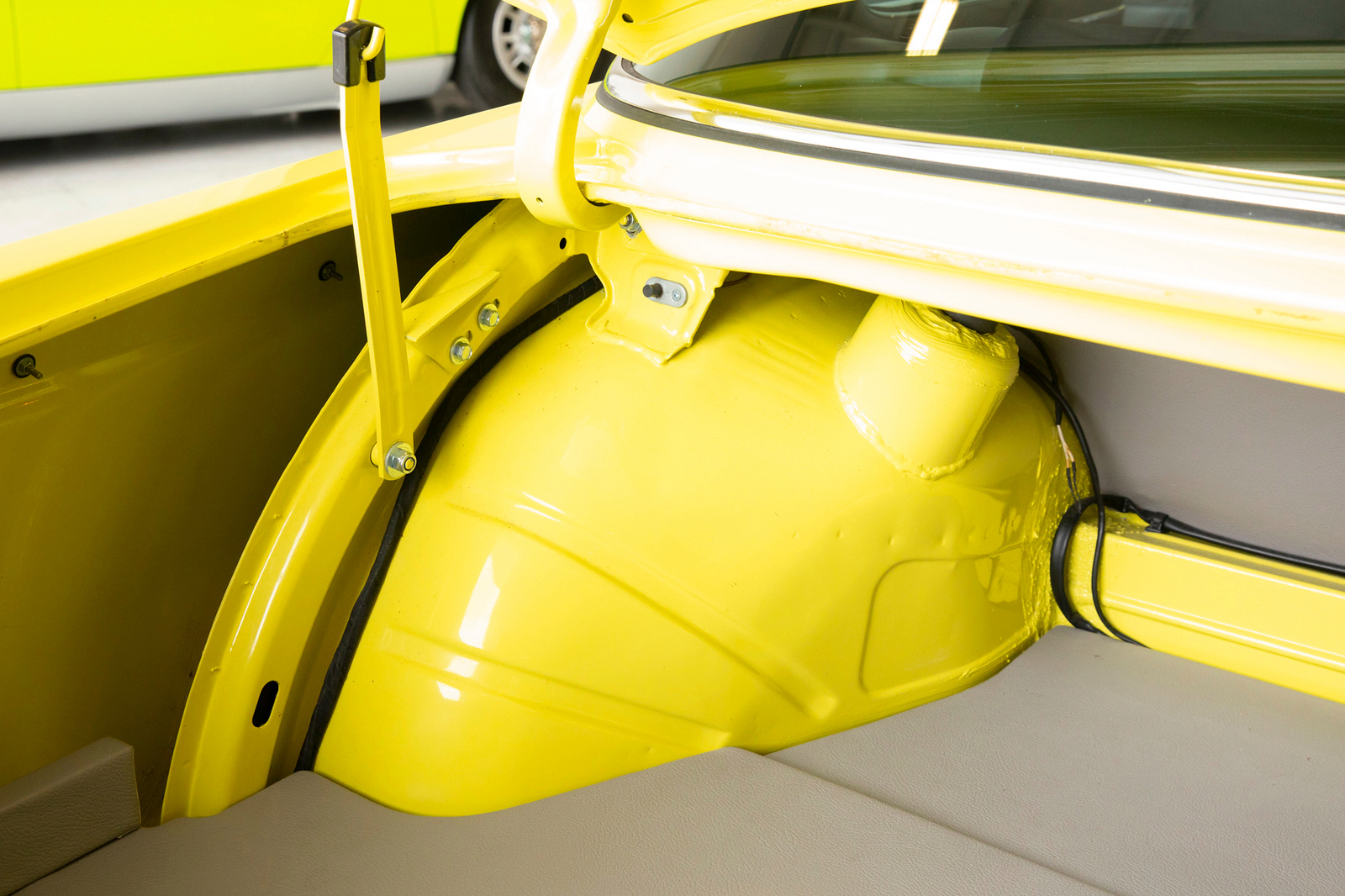

Trunk: Seam sealer everywhere, particular shock towers, zinc bolts, odd wiring, no trunk seal

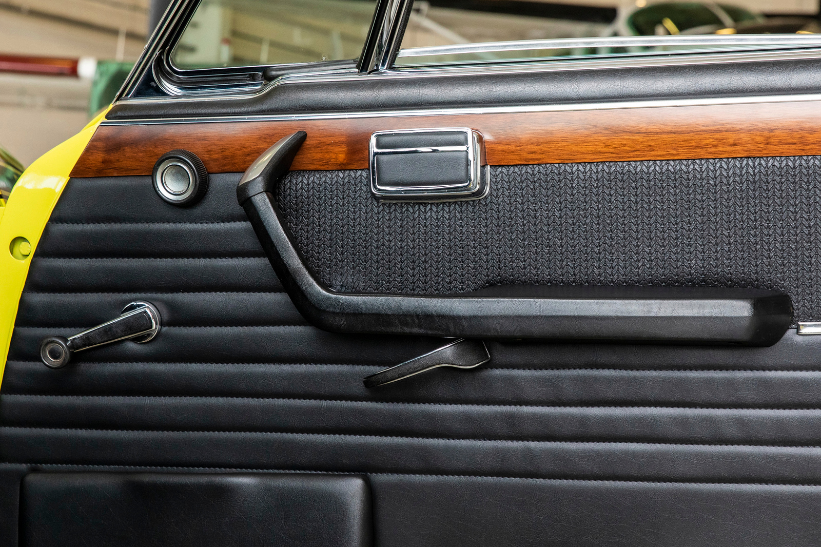

Door Panel: Missing white bolt cap, Missing lower aluminum trim, missing arm rest gasket, custom stitched pleats, custom ashtray inserts

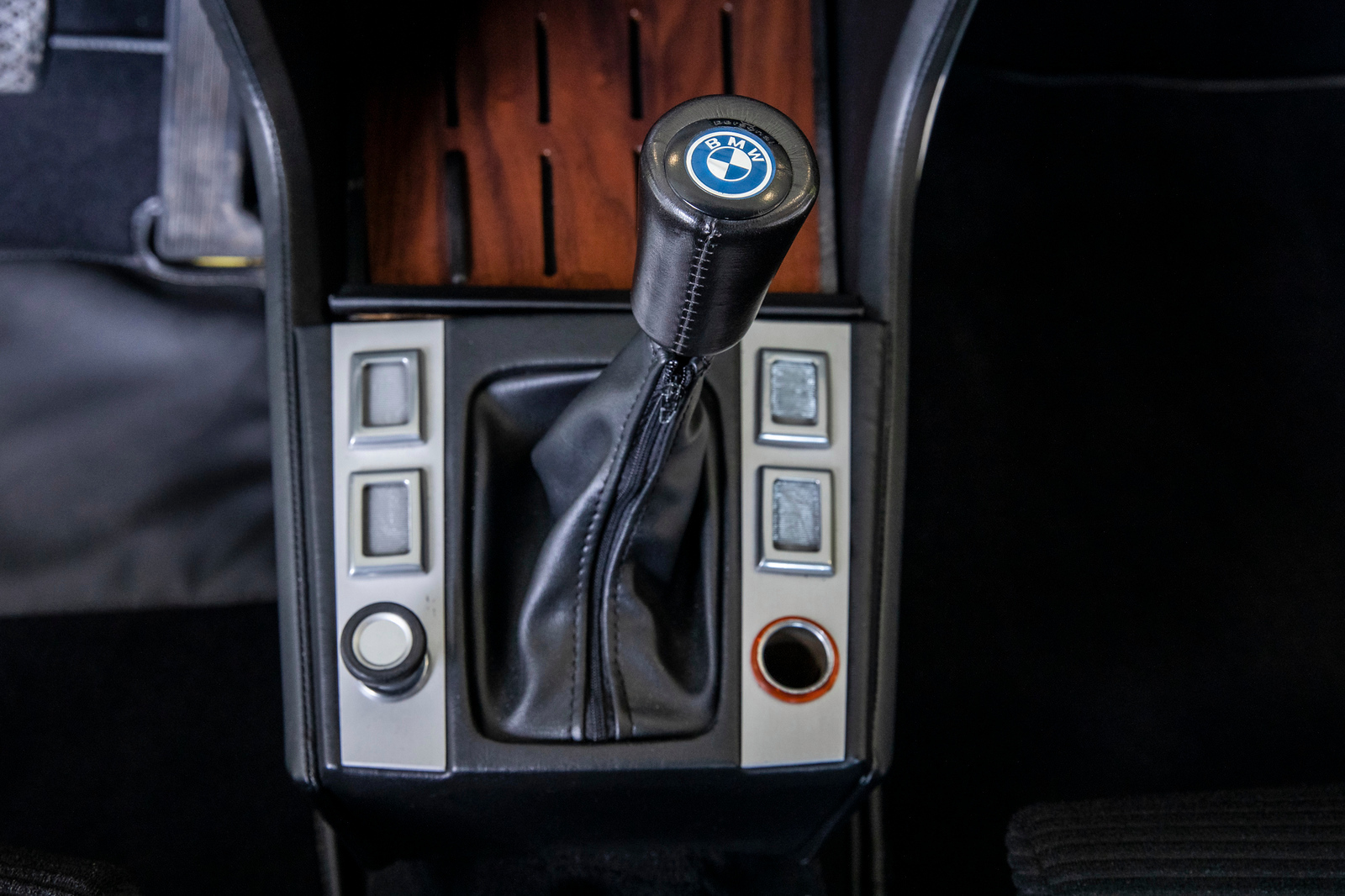

Console: Missing rubber plugs in wood, wrong shift knob, wrong lighter, restitched console sides
