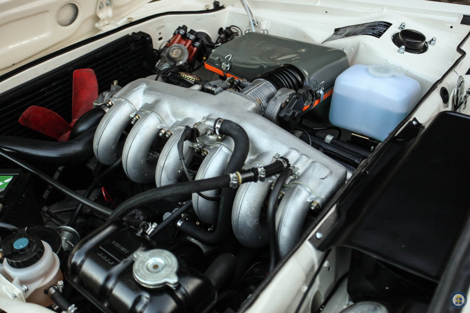

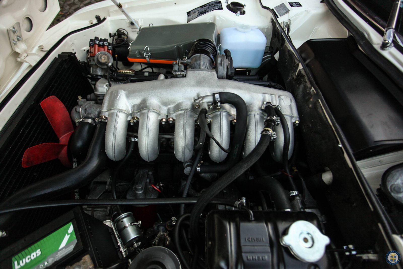

Hello every one ,,, I am new owner of 73 3.0CSI imported from Netherland , car over heats in the city not on highway , I removed the thermostat and problem not solved , radiator looks new ,fan runs but seems to be slow ,, is it water pump ?? belt is tight , any Ideas ?? thanks a bunch . Farzad

Is your fan clutch working? You have the original friction set up. With the engine hot, can you turn the fan by hand? If no resistance then your fan clutch is kaput. Many of us have upgraded to the 9 blade/modern clutch setup. Another option is to do what they say in the blue book, remove 2 of the 4 fan bolts (opposits sides) and replace with longer ones to lock the fan in place to see if that solves your problem.
Hi Farzad, the first thing you did already. Thermostat. Water pump is close to not possible due to it´s made based on metal.
Next thing would be the fan / the thermo clutch which "switches" it on in case engine temp ist too high.
If the engine temp is high, you should have reasonable resistence when you turn the fan by hand (engine off ;))
I didn't check the fan when it was hot .... I am going to do Steve's suggestion ... I am waiting for new water pump to do it all at once ...I don't think its the water pump ... I have no idea about thermo clutch .... I know that fan operates when engine running .... but looks slow.
Thank you ... fan turns free in one direction but not the other way ... I will do the bolts as you suggest ,, lets see if it solves the problem .

I know a lot of guys do not like the original fan clutch set up but you can shim the thermo coupling inside the fan clutch to make the fan lock on when it gets hotter If you want to keep it original We used todo it at the dealership all the time, still do it from time to time I can explain it if anyone is interested Guess I am still old school, well, I certainly feel it these days
Thanks, Rick
Am I wrong to assume that the current setup based on the pictures is original and without a fan clutch? Fan does not look like a nine or eight blade.
If so, that set up should be upgraded, like in most of the coupes.
Also, I have been told that removal of thermostat is a wrong thing to do in any situation.
Thanks, Rick
I would like to have you explain this!
