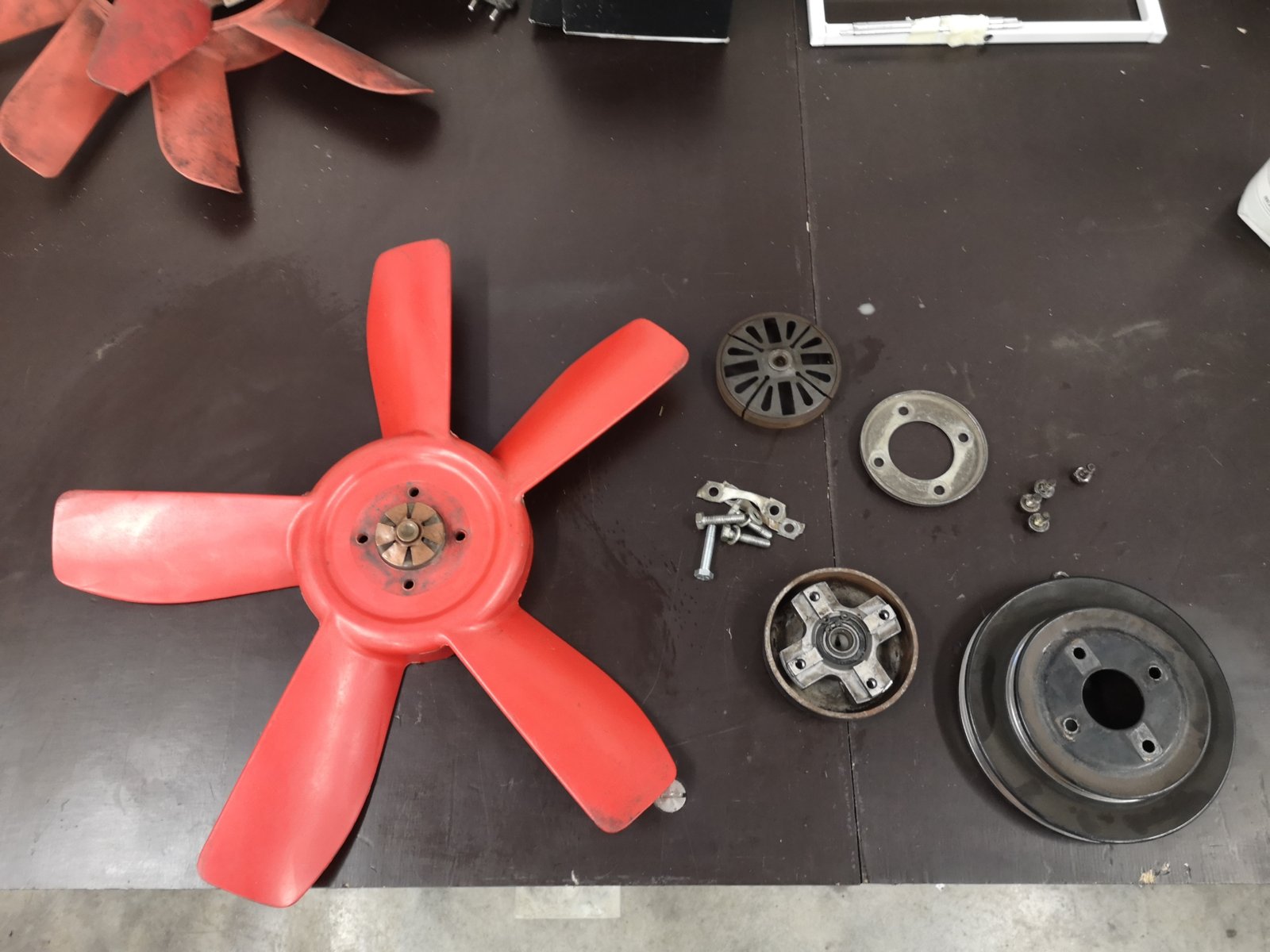

After reading your comment we just had to try it out, and here are some pictures that might help someone else.
All the parts:

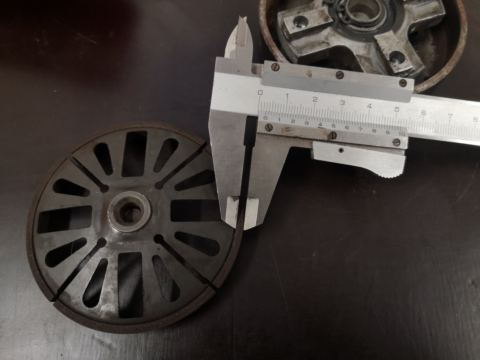

According to @eriknetherlands great info in another thread, the friction material should be somewhere near 2,7-2,8mm when new, and ours was 2,8mm.

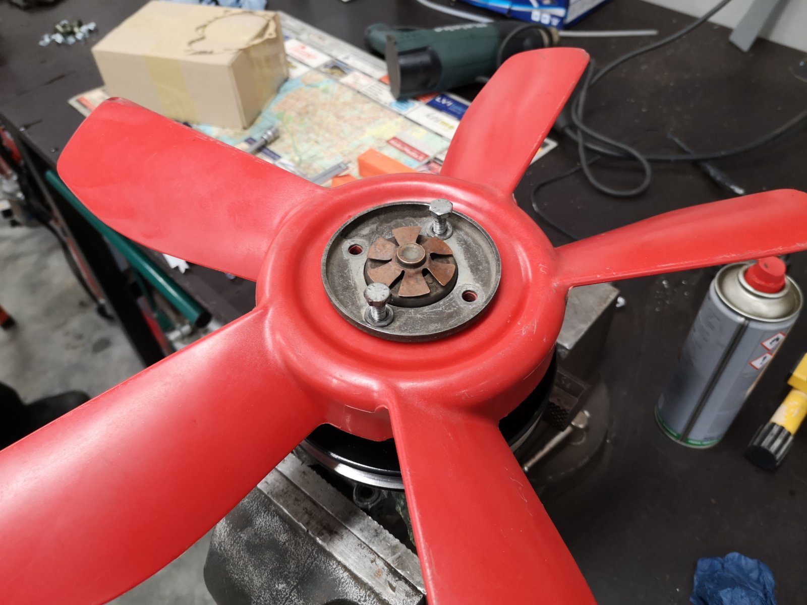

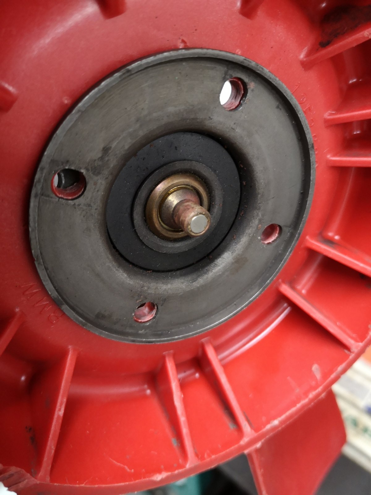

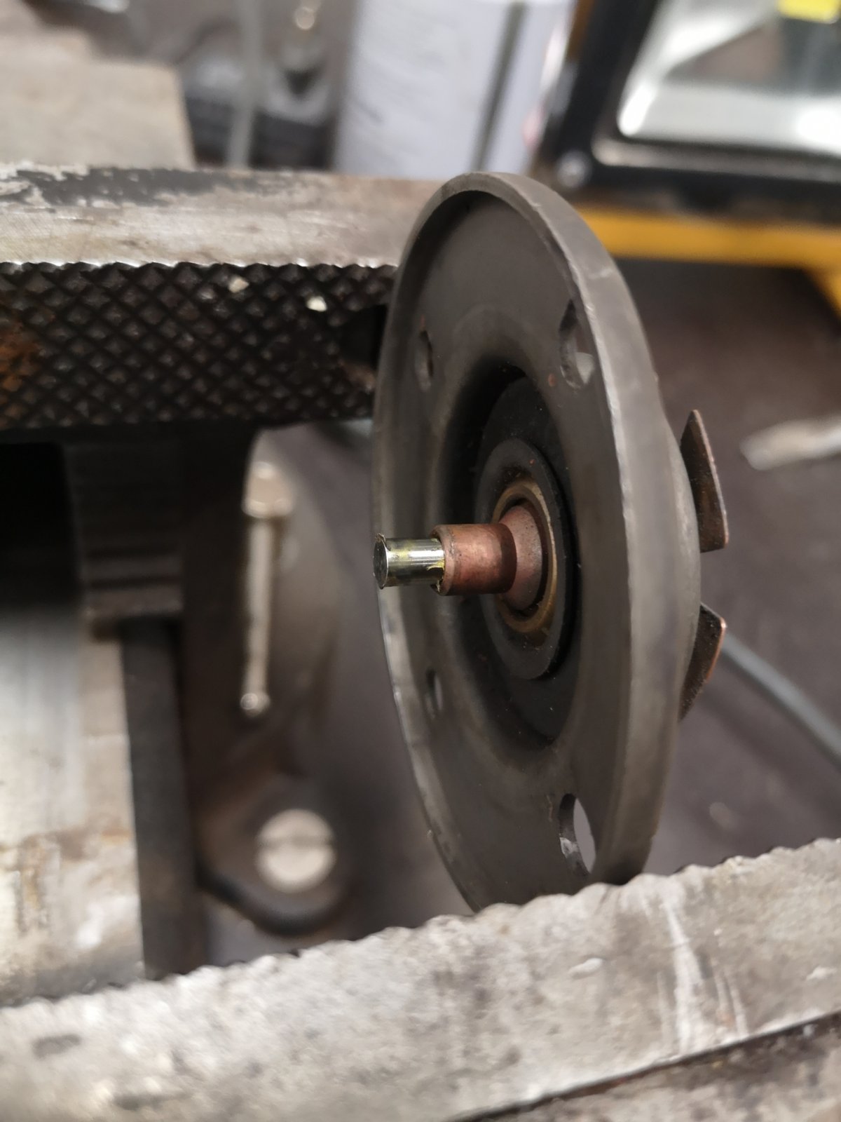

This thermo coupling pin in the middle is what engages the clutch, here when cold:
And here after some heatgun treatment:

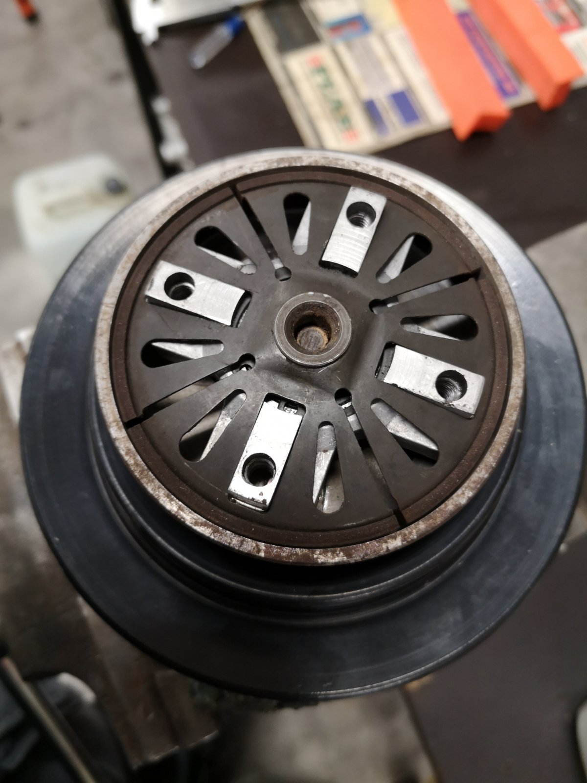

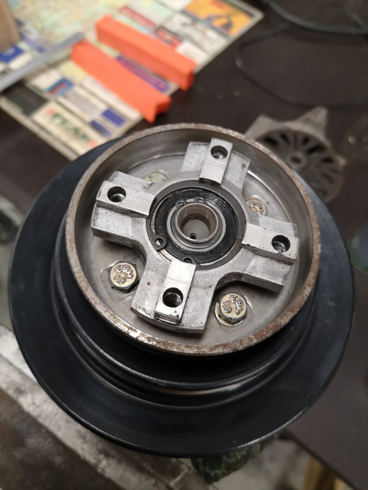

This pin pushes into the middle of the clutch disk, and this is where you need to add a shim.
Easiest way to check what might be the best shim thickness for you, is to put an old waterpump in the vise, and install all the parts on that.
We started with no shim, then spun the fan while heating with a heatgun to get a feeling on when, and how much it locks up.
After that I tried several different shims until I found one that does not lock up the fan when cold, but still locks it up quite fast after getting some heat.
One of the washers/shims I tried
Since it's winter, we haven't really tried it out, but it seems to lock the fan way earlier and harder.
