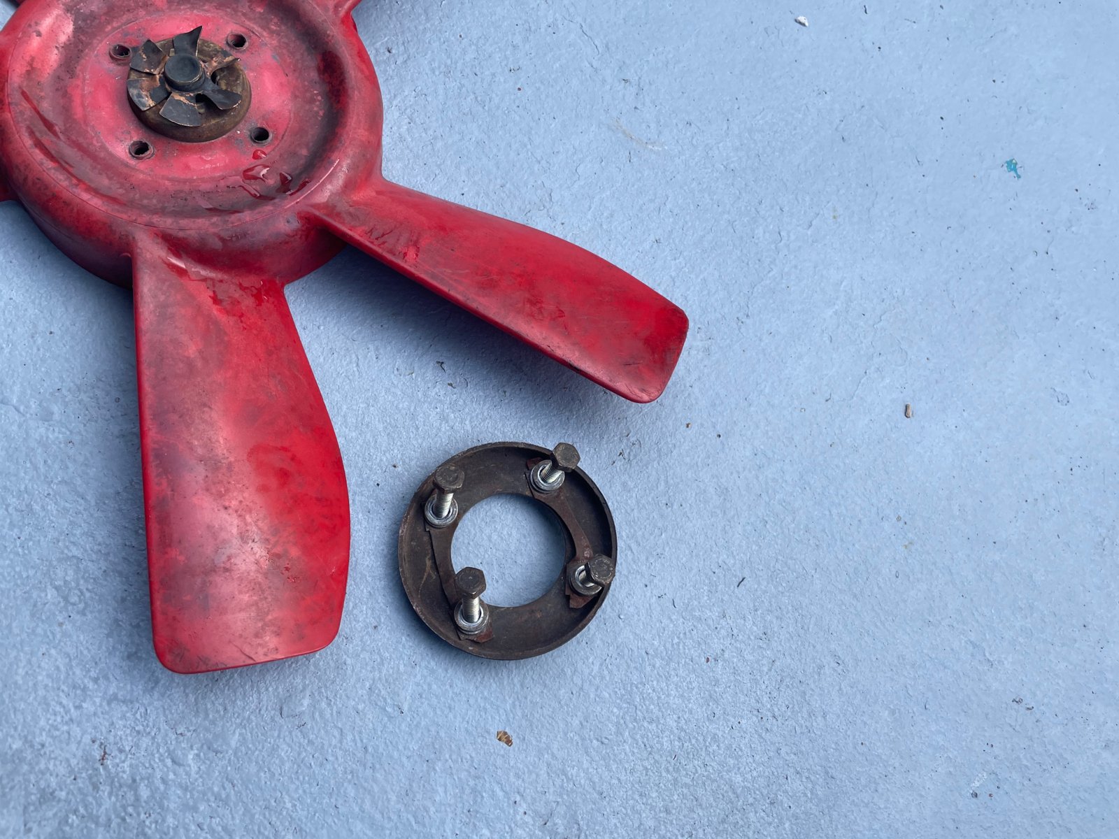

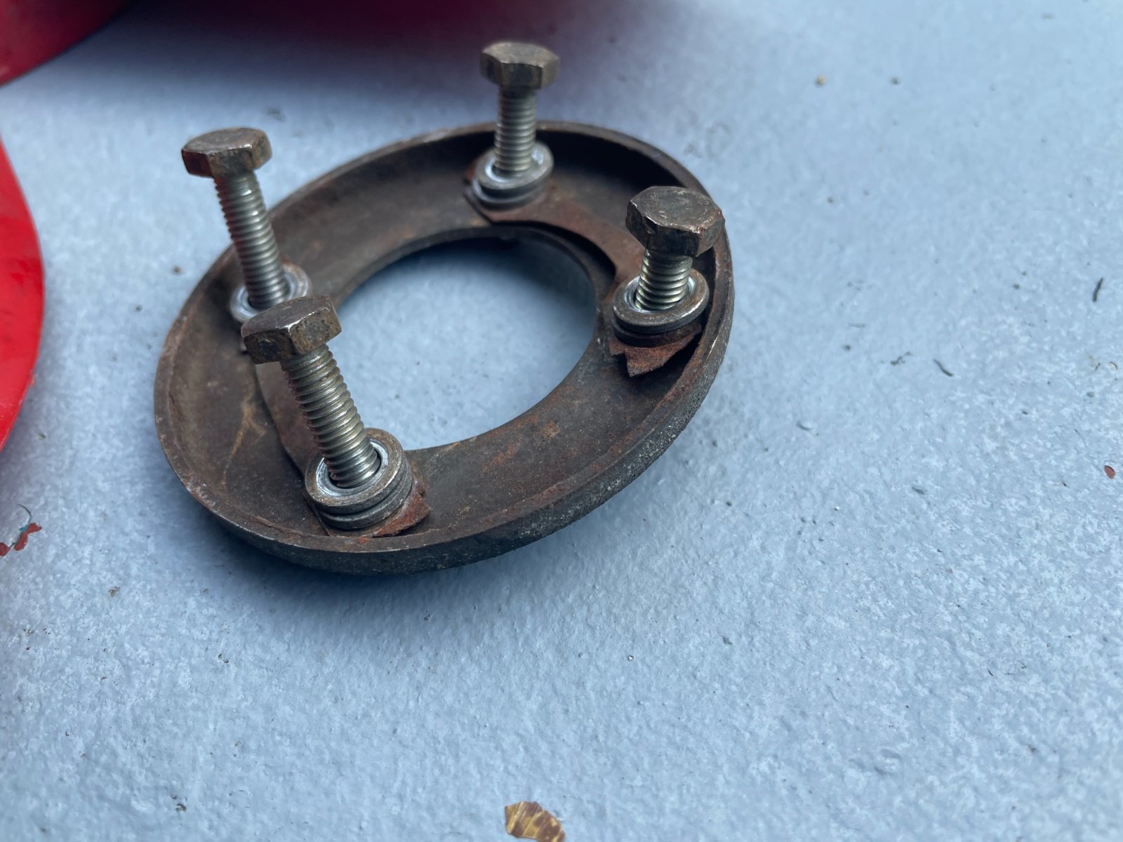

Is your fan clutch working? You have the original friction set up. With the engine hot, can you turn the fan by hand? If no resistance then your fan clutch is kaput. Many of us have upgraded to the 9 blade/modern clutch setup. Another option is to do what they say in the blue book, remove 2 of the 4 fan bolts (opposits sides) and replace with longer ones to lock the fan in place to see if that solves your problem.

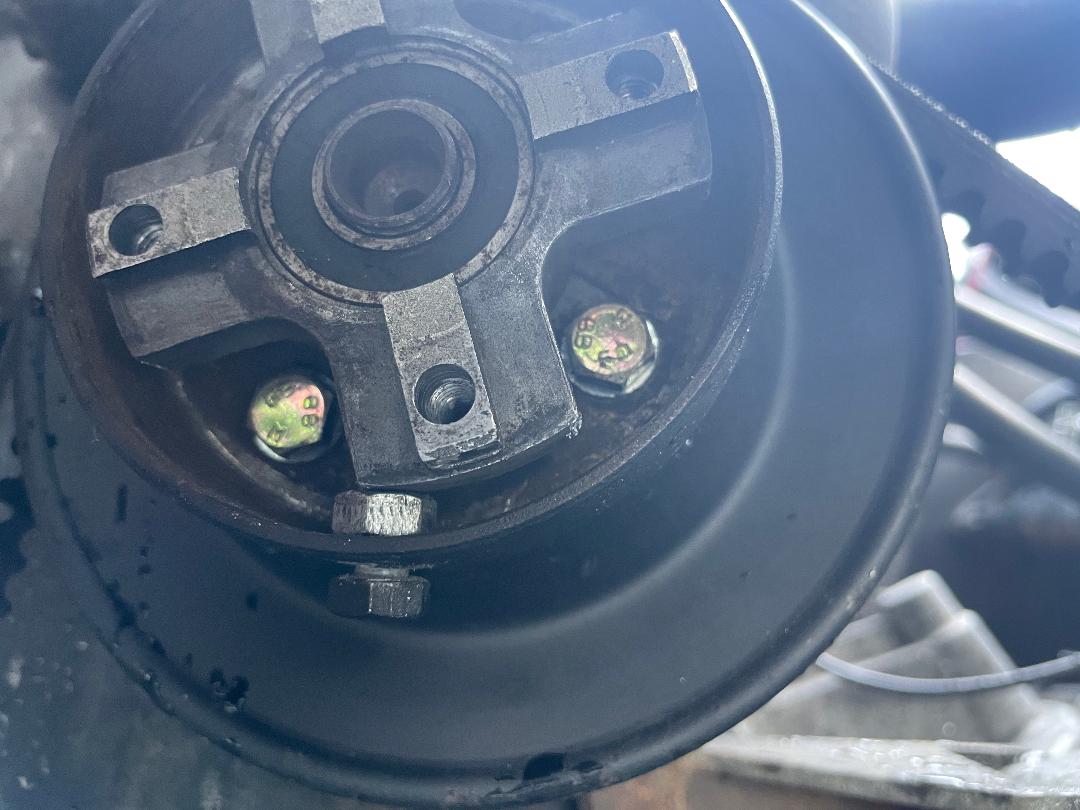

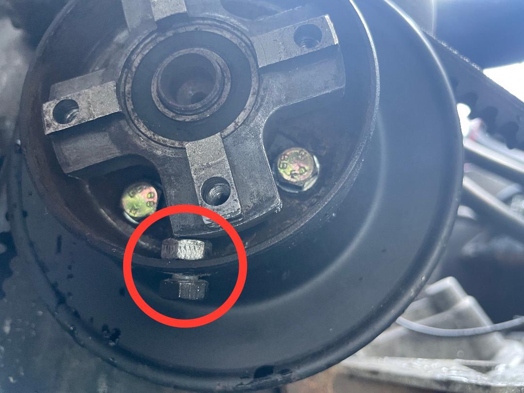

Is this the bolts you are talking about ... also what is this bolt and nut on outer edge? I have the picture.. it was lose

If that is your setup I would consider replacing your water pump. That’s not the proper way to lock the clutch. That extra bolt at the bottom is likely throwing everything out of balance, like a poorly placed wheel weight. I would imagine that the water pump bearings are take a beating.
I agree with @Markos that little bolt is not supposed to be there. Someone tried to lock the clutch that way. Remove it. Yes the 4 bolts shown with the ring in your pic are the ones I referred to. From the manual:
If a new fan coupling is not available for a repair,
the fan coupling can be blocked for a limited time with two M 6 x 30 mm
screws. The fan then turns continuously.
The screws should be opposite each other to avoid serious unbalance.

What do you mean by limited time?? I am changing the water pump too ... if installing longer bolts takes care of it ... I will do that ...
It's not a permanent solution, I thought you were going to just add the bolts to see if this was your problem. The permanent solution is to do the 9 blade fan and clutch upgrade.
