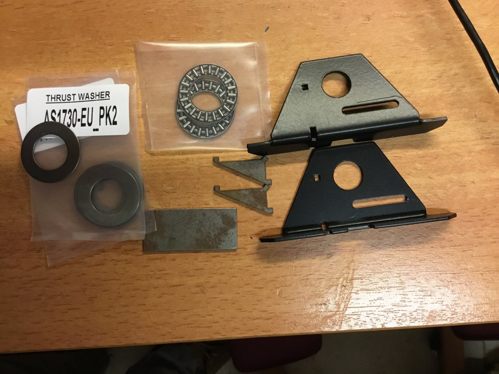

Going through the accumulated stuff. Come across this upgrade kit. The write up can be found on the forum
$25.00 plus shipping

that;s a good price. the question becomes which version. there is the original Paul Cain version ... and the deQuincey update to the upgrade

its a most have - works so good its amazing
that is the original setup
beautiful set of brackets.
tap and screw up down -no weld needed.! neat

I bought the handbrake upgrade kit from Coupe King. I believe it was called the Paul Cain. The restoration shop installed it and my brake has worked fine without the sloppy lateral movement it had before the work was done. I guess this is even an additional upgrade?
deQuincey
Quousque tandem...?
8,414
2,429
yes it is, but minimal and maybe only appreciated in the very very very long term
if you already have the original paul cain one, you are ok
if you are starting from the factory setup i would consider it
paul cain original is a M14 crude bolt, the handbrake lever is sitting and rolling against the bolt thread
dequincey upgrade is an M12 bolt inside and brass bushings on top of it, the handbrake lever sits and rolls against a flat brass surface,
so peak contact vs flat contact, see detail:
probably irrelevant provided the use of handbrake you do, but hey, if you want the best of the best, and moreover when the difference in price is ridiculous...
you decide
